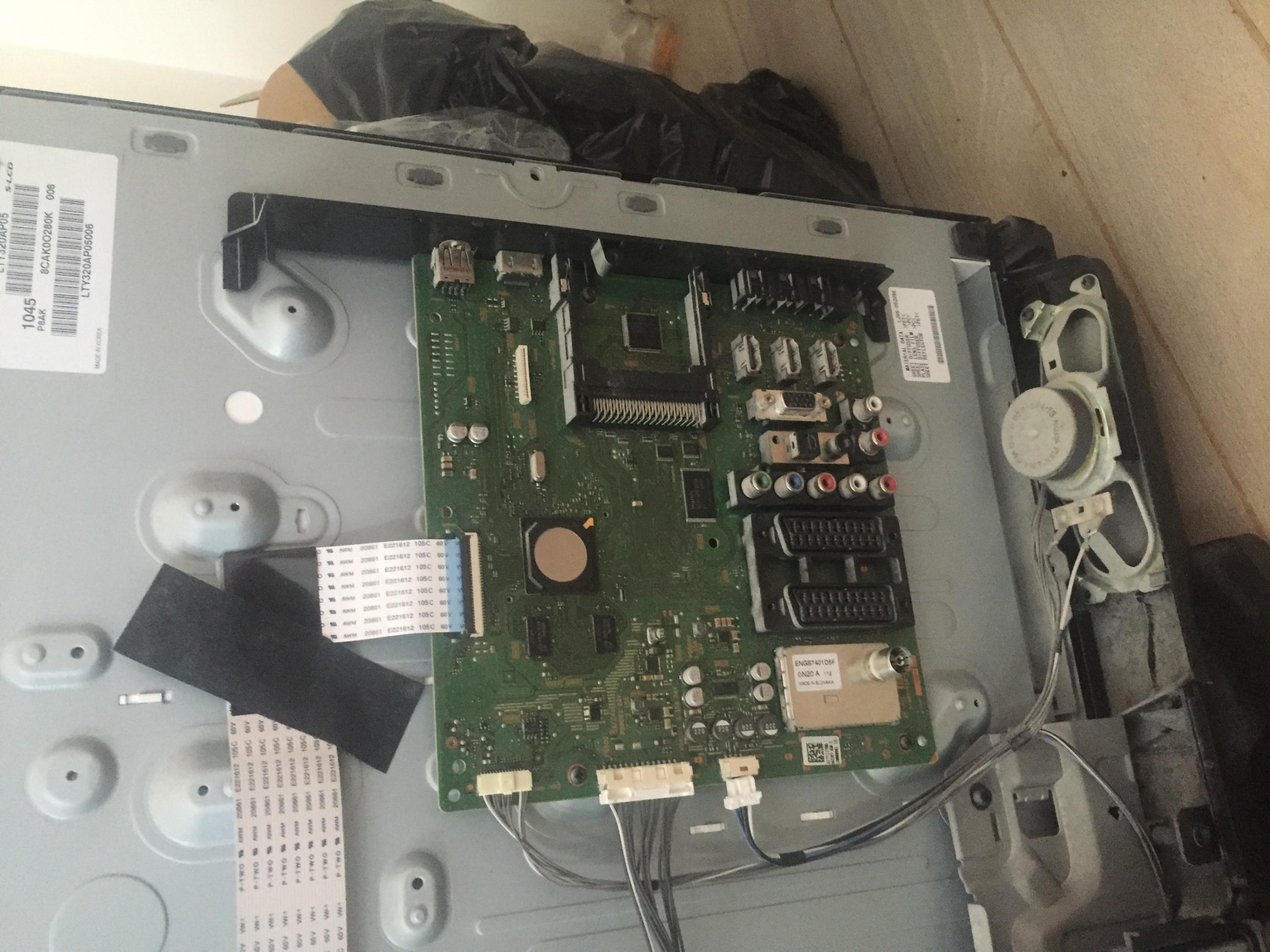

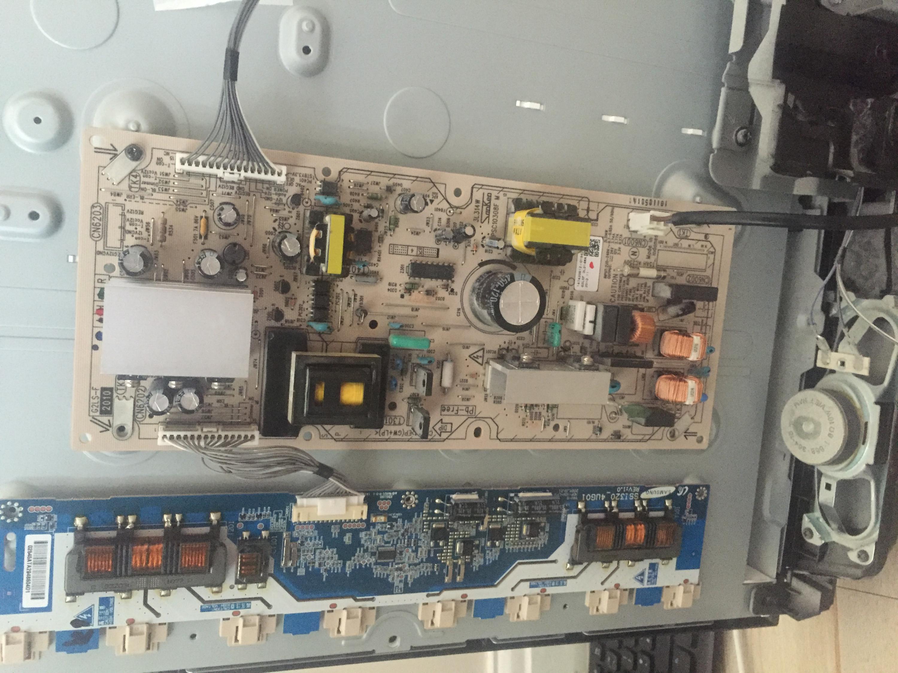

    The main board is the one that sends out the BL-ON signal. You may try removing the cable to the T-CON board to see what happen.
    When you force on the power supply, you can also try forcing on the backlights too WITH RESISTORS, I do not do force on without using the resistors, especially if you forget to remove the cables going back to the main board first, you can damage the switched transistors on the main board if you do not.

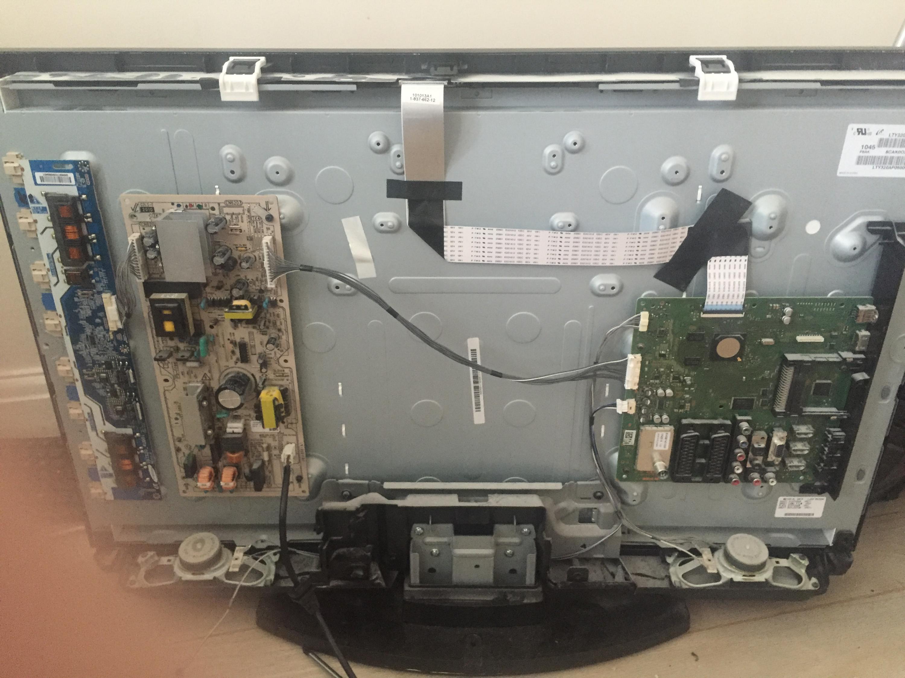

    Pictures of the whole backside of the TV and the boards will help.

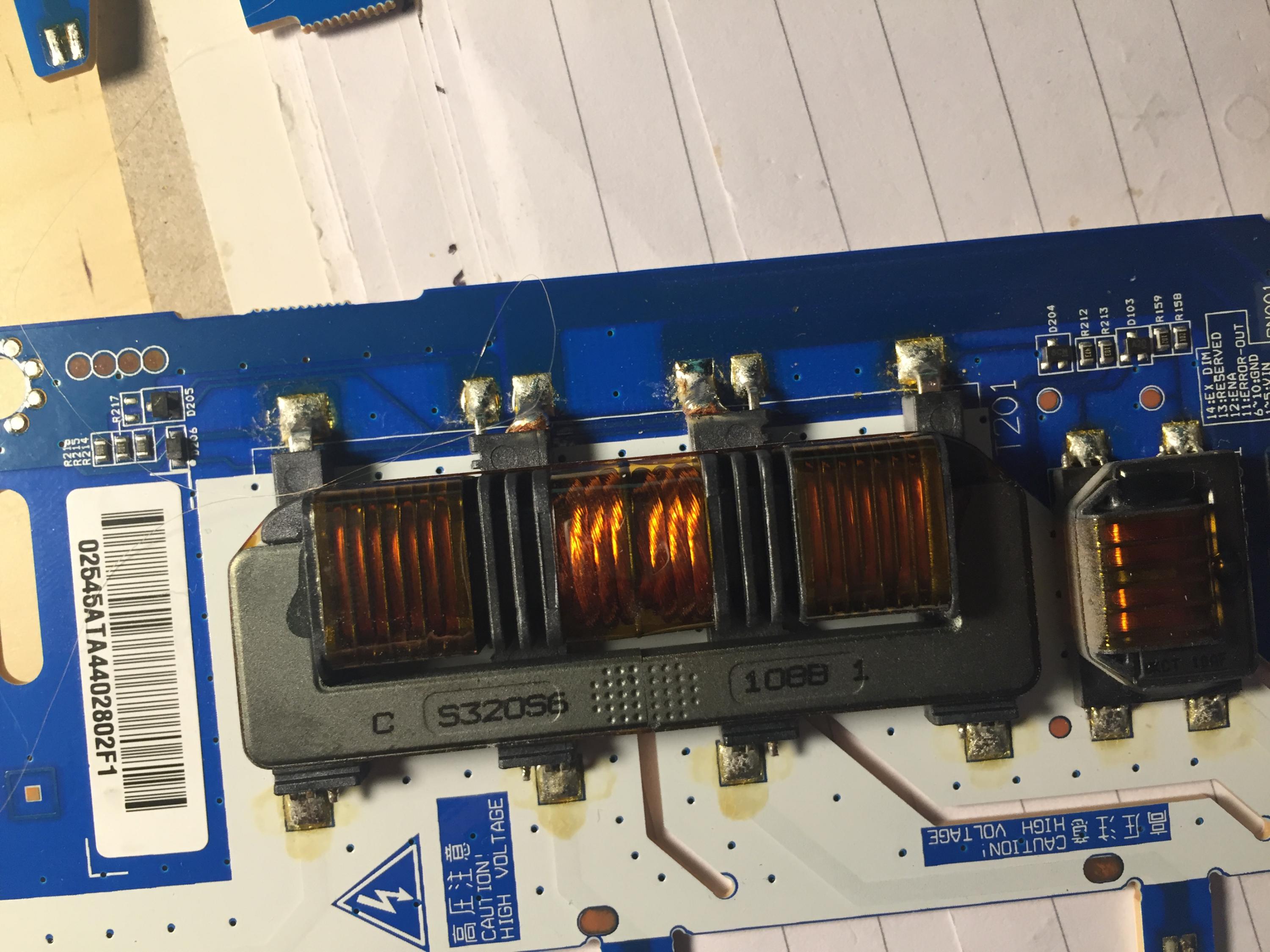

                You can check the resistance of the secondary side of the inverter transformer windings to see if they are with 3% from each other.
                I cannot read the P/N of the inverter board, the one printed on the board and theone printed on the barcode sticker, and also the P/N as printed on the inverter transformer.
                Is this your Samsung LJ97-02545A (SSI30-4UG01) Backlight Inverter?
                Picture provided by SHOPJIMMY.

                  Re: Sony KDL-32ex301 Backing Issue 6 flashing Red
                  yes that the one
                    Board ss1320_4UG01
                    Sticker 0254ATA298804D1
                    TRANSFORMER S32056 1077
                      OK, check the resistance between:
                      A & B
                      C & D
                      • smiddy1980

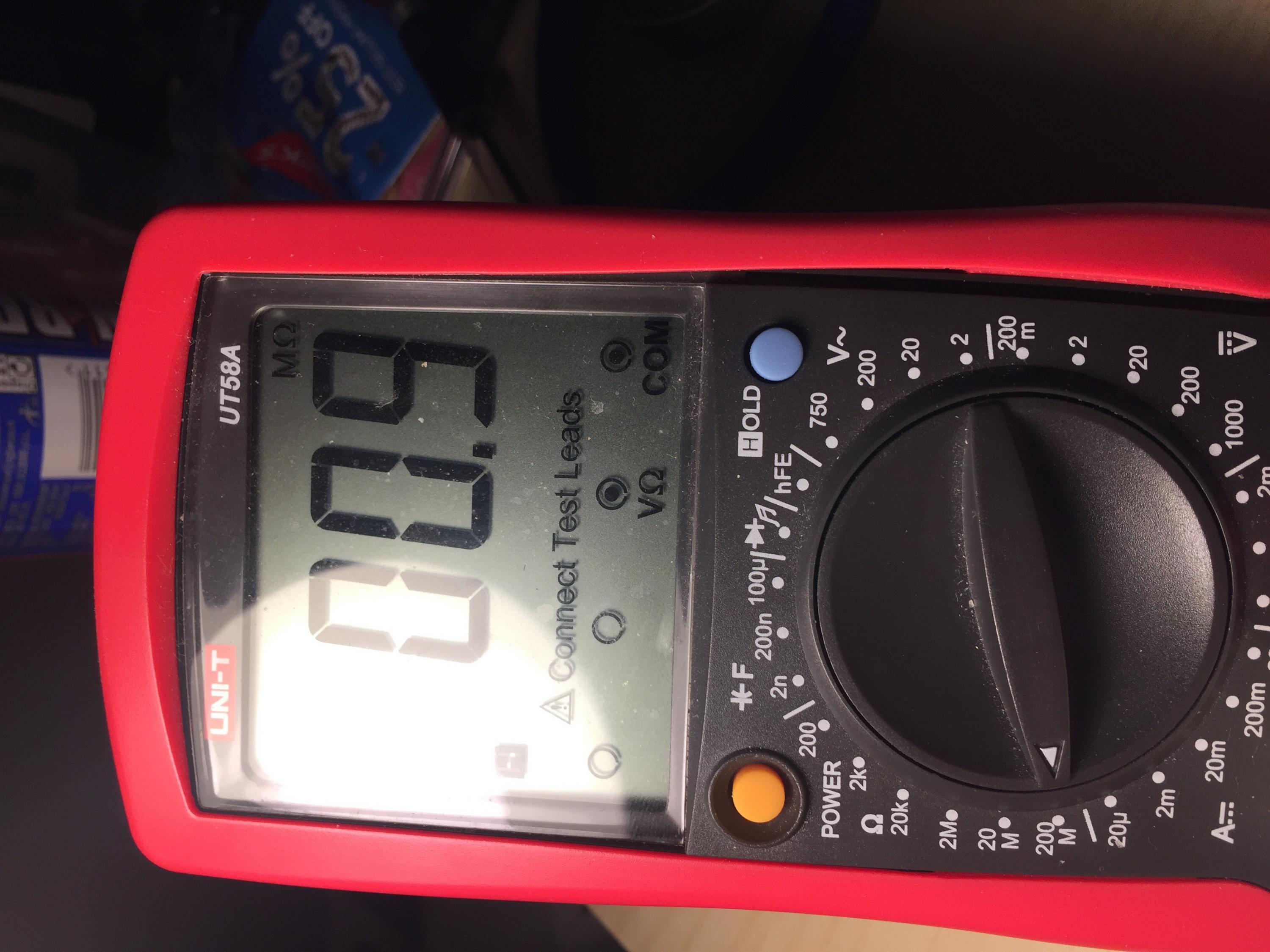

                        So the TOP Transformer (setting on Multi 200M)
                        A-B 1.1 M Ohms
                        C-D 2.0 M Ohms
                        Bottom Transformer
                        A-B 1.1 M Ohms
                        C-D 2.0 M Ohms

                            My Board looks like is has more feet on the transformer than the one in the pic
                              There are 4 legs on one side of the transformer as shown in my picture. Those 4 legs are for two pair of windings.
                                Originally posted by smiddy1980
                                on the second board I have for both top and bottom
                                A-B 1.1
                                C-D 1.2
                                What do you mean on the second board?
                                BTW, those reading are in Ohms, K Ohms, or M Ohms?
                                  sorry about that
                                  They are all 0.9 M Ohms
                                    sorry about that
                                    Are you sure? that is 900,000 Ohms!
                                      This is what it says on the meter, Sorry learning every day
                                        You do read it correctly, may be I am wrong about the pin out of the transformer. I cannot find much info on this transformer to verify the pin outs.
