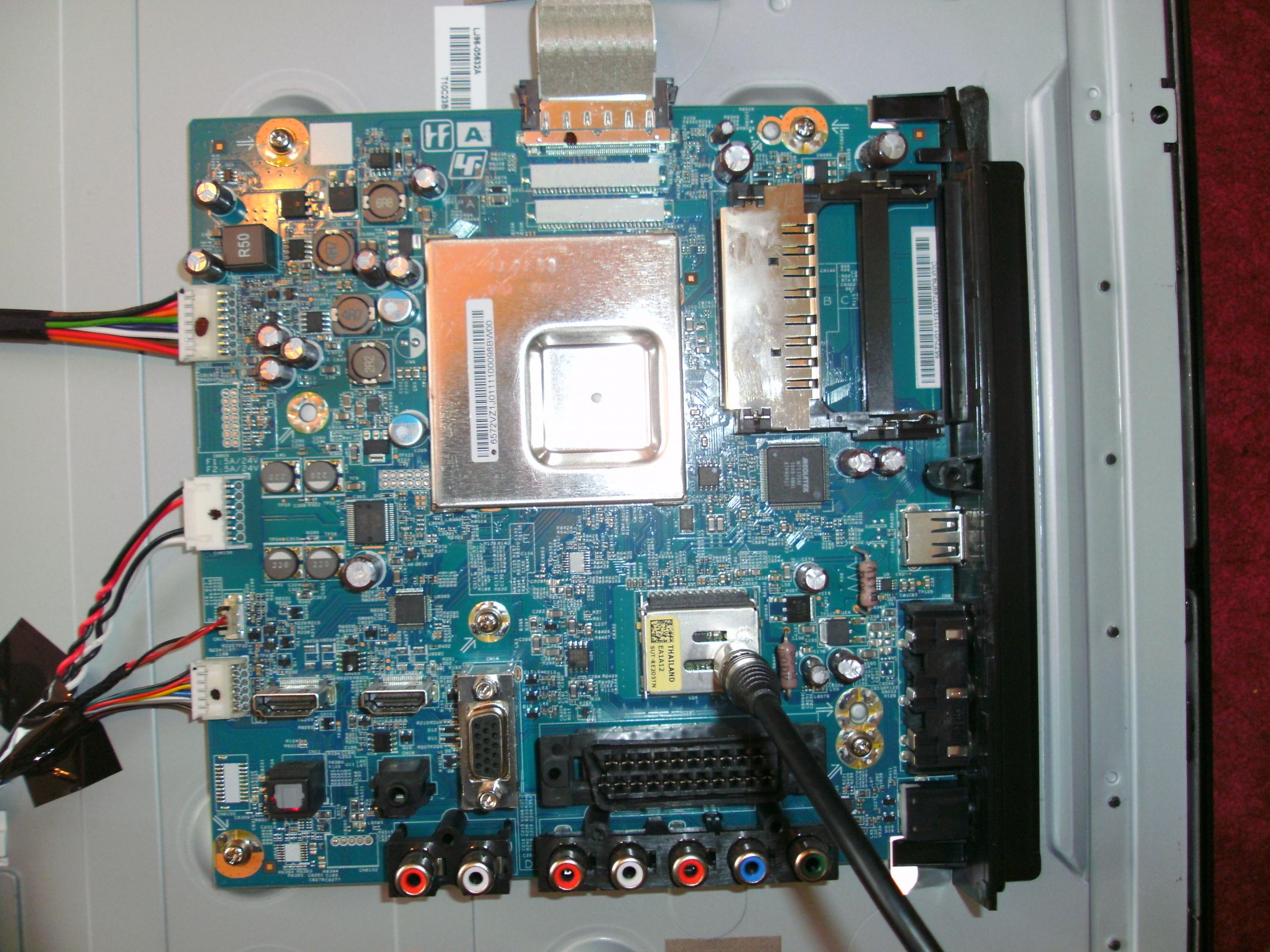

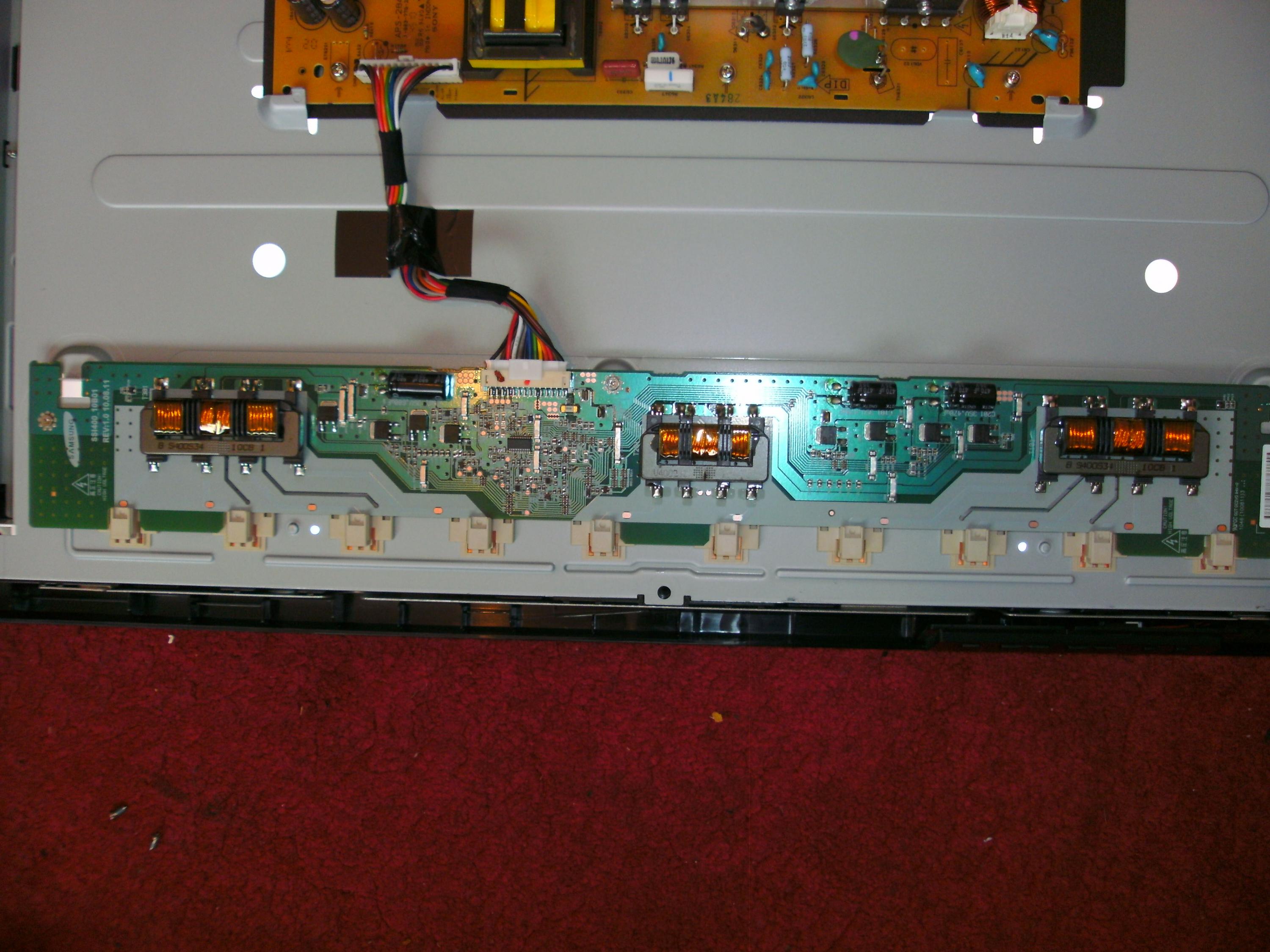

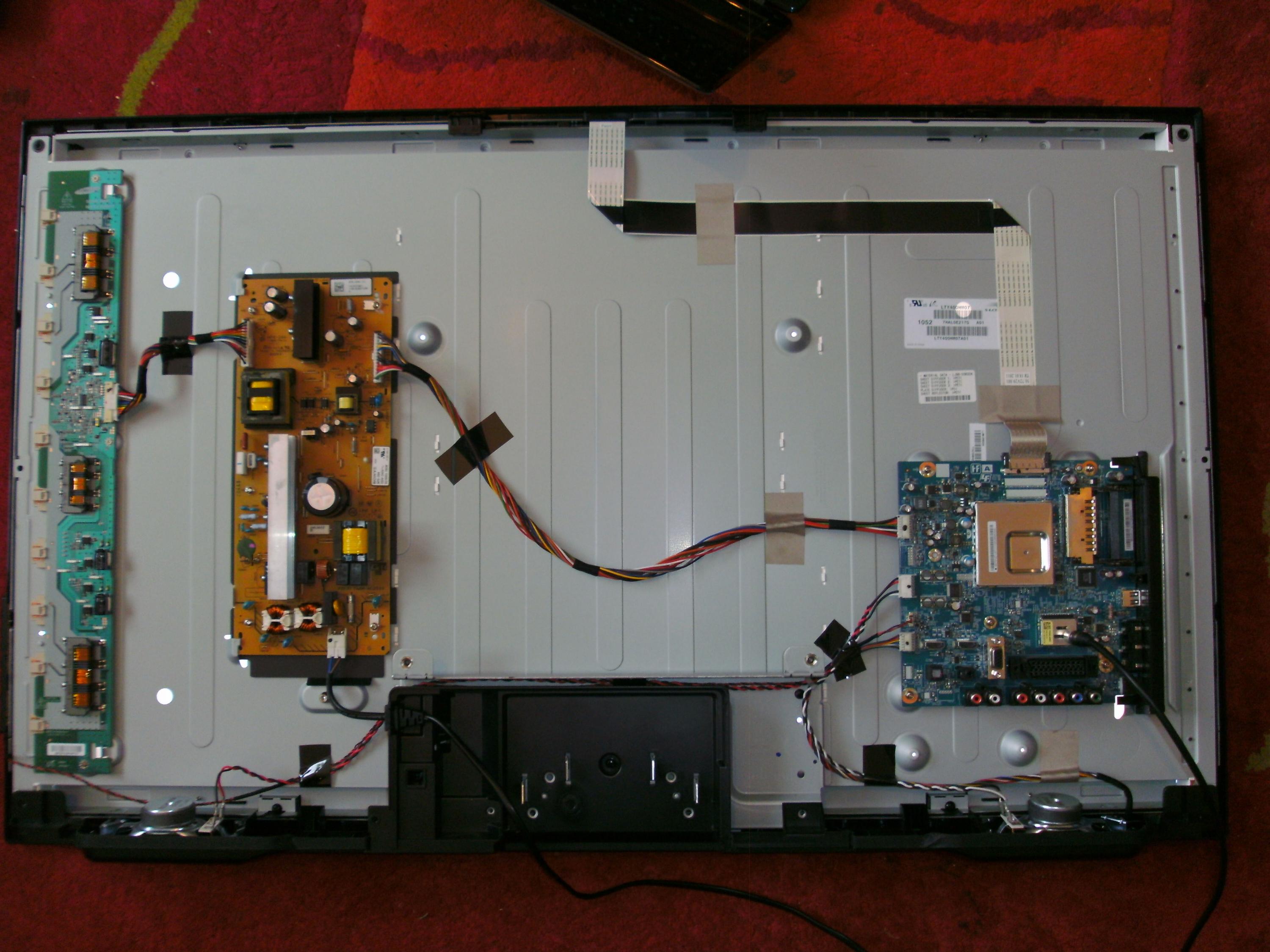

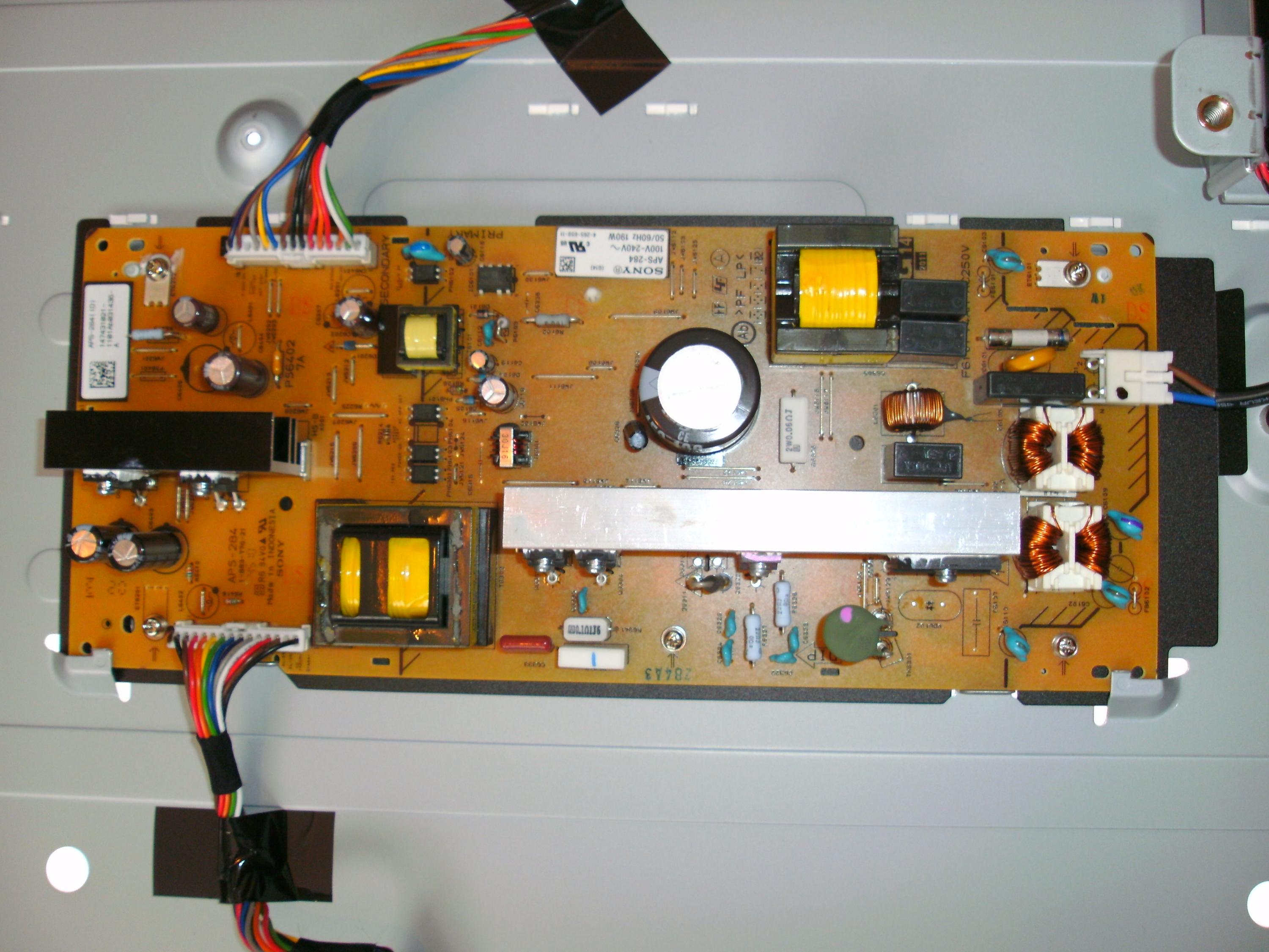

    Now this one is proving a pain, basically the Tv will turn on and give a picture but after a short period of time it will switch off needing to be unplugged from the mains to restart it, this period of time can be almost instant or after 30 seconds, maybe a minute, maybe five minutes, can even be longer. I've just done a little testing and have a stable 25V to the inverter, indeed disconnecting this has proved to stabilise the Tv, you can see the menus and such like faintly appear until it auto-powers down to standby and then can happily be turned back on, so for sure there is an issue with the back light, somewhere?????

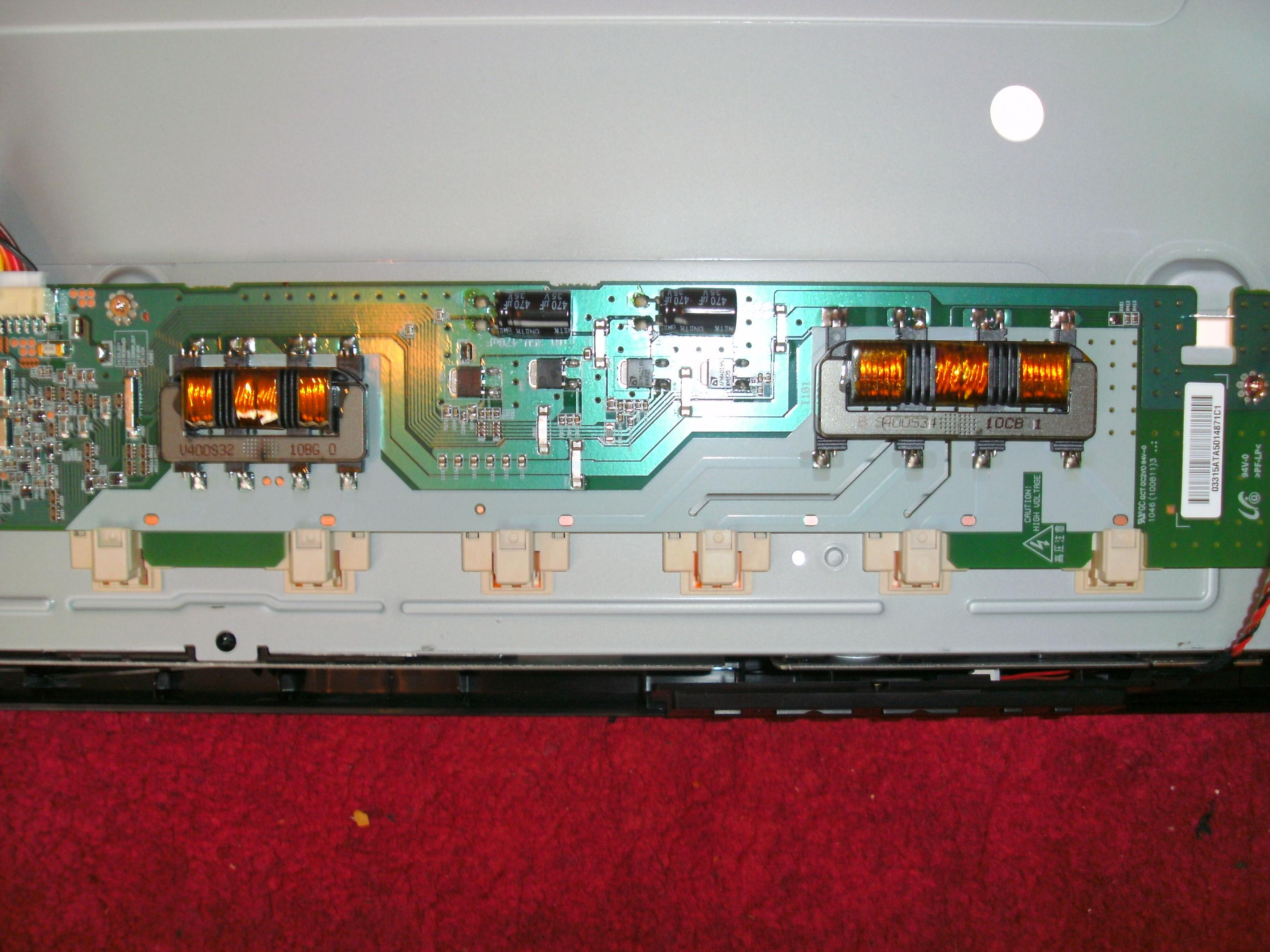

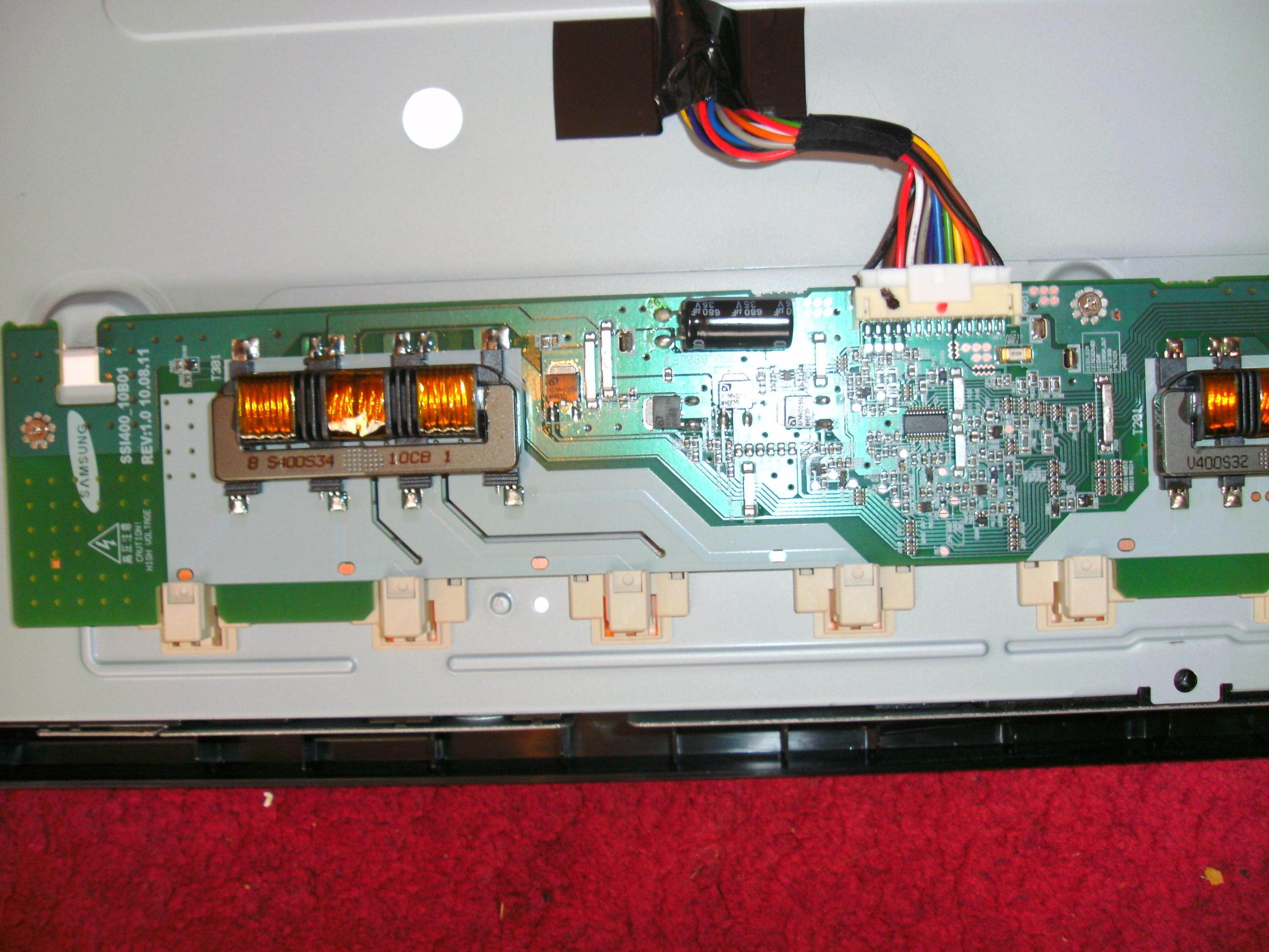

    I've tested all the components on the inverter and they all seem to measure out fine, strangely removing this and replacing it has allowed the Tv to be stable for over 20 minutes now, would this point to an earthing issue?

    Incidentally the Tv has been on for nearly an hour now, all good so far so I think I'm going to resolder a few joints and see how I get on.

      OK, so the inverter shield is back on, all components checked very closely with a magnifying glass for any dry joints and has now been working fine pretty much since this morning without issue. It's a strange one, I can only think it to be either an earthing issue or the possibility of a temporary short somewhere: maybe the pins used to connect the inverter to CCFL tube a little bent???? I don't know but for know it's working and all seems fine, I'll keep on using it and see if it rears it's ugly head again.

        What happen if you turn down the backlights level (not the Brightness level)? Will it stay on longer?

          This is the thing, it seems perfectly fine now, it seems that just by removing it and replacing it has some how resolved the issue, I have no idea what it's done but it's been fine since this morning.
          Any ideas what may of been the problem?
            Re: Sony KDL-40BX420 strange back light issue.
            May be loose connections, bad board mounting screws so you were not getting good ground, etc.
