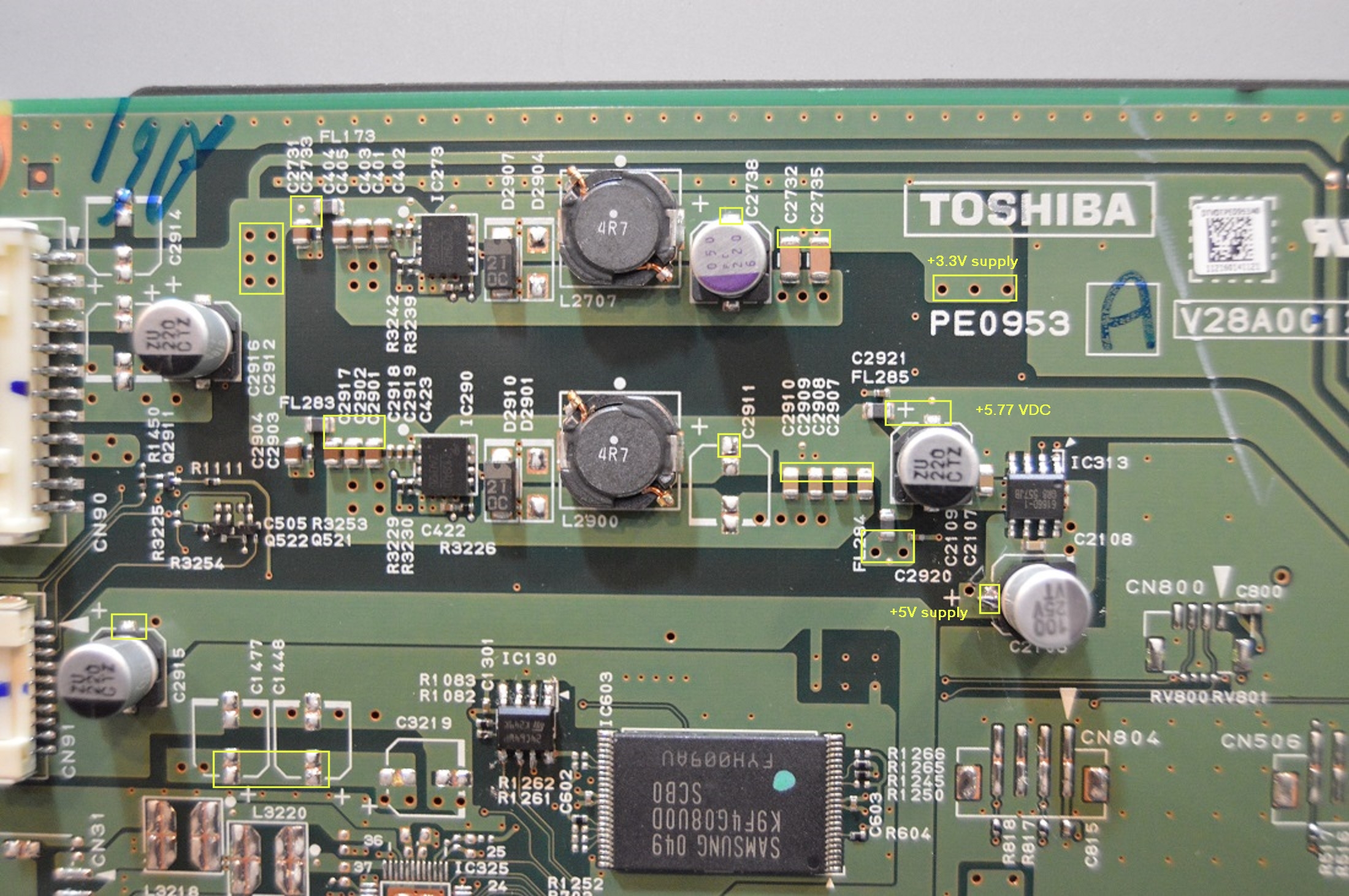

    ic273 D2907 L2707 C2735 THEY ALL HAD 3.32VDC
    IC290 D2910 L2900 C2907-2910 C2109 C2107 ALL HAD 5.77VDC
    IC313 THE 100UF SMD CAP JUST BELOW IT WAS 4.98 VDC
    C2705 C2707 C2708 FL174 ALL MEASURED 1.5VDC

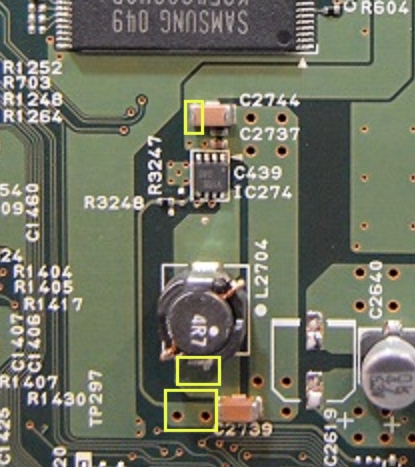

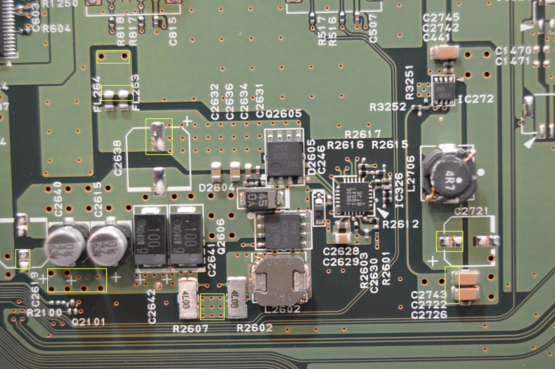

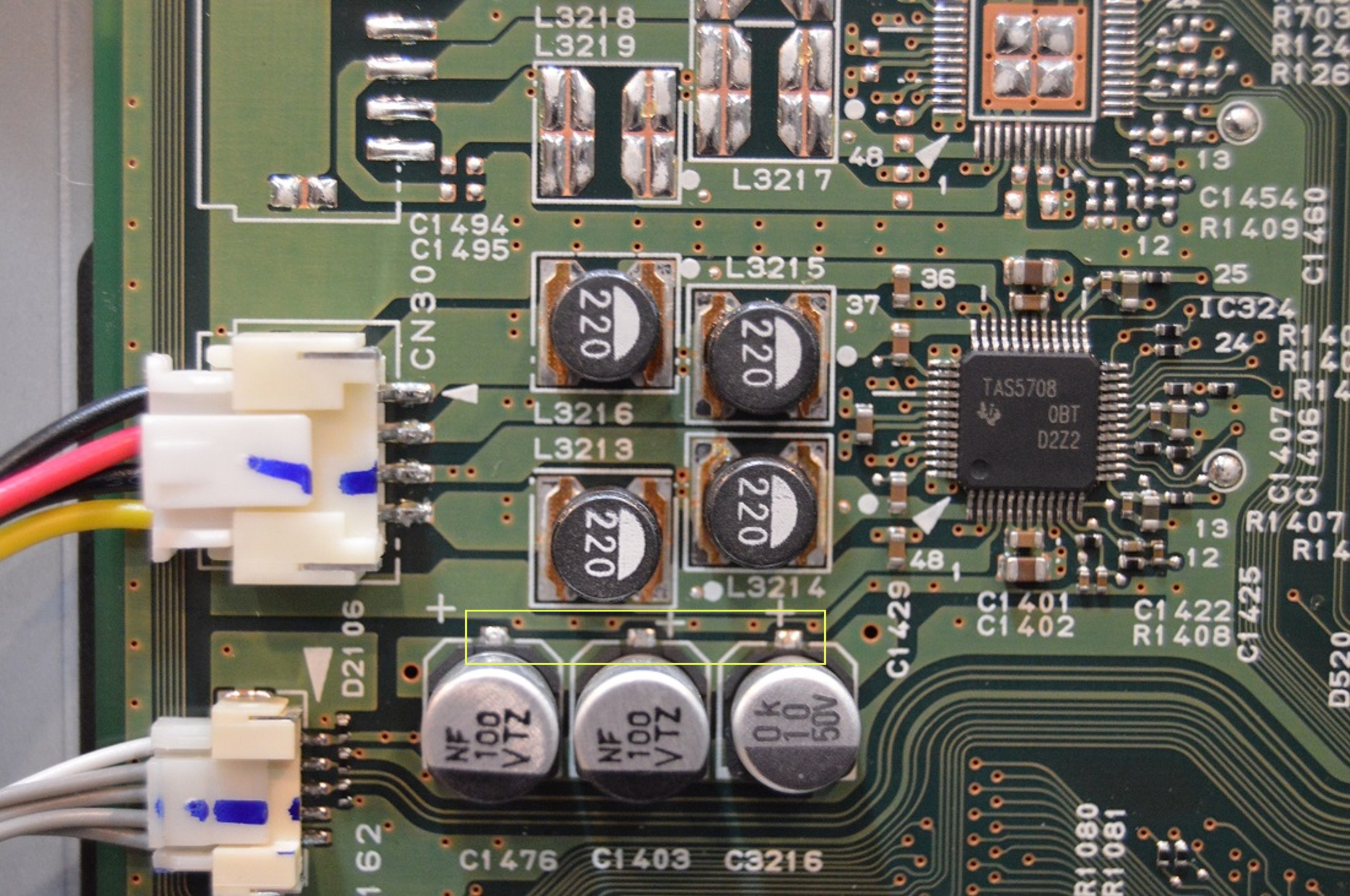

      I have identified various voltage test points. Many will be duplicated because I can't be certain if you will make good contact with your probes.
      You have identified the +3.3V, +5V, and +1.5V supplies. Could you now measure the voltages in the "regs3" and "regs4" attachments?

        C1476 24.31V
        C1403 24.31V
        C3216 24.31V
        C2915 5.14V
        C1477 24.32V
        C1448 24.32V
        C2702 5.72V
        L2701 5.72V
        C2705 1.5V
        FL174 1.5V
        C2707 1.5V
        C2708 1.5V
        FL264 3.3V
        FL263 3.3V
        C2638 3.3V
        C2640 .91V
        C2615 .91V
        R2607 .91V
        C2743 2.49V
        C2721 2.49V
        C2744 5.14V
        L2704 .91V
        C2739 .91V
        C2914 12.27V
        C2915 5.14V

          Thanks. You've now found a +2.5V supply and what appear to be two 0.9V Vcore supplies. Therefore it appears that the SoC (the large chip under the heatsink) is a dual-core MCU. I don't understand why one of the Vcore regulators is "heavier" than the other, though. You might like to verify that there is no short circuit between the two cores by measuring the resistance between L2704 and R2607.
          The next thing I would do would be to measure the same voltages again, once in standby mode (after switching on the AC supply), and again in run mode after pressing the power-on button on the remote or on the front panel. If some of the voltages are switched on by the remote, then this will prove that the SoC is alive.
