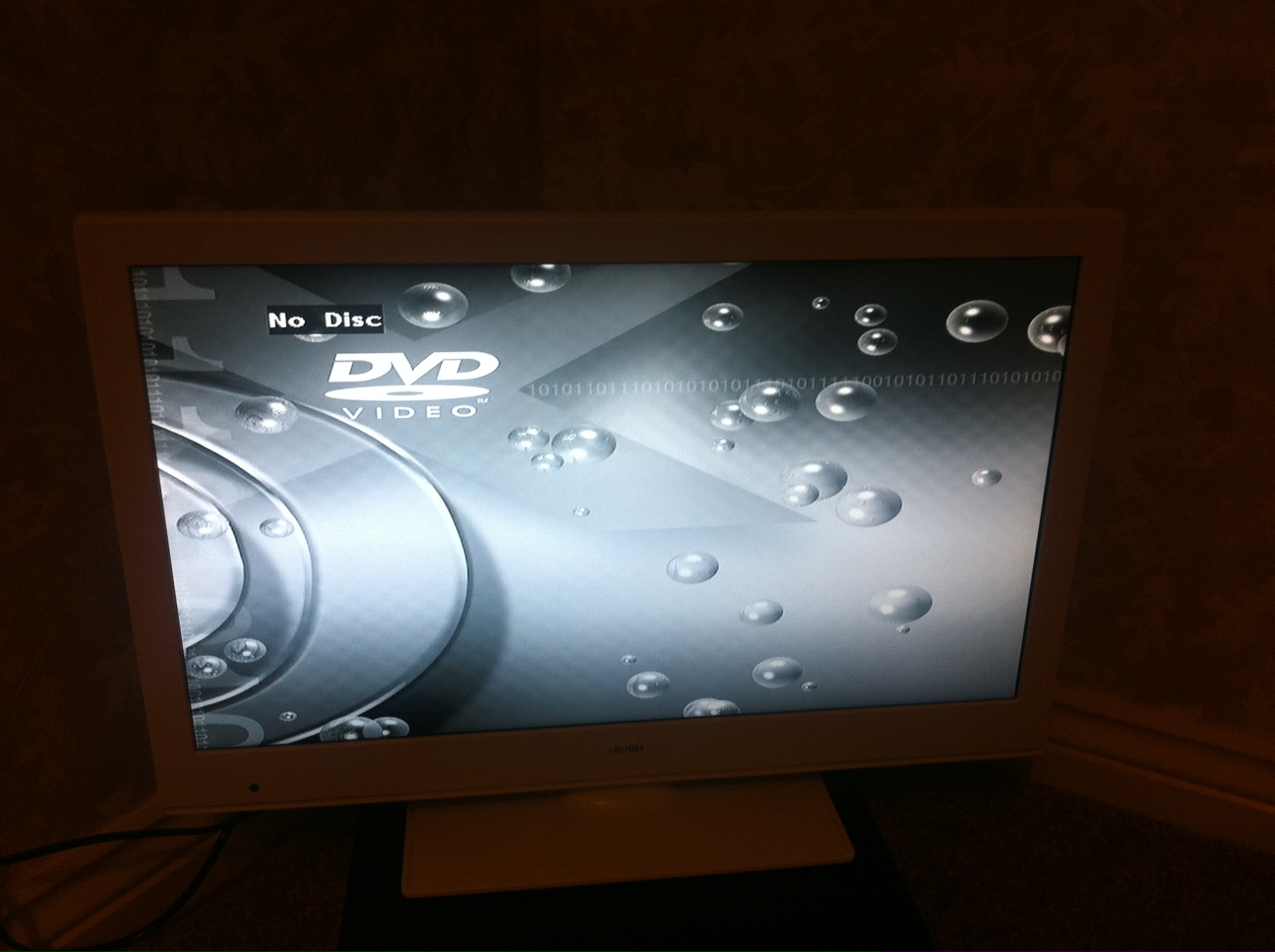

      Yes but also the Picture is completely Black and White
      Whatever DVD is played
      All the DVD's are Region 2
      I will get a Photo of when the TV is playing a DVD in Black and White and when the TV is in Colour

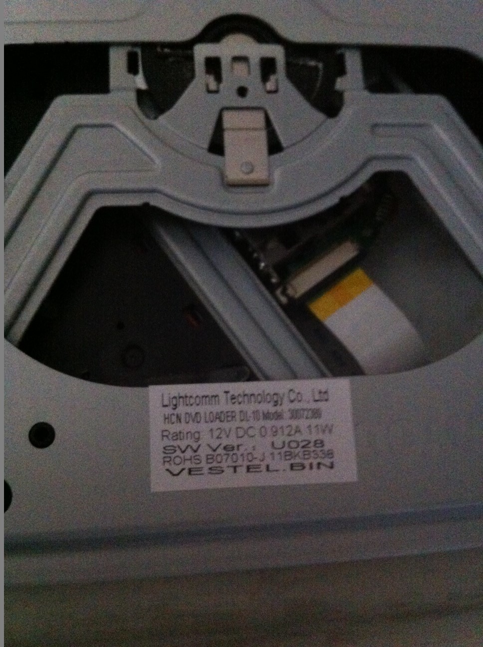

        Photos of the DVD loader

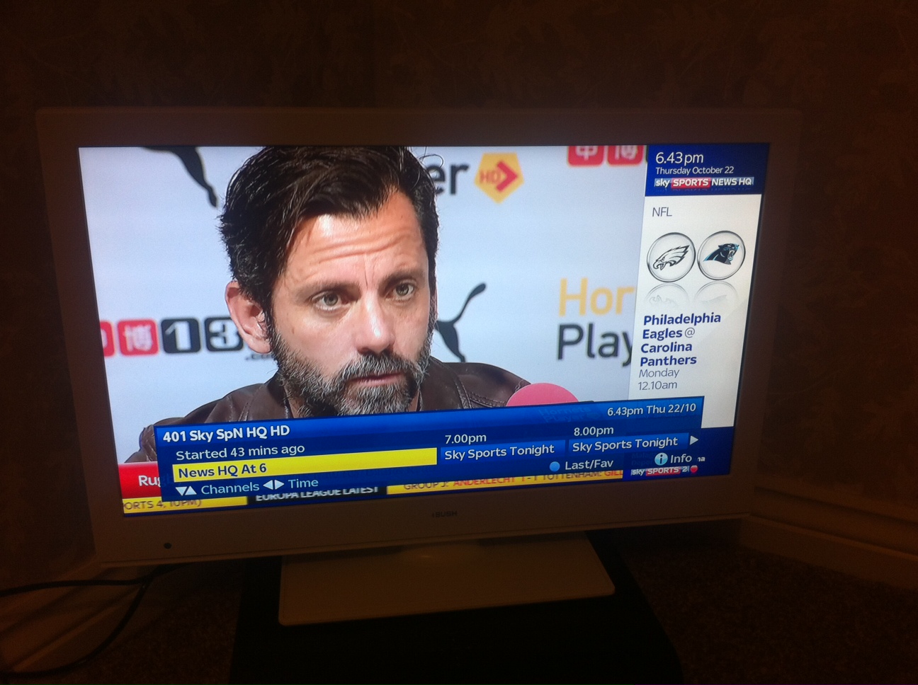

        Also the TV on Sky/TV Input
        Also the TV when using the DVD

          Hmm Vestel trash I see, the particular Dvd rom used in that tv is prone for the Epprom Ic on it failing and casuing the player to act goofy. Whats the full model of the Dvd player please ?

            Thanks, hopefully this is the correct info
            Is it worth buying just a replacement DVD Loader?
            Cheers
            Lightcomm Technology Co LTD
            HCN DVD Loader DL-10 Model Model 30072389

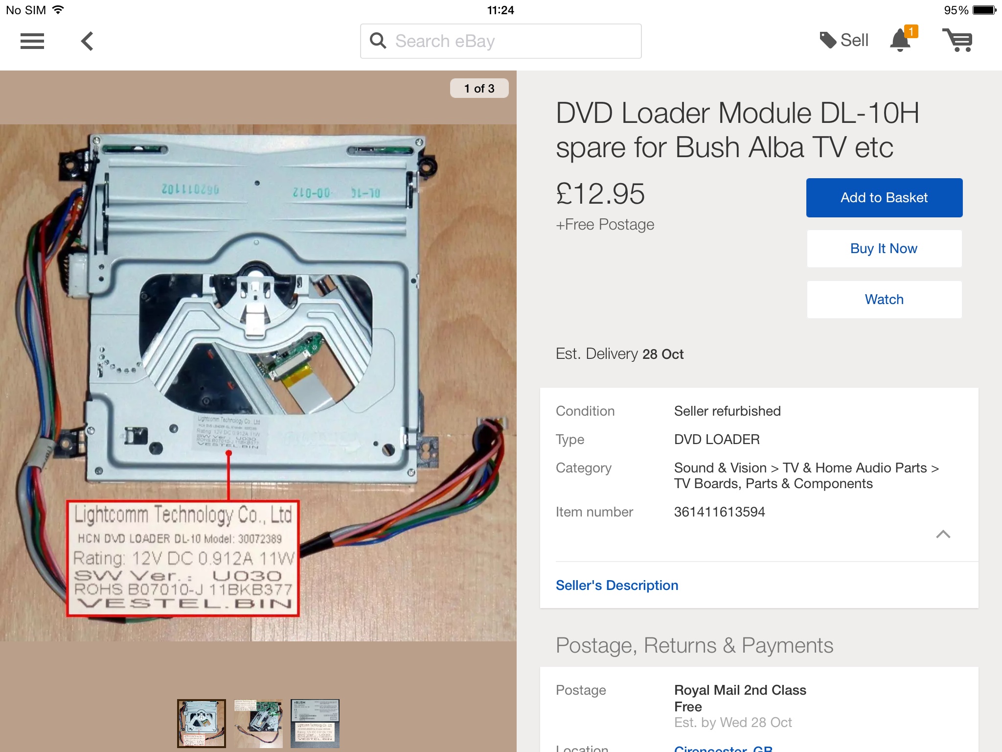

              Re: Bush LED24127FHDDVDW White DVD Combo - Plays Black and White DVDs
              Hello no worries glad to help
              I have found a replacement drive item number is in the photo, however I don't think its worth that tbh unless you are planning on selling the tv and would benefit (profit wise) from it having a working drive. These are just so unreliable and wont last any longer than the original. I have seen too many fail with similar issues.
              Its up to let us know what you decide to do. Cheers
                Hi ReeceyBurger123
                Many thanks for the quick reply
                Totally understand the TV is rubbish
                I need to replace the Drive as it is for my Son's Bedroom and they watch DVD's
                So i will take a punt on it and hopefully it will last longer than the last one
                The last one has lasted nearly 3 years, so if I get that amount of use from it would be great
