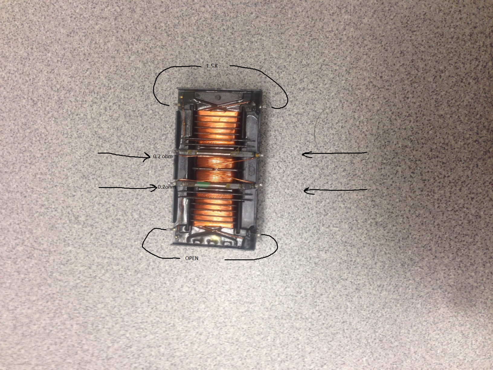

    Found Samsung LNR328WX/XAA thrown in trash. After powering up backlight lids for about second or 2 and shuts off. The backlight board part number 19.26006.104 appears to have one bad transformer. It has marking 4001K511010 (GP). Can anyone point me where to purchase one of these. Boards are also available but I would like to repair board just for fun.

    What resistance measurements do you get on the bad transformer?
    These used to be cheaper as I bought one myself. Something like $6 or $7 USD + free shipping, but prices have gone up significantly.
    Only two sources that I found. It might be cheaper to buy the inverter board and have spare transformers?
    $15 USD + $5 s/h (used)
    http://www.ebay.com/itm/151456908758
    $21.99 + whatever for s/h
    http://lcdparts.net/TransformerDetai...ProductID=2725

      Re: Samsung LNR328WX/XAA
      Pin out and the resistance:
      http://www.shopjimmy.com/auo-19-2600...t-inverter.htm
          Thanks for your help. I ordered replacement board since it is cheaper then just buying transformer from China for $20. The one side of transformer is completely open while other side reads 1.5K. See the picture of transformer removed from circuit.
                  Received the board and got it running. Thank you all for your help.
