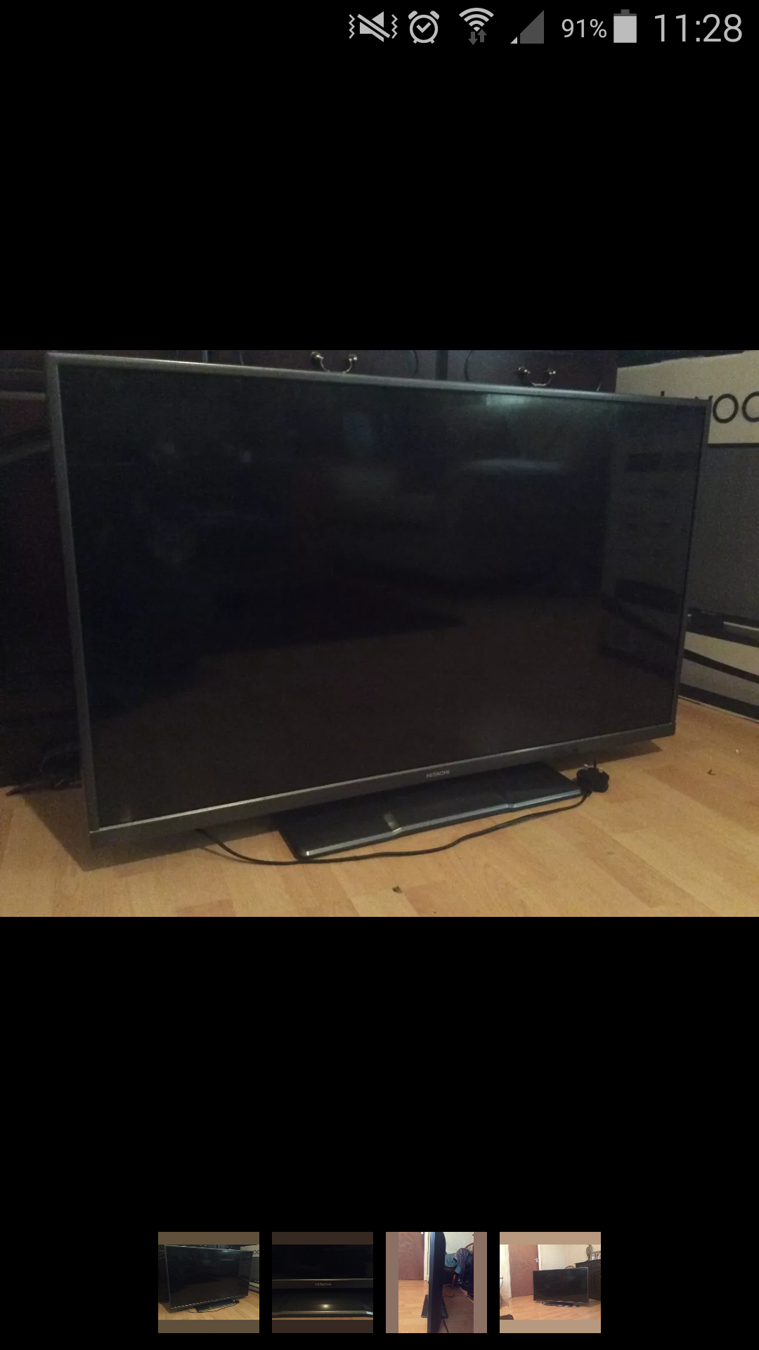

    Hitachi 42hxt12u
    Hi i have this tv its getting no back light but the tv is on iv checked the power going to the back light and im gettin 117 volt to the back light board is this right its led

      Re: Hitachi 42hxt12u
      We need MUCH better pictures of the whole back side of the TV so we can see how all the boards are connected and then good clear pictures of the board and where you took the Voltage measurement.
          Its not a real Hitachi but a rebadged Vestel shit. Uses VES420 Led backlit Lcd panel. You probably have a blown Led with in the panel. But you need better images so we can HELP you diagnose the fault.
