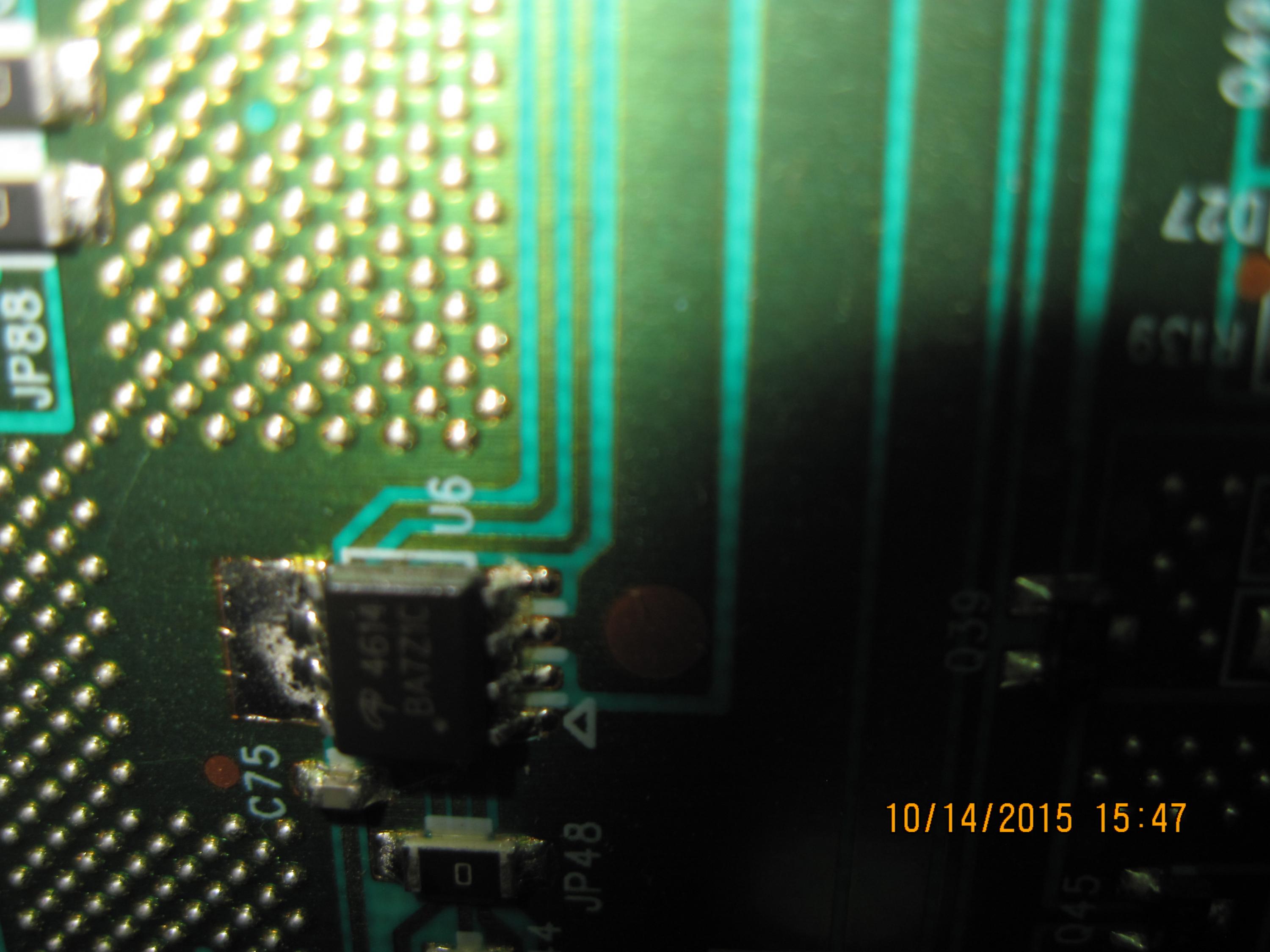

    This set has a backlight issue. it has a picture for 2 seconds then goes black. It has sound. I found fuse 102 on the long board on the leftside to be blown. Any suggestion?

      Test the Mosfets that run the vertical length of the board you will probably find some shorted.
        Re: Sanyo dp42647
        You have two inverter boards, Master and Slave.
        http://www.shopjimmy.com/catalogsear...=Sanyo+dp42647
        You need to get the P/N of those 8-PIN Power MOSFET (there are 8 of them in the MASTER Inv BOARD) to check the resistance between S and D pins.

          hey thanks guy I found one of the mosfet short. Is it easy to replace for someone with avg. soldering skills.
