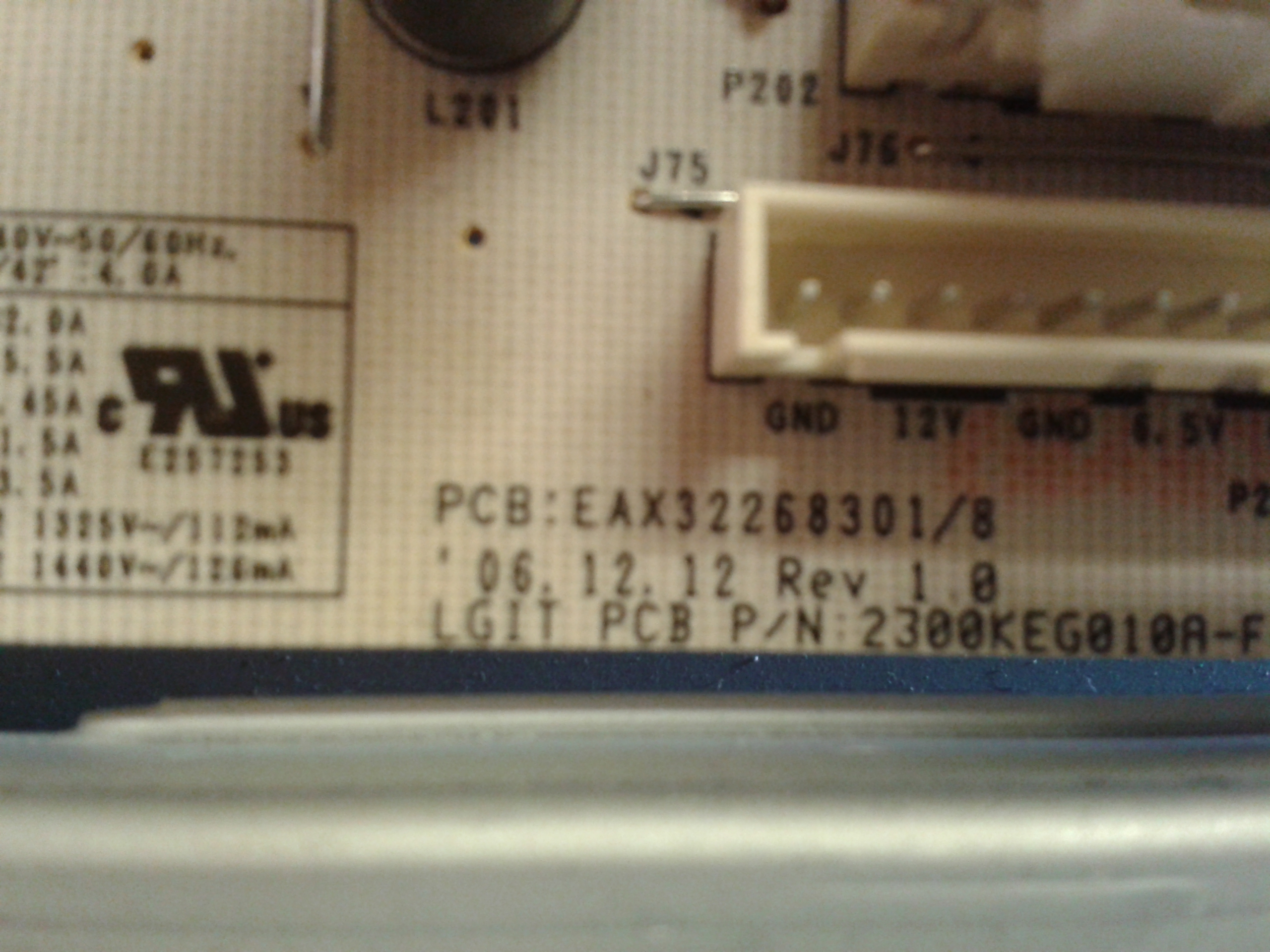

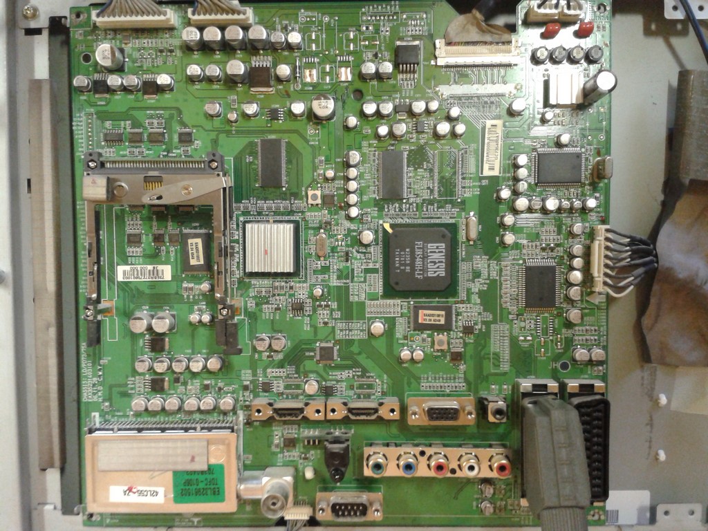

Now I am by no means a technician. Computers I'm ok with. Trying to help a friend.

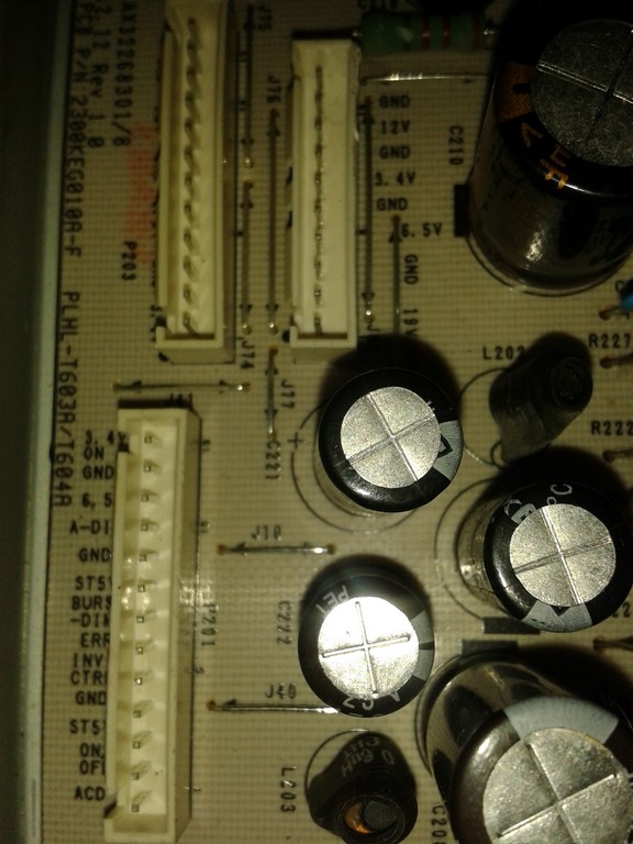

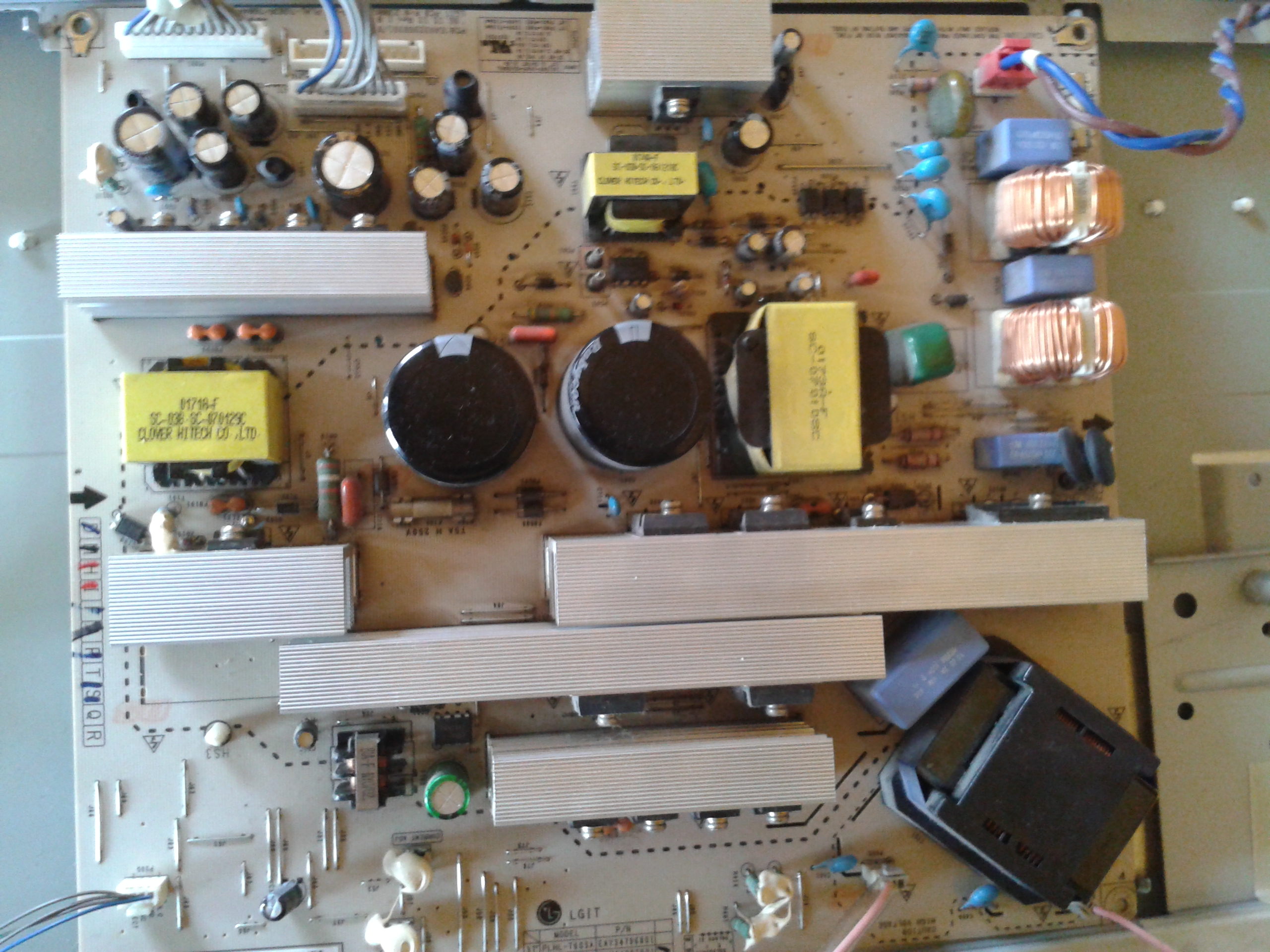

I have changed all the bad capacitors on the PSU board (7 in all). Checked and checked the soldering and it all looks fine.

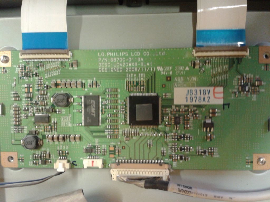

The said TV works ok for twelve minutes from cold, then picture goes off and sound remains. It switches on or off fine. I have replaced the P S Board (reputable second hand spares company) and the problem is still there. I have also changed the T-Con board. I have read most of the other forum posts relating to this problem but haven't found anything else I can try or a solution. Any help/suggestions would be appreciated.
Thanks Jimbo
