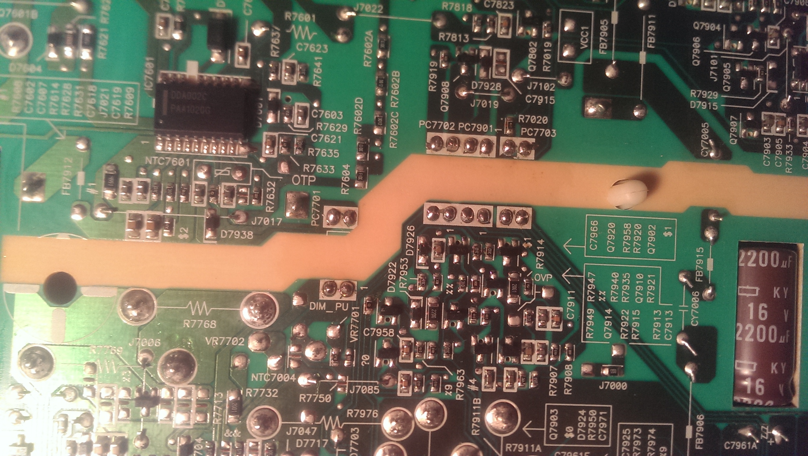

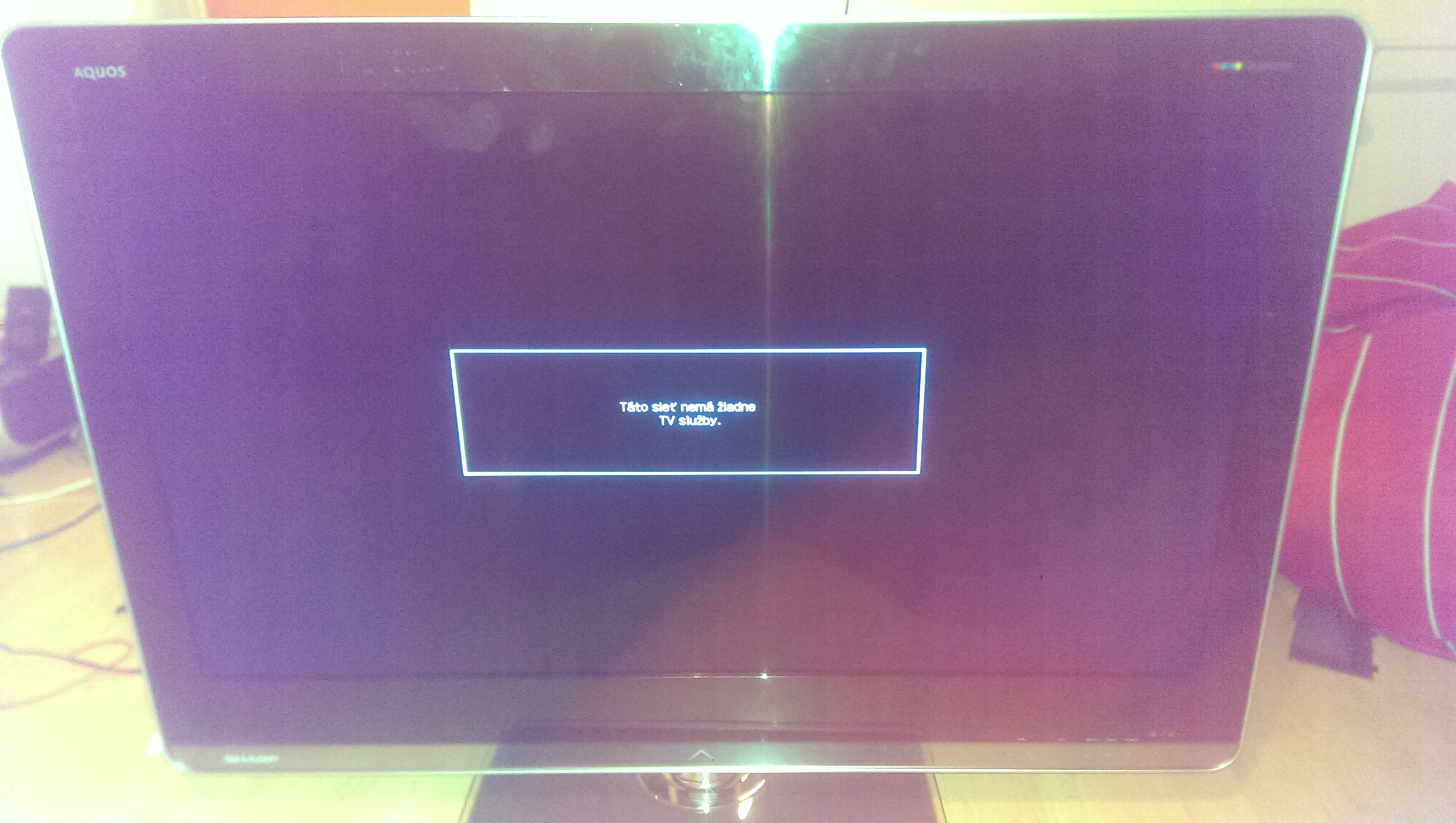

    Wow. You guys are awesome ! Real professionals.
    I took out pin 9 - AC-DET an just plugged it next to pin 11 - 5v. Without any soldering. It's just touching and TV has started up. Everything seems to be working.
    I will test it tomorrow. If you want, I can make some measurements for you. Is there anything that I should check before soldering it? I will also keep that 68k resistor and optos for future.
    /edit
    I added quick photos I will post more, when You allow me to solder that.

      If you do not restore proper function of the AC-DET, you will risk EEPROM corruption. Your TV will have similar function to that of a brick.
        #43
        Re: Sharp aquos LC-40LE810E
        Glad to hear, so now we know that it is the AC-DET failure only, so it is either the resistor for the circuit is marginal or changed in value (goes higher resistance), or bad opto per suggestion by other members.
        The purpose of the AC-DET is not to allow the TV to come on if the AC Voltage feeding the TV is too low, so right now it is the protection circuit is causing the fault due to its own failure.

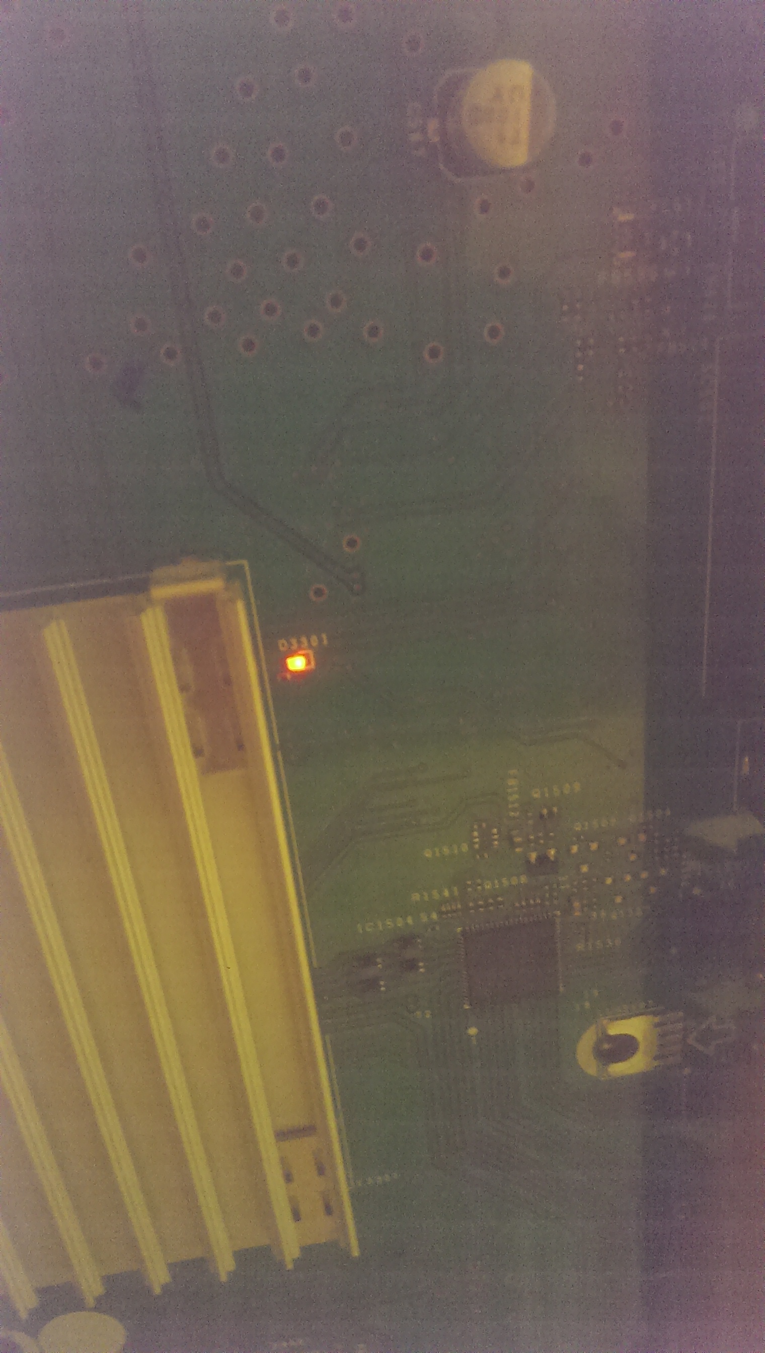

            I was celebrating too soon.
            I changed all optos. Measured all pins...getting same voltage on all pins like before. Tried that magic trick with resistor again, but this time tv didn't turned on. Not even led. Just red led on mainboard.
            I put all original optos back. Same... Red led on mainboard. When start without that resistor trick, tv is still flashing with same error.code. getting same voltages. Just resistor trick doesn't work anymore.
            Could I burn optos? Or I really screwed something? I will send you photos tomorrow, I am sad and tired, so I am going to sleep now. But there weren't any cold joints, bridges, used flux, everything seemed nice.

                "I took out pin 9 - AC-DET an just plugged it next to pin 11 - 5v. Without any soldering. It's just touching and TV has started up. Everything seems to be working."
                The AC-DET signal is normally tied to the supply via a pullup resistor. By connecting pin 9 directly to the BU5V supply pin, you would have impressed the supply voltage directly onto an MCU GPIO pin. This is not always a safe thing to do.
                Edit: IC2002 is powered from BU+3.3V, so impressing BU5V onto its AC_DET pin would have resulted in latchup without any current limiting. I could be wrong, though.

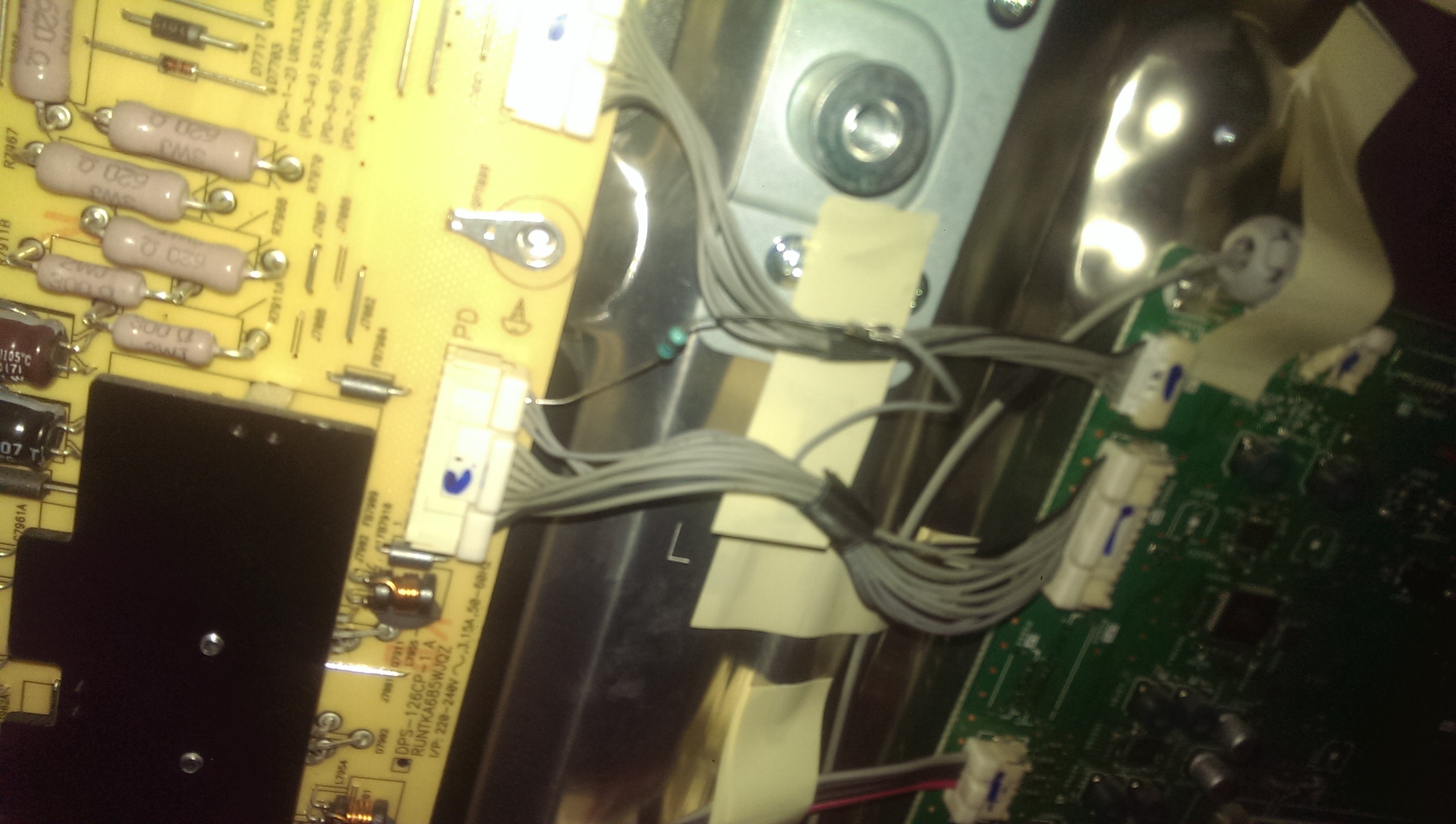

                  Here are photos, after I changed all optos. I noticed they are not same brand. 2 of them were sharp and 2 of them different. Also I checked if I am fitting them in correct way. There is sign 1 on motherboard for dot in left top corner. Also there are marks on side and motherboard like half circle. So I am sure I fitted them correctly.
                  • Nightmare0
                    • Oct 2015
                    • 39
                    • Slovakia
                    #49
                    Here are photos after I put all original optos back. You can check, they are in same position. I added photo from shopjimmy so you can check they are really in proper way. Also photo of that red led. Red led is not still on. It is flashing like: maybe 20 seconds on, off for few seconds afaing 20 seconds..... after few flashes, led will turn off and nothing else happens.
                    I was not using TV with this fix. I tried that once, when I first tried for maybe 30 seconds until I took photo.
                    After opto change, it started to act like that. So how bad is it? All pins have same voltage. If you need more info just let me know.

                            The opto for the AC-DET is PC7703
                            • rievax_60
                              • May 2012
                              • 897
                              • australia
                              #54
                              I made a mistake before. PC7703 is the lower one.

                                        PC7703 legs 3 -2.1V and 4 -4,9V
                                        Should I solder that 68k resistor on top of other now?
                                        • rievax_60
                                          • May 2012
                                          • 897
                                          • australia
                                          #60
                                          Yes, solder in the resistor. pin 3 on the opto needs to be well over 2.5v.
