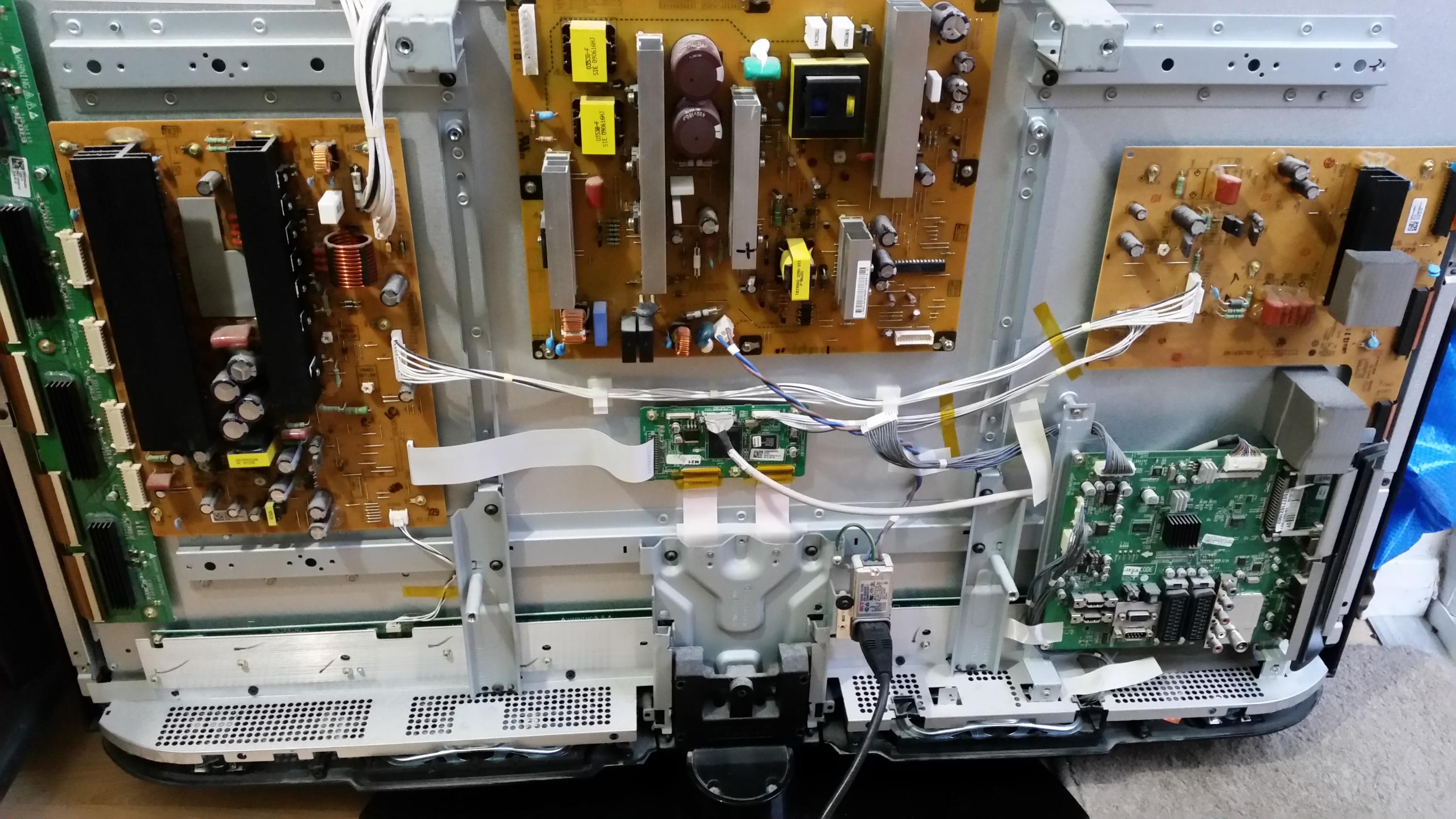

    I have a LG 42PQ6000 seems to be stuck in standby
    after plugging in to the wall the only thing you can get is a rapid click (twice a second) from the main power board.
    If I disconnect the X/Y boards it makes no differance, if I disconnect the main AV board the clicking slows down (once every 2 seconds)
    TV does not power up
    X is connected thur the YSUS
    Board numbers are
    Power: EAY60696801
    AV: eax57566204
    Y: eax60764001
    X: eax60764101
    If anyone can help it would be great,?!? I have replaced a few compontents, as I thought I did not have 5v standby but this has made not effect on the issue of the clicking relay

    Re: 42PQ6000 Clicking fast not powering on
    Posting pictures of the back of your tv showing the boards with clear pictures may help you more with fixing your problem
      Common issue a the stby Diode shorting is something like Vb3200 check that.
        Here is a pic of the back of the TV.
        Not sure what you mean by VB3200?
          Vb3200 is the model of the diode, do you have a DMM and do you know how to check for SC ?
                  found a diode marked VSB3200 shorted out. can this normnally be replaced, or is the short often casued by something else?
                    Normally just the diode replace it and away you go Common issue on these sets, repaired two previous ones and was just that diode.
                      cool, parts on order though various websites have different part numbers for them including
                      UF5408 (VSB3200 / RGP30) DO-201AD Diode 1A 1000V from ohmsupplies
                        You will need a VSB3000 that will work.
                                        Ohms Supplies Ltd are a local UK supplier. LoadedlboyUK didn't come back on the thread so perhaps it worked for him.
                                        He indicated UF5408 (VSB3200 / RGP30) DO-201AD Diode 1A 1000V
                                        But I don't know if it is a replacement for the VSB3000 which I can't find anything on.
                                        update for you guys, took out that diode and put in the UF5408 (VSB3200 / RGP30) DO-201AD Diode 1A 1000V from Ohm supplies and it was a success so for anyone else having the issue if the diode is goosed then change that and away you go.
                                        thanks guys.
