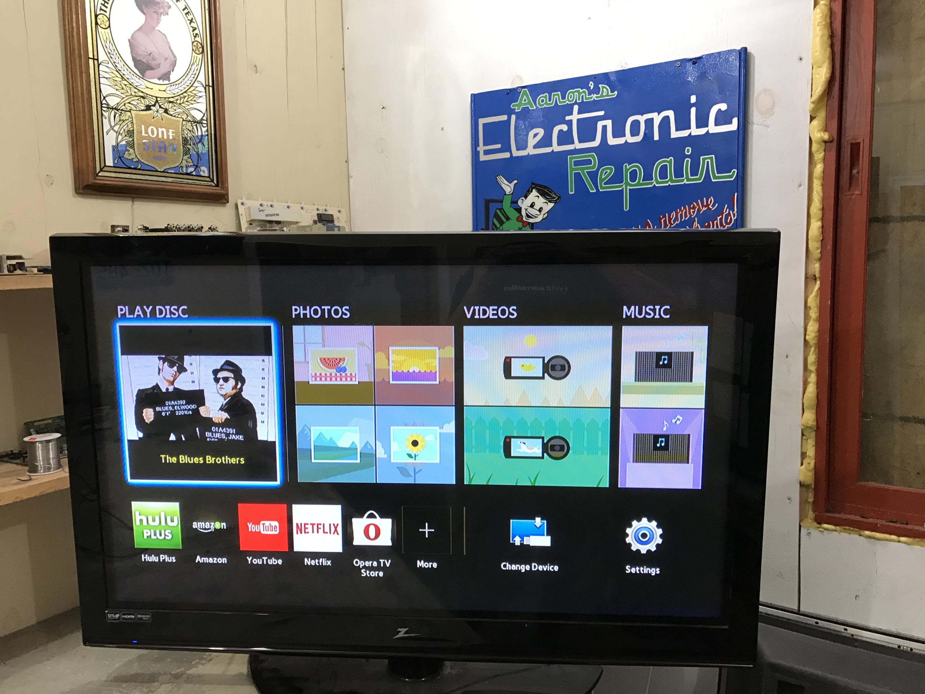

    Just wanted to post a thank you for this thread. I had a Zenith Z42PQ20 with this power supply. It was exhibiting the rapid clicking upon plugging in which brought me to this thread when I searched. Immediately checked the diode stated here and found it to be shorted. Swapped it out and the TV is back in business.
