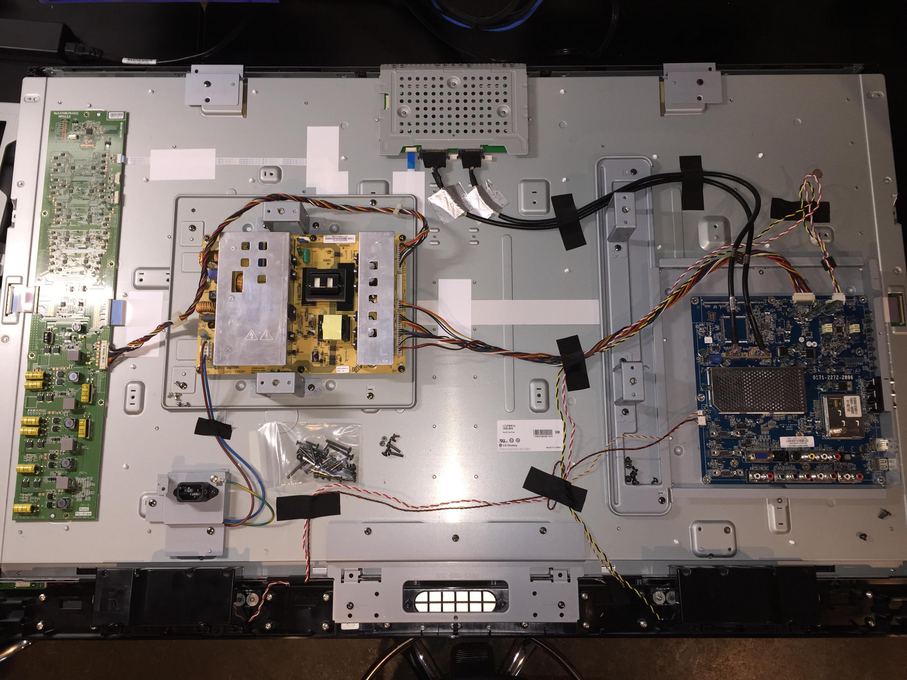

    With TV is plugged in and NOT pressing the power button, PSON already has 3.16v and the PS is switched on providing 5v, 12v, 18v, & 24v. The power switch is not stuck closed and is showing 2.29v across it when pressed.
    Although the PS is switched on, there are no backlight or picture present, just a dim white Vizio logo. The picture and light may be a separate issue? But why is the PSON signal always on?
    Thanks for any help!

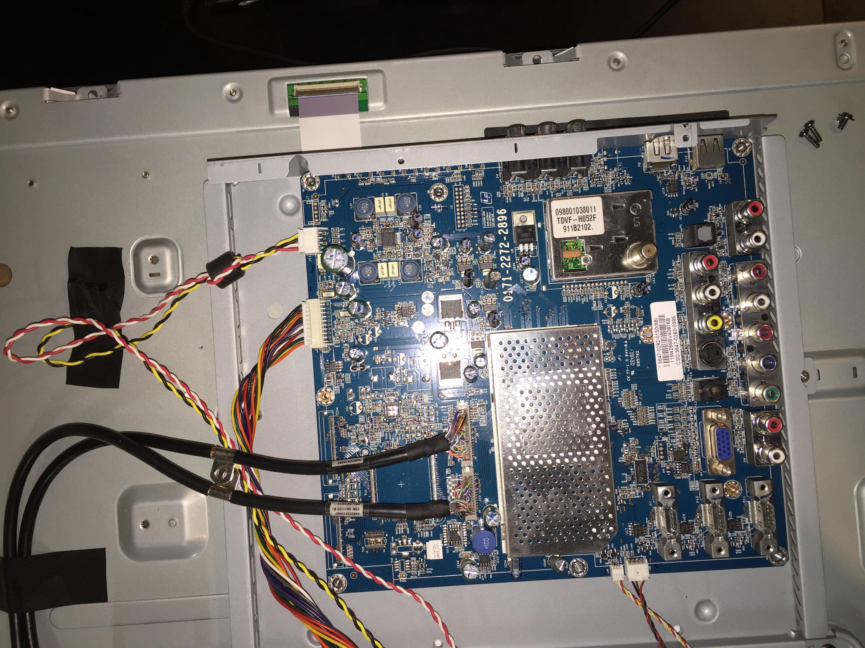

    Main Board
    F1 5.10 5.12
    F2 12.02 12.02
    L271
    G9117
    U2 2.05 3.30 5.10
    U4 0 1.24 3.30
    U6 6.86 8.11 12.02
    U7 2.06 3.32 5.08
    L391
    G1084
    U3 2.05 3.30 5.08
    U5 2.04 3.29 5.08

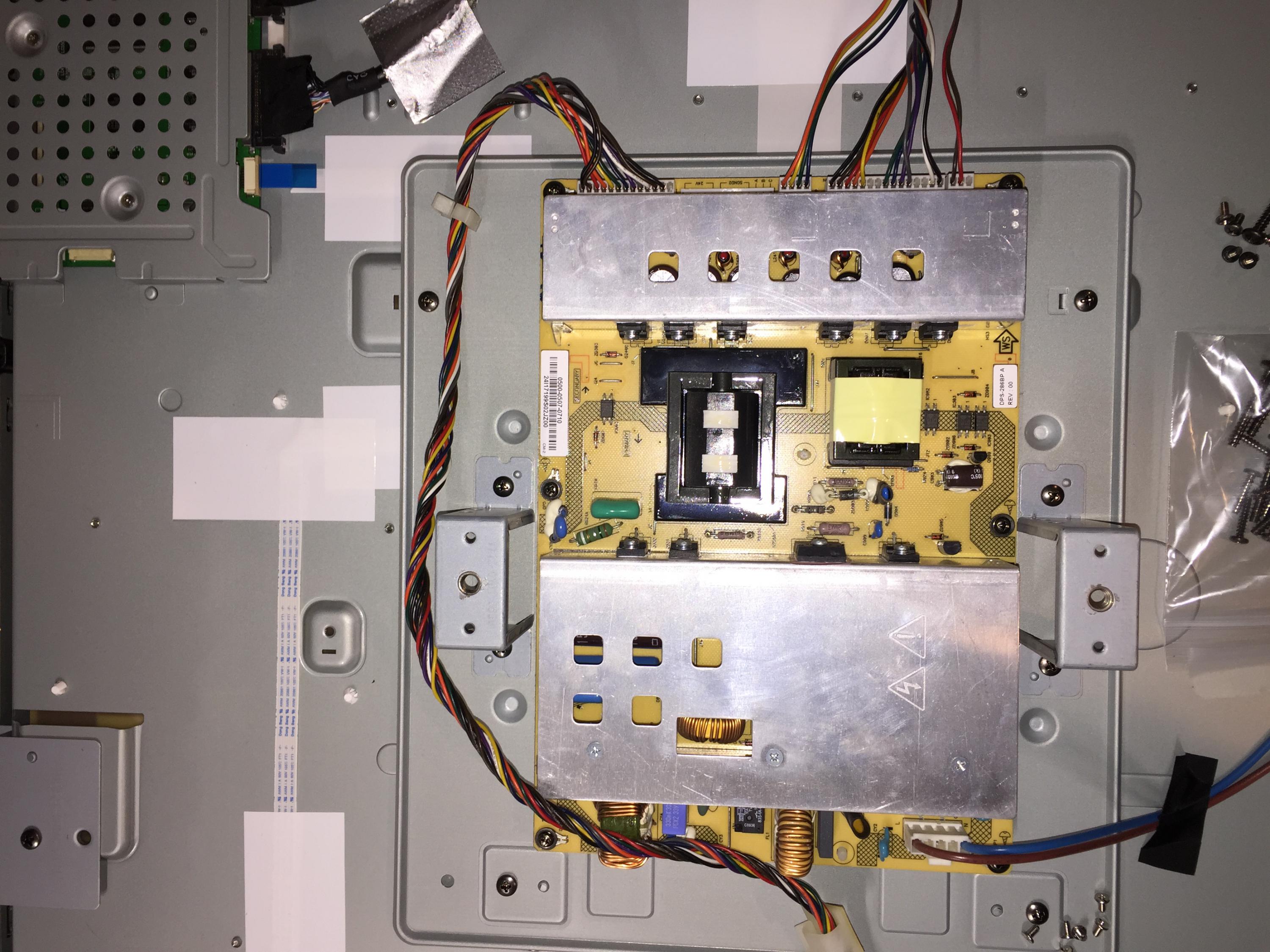

    Power Board Connectors
    PSON 3.16
    +5VSB 5.16
    12v 12.02
    18v 18.16
    24v 24.31

    Follow up info:
    L354
    G1084
    U9 (backside of mainboard) .55 1.81 3.29

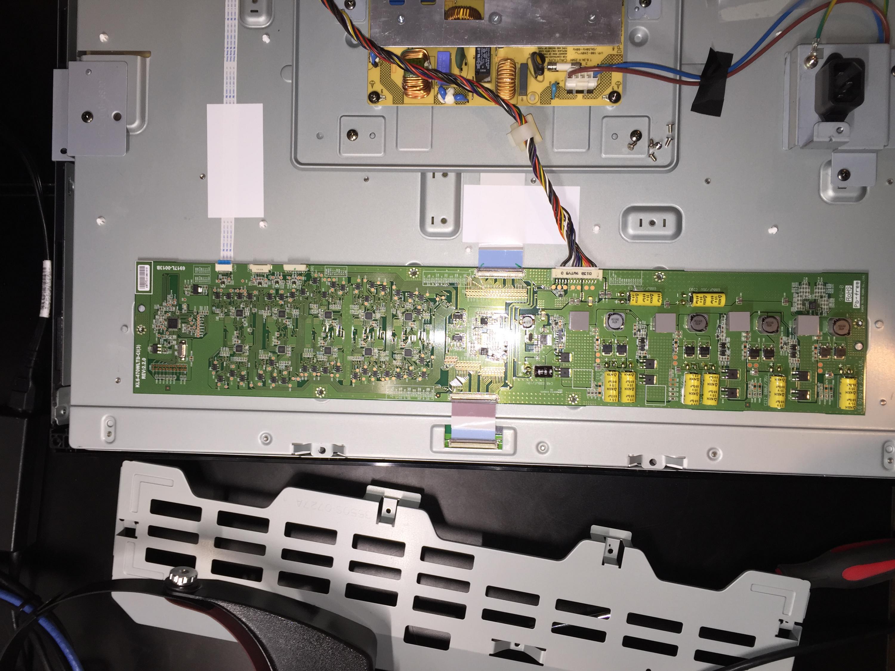

    LED Driver board
    Both main fuses good and passing 24.3v

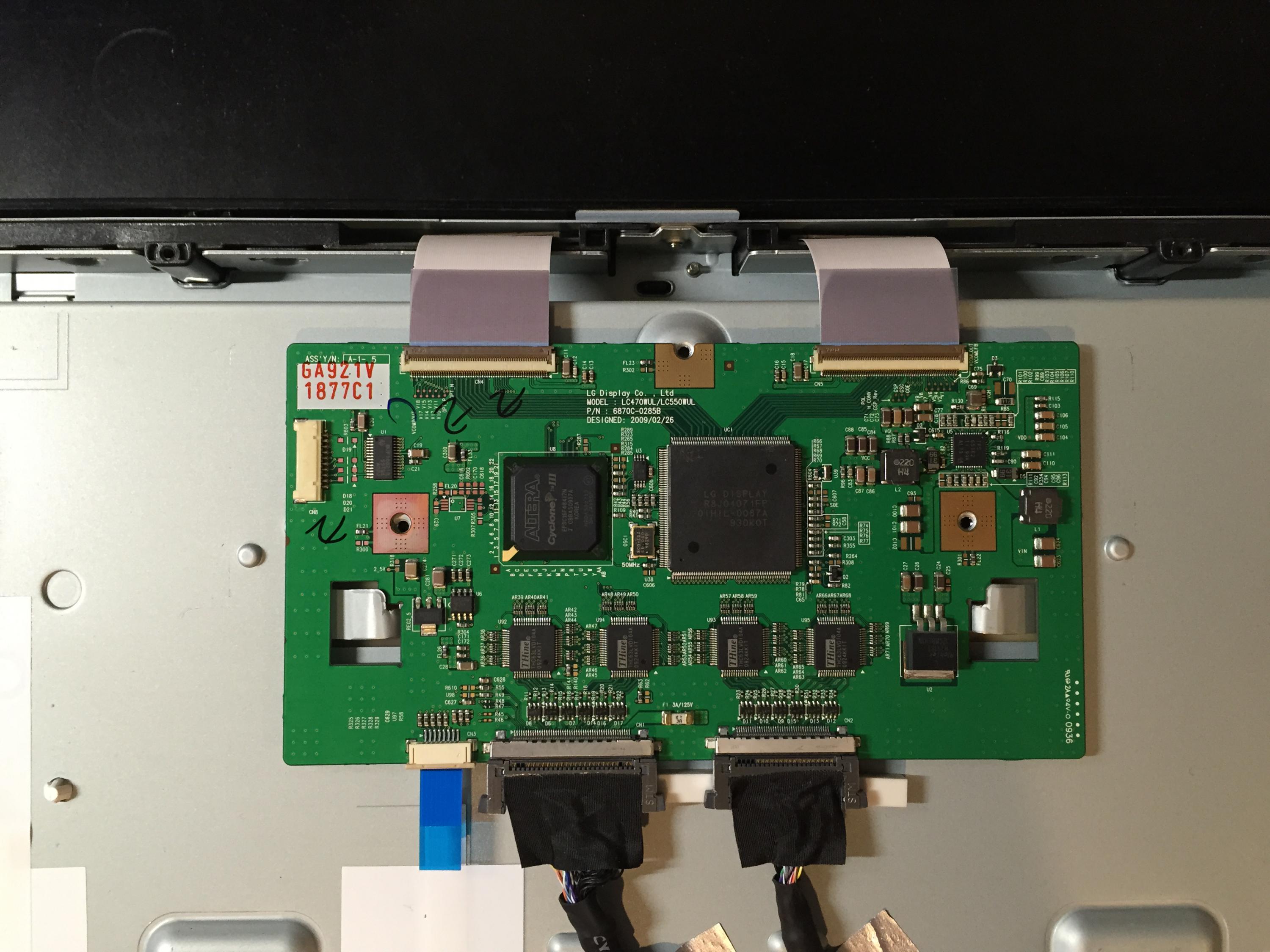

      Set aside the PSON always on and further diagnosing the no picture finds that the T-con board is getting no power. Following another thread on here (thanks jasonpeters!) I found U33 not turning on. Jumpered with a resistor to GND it turns on and now have 11.9 to T-con, but no difference...no pic or backlight.
      Has anyone had the issue with the PSON being activated as soon as you pug the TV in? Can someone point me in a direction to start figuring that part out?
      T-con Board
      Main Fuse - good (11.9 v when U33 on)

        Unless you have the diagram for this main board then it will be real hard to troubleshoot down to component level as you see in the other thread (https://www.badcaps.net/forum/showthread.php?t=49276).
        May be it is EEPROM problem.
        Beside PS-ON is stuck, you also missing the BL-ON, the On command for powering the T-CON, no LVDS signals feeding the T-CON.

                Just for the record, most of the times when a main board starts automatically (BL_ON activates almost instantly) 99% of the time the problem is in the main processor, which never actually starts up properly.
                Seen it happen many times on various boards and for some reason always with MediaTek MT processors as opposed to, say, the Broadcom BCM ones.
