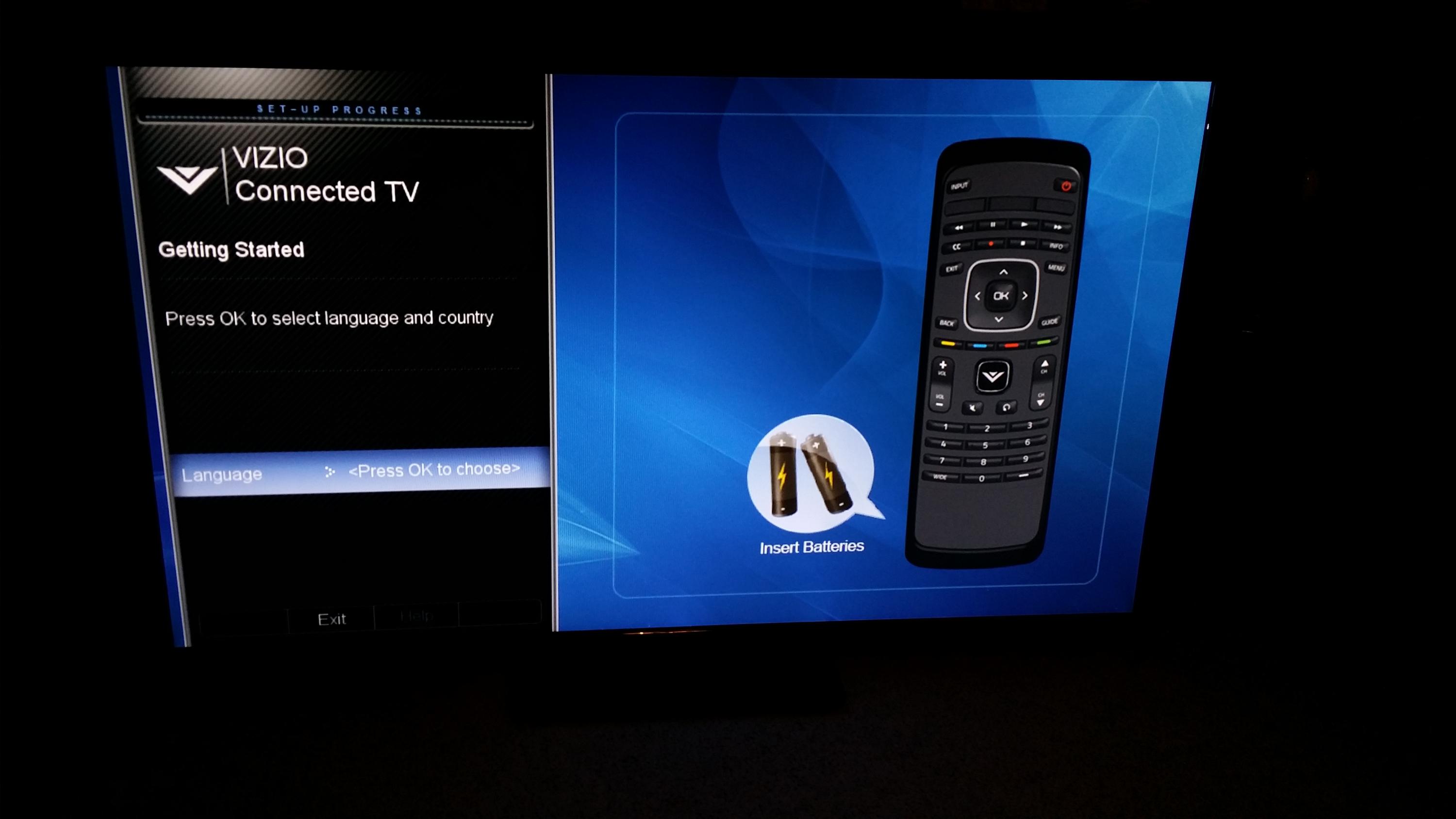

You also need to double check the cabling leaving the tcon to the panel, especially the one going to the same side as the vertical lines. If the cabling is OK (clean the bare cable "pin" surface with some alcohol), and the vertical lines still remain, try another board. From my experience, when a tcon cable is not connected, and one "brushes" their finger lightly across the corresponding tab cables at the bottom of the screen on that side, you can cause those vertical lines to readily happen. So it more than likely you have some form of "open" connectivity on that side or broken tcon card.
If fact, if you do the "remove tcon cable" test (one cable connected, other removed) on the other side, the same vertical lines will appear.Comment
Re: e701i-a3 no picture but backlights
So bud you mean check the cables going down from the t-con? So disconnect all connections,wipe with alcohol, then reconnect- I assume you mean bottom boards and right side LCD drivers? Then do the t-con test…Comment
yes those cables especially since you have been taking them on and off alot between swapping cards in and out.
As for side... from the "V" picture, it is the left side of the screen, looking from the front, then on the back side, the right side cable.
Further, I would bring up the menu screen to help with looking at something that you would expect to see along with the fact that text stuff is easy to quickly determine whether things are good or bad.
You can take turns connecting and disconnecting one of the 2 tcon cables (ie. one for each side of the screen) with power off during the disconnect / connecting and look at the screen for changes.
I suspect that you have a tcon issue currently / still.Last edited by budwich; 10-23-2015, 09:48 AM.Comment

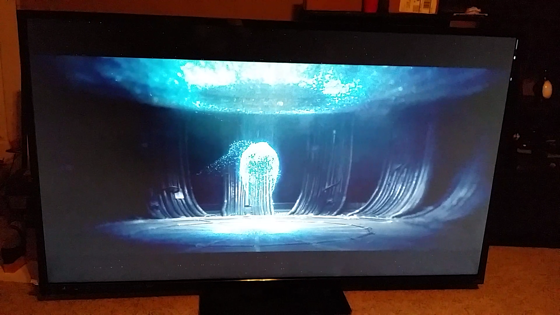

Well I disconnected the bottom ribbon cables both sides and cleaned them with alcohol and the right side boards patch cable and bottom cable, swapped out another t-con then plugged in and shizammm a picture for the first time but the only thing is the audioa dosent work- only bleeps of audio for a second here and there- I disconnected the speaker cables going into the main board- no change- could this be a t-con thing also? Thanks for all the help!Right. Like we cleared one problem but now we have to look at the next
Don't touch the right side tab drivers. The more you move them the more chance it have a break in connection. The only thing you need to check is replacing the t-con board to start see if the picture changes. We'll go from there.Comment
Awesome man congrats! Another "operation " completed. 2nd vizio I know of besides mine now.
Your audio problem is probably a processor ic problem on the mainboard. Did you have audio before?Did I leave the soldering iron on?Comment

You need to try different cables, different input ports. Audio on hdmi is carried on a different pin (I think)... so you can have picture and no audio but the decoding is reliant on the protection bits being properly "computed" (ie. hdcp stuff). Further, if you have an over the air antenna feed, that would be best to check things out further.
My guess is you have some bad pins maybe on the port. My sharp set's hdmi ports were "weak" as there is no strain relief provide by the set and the owner's cables were heavy and stressed the ports.
Further try some analog rca's to see if they work.... and go from there.Comment
You know I did forgot the unplug the chromecast dongle into the HDMI 2 port and when I went to lay the tv down again on the base I made to remove the stand, it popped out the plug from the wall so now it could be the HDMI port on the main board- I didn't try another and this was the only source I tried last night so it could also be now the cord on the chromecast dongle. I'll scope it out I'm sure it's an easy fix. Those transistors were key since the the COAXA didn't hold up to the to testing. Anyaay, thanks for your help- if you need any of the transistors let me know I'll send you some I have plenty- I couldn't find them searching online but in China but once talking to an electronics module company on the phone- they found them by model number- Mouser in Texas…Comment

HDMI audio is carried in the blanking interval on the video frame. It's effectively interleaved with the video data and transmitted on the video TMDS pairs.

Cable worked good plugged in to HDMI 1 didnt have time this morning to check anything else. Will be able to tomorrow. Ya the HDMI audio claim is marketing bs. Worse case I could change the port if its bad or a new board. Was it you that had the Sharp issue- if so howd you make out?HDMI audio is carried in the blanking interval on the video frame. It's effectively interleaved with the video data and transmitted on the video TMDS pairs.
