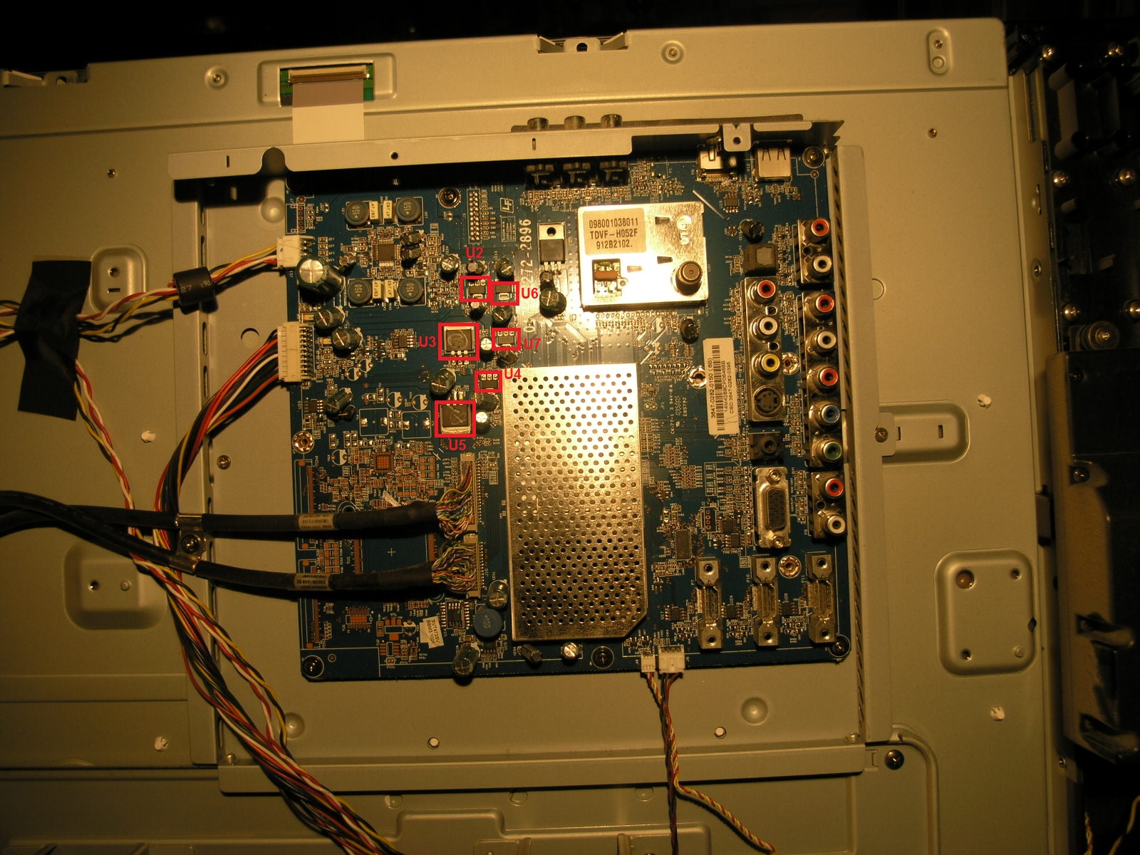

    Main Logic Board
    -- Fuses
    F1 - 5.95v
    F2 - 14.1v
    -- LDO Voltage Regulators (small package)
    Chip Package Markings
    1st Line: L271
    2nd Line: G9117
    Code:
     Pin  3    2    1
        In  Out/Tab  Adjust  Diff(1-2)
     U2  5.88  3.81   2.38   1.43
     U4  3.90  1.46   0.00   1.46
     U6 13.95  9.42   7.97   1.45
     U7  5.90  3.83   2.38   1.45
    -- Voltage Regulators (large package)
    1st Line: L391
    2nd Line: G1084
    Code:
     Tab Up, Left to Right
     Pin  1   2/Tab   3
     U3  2.45  3.93  5.97
     U5  2.39  3.87  5.97

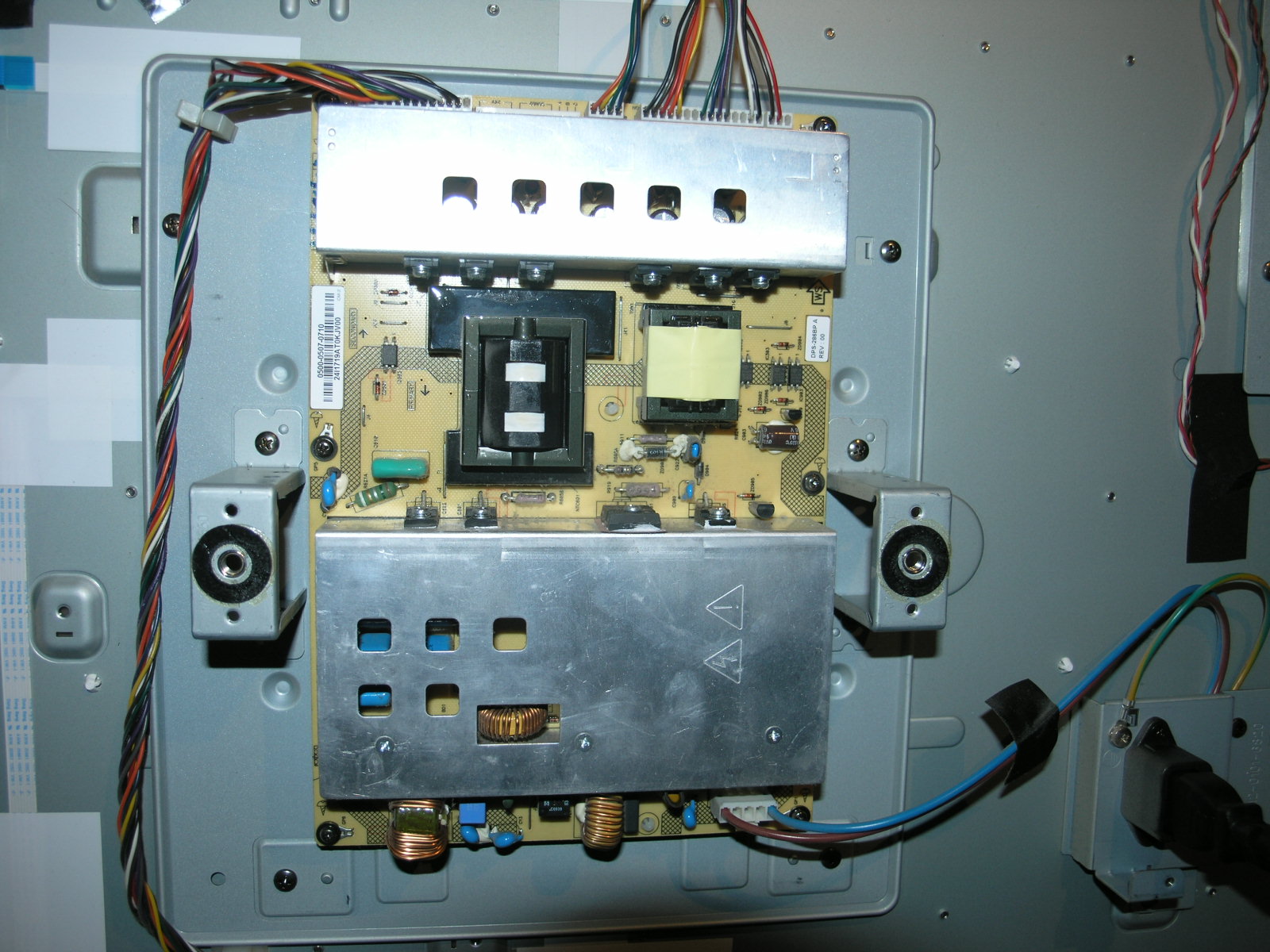

    Power Board
    -- Voltages at Connectors
    Code:
     Label  Voltage (DC) Notes
     A    0.00 / 3.75  Pwr Off / Pwr On
     B    0.00 / 2.95  Pwr Off / Pwr On
     PSON  0.06 / 3.80  Pwr Off / Pwr On
     +5VSB  5.95 / 5.95  Pwr Off / Pwr On
     12V   0.00 / 14.1  Pwr Off / Pwr On
     18V   0.00 / 21.5  Pwr Off / Pwr On
     24V   0.00 / 27.5  Pwr Off / Pwr On
     SGND  0.00
     SGND2  0.00
     SGND3  0.00

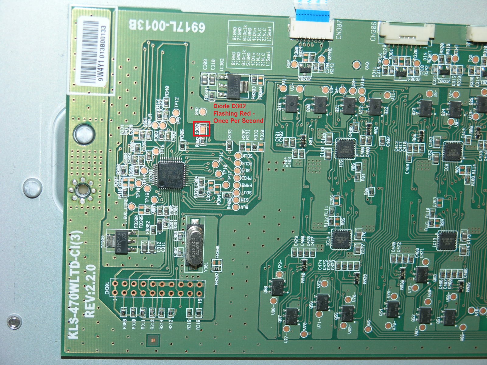

    -- LED D302 is flashing red 1/sec

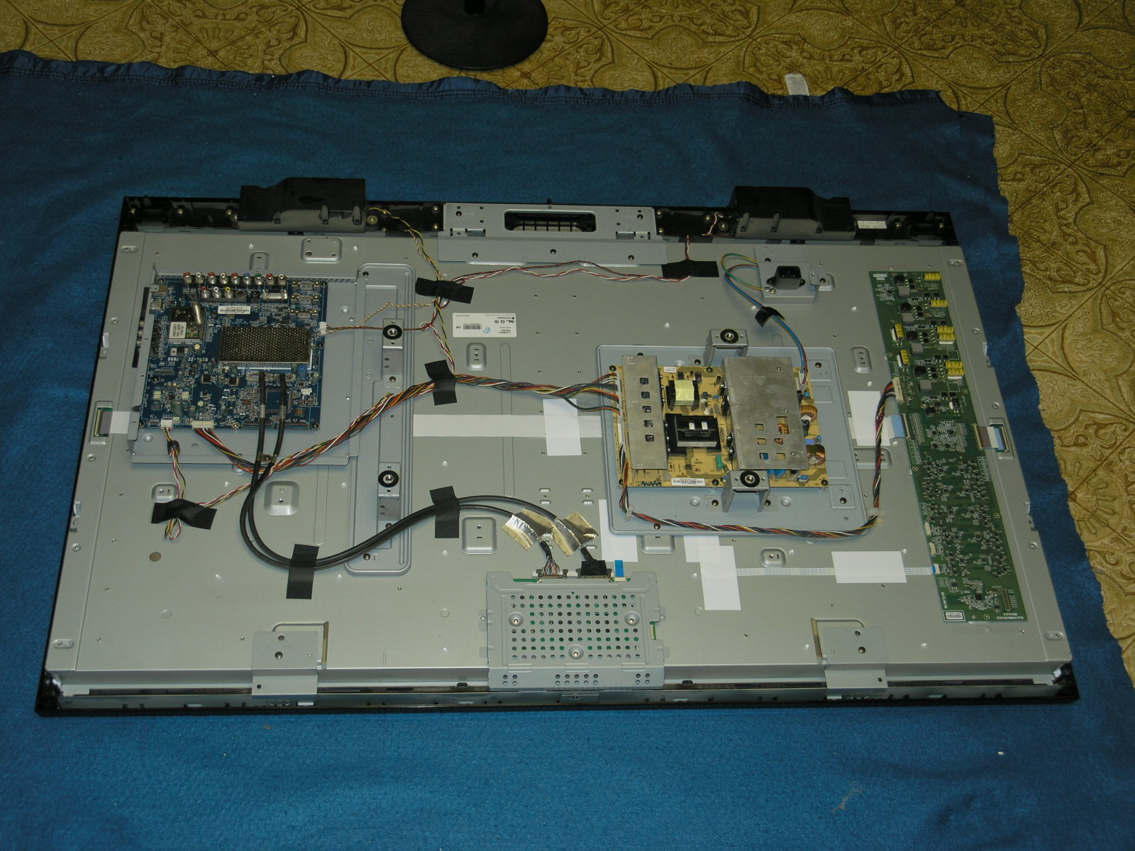

      Symptom: Back light on, no Image, Video, Menu, etc.
        Re: Vizio - XVT472SV
        "or Should I re-read the voltages?" Yes, so far the control Voltages are present, you probably check to see if you do dcv at both ends of the fuse on the t-con board with ref to the chassis GND.
        Also up load the pictures of the whole back side of the TV so we can see the board.

          Main Logic Board
          -- Fuses
          Code:
              Pwr Off    Pwr On
             In  Out   In  Out
          F1 - 5.18 5.18  5.14 5.12 <- Diff = 0.02
          F2 - 0.0  0.0  12.09 12.09
          1st Line: L271
          2nd Line: G9117
          Code:
           Pin  1     2    3
             Adjust  Out/Tab  In  Diff(1-2)
           U2  2.06   3.31   5.12 1.25
           U4  0.00   1.25   3.34 1.25
           U6  6.87   8.13   12.08 1.25
           U7  2.04/2.05 3.29   5.08 1.25 <-- Adj Fluctuated
          1st Line: L391
          2nd Line: G1084
          Code:
           Pin  1   2/Tab   3   Diff(1-2)
           U3  2.09  3.34  5.08  1.25
           U5  2.03  3.28  5.08  1.25

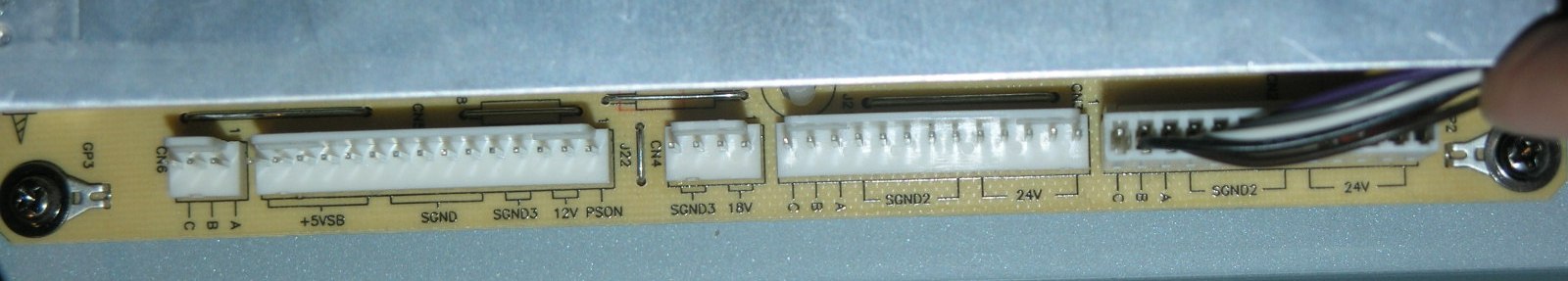

          Power Board
          Code:
           Label  Voltage (DC)
               Pwr Off  Pwr On
           A    0.00   2.62
           B    0.00   3.26
           PSON   0.0571  12.09/12.10 <- Fluctuated
           +5VSB  5.18   5.18
           12V   0.00   12.10
           18V   0.00   18.22
           24V   0.00   23.60
           SGND   0.00   -0.01
           SGND2  0.00   +0.01
           SGND3  0.00   -0.01
            Here is the Rear Side of the TV, all boards visible.
            I already included in the earlier post the Main Board, the Power Board and a partial of the TCON board.
            Did you want a specific board?
              The Voltages are fine now with good running meter so you need to check the Voltage on the SMD fuse of the T-CON board next.
              'T-CON Board : KLS-470WLTD CI(3)' is NOT T-CON board. It is LED driver board: http://www.shopjimmy.com/vizio-6917l...iver-board.htm
              T-CON board is under the metal shield with two cables going to the main board.

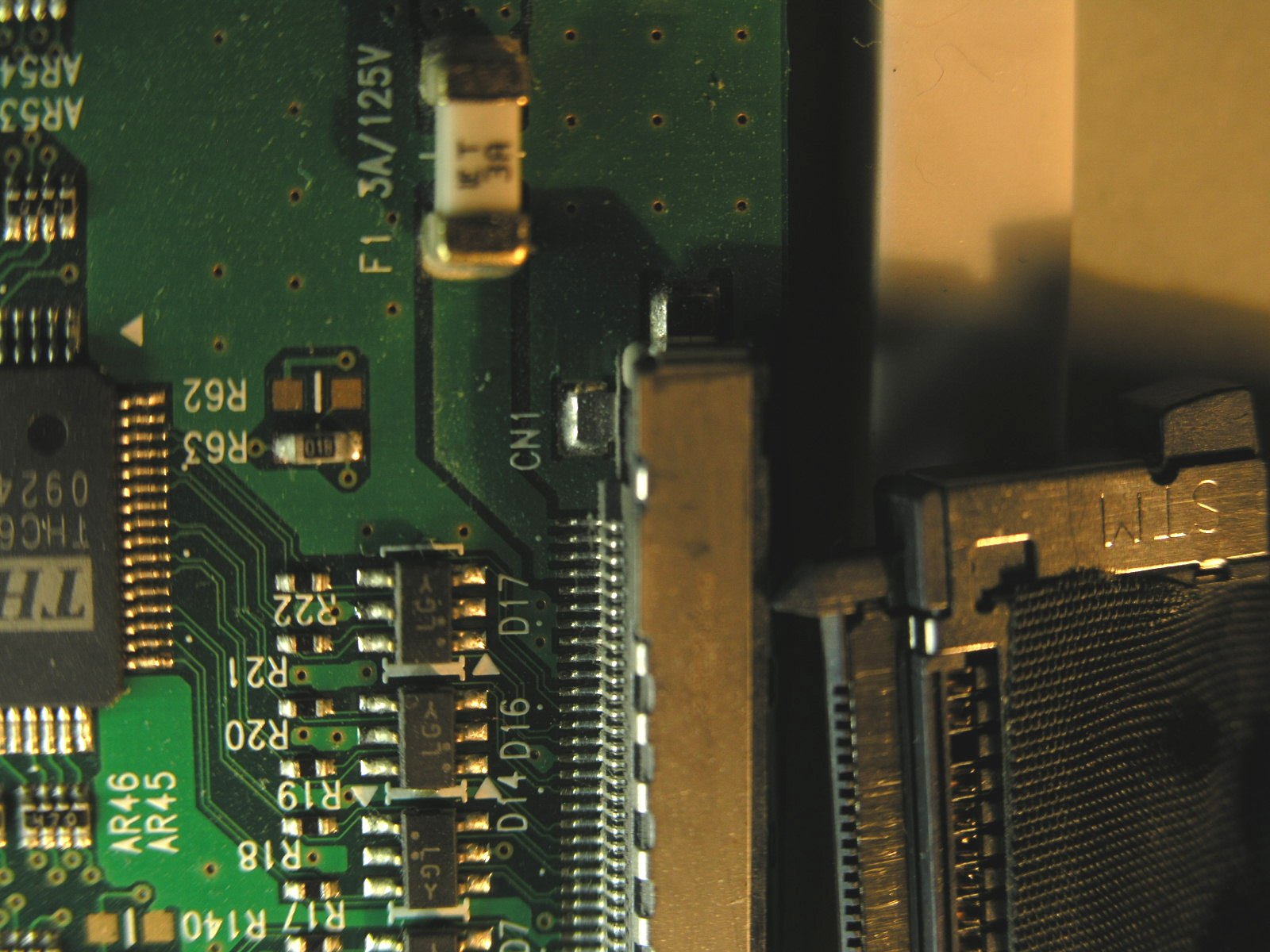

                T-CON Board
                Fuse 1 : 0.25 / 0.25 In/Out
                  There is a white SMD fuse on the T-CON board.
                    It is white with gold ends.
                      Yes.
                        Ok, I read the fuse on the T-CON board:
                        T-CON Board
                        Fuse 1 : 0.25v / 0.25v In/Out
                        Any ideas?

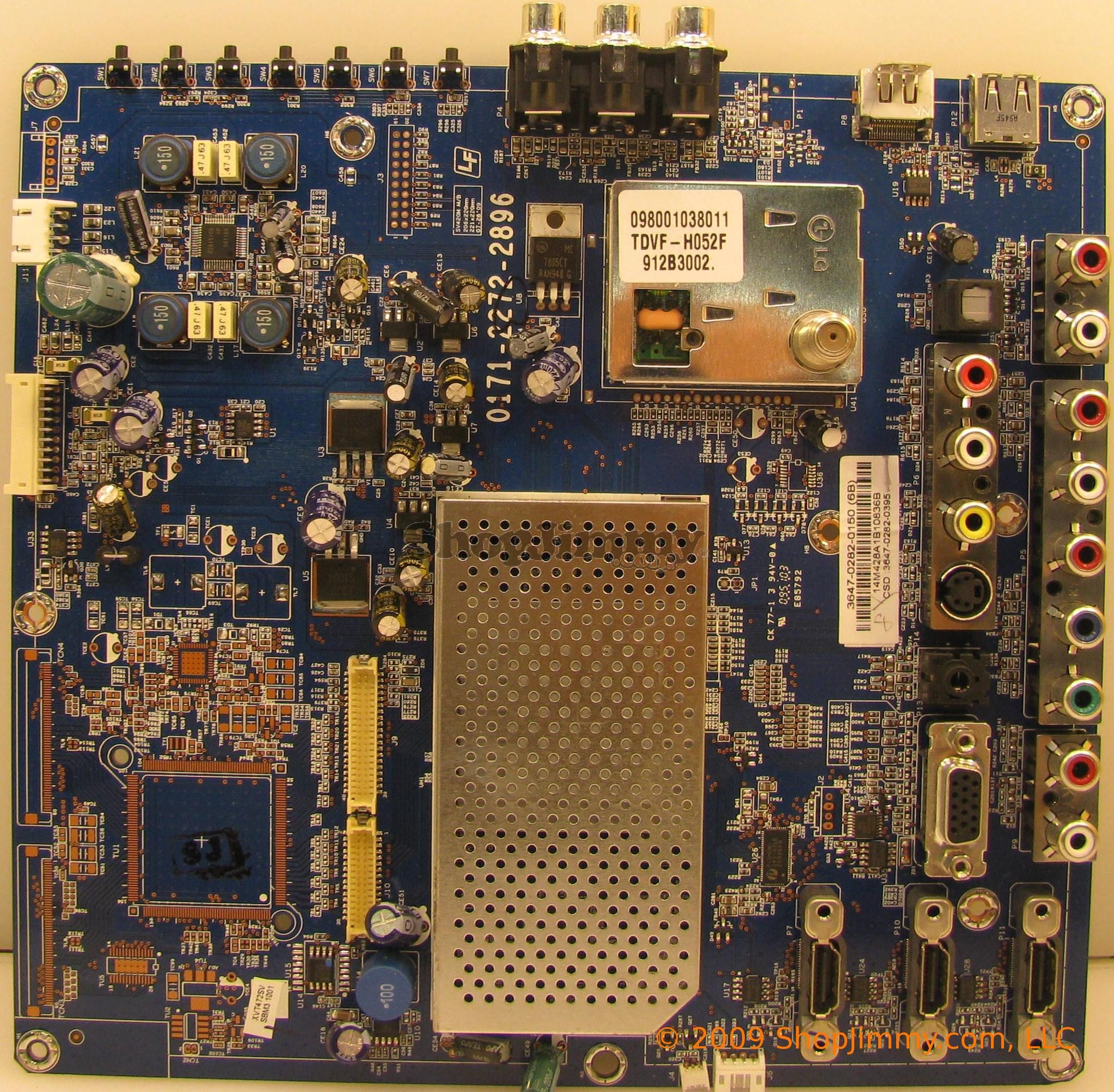

                          The readings are done with the TV turned on? If that is the case then the main board is not supplying the DCV to for the T-CON to function.
                          This is not going to be easy since you will have to trace out which pin is the Voltage supply pin of one of the two connectors that go to the T-CON board fuse, then we need to locate the switched MOSFET that is used as a switch to supply that Voltage to the T-CON.
                          Picture is provided by SHOPJIMMY.
                            Yes, power was on. And I too, figured that 0.25v at the fuse would be low.
                            Any suggestions on what device on the main board supplies that DCV and what voltage value should it be?
                              It should have 12VDC to run the T-CON.
                                on the mainboard picture theres a white connector on the left which has two white fuses it maybe worth checking those to rule them out.
                                  Those are OK, he already checked them, one is for the 5VSTBY VDC, and another one is for the switched 12VDC, he is getting both Voltages.
                                  Too bad the pictures from SHOPJIMMY is not good enough for me to do the reverse engineering.

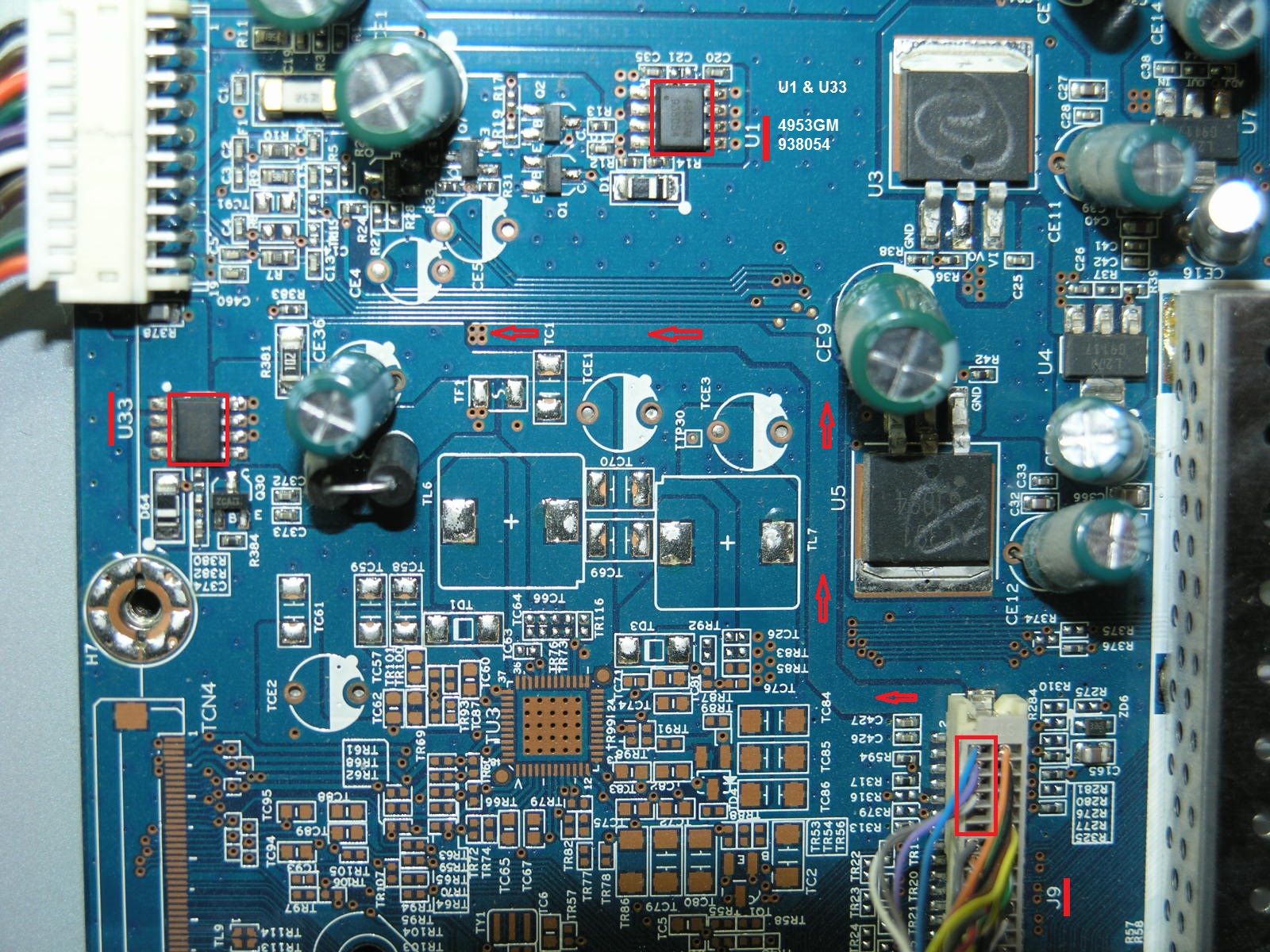

                                        On the T-CON Board:
                                        I traced the F1 Fuse to the CN1 Connector.
                                        From the TOP of the T-CON board the LAND goes from the F1 Fuse to
                                        the first 4 pins of CN1 Connector (See Picture)
                                        These pins correspond to the single (not twisted pair)
                                        wires: Purple, Blue, White, Gray
                                        These wires connect to the Main Board J9 Connector, pins:
                                        2-Blue
                                        4-Purple
                                        6-Gray
                                        8-White
                                        From the TOP of the Main Board the LAND goes from the J9 Connector toward
                                        U1 and U33. However the LAND ends at 4 through holes.
                                        (See Picture)
                                        I researched and find that U1 and U33, both having the same markings:
                                        4953GM <---- 1st Line
                                        938054 <---- 2nd Line
                                        These devices may be:
                                        Duplex P Channel Enhancement Mode Power MOSFET SO-8 Package
                                        (see datasheet attached)
                                        Getting closer
