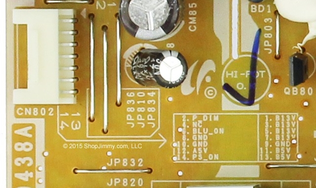

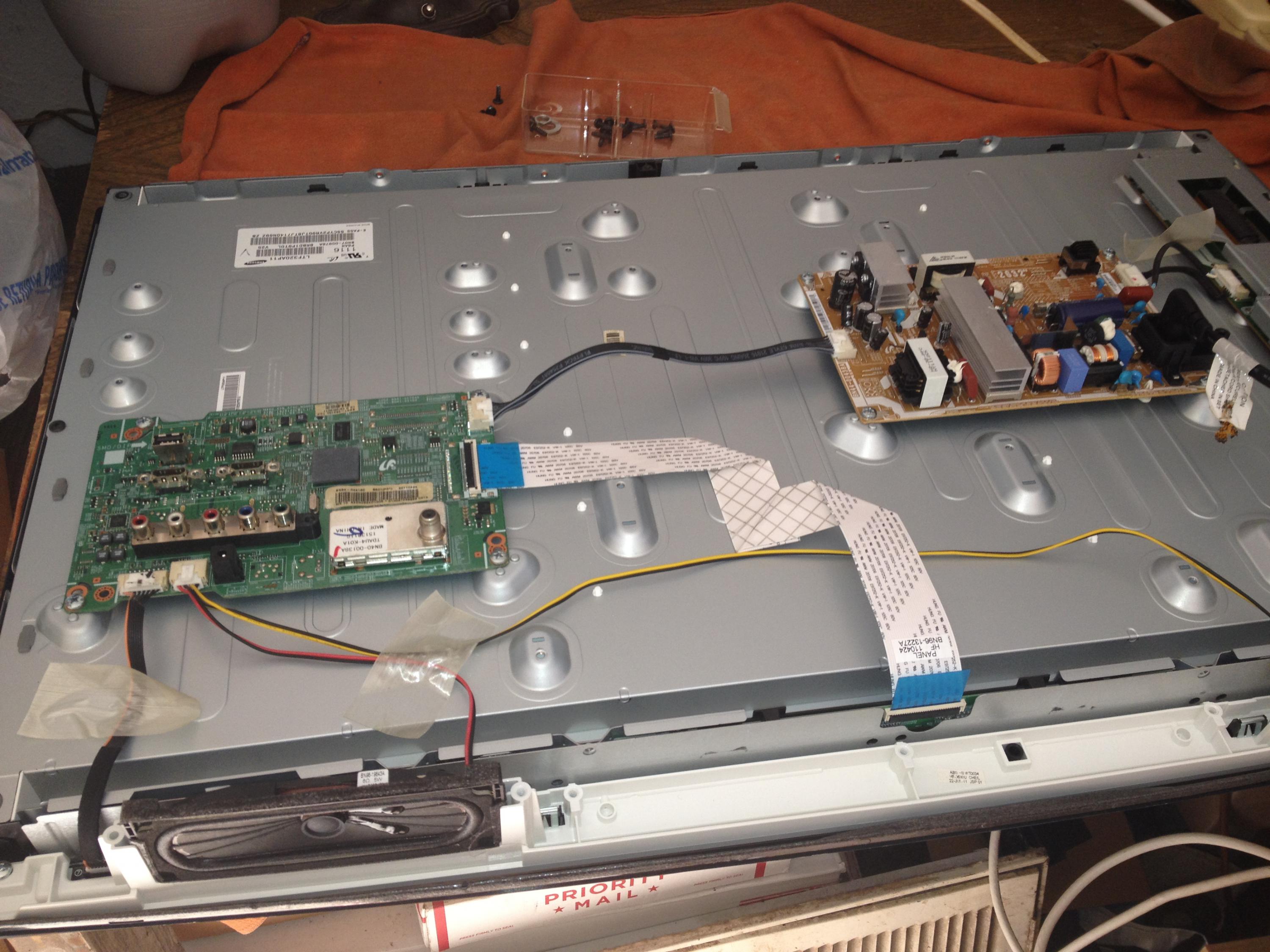

    My problem is I get Samsung jingle upon turning tv on and get baclights but no picture. I checked fuse on t-con which appears to be attached to led panel. Fuse had continuity and ribbon cable to t-con had continuity.
    I powered up unit and have no voltage at the fuse of the t-con. I am assuming the mainboard is the problem? Got one from Shopjimmy and still no voltage to fuse at t-con.

    are you getting any voltage at the source? is the ps supplying voltage to the mainboard to power the tcon? you need to verify the ps is making all the voltages on the rail, most have a legend printed at the pins. if no then you need the service manual.

      Thanks for the reply awyatt2. Couldn't find a schematic on this model and the pinouts don't make a lot of sense. Will need more research. you have given me another way to verify. Thanks

        look at cn802 the connector going out to the mainboard .do you see an arrow pointing to a block with voltages? these are usually +_ a bit, but close so there you can check and know the voltages needed. if any are not present then you know where to start looking. two are ground pins so be careful to not short two pins and make matters worse. the pins read the same as the block top to bottom same order.

          Thanks again fir the reply awyatt2. Yes I did see and check those voltages and they are,
          pin 1-12.77vdc
          pin 3-12.77vdc
          pin 5-12.77vdc
          pin 7-12.77vdc
          pin 9-0vdc (grnd)
          pin 11-5.22vdc
          pin 13-5.22vdc
          the legend says 1thru7 should be 13vdc and 11&13 should be 5vdc.

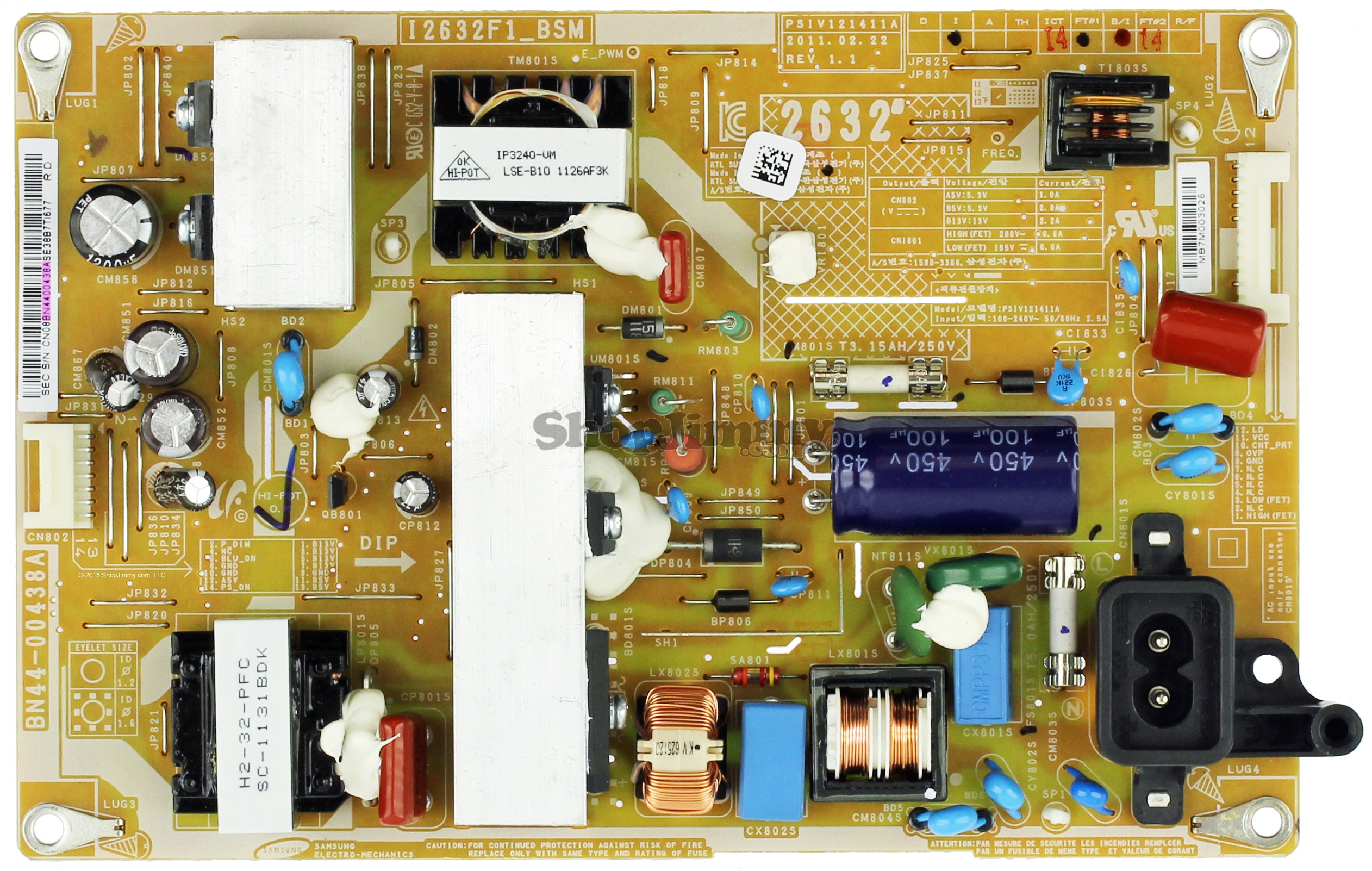

                What is the P/N of the power supply board? BN44-??????
                The Main board P/N?

                  bud the power supply appears to be a BN44-00438A , the main I cant read from the pics. I had one here a while back with a power surge. hope this helps, I don't have a print on it had to trace it back and the set I had has gone back to the owner. thanks for all you do Bud, you have helped me out a lot.

                      Hey guys, thanks for the help. The main is a BN94-04416C and the PS is a BN44-00438A. I did reseat the ribbon cable several times.
                      pin 2=2.66vdc
                      pin 4=0vdc
                      pin 6=5.08vdc
                      pin 8=0vdc
                      pin 10=0vdc
                      pin 12=5.22vdc
                      pin 14=3.32vdc
                      Also, this may be a wild goose chase. I rechecked fuse at t-con and am getting 12.75vdc. It is so tight between the frame I may have not been getting a connection on the other end of the fuse last nite. So still no picture, just backlight.
                        Re: Samsung LN32D403E4D
                        OK, I wish you had put the pin names on the list also, so here they are:
                        pin 2 (P_DIM)=2.66vdc
                        pin 4 (N.C.)=0vdc
                        pin 6 (BLU_ON)=5.08vdc
                        pin 8 (GND)=0vdc
                        pin 10 (GND)=0vdc
                        pin 12 (A5V)=5.22vdc
                        pin 14 (PS-ON)=3.32vdc
                        So you have all the correct signals and Voltages but still no pictures on the screen, only the backlights.

                            Well, bad news. Got replacement board from shopjimmy and and still no picture. The only thing different that happens from the original board is upon power up sequence, I do get a white flash across the screen from the bottom 1/4 of screen while original board was just straight to backights, no flash of screen. So looks like panel is shot.
