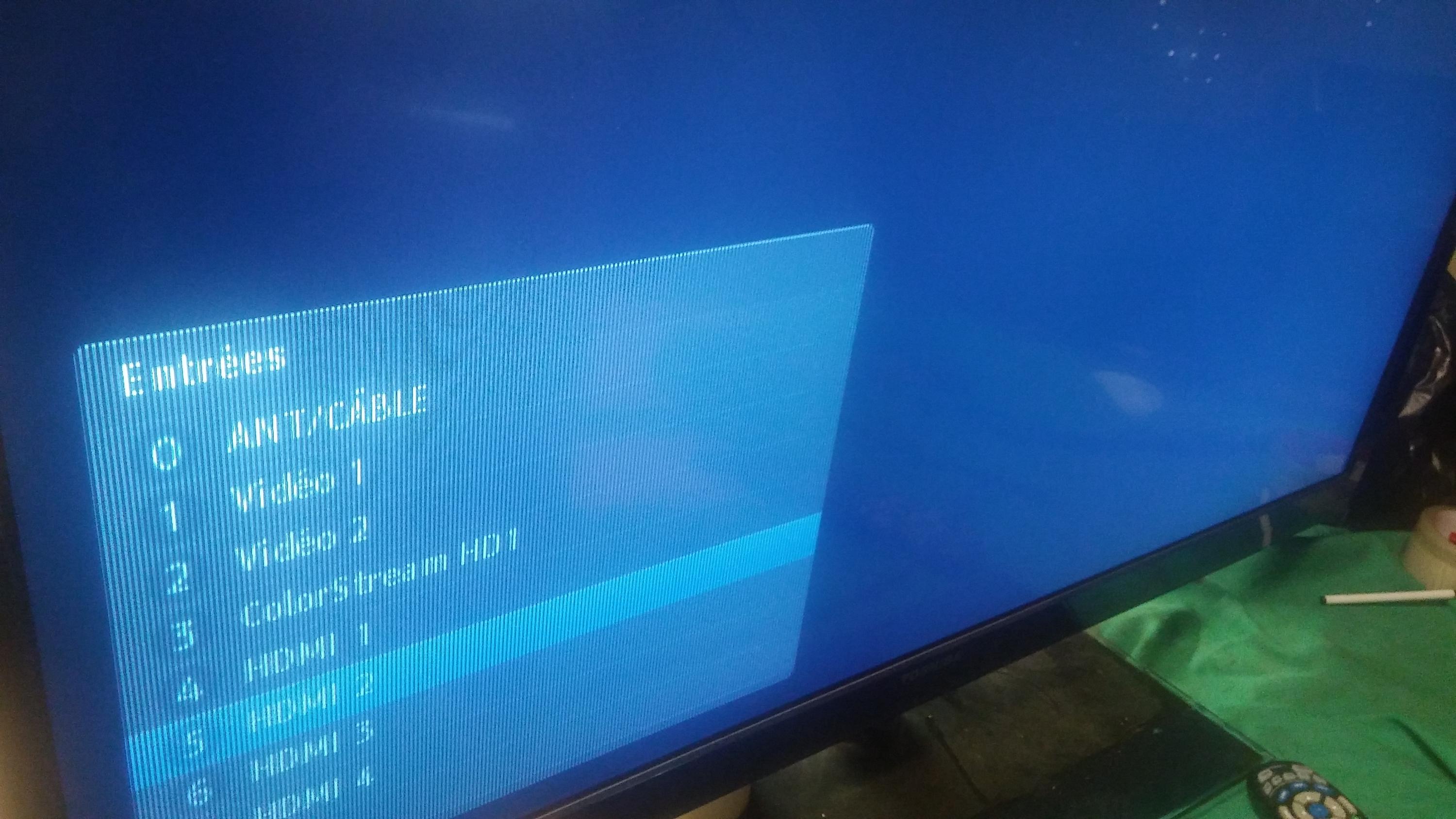

    So i got this tv in my shop wouldn't turn on had a bad main. Could find a replacement so I sent to moduslink for repair and return. So i get it tv works but has lines vertical all over it. Don't have a good picture put here is what lines look like. Do you think its bad main?

    I think it could have a bad connected lvds cable, since some pins are for odd pixels, others are for even ones only on fullhd screens. Bye.

      Is the mainboard the correct one for that panel ?
        Re: toshiba 46sl417u lines on screen help
        I have seen this on "100Hz" sets where the EVEN or ODD LVDS connection is missing (usually marked) this can be e.g. if one connector not properly seated or damaged or perhaps a bad main board.

          thanks tom i found a damaged lvds cable

            Ok so I did find on one of the lvds cables had a burnt strip so I replaced both and still getting same thing. I even sent it back to modus link pts cause they repaired the main board and they said it worked fine in there set. And they tried to tell me I needed new lvds cable so I bought both brand new and still same issue. Is it possible tcon?
