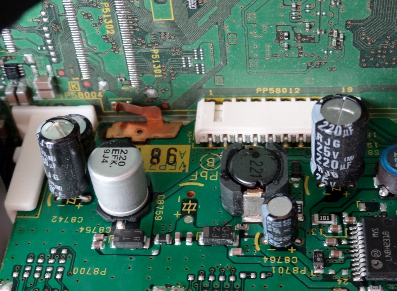

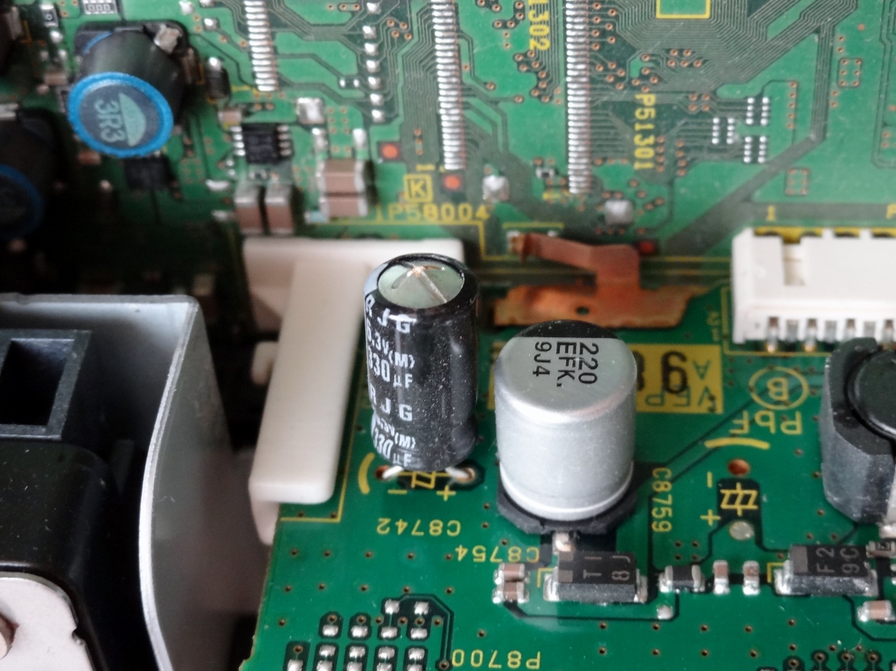

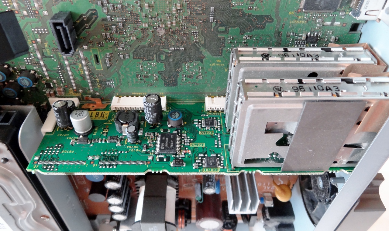

    Hi guys, scored this Panasonic DMR-XS350 tuner the other day which I thought worked fine. Plugged in and dvd / hdd recording playback were working fine but today decided to hook it up to dish and isn't getting a signal. Tried two cables which both work fine on other boxes, so not a cable / dish problem.
    Anyhow got it opened up and spotted a leaky cap right off on the tuner board.
    Is this a likely culprit?

    It should definitely be replaced and the other RJG capacitor seems like it's going bad as well. By the vent shape it looks like made by Elna but any low ESR capacitor should be fine (like Panasonic FM or Panasonic FR).
      Re: Is a bad cap enough to cause a tuner not to work?
      Yes, if the cap is for the +30V tuner line, it can cause a drop out of that bias voltage which can prevent the tuner working properly or make some channels inaccessible.

        Cheers will replace the 4 electrolytic caps with FR series.
        Would be great if its just the caps, fingers crossed
        Yea its completely not picking up a signal what so ever, just says astra 2 not found.

                      Awesome all sorted, seems to have done the trick with both tuners picking up signal / channels

                          Replaced 3 of them, the two RJG ones and the 50v one.
                          There was one other tiny 50v one behind the blown cap but I couldn't make out the uF on it at time of ordering so didn't bother with it.
                          Hope I don't live to regret it!
                          Cost me £15 in total to repair, £12 for a replacement remote and £3 for caps. So satisfying.
