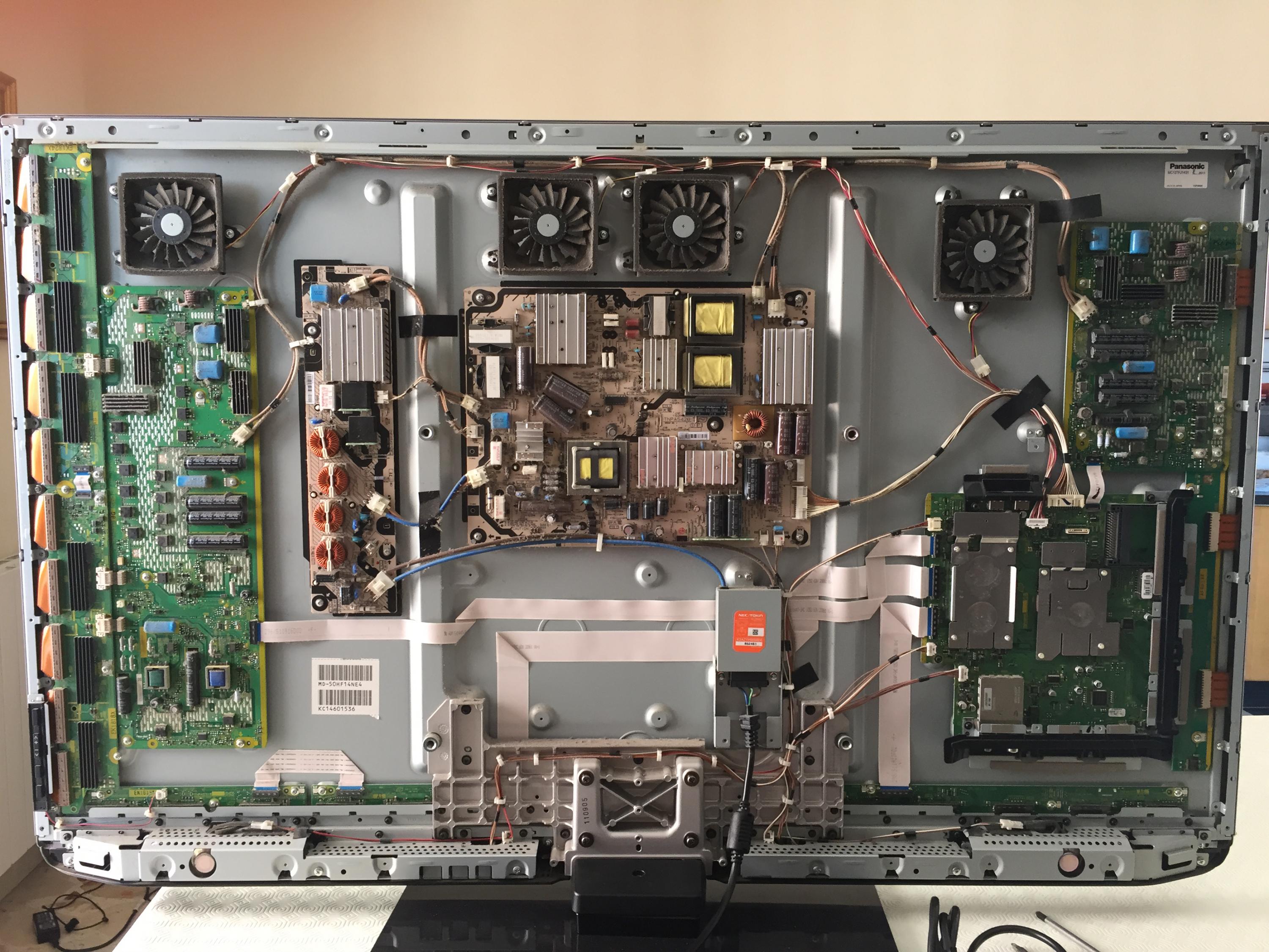

    Hi All,
    my tv is broken the SS-Board is dead (8 blinking led).
    I tried to repair it but the Mos and the diode are good.
    I need your help for replace this board.

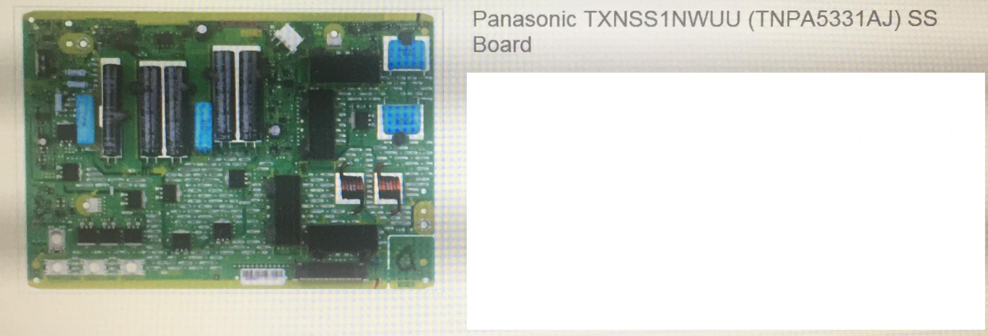

    I search the SS BOARD TNPA5331AG (board Broken)but I found on the shop jimmy store only the TNPA5331AJ.
    It s possible to change the dead board "AG" with the new model board "AJ"?
    What is the difference?
    The board seems the same in the picture.
    I suspect that the new board AJ is better than old board AG.
    Can you help me?
    Thank a lot
    Andrea

    Re: TX-P50GT30E Replace SS Board
    Posting pictures of the back of your tv showing the boards with clear pictures may help you more with fixing your problem

      Thank you a lot for your help,
      below you can find the picture.
      Sorry for the bad resolution, tomorrow i will resend it.

        AJ should be fine it's also 50GT30 in the US. Looking at it the only difference will most likely be the panel connector. Appears to be a flip up type on yours and on the AJ the tabs slide out from the front, insert ribbon then press the tabs back into secure it.
        No it won't be any better, same board really just different hardware used.

          Thank you
          you think that will be possible to insert the panel flat cable in the new connector of new board (AJ)?

            yes

                Hello i finally changed the SS board (bought from shopjimmy) and when i plug it into my tv Showed 8 LEDs.
                I verified the cable side and the flat D board
                I saw that the cable flat was oxidized and after cleaning my television set is turned on.
                thank for all
