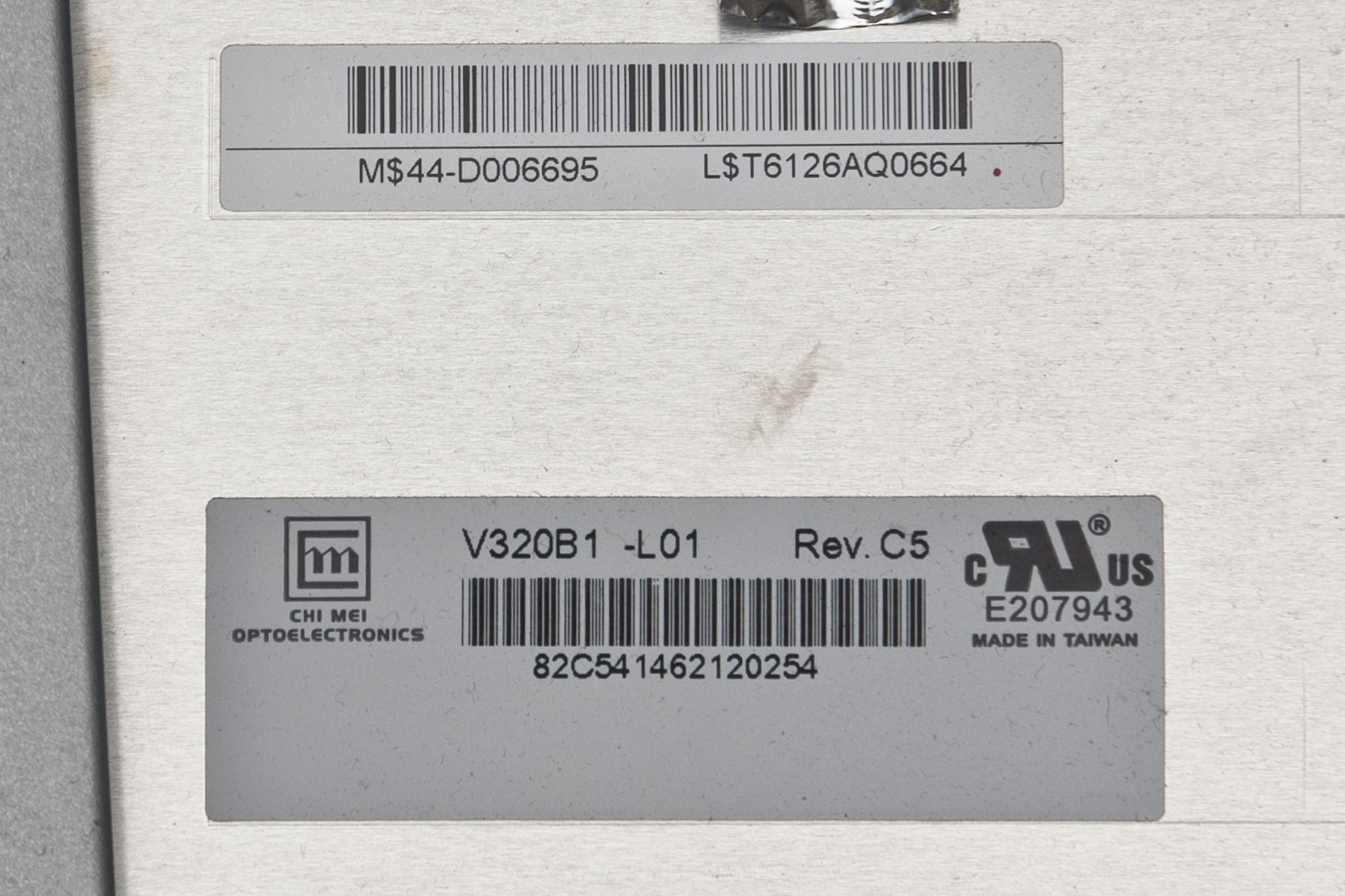

    What is the LCD Panel model number? I acn then look for the panel spec.

      Panel model number is V320B1-L01

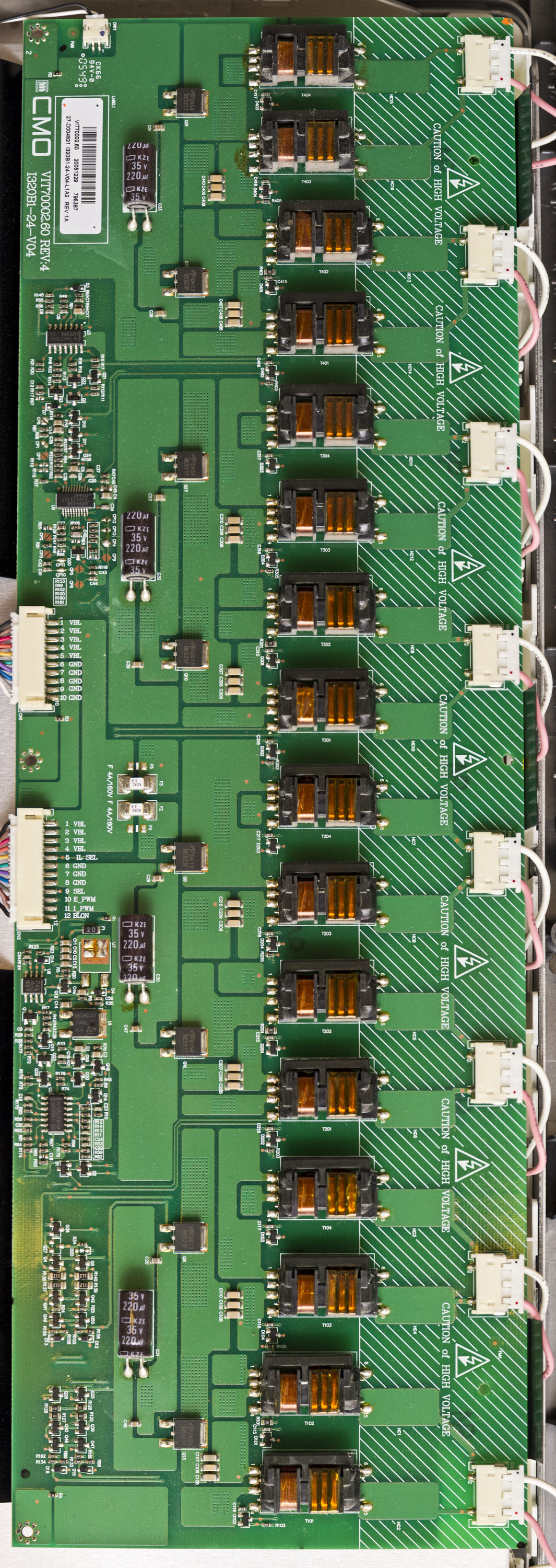

              I will need the good clear pictures of the whole Inverter board next.
              Which one of these is YOUR Inverter board?

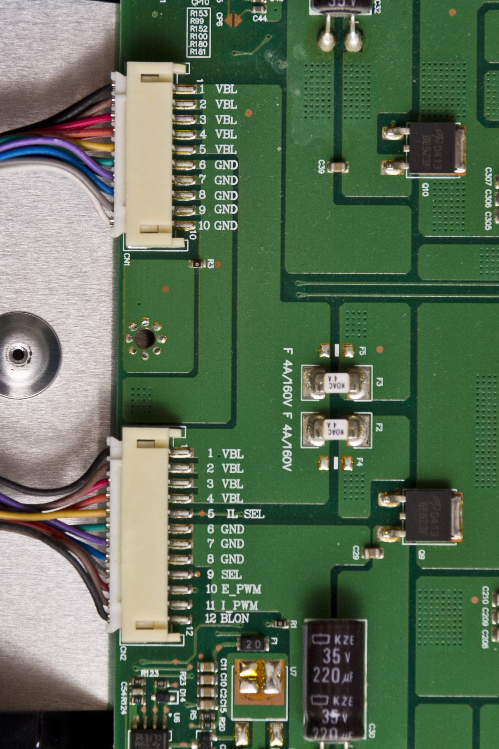

                      High res of the inverter board . This one is mine.
                        Re: LTV-32W6 HD has back-light issues with picture.
                        OK, to the right of the CN2 BY PIN #12, there is a very small black fuse F1 with '20' printed on top, check and see if it shows <1 Ohms. That is the commonly failed fuse.

                          Holy $#!?, that is it. I jumped the fuse and the back lights came on. And that is without jumping 3.3V or 5V to the I_PWM with resistors.
                          The fuse in question; is it 20ma, 0.2A or 2.0A? I am not sure how to read it. I am sure that I do not have replacement like that around. I'll check other burned out components I have around to see if I can find a compatible fuse. At worst I will hot wire and external 5x20 fuse to the board. Or should I just bypass the fuse all together? Not really a sound decision, but at worst it will work.

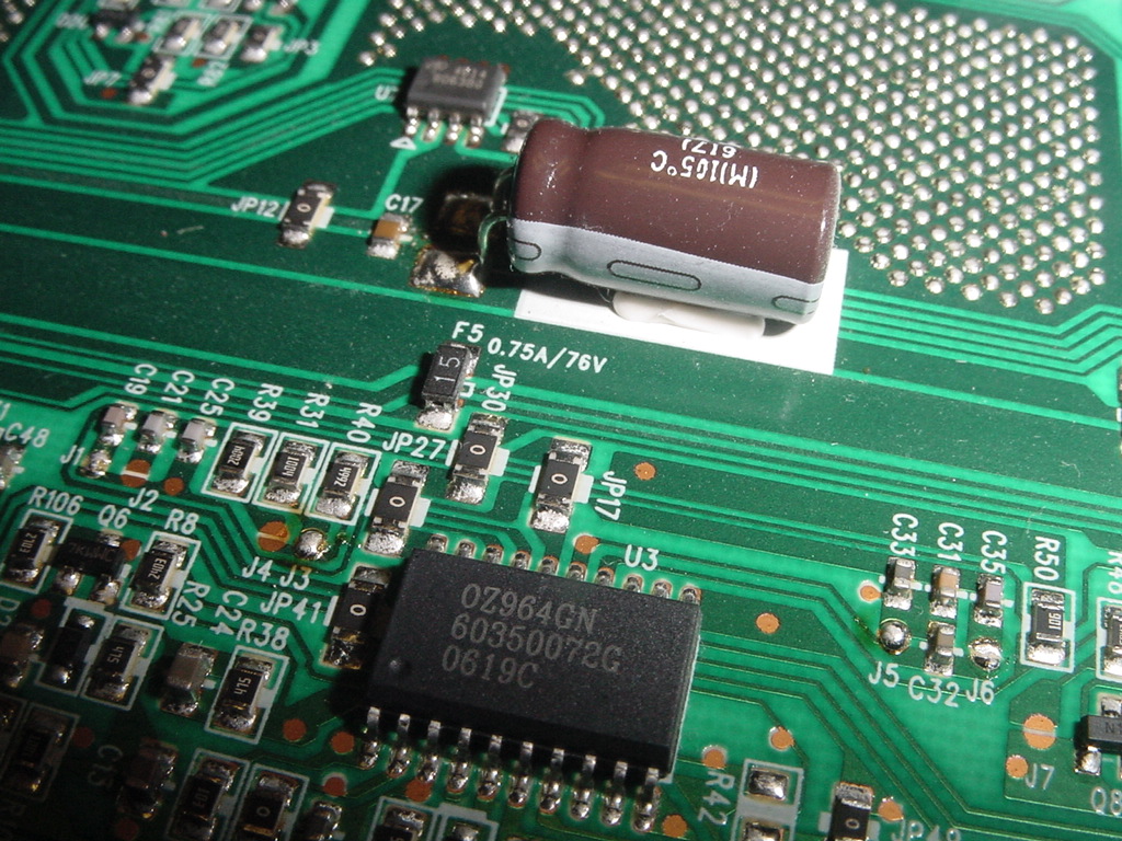

                            If I rememember correctly that is 1.5A fuse with 36V minimum Voltage rating, I use PICO II fuse or 5X20mm fuse will be fine..

                                15 = 0.75A so 20 is higher than 0.75A.
