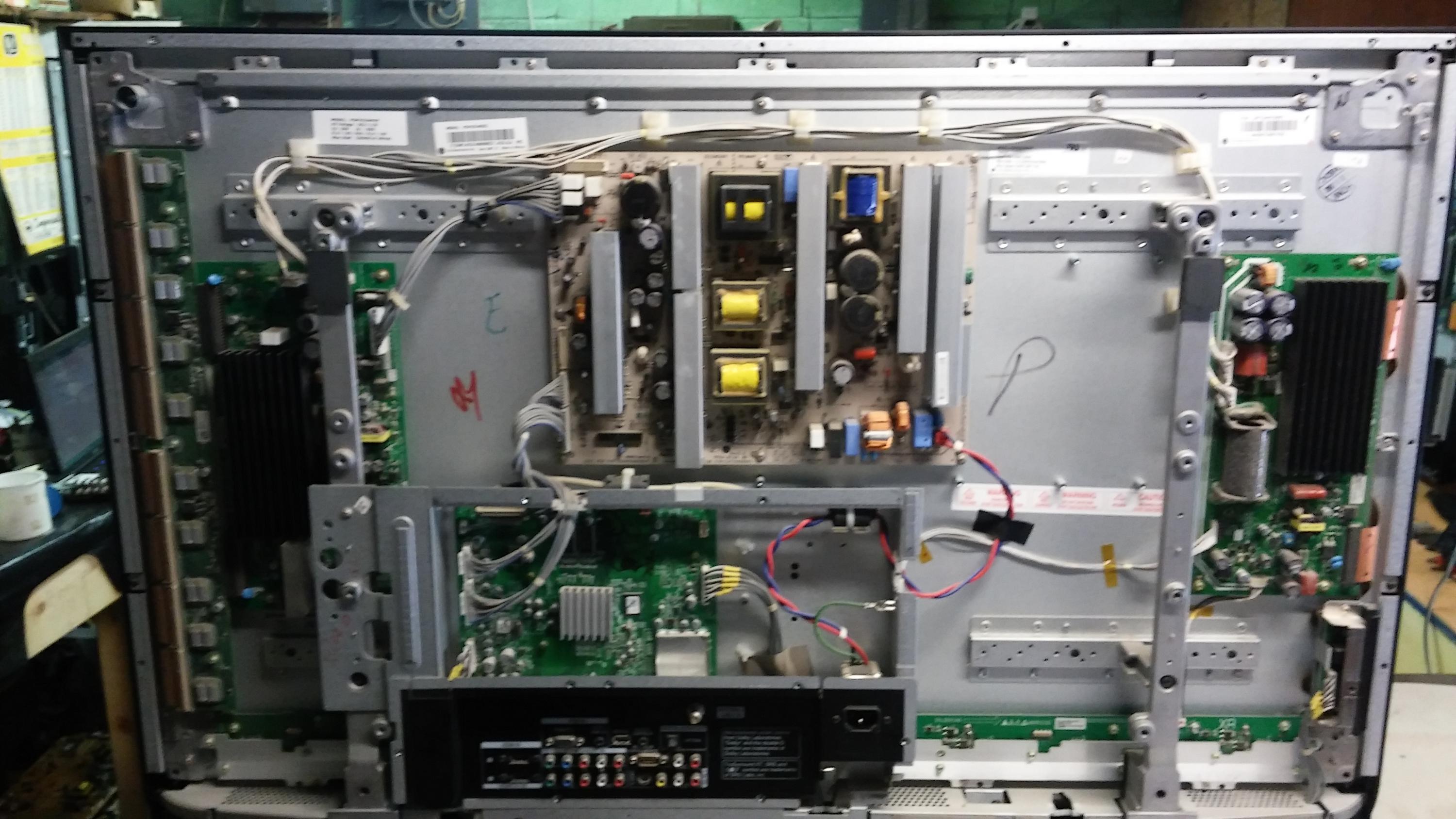

    tv turns on just no picture, would it have to be a ysus? I have a hard time figuring out plasmas not sure the best way to figure out what is the problem

    Usually this would be a failed ipm on the y-sus.
    Is the fuse open?
    Vsc and -vy voltages?
    These are Measured across a couple of marked resistors.

      This is what i gathered so far, well first off tv turns on soon as i plug it in and the buttons will not shut it off and i dont have a remote to try. So makes me thing main fault? No open fuses.
      Va 59
      vs 192
      vz bias 140
      -yz 160
      i dont know what ysc is or where to check that thanks for your help so far and sorry about the caps. My button got stuck

        Ok connect the 2 holes marked autogen on the control board.
        Disconnect the lvds cable that connects this board to the main board.
        Power on and see if you get test patterns.
        Autogen located here:

          Ok i got the auto gen and test pictures appeared on screen so does that mean bad main?

            Yes, almost certainly.

              What's crazy is i had a newer lg plasma i fixed couple months ago kept cutting in and out and when picture would cut out i would still have sound. And I did the auto gen and test patterns appeared and I ordered new main and still did it and what's weird it happen to be the digital main fault
                Re: help with plasma lg 42pc5d no picture but powers on
                The autogen test bypasses the main board and part of the control board. If the autogen works, the PSU, Z-sus, Y-sustain, panel, buffers etc are all working ok. There is a very small chance the control board LVDS processor is faulty but in almost all cases the main board is the only fault.
