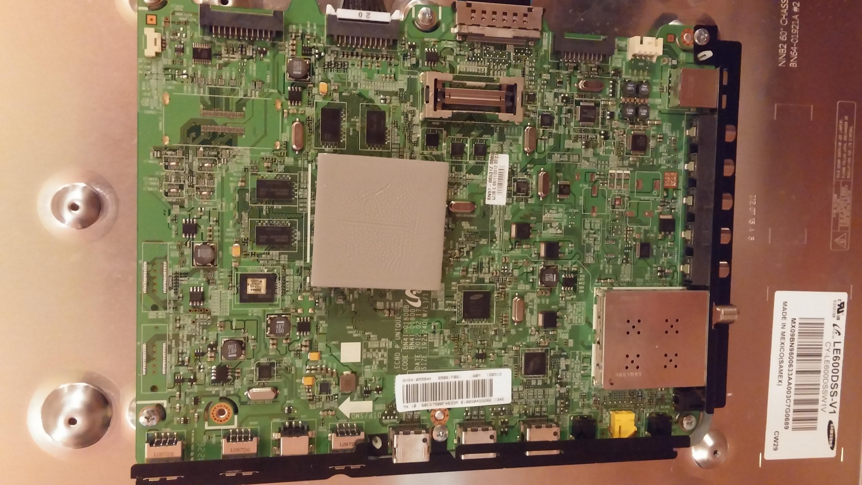

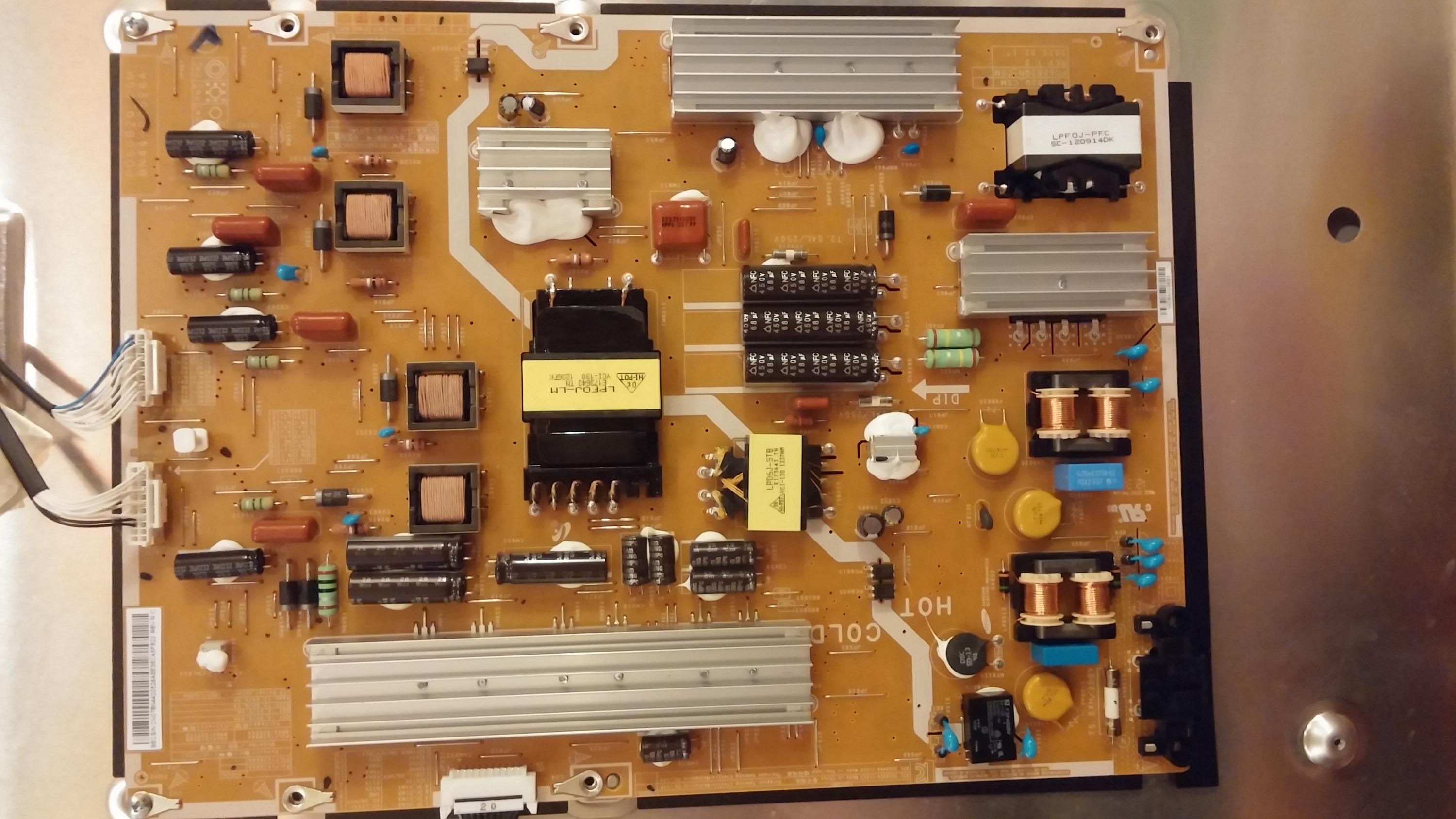

    Hello experienced badcaps users, I have an issue with this tv that I just can't seem to figure out.
    I purchased this tv busted. It is an absolutely beautiful tv and I couldn't pass up the opportunity of having it as the centerpiece of my livingroom. I've gotten tired of my 60" DLP. The folks I bought it from said it wouldn't turn on, and that it had been serviced before. They didn't want to sink more $$ into it, so they decided to sell it. They had both the main board and power board replaced as well as the power wire harness with the revised black one mentioned in another post about this model. I have already ordered and swapped both the power board and the main board with absolutely no change in this tv's behavior. When I plug the tv in, I hear the power board click on pause a second or two, then click off and i see the green LED on the top of the tv next to its webcam blink 10 times in 5 groups of 2 blinks. This repeats for as long as I have the tv plugged in and then continues until the capacitors drain. I couldn't spot anything out of the ordinary on either of the boards. I really need some advice on what to look at next.

    Re: Samsung un60es7500 clicks 2 times blinks 10 times repeats
    Pics of the rear cover removed and of individual boards may strike more responses from us to help you.

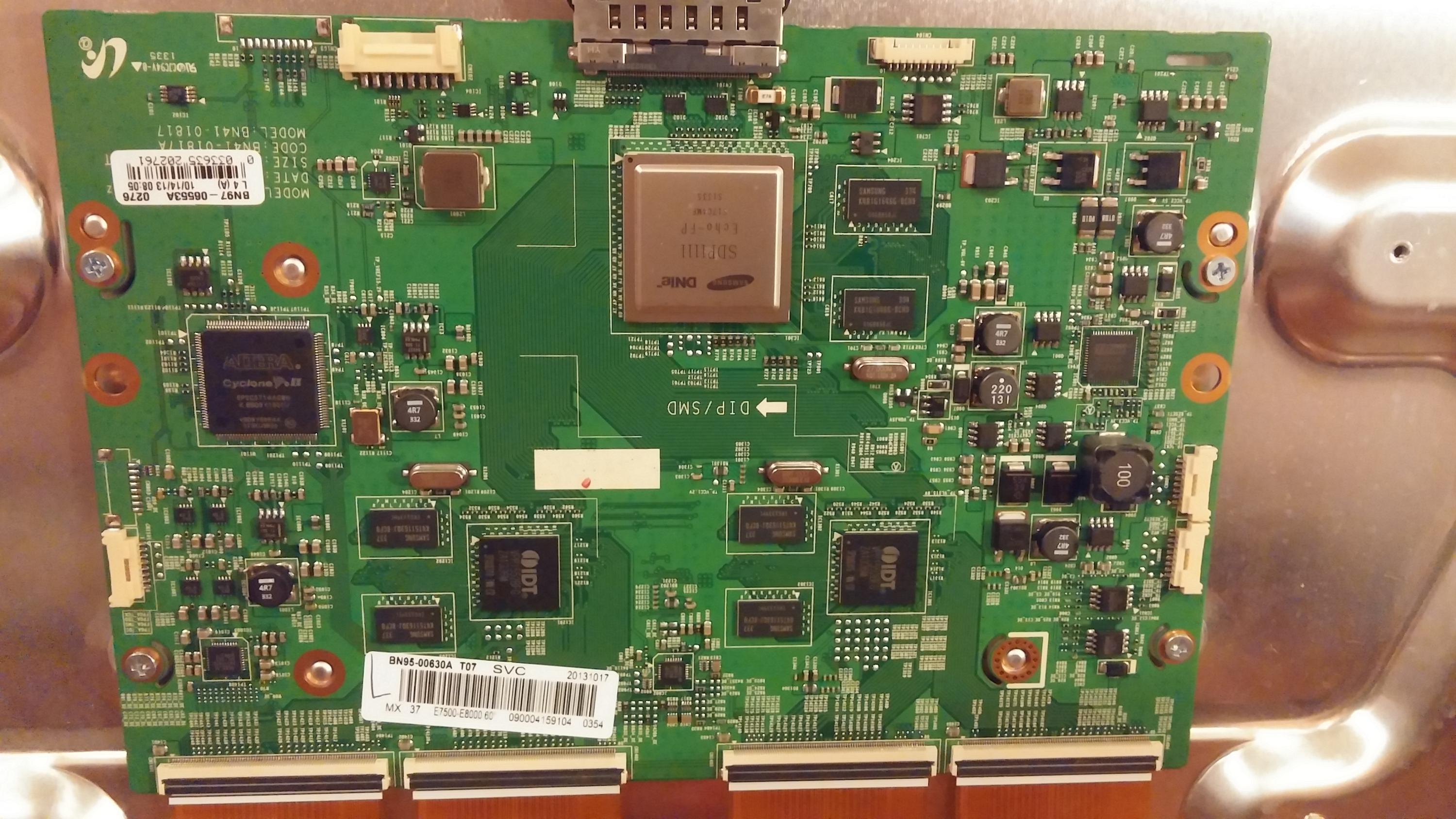

          I just got a chance to tear the tv apart and I don't see any off-color LEDs. Here are pics of the boards. I also took a pic of the T-con board.

              Thanks for the reply mmartell. I did remove the LCD panel, and I looked closely up and down both LED strips, but didn't see any that had the brownish tinge they usually get when they go bad. I'll have to test them today with a meter when I get home. What am I looking for when I test the LED's? I just attached those pictures for Andrew in hopes someone might see something I didn't on the boards.
