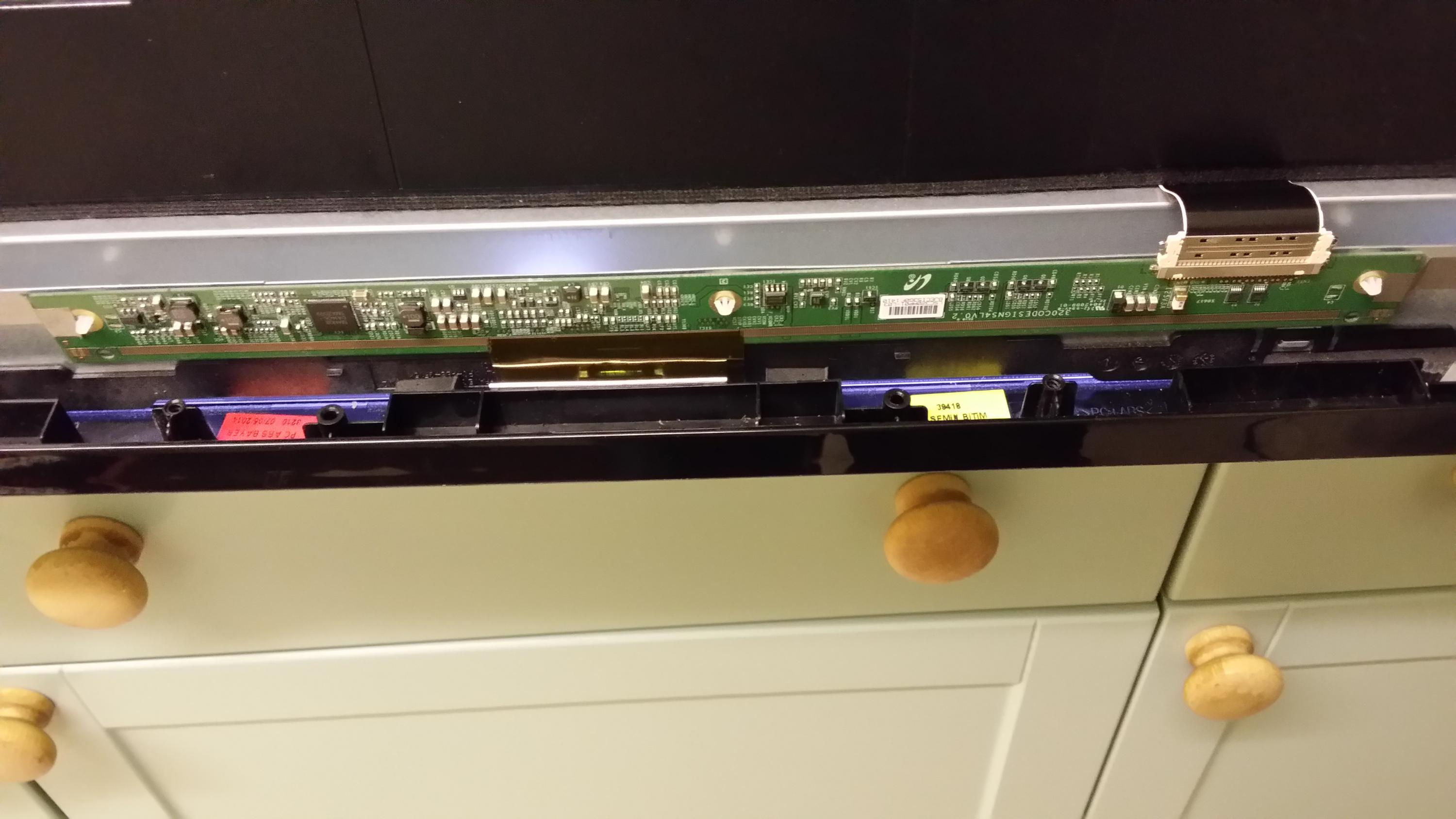

                OK replacement mainboard arrived today, fitted it same result, red power light flashes and changes to green, backlight comes on NO Sound or Picture
                Have now changed the power board and this is the second replacement mainboard, still the same as when I first got this set

                    #49
                    Re: Toshiba 32w3453d no video or audio backlight on
                    Probably means that the lcd screen is fucked and something on it is shorted try taking the bezel off and see if there are any obvious exploded parts on the tab section of the lcd. Also maybe you do have sound but not on the correct input.

                                  no sign of any damage, surface mount fuse next to connector is ok seem to have 12v in several places on this board

                                    #57
                                    What about on the panel on its tab/pcb section ?

                                      #58
                                      panel board

                                        #59
                                        Wow that really is a piece of shit one tab to drive a 32" 720p glass. Right try pressing on the tab bond and ic and see if image comes back ?

                                          #60
                                          tried that no change at all
