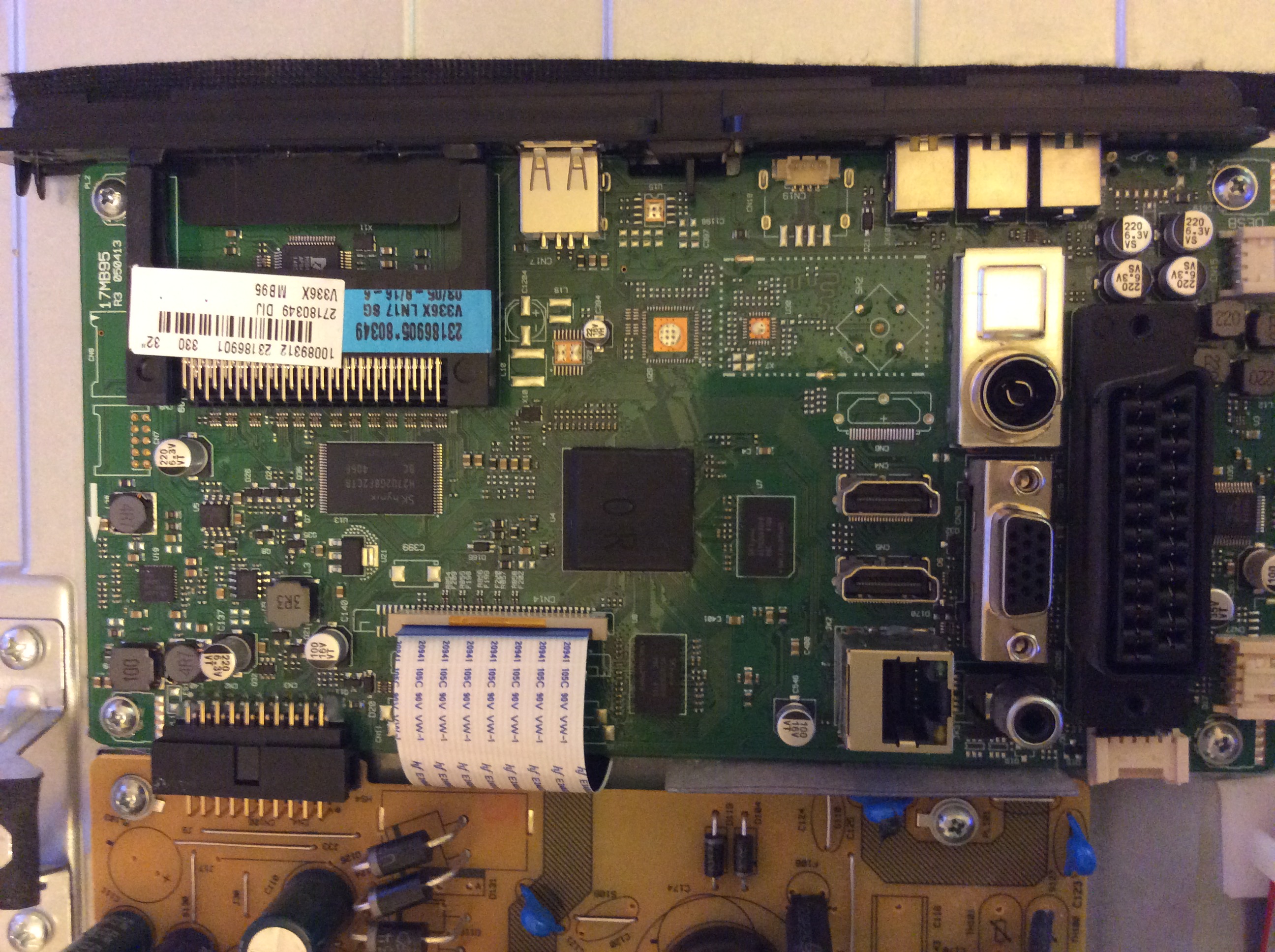

    Hi just acquired a Toshiba 32W3453D smart tv to play with
    When powering up backlights come on but no video or sound
    Had a quick look inside seems to be vestel power and main boards
    My first thought is it is a main board failure, however is there a way to confirm this ie rule out the power board,
    All caps look ok on powerboard
    Anyone any ideas don't really want to buy a mainboard if it is a powerboard fault

    Re: Toshiba 32w3453d no video or audio backlight on
    Pictures needed.
    I take it the TV doesnt have a t-con.
    If not, going by description sounds like main board fault.
      This is a vestel chassis nothing toshiba about this one. Im guessing that its a 17mb95s chassis so probably failed epprom as usual. Can you upload pics of the set please.

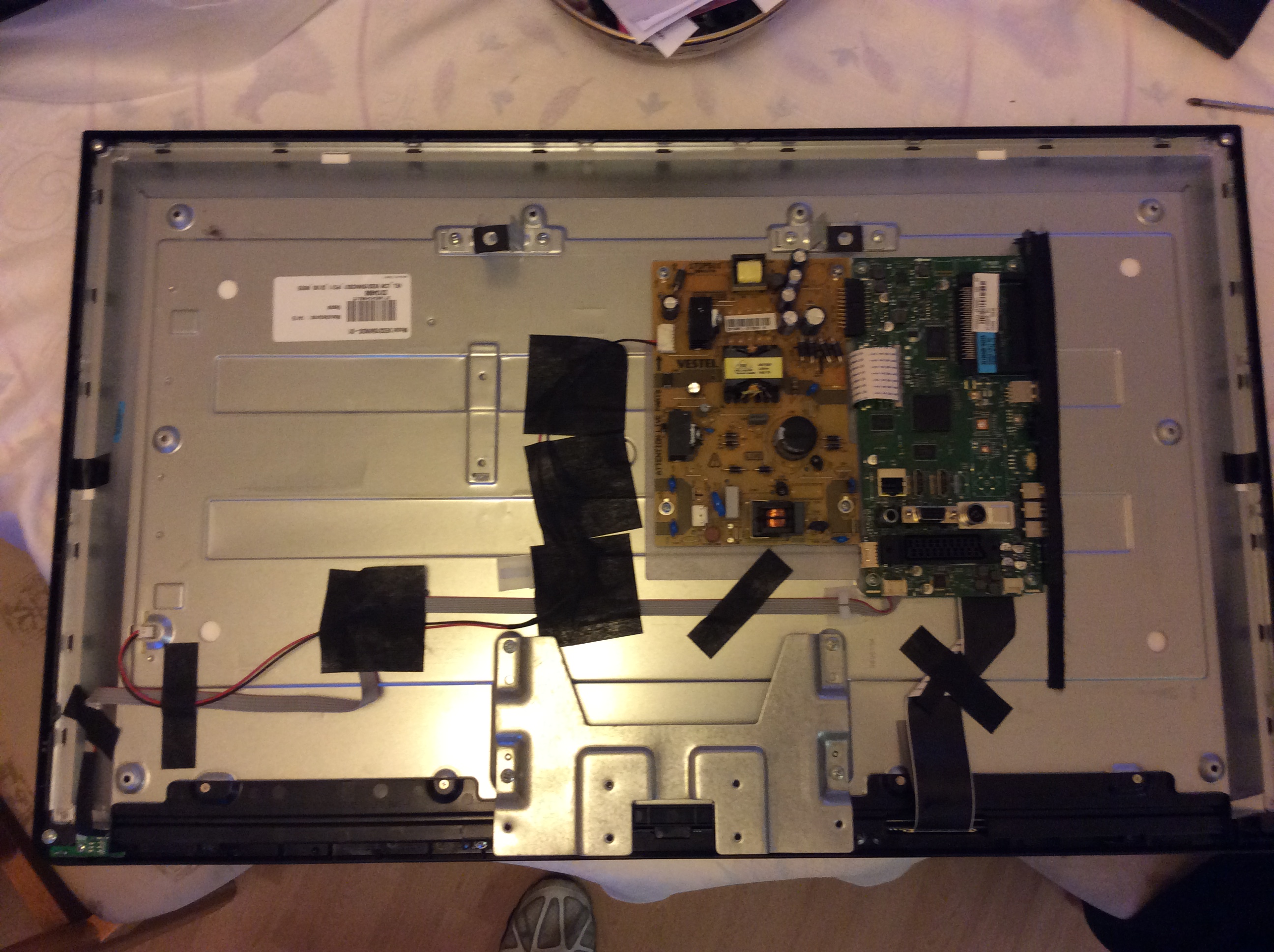

        pics or fitted boards

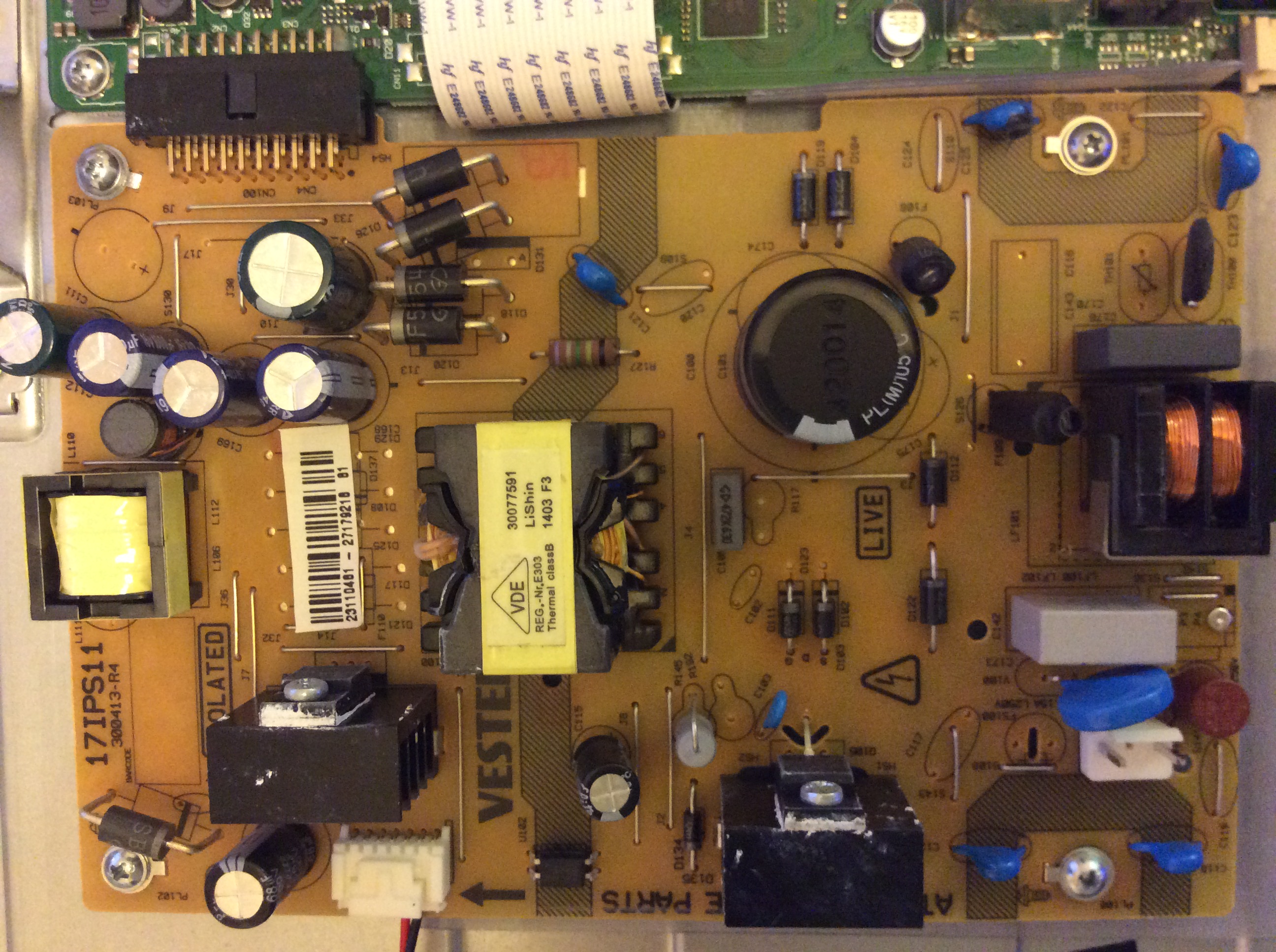

                        now replaced capacitors on powerboard still no video or audio

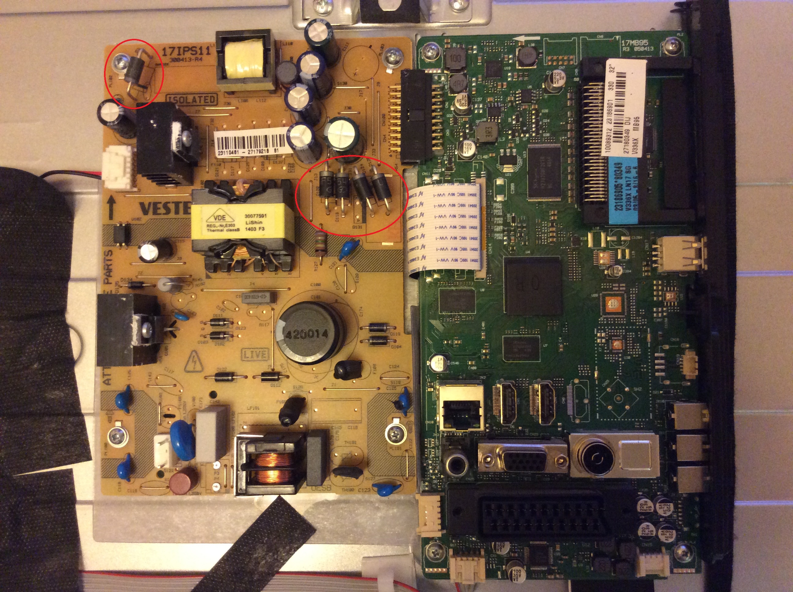

                          Have you checked all the diodes on the psu ?
                          I had a similar problem with a vestel psu no video but sound turned out to be a shorted diode
                              Just test the ones i have circled lift one leg out of circuit and test before you buy a replacement psu
                                  ok checked diodes out of circuit all check out ok
                                    anyone know how to check the power board on this tv vestel 17ips11, maybe this is the problem
