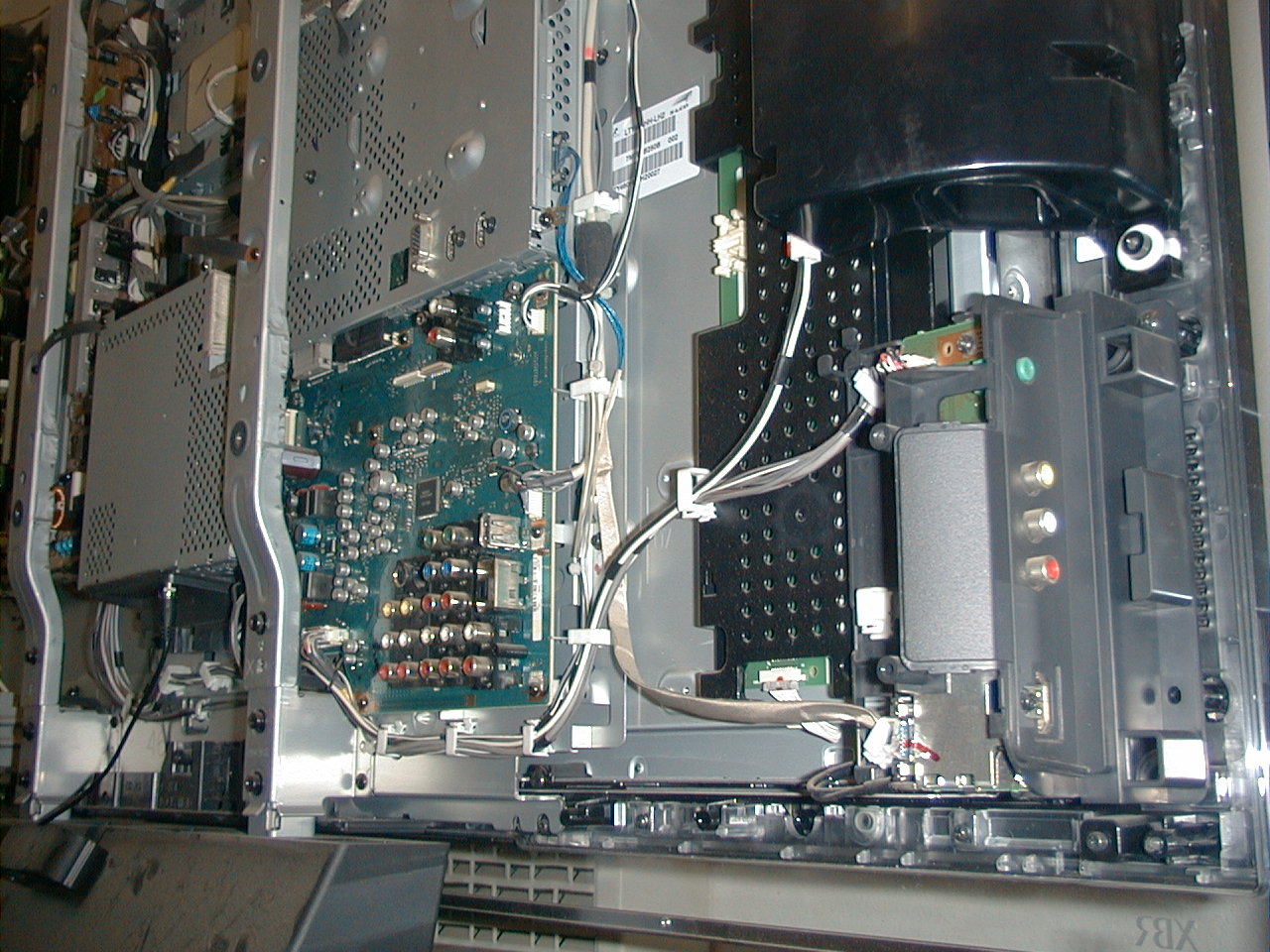

    Hi, The HDMI is not working on my SonyKDL46XBR4, tried swapping cords and other hdmi devices. The TV is working fine. I called a tv parts place and they said it sounded like the main board was bad. I got a "good used board" from them and installed it today. TV works, still no hdmi. There is a orange light located left center on the board that is blinking steadily. I don't have the metal cover on the board, could this be the problem? Sorry to sound so dense, I built a 427 Cobra, but this is all new to me.

    Any high res, straight shot pix?

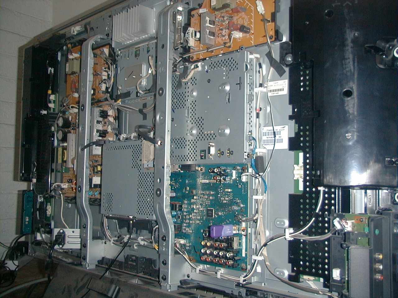

          Hopefully this is what you wanted.

            Re: SonyKDL46XBR4 hdmi not working
            where does the blue cable on the bottom right side go? It has something to do with the hdmi
            • thorconstr
              • Aug 2015
              • 12
              It goes to the HDMI plug on the side of the TV.
              • CapLeaker
                Leaking Member
                • Dec 2014
                • 8146
                unplug that cable and see if the on board HDMI works.

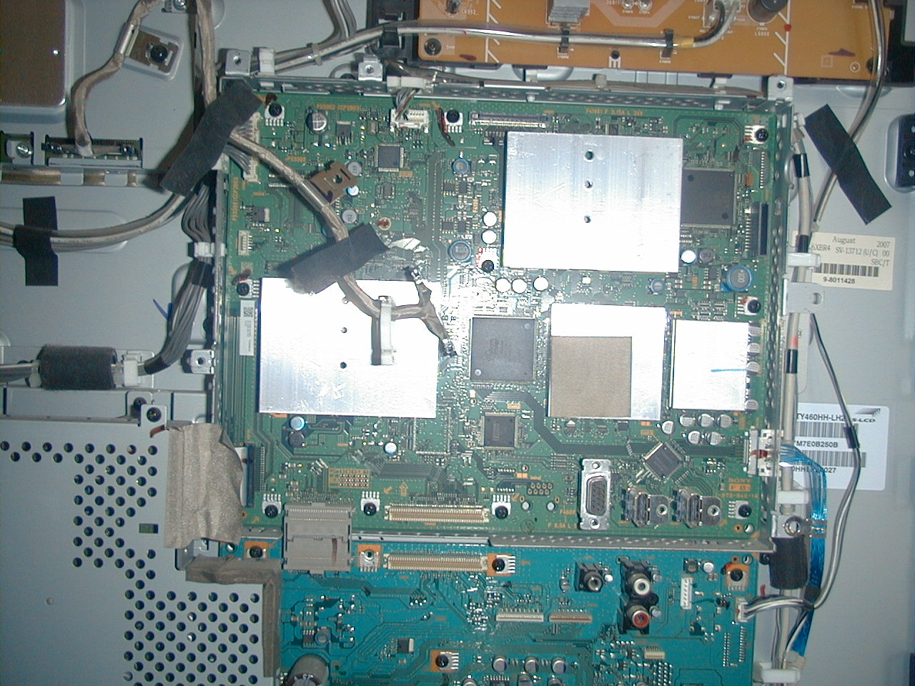

                  I unplugged the cable, no change. On this replacement board and my original board the is an orange light blinking left center on the board. I was told by an "expert tech" on Just Answer that this meant a bad board. So I sent that board back and got another from Tri-State Module. I installed it yesterday, same problem, no HDMI. Cable picture is fine. I tried 3 different HDMI cables and swapped them on the ROKU and BluRay that worked prior to this. I haven't installed the rear cover, don't see how that could effect anything. Could a source other than the main board make the light blink? I tried downloading from a memory stick some Sony updates, that's in the board below the main board, nothing.
                          First go to the menu and do a "factory default"
                          After you replaced the main board, did you go into the service menu and set it up cording to the SM? Did you load latest firmware on it?
                          What that orange blinking LED belongs, its called a "Heartbeat". I'd be concerned if that blinking LED would be off. It tells you if the processor is working or not.
                          See what this brings.
