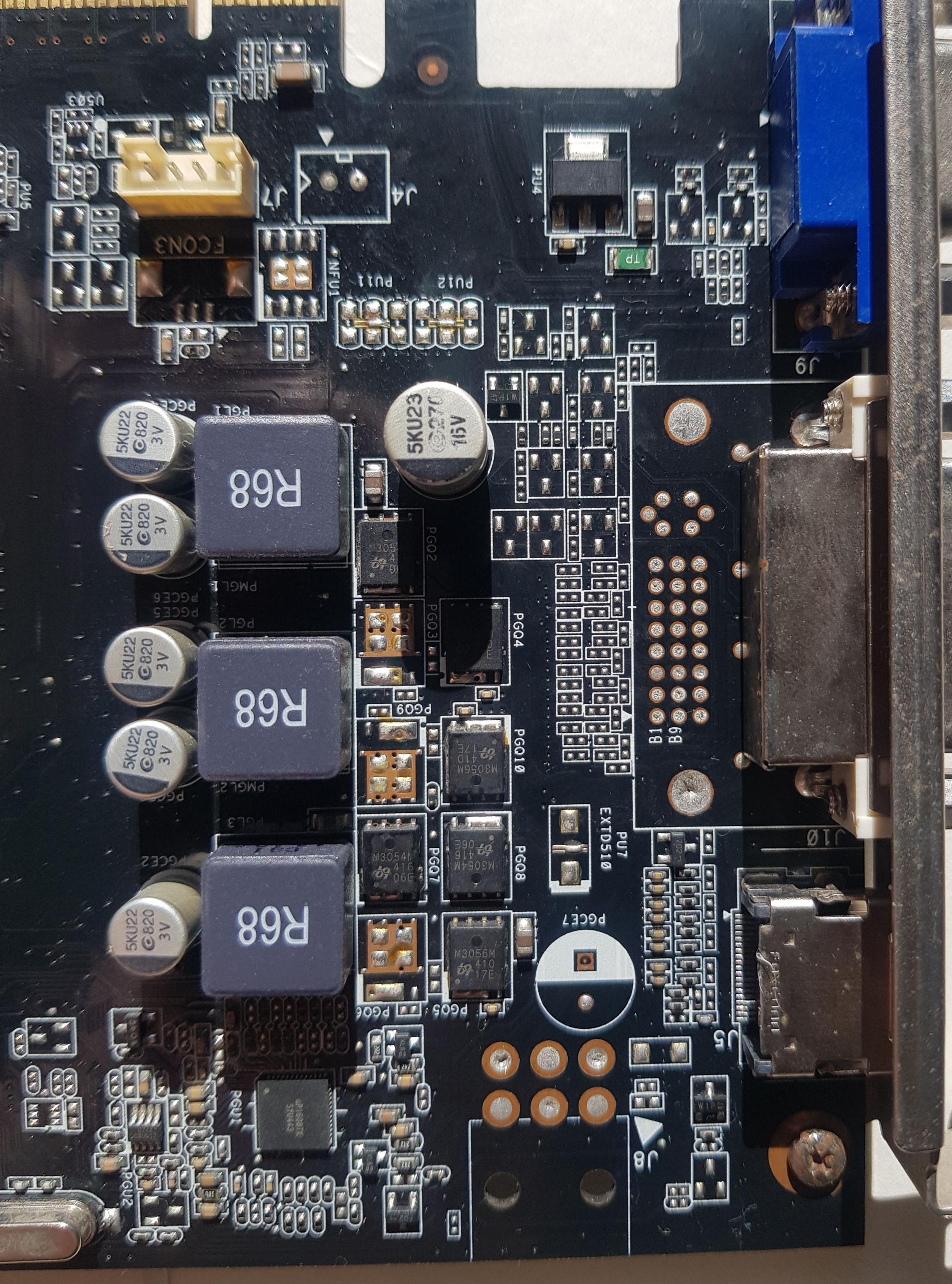

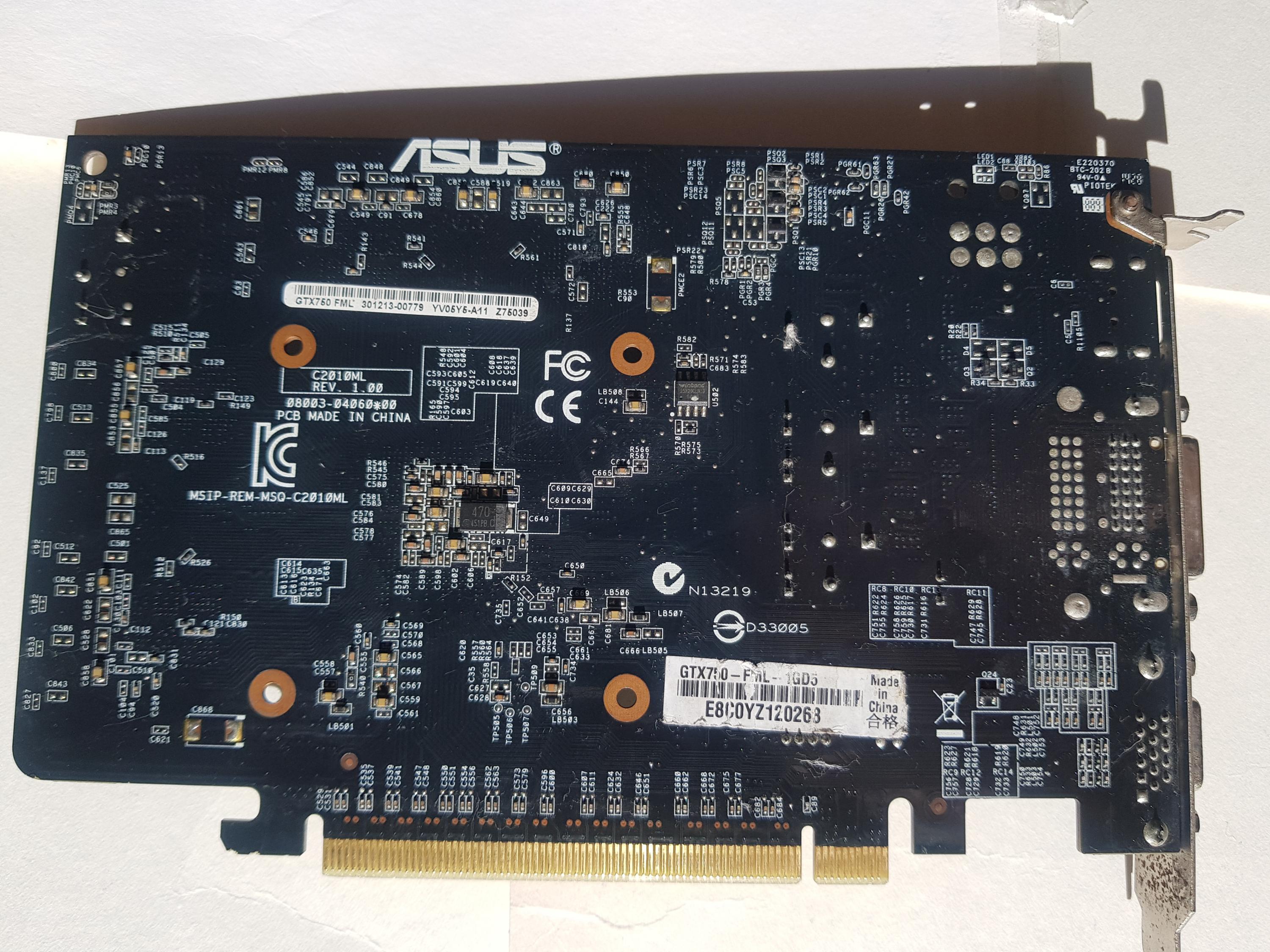

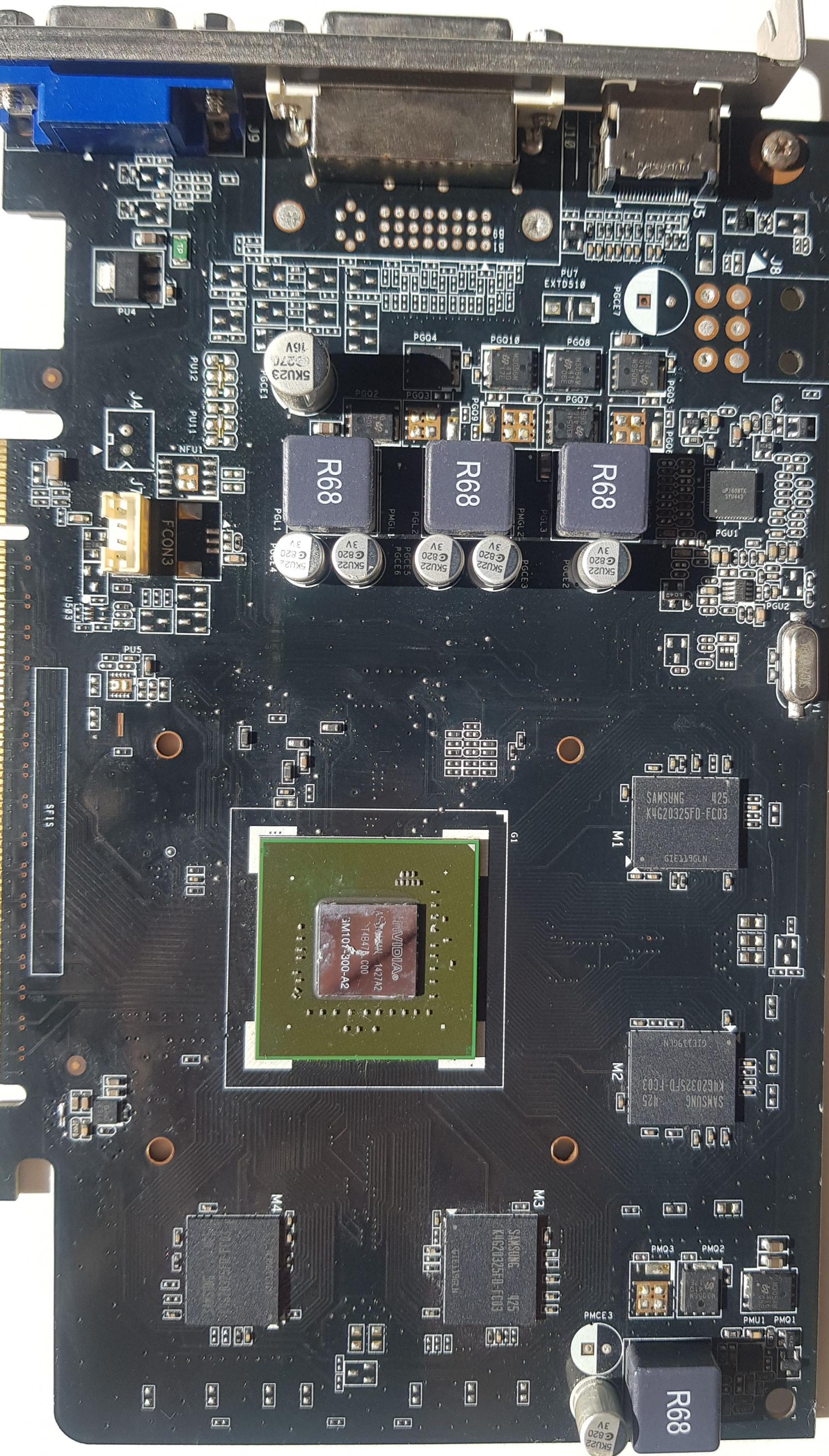

    Hi
    I have an GTX750-FML-1GD5 with a non-working HDMI port and I'd like to figure out what's the cause and if it's easily repairable.
    GPU is working fine. VGA and DVI-D ports are also working just fine. But whatever monitor or TV I plug into the HDMI port, it isn't even recognized, let alone giving a display.

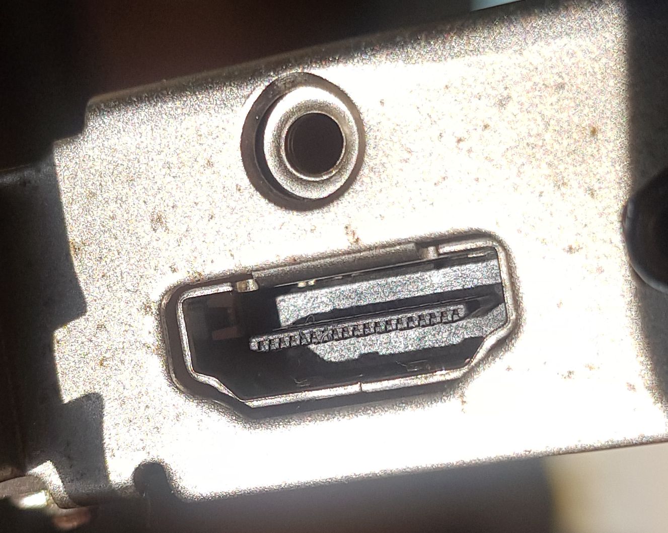

    I took a glance at the HDMI port and couldn't see any obviously broken parts.
    I've also read on various forums that some firmware versions have non-working hdmi, so I flashed dozen or so different VBIOS ROMs that I acquired from techpowerup database. I tested different rom versions from different brands, but still no success. It is reported flashing vbios of Strix card results in working hdmi, but since I have 1 GB non-TI version of the card I have large difficulty in finding reports of working vbios versions relevant to my card.
    I'm attaching shots of the card below. I have closer shots in case anyone is interested.

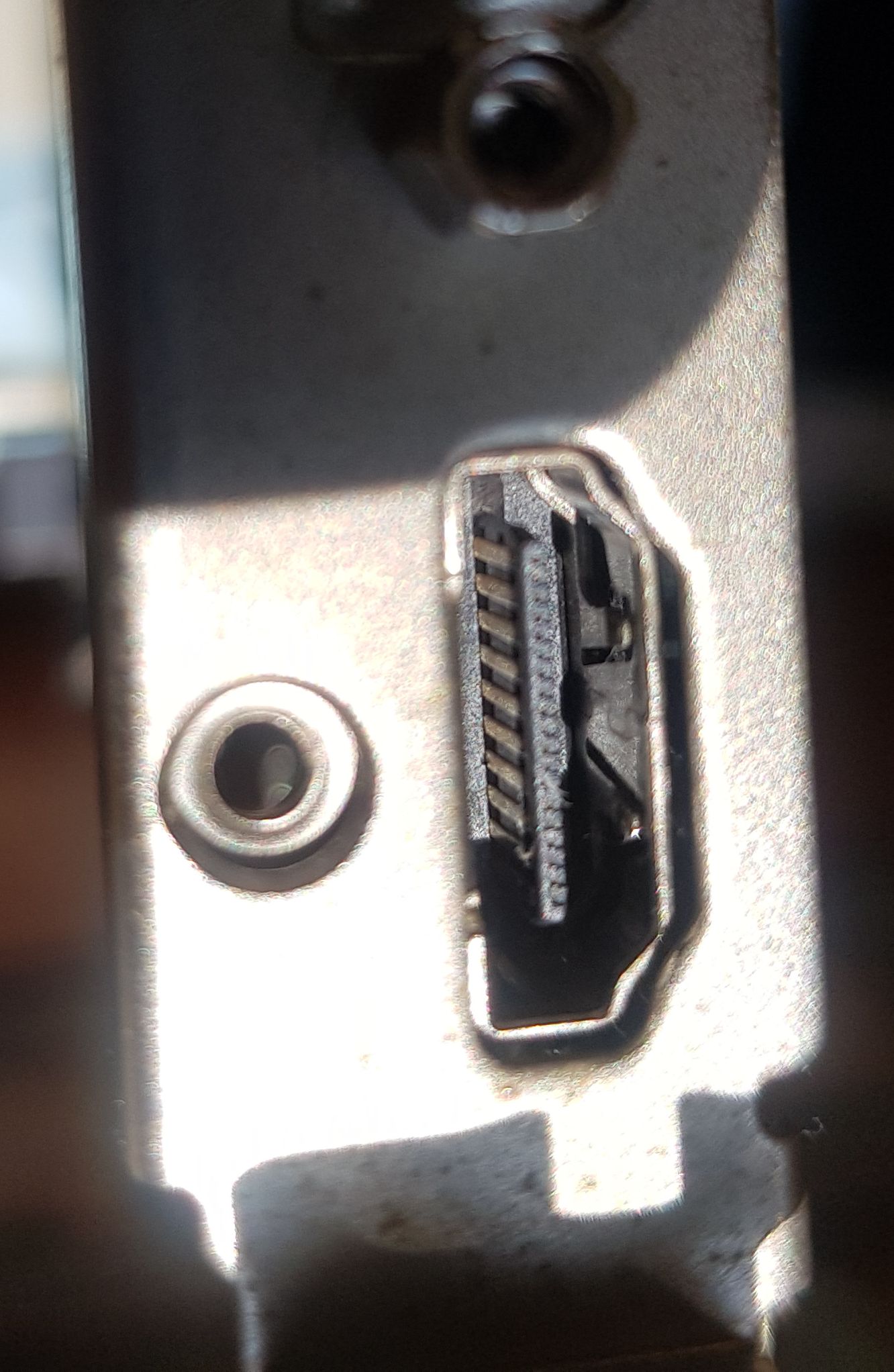

    That last pic looks like a broken HDMI connector to me - it could just be the angle.
    Take an old HDMI cable, cut one of the plugs off it and strip the wires back. Plug it in and measure continuity from each wire to the PCB at or near the HDMI socket.

      Connector is fine (there is a symmetrical gap at the bottom of the metal part which may look deceiving) Cables plugs in without a problem and sits fairly tight.
      I measured continuity of 19 pins from cable to rear end of the connector. (I couldn't see further tracks on pcb unfortunately). All measured OK.

        Another strange thing (maybe related?) about the card is GPU-Z always shows it as having Elpida memory regardless of which vbios I install.
        Here it says there's a resistor for specifying which rams are installed on the board but I don't know
        1. where it's on this board
        2. Why would it be set to Elpida
