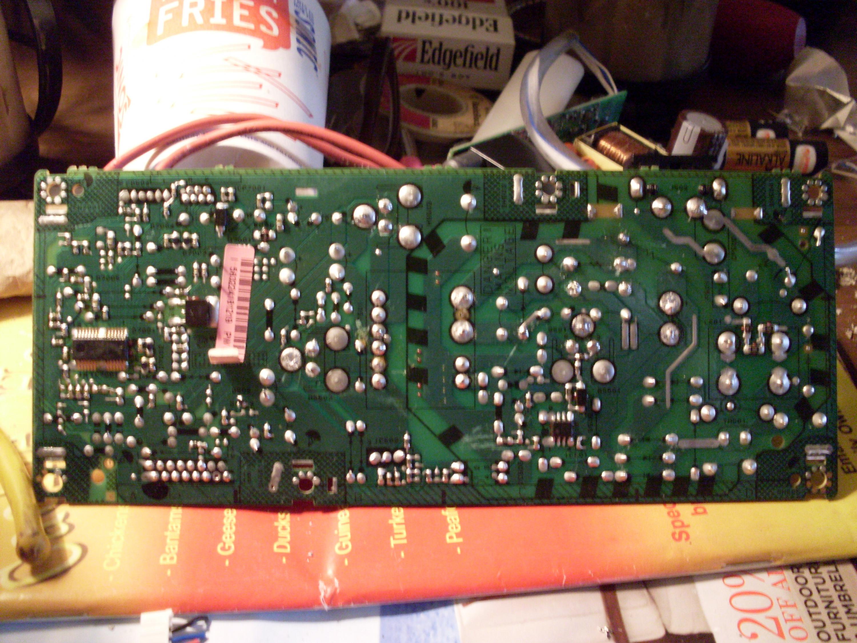

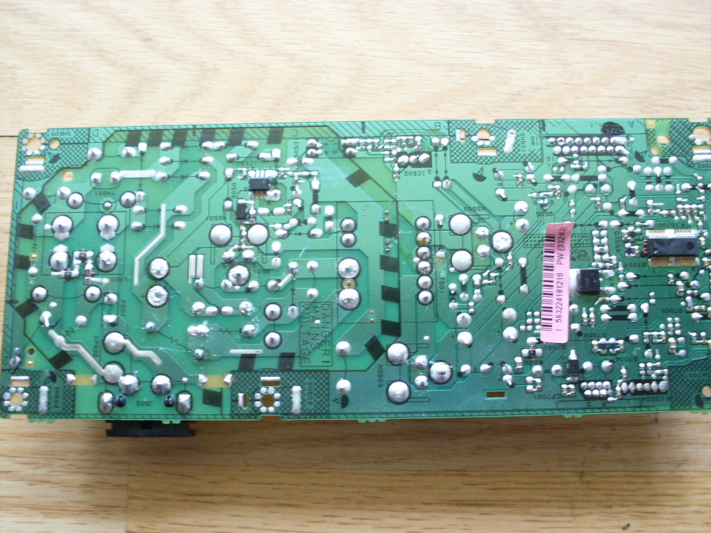

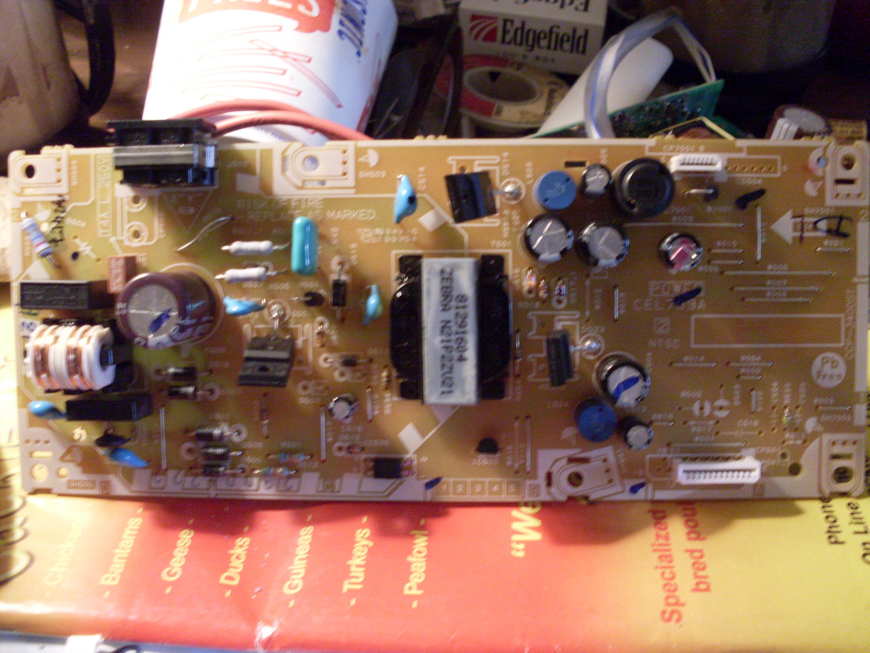

    Trying to fix this set for friend of mine there is no standby light at all he said heard pop and quit working. Fuse is good I found a blown 0.22 ohm resistor replaced that now have 170v across main cap he purchased new mainboard from ebay but the prob lies in the psu somewhere cant find schematics anywhere what I think is the startup cap 50v 22uf has 10v across it any help would be much appreciated here is pics of the psu below thanks for looking P.S also tested large diodes and mosfet out of the board tested okay tested all smaller diodes in board tested okay

    Sorry... you got to make better pics than that. Everything is just a big blurr.

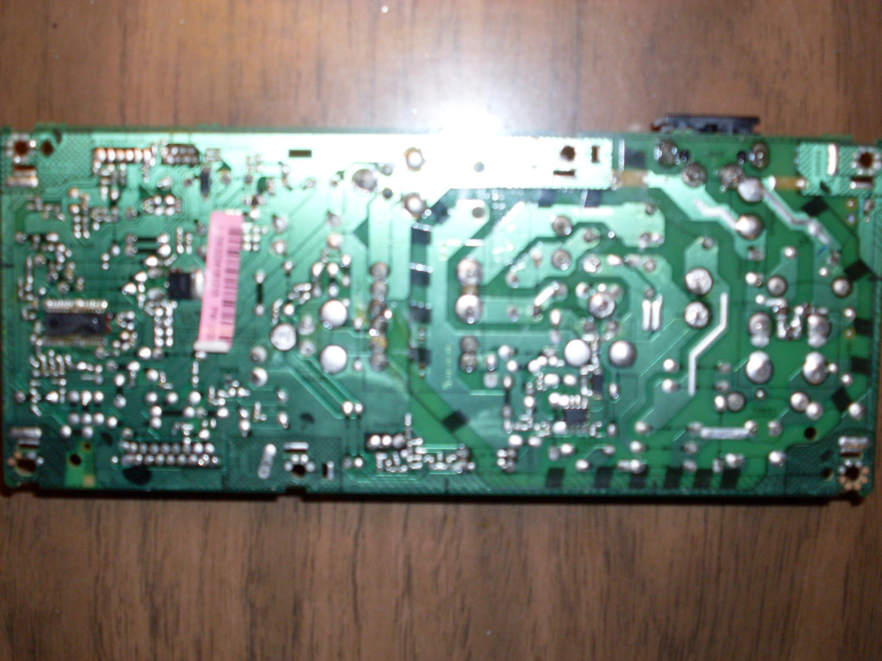

      Here Are Clearer Pictures I Hope This Helps

        Not really... those are better, but I still can't read not a thing. Be careful there are lethal voltages in the primary circuit. Plug the PSU in and see what you get on the main filter cap.

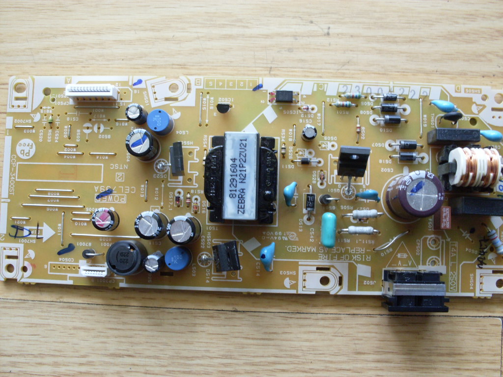

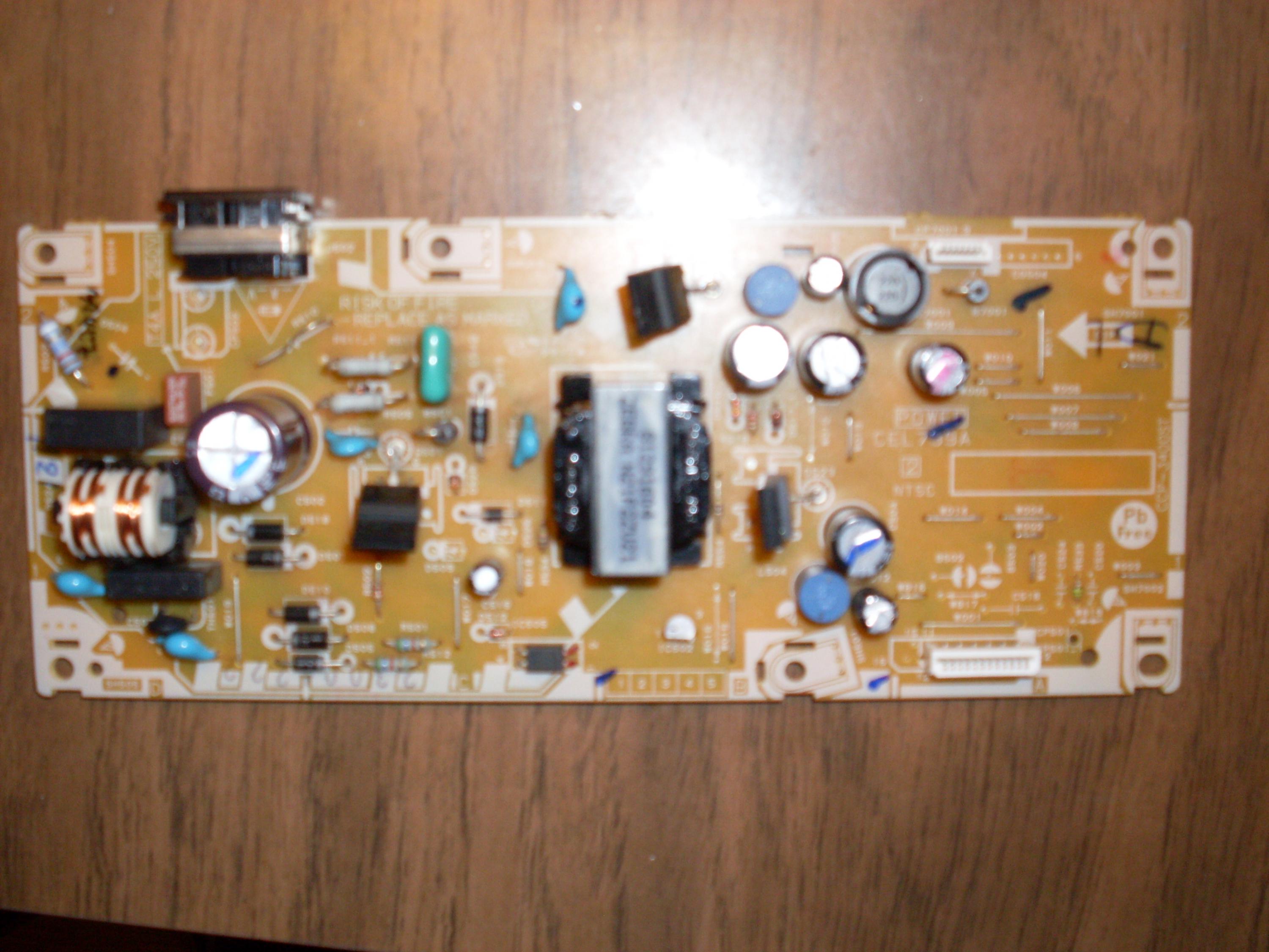

            sorry about crappy photos I think you can read these now LOL my cam really sucks!!

              With power disconnected, try checking large transistor Q501 for a short. Really surprised it's not heat sinked.

                  I think I just found my problem the opt coupler is wide open both sides

                                    The 10v across the startup cap appears a bit low. It should be connected to the vcc leg of the 8-legged pwm smd chip on bottom of the board. If yes, then try replacing the startup cap and see what happens.
