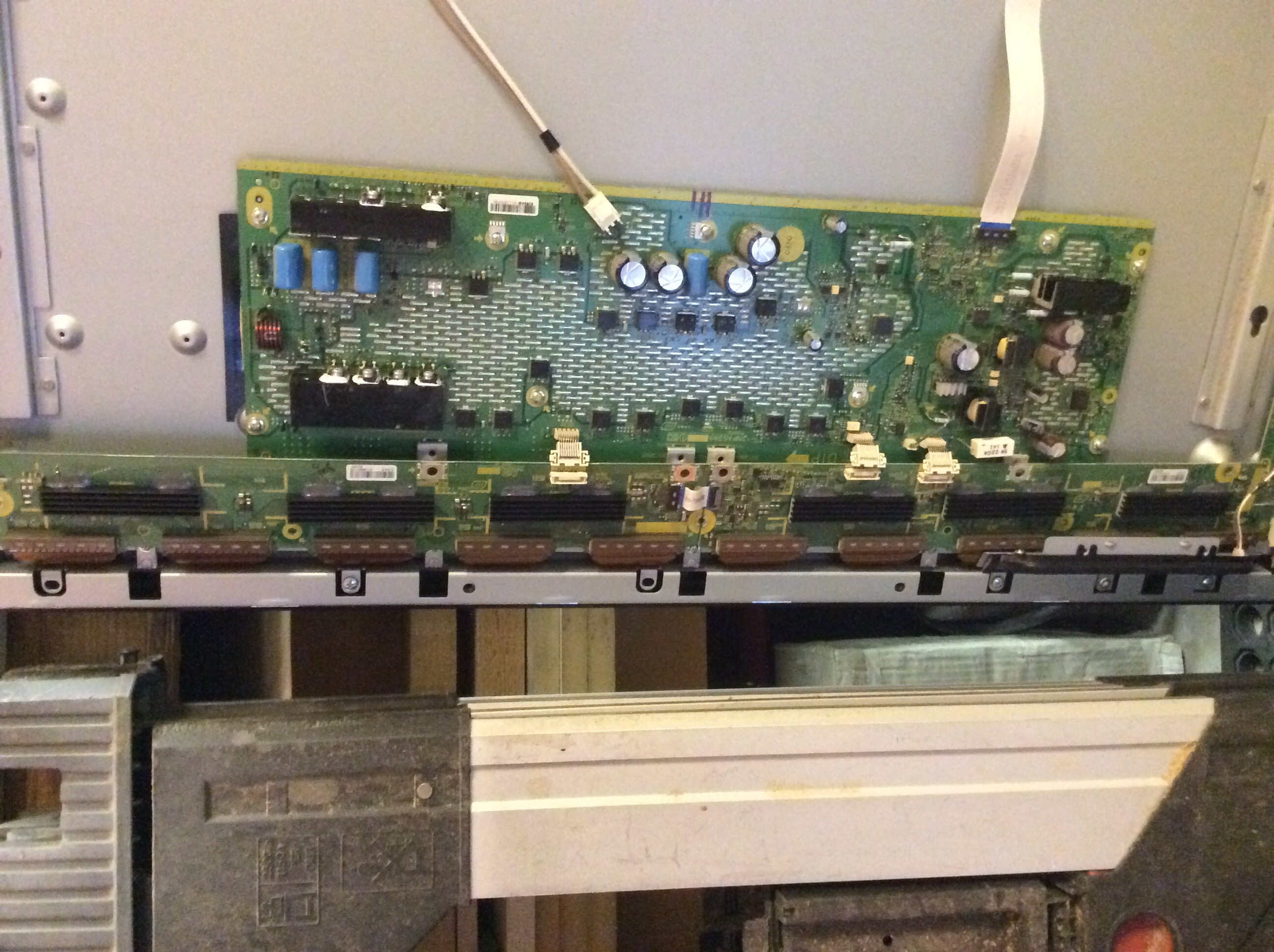

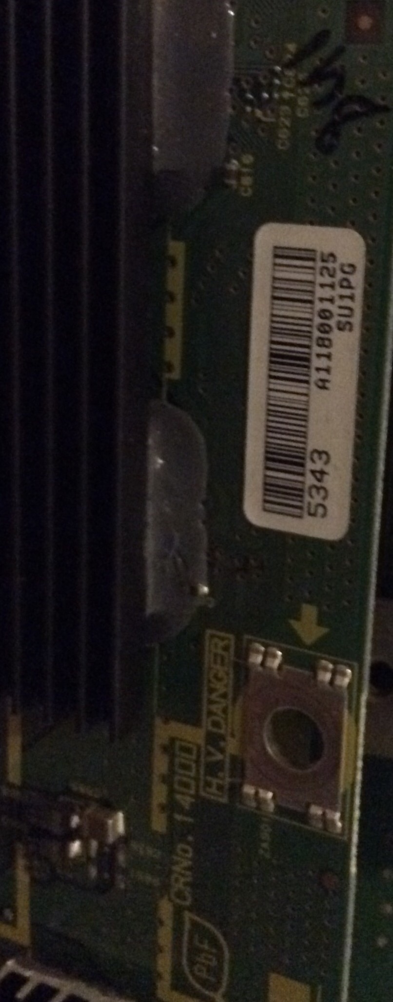

              Please excuse my delay. Here are some pics, let's see if I can post more than 1 pic.

                so looks like AB is no heatsinks and no revision has them . So that encompass data looks to be out but either would work of course going for the heatsinked version would be preferable. I think I'd clarify with SJ or whoever you choose and specify you want the no revison with heatsinks . there's a few listings on Ebay too some quite cheap

                  Ok I couldn't finish posting info and I can't upload more than one pic at a time. Anyway,
                  Here are all boards perspective numbers letters: SD=5344-TNPA5344, SU=5343-TNPA5343, SC=5399AB-TNPA5399. Hope this helps more. Again thanks for your time.

                    Yeah, I got what I wanted from the 1 pic. Anyway, that's pretty lucky less than $40 for a SC board, the buffers you'll just have to fight your own battle with whoever to try and ensure you get what you want but still worth getting extras and / or testing yours. 50/50 chance they're ok but don't chance fitting a new Sc without being sure they're not shorted
                    Quick test would be to check between the Vfg gnd plate on the buffer and slide the other probe along the face of each ribbon connector and watch for low ohms or shorts or use continuity/diode mode and if you get constant beep then is bad.

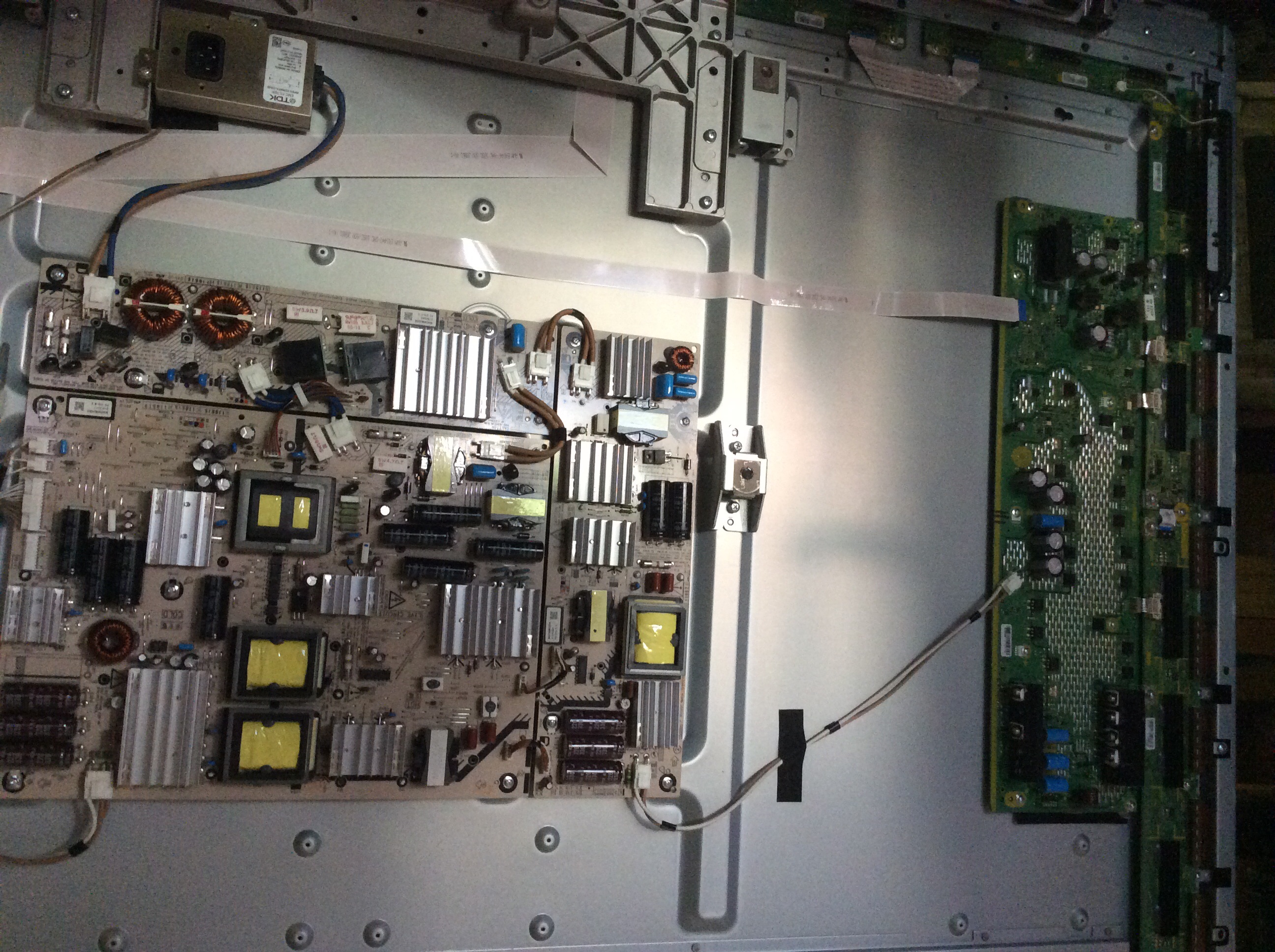

                      Here is a pic of all three boards.
                      • tw2005
                        • Oct 2011
                        • 6458
                        Re: Panasonic TC-60PS34 red light flashes 7 times
                        I got it.
