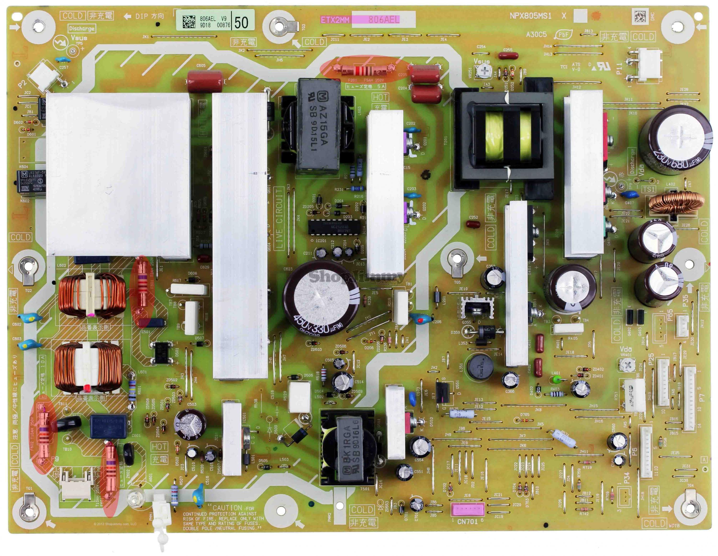

    Check Fuses F201, F501, F601, F602.

      Yeah, how do you check those fuses? I've never seen those types. They are white with colored bands...how would you know if they are bad other than removing them from the circuit and seeing if they are "open"? By the way, while still soldered to the board, they measure .4 or .5 ohms...none are open...

        Set your DMM on continuity test on the 4 fuses in the picture shaded red, if it doesn't beep, it means the fuse is bad.
          Re: Panasonic Plasma TC-P50S2 Lightning Dead
          While still soldered to the board, they measure .4 or .5 ohms...none are open...all beeped

            Anyway do you know how to solder and use the DMM? IFyou can then I can give you a procedure to test the Power Board then that way you'll save gussing time and determine if the Main Bd is the culprit. However, when you look at the underside of the Power Bd d0 you notice if any of the copper traces are burnt out?

              lol...yes...living island was just a great place for an 8 year old to spend a few minutes on saturday mornings...yes, I know how to solder and use dmm...when you say underside of the p board do you mean back side, as in with it removed (because I have not removed it yet) or do you mean the bottom of the board? I went ahead and pulled the board, the back (the joint side) looks good.

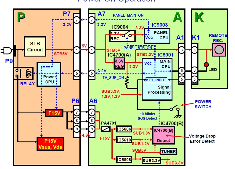

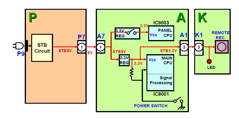

                A board is quite vulnerable with lightning especially the HDMI ports, I've seen photos of components blown up or burnt around those. Check if 5V stdby is available at either A7 or P7 pin1, if so the A board is dead because from there the A board then uses that to power the front LED via a regulator. may want to isolate P7 too if there is not 5v stdby and check again in case the A board at A7 pin 1 is shorted.

                  thanks tw...I think that means put dmm meter on "DC" and check for voltage with the positive lead on A7 or P7 pin 1...where do i put the negative lead...is there a good place to ground the negative lead (chassis, a place on the board, or some other place)?

                    chassis or any of those board bolts that have earth pads under them and yes DC 5v. since something went pop, there may be a visual burn on that A board or component with a hole in it's head.
                      i've got 5v dc at p7 pin 1
                        Well the A board has an issue.
                          okay...so is it possible to troubleshoot the A board and replace bad parts (i suppose there could be many) or better to replace the whole board? Also does further trouble shooting need to be done on the A board to confirm that it does not have other issues? Or does the 5V standby test tell us that all is well with the A board?

                              Do as tw2005 suggests That way you will probably determine is the A bd is defective. However if you are getting on connector P7 at pin1 5Vdc that is a good sign too.

                                tells me the P board is at least producing standby voltage, from there the A board should then have the front LED lit, which it does not, and the F15v and relay clicks, also not present.
                                A board is dead in my opinion.
