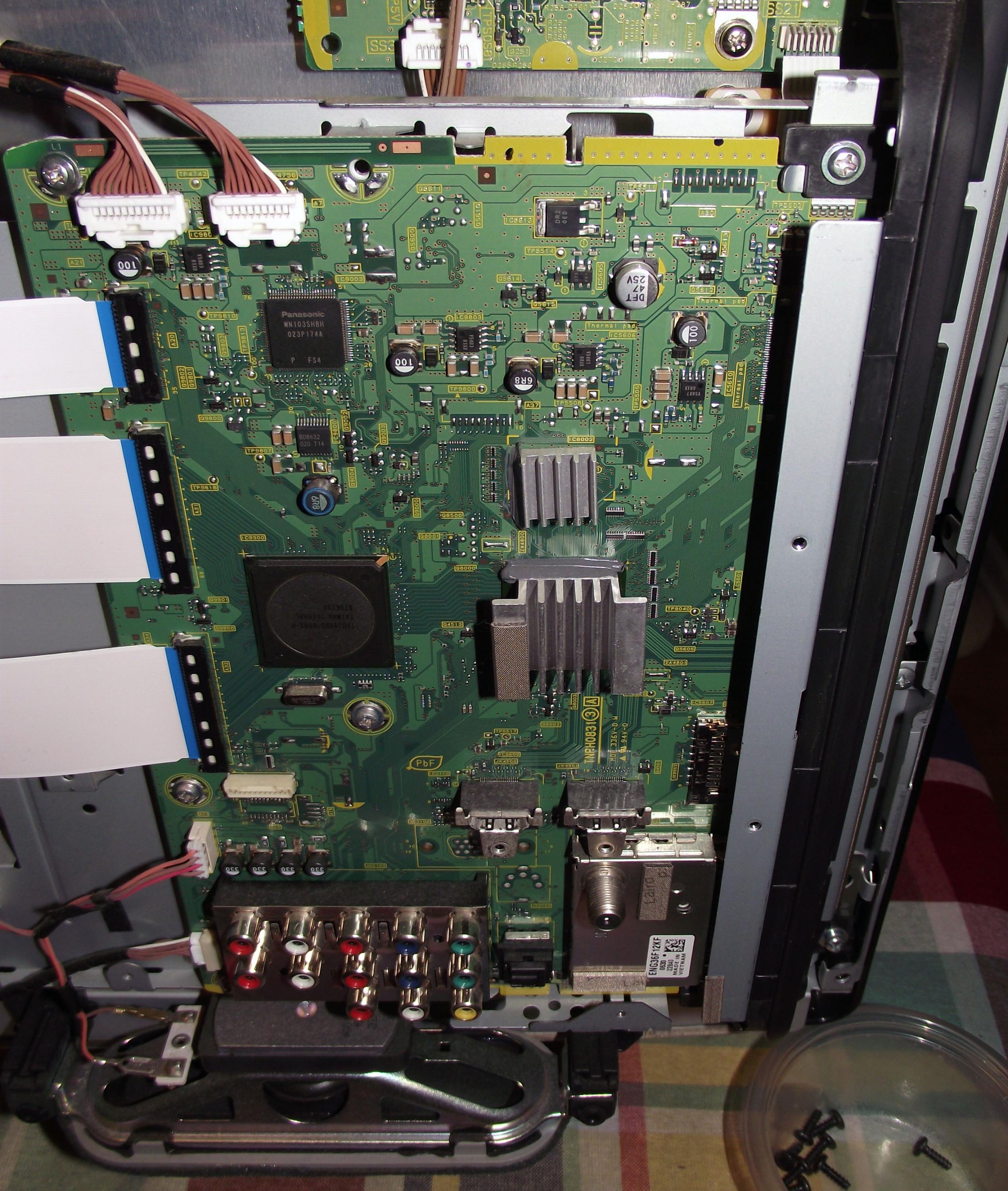

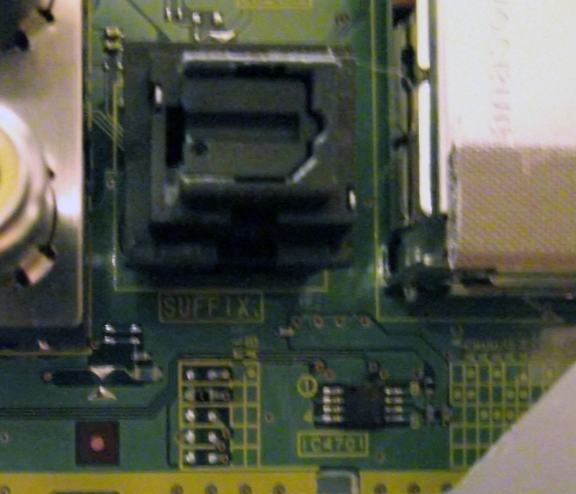

    can we get a picture of the A board. owned this from new? AB revision is looking like a 46" board. this is a 50S2, yes?

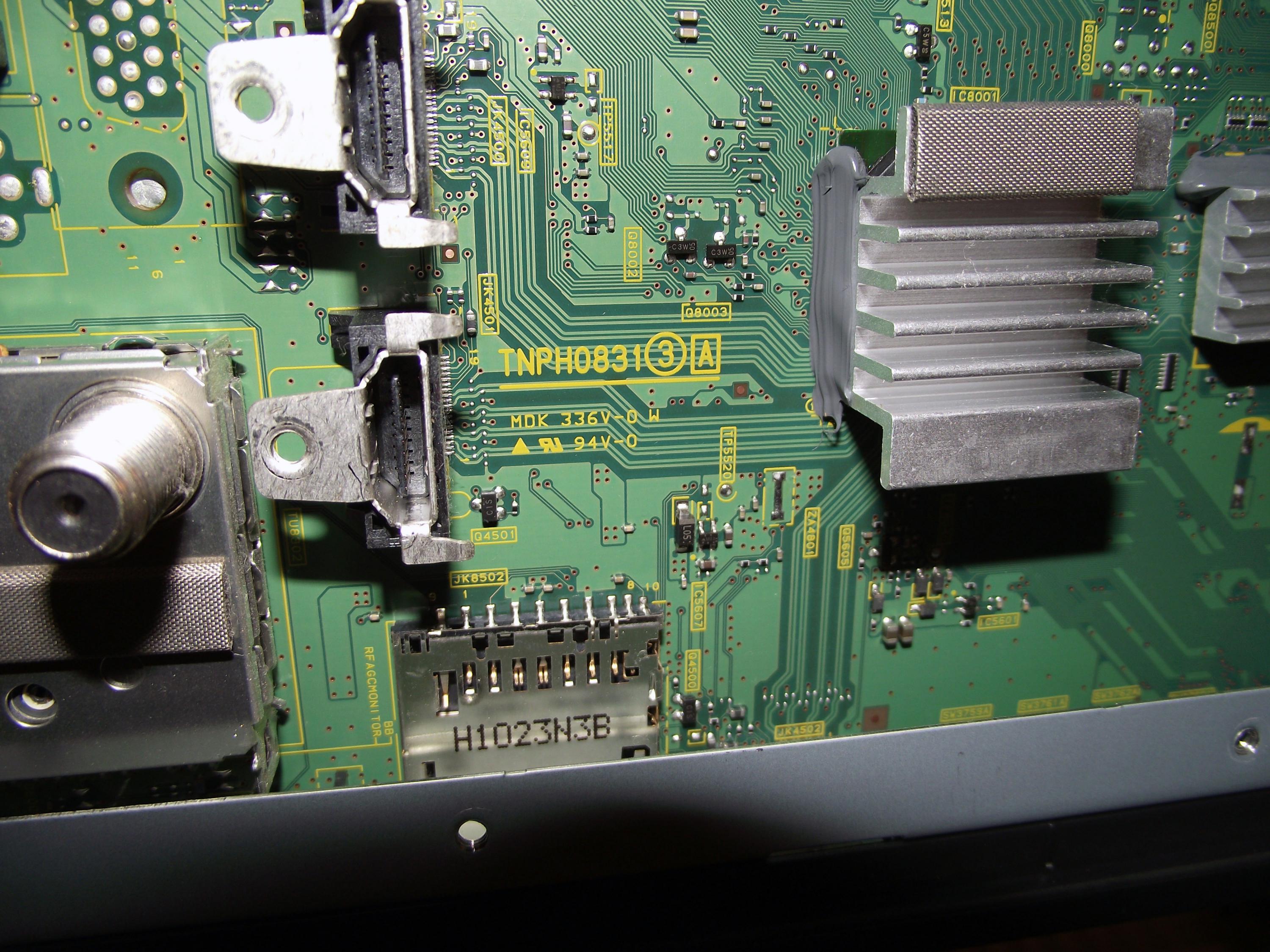

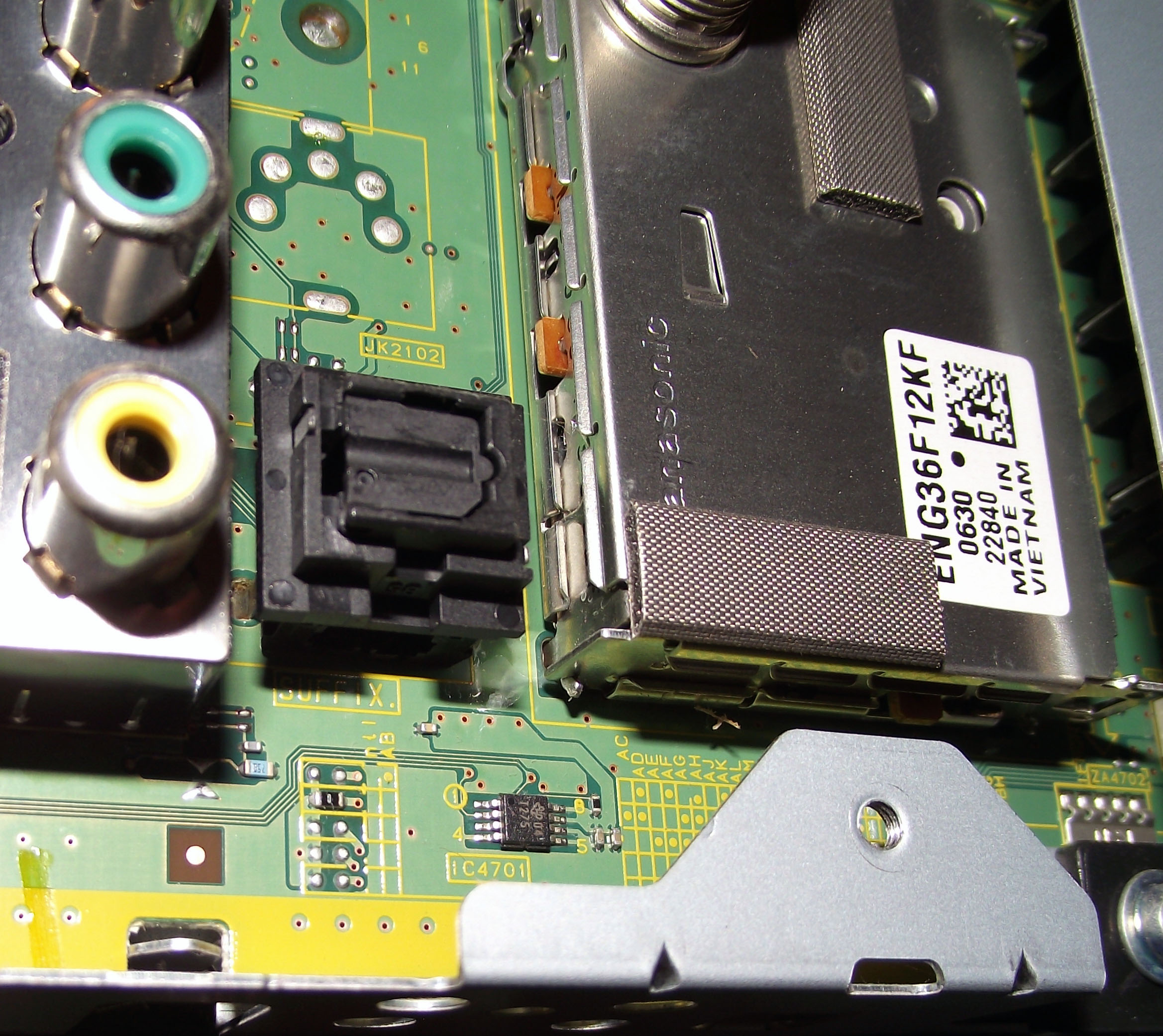

        Thanks again...yes, I have owned since new and never had a problem...the pics should show the pertinent info...night time here so I apologize that I had to use flash instead of natural lighting

          yes it does show pertinent info. rev of your board is AC

            yep...i just watched the shop jimmy video of how to find suffix revisions...i assumed the "AB" located near the "SUFFIX" letters meant it was an "AB" version...but it looks like the jumber locations under the suffix letters determine the version...seems to me this is great news! thanks again TW
              i guess it is because modus charge $180 for rev AB. Also means you won't pay $150 for the incorrect board
