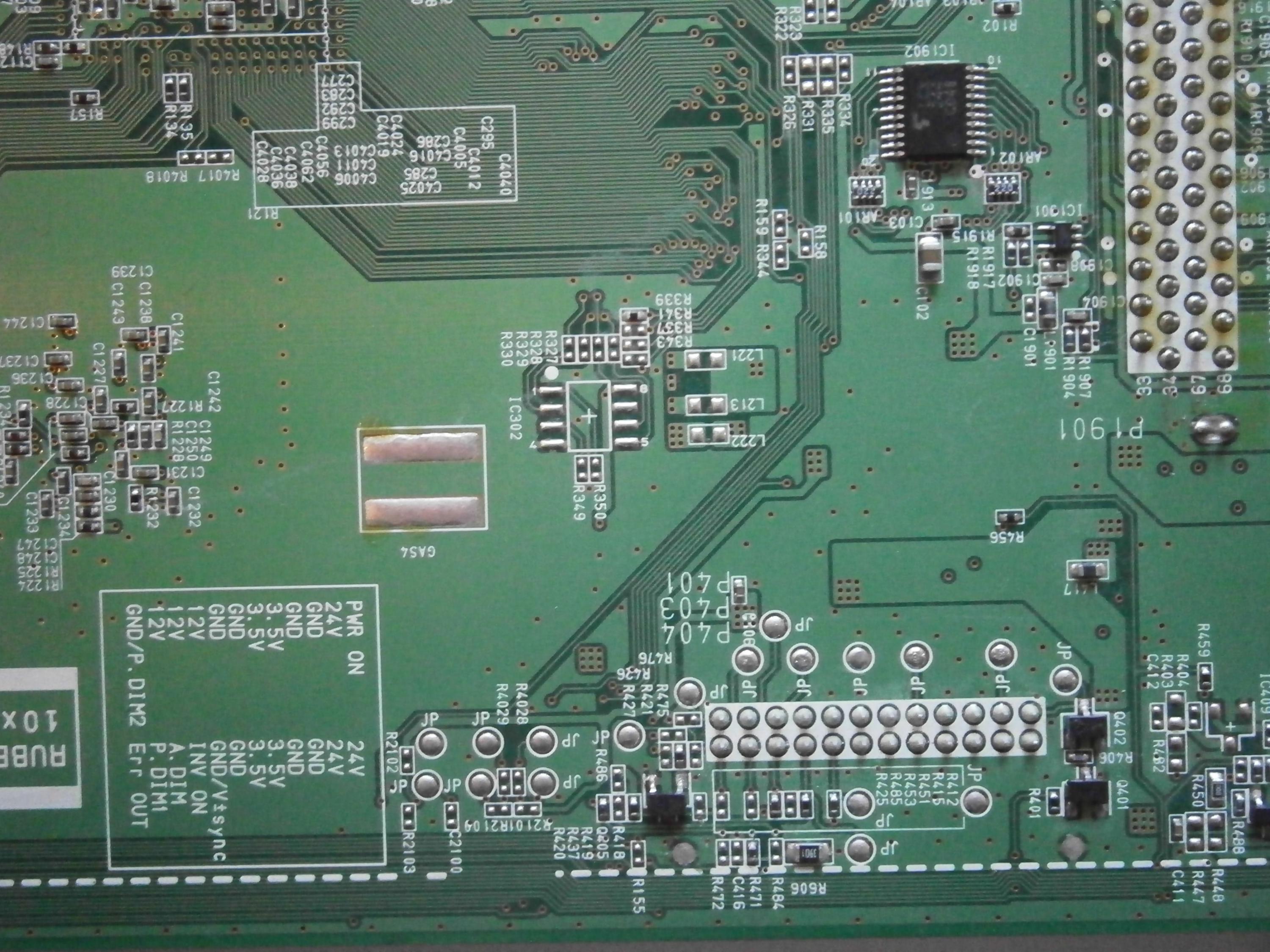

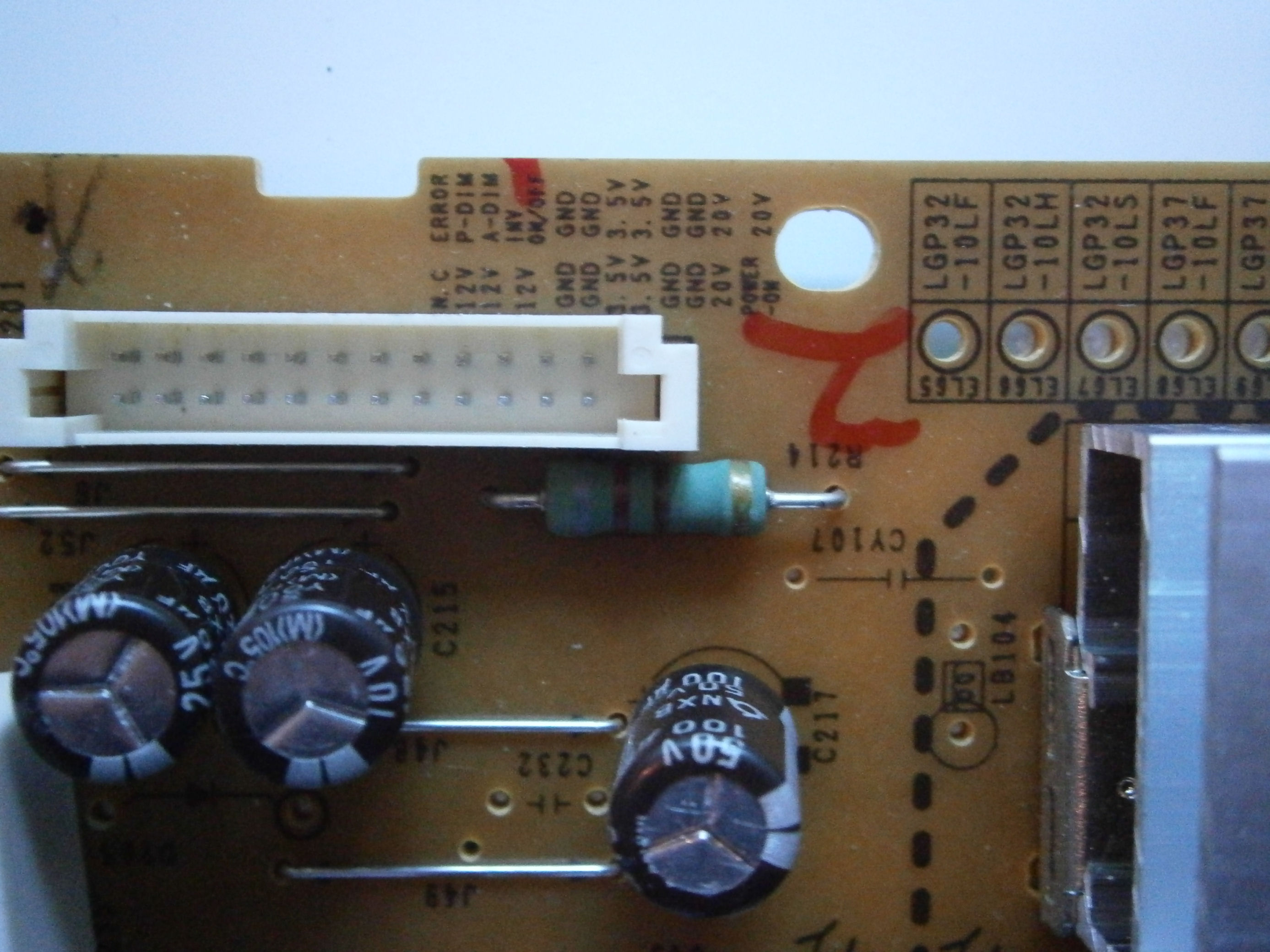

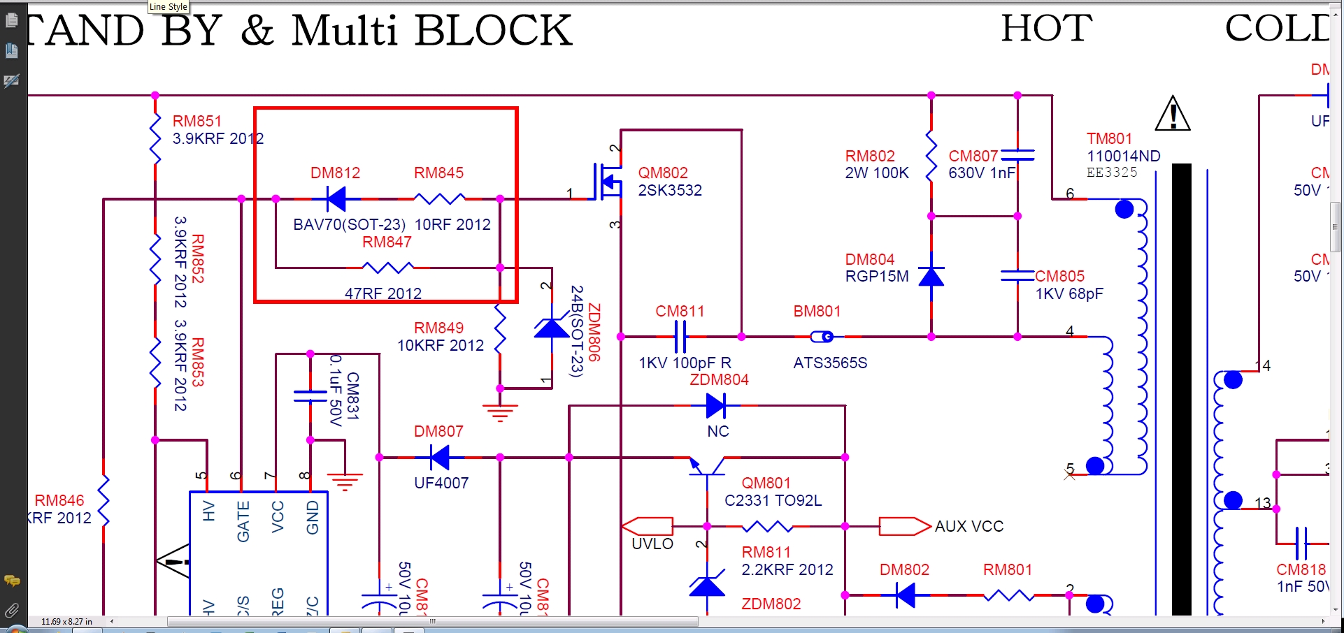

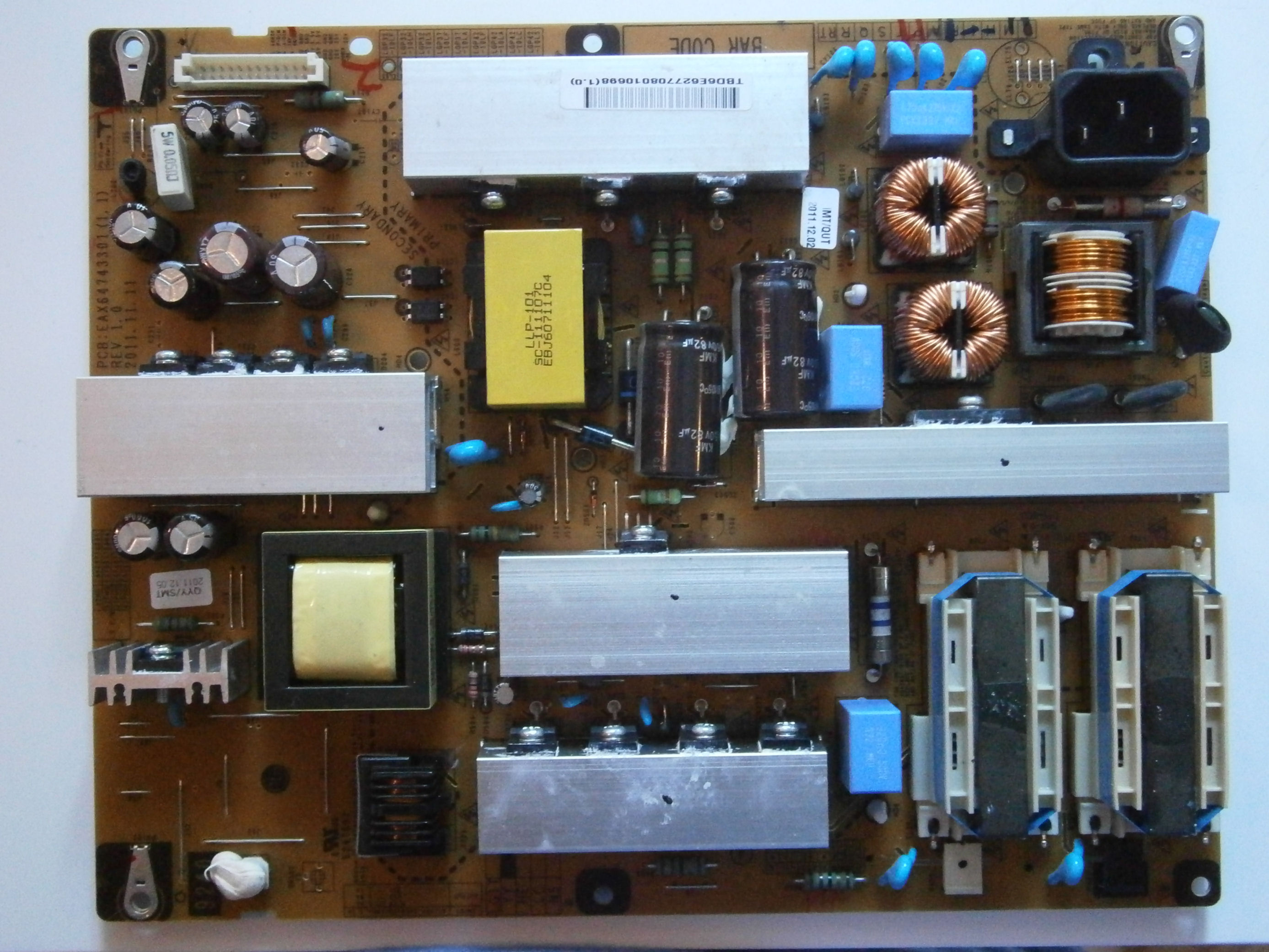

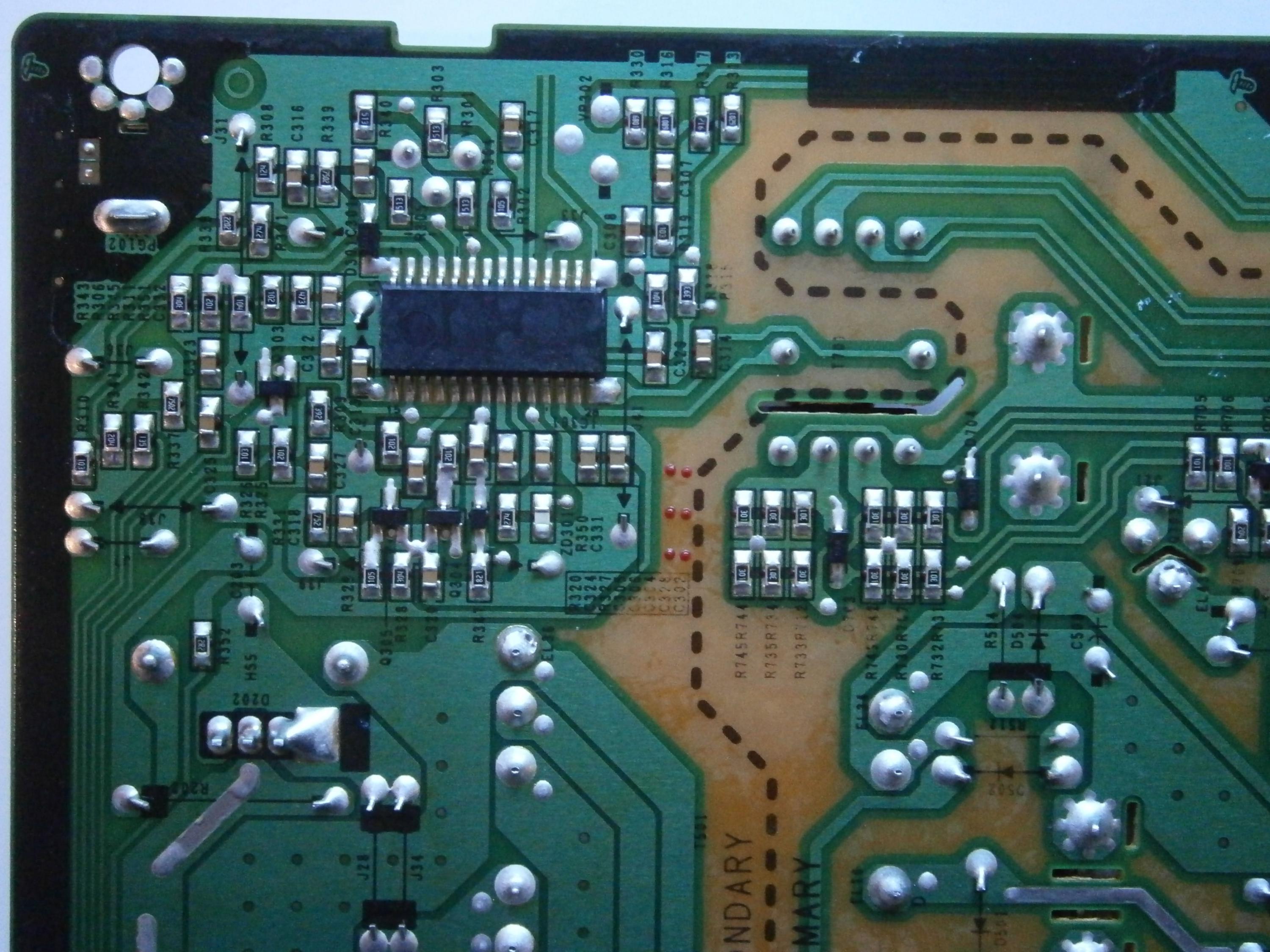

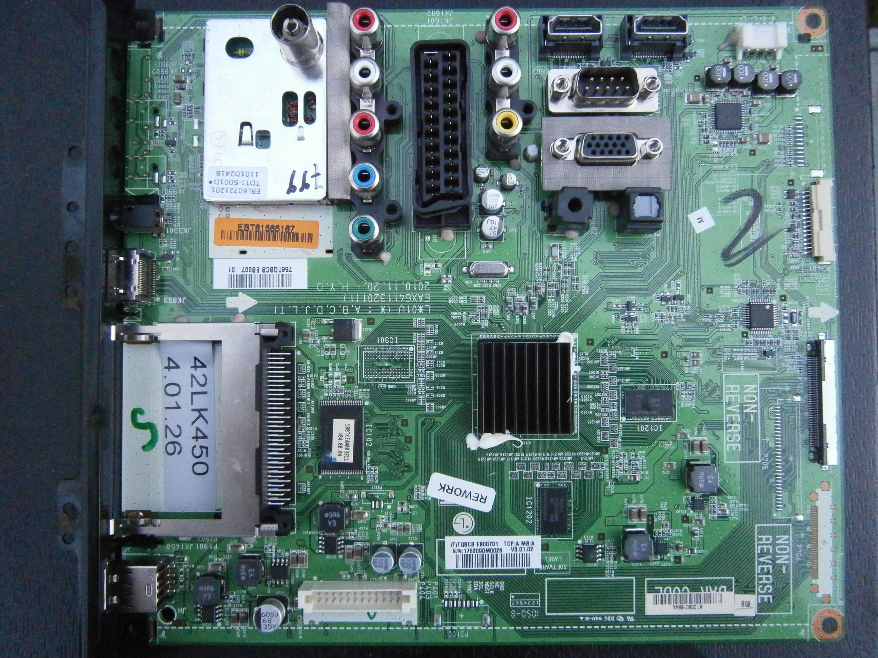

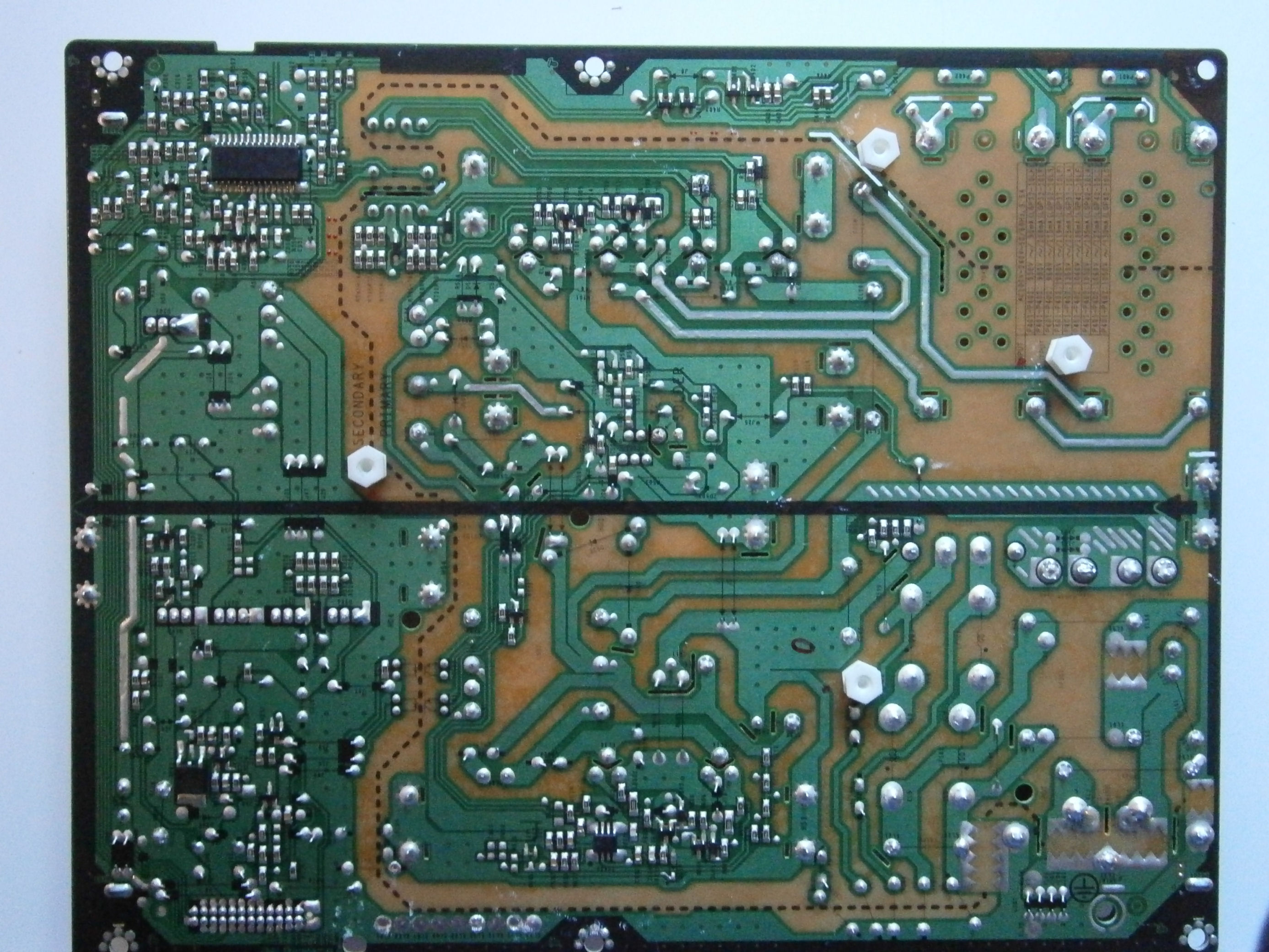

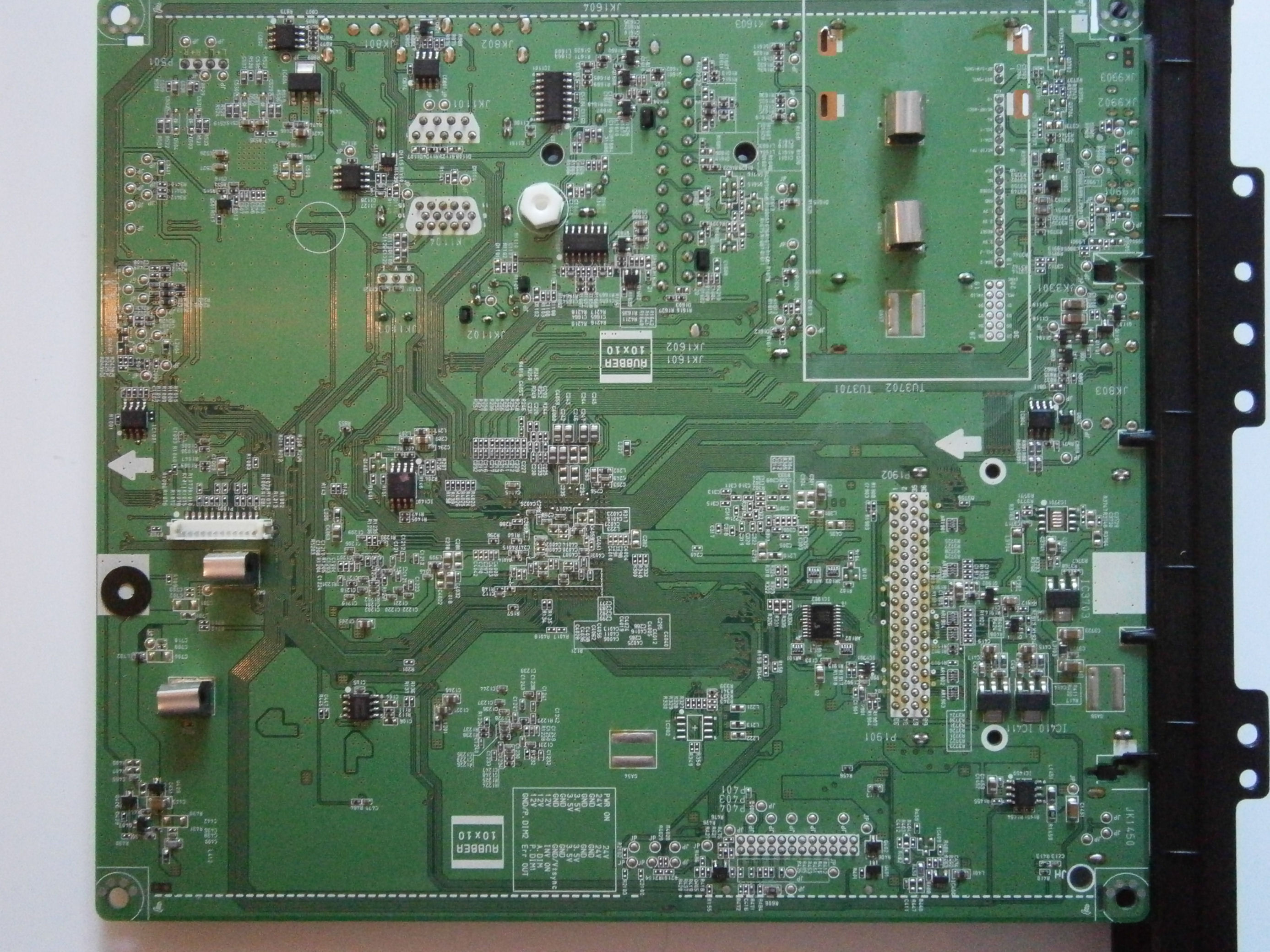

LG 42 LK 450N won't start
  • manoftheyear
    • Nov 2010
    • 39
    • Europe
    LG 42 LK 450N won't start
    Hello
    TV goes on and blue led lights on for 5 seconds, then the tv switches off and red led comes. Screen stays black all the time.
    something wrong with the power supply voltages, when the TV is on for 5 seconds my DMM shows P. Dim runs between 0v and 3.1v, A. Dim somewhere between 1.7 and 3.1v, INV_ON and Error out rails go from 0v to 3.4v.
    Can the inverter and the backlights be checked by jump wiring? I tried a jump wire (680 ohm resistor between) from the 3.5v rail to INV_ON and PWR_ON. Nothing happens. By doing this the main filter cap has only 330v (line is 230AC), PFC not working this way?
    Service manual here https://cdn.badcaps-static.com/pdfs/...b64fd020f0.pdf
    Not the exact same but many similarities and mostly same components.
  • manoftheyear
    • Nov 2010
    • 39
    • Europe
    Re: LG 42 LK 450N won't start
    Anyone? Where to start, which board to suspect? A little 'tick' kind of sound can be heard I believe from the PSU each time the voltages drops and raises.
    • Andrew F. Ali
      • Jan 2014
      • 2450
      • Trinidad & Tobago
      Re: LG 42 LK 450N won't start
      Post pics of the PSU Bd and the back of the TV.
      Are you getting StdBy 5V when you plug into the AC without trying to turn it on?
        Re: LG 42 LK 450N won't start
        INV ON , >2.5VDC = ON, <1VDC = OFF, the command signals are generated by the main board not by the power supply board.
        How about the Voltage for running the inverter board? I cannot tell much until I can see the pictures of the boards and the whole back side of the TV.
        • manoftheyear
          • Nov 2010
          • 39
          • Europe
          Re: LG 42 LK 450N won't start
          Some pictures attached. IF you need more or any specific let me know...
          Standby is 3.5v and working fine. While the tv is on for the five seconds, 3.5V, 12V and the 20V that is for the inverter are all ok. The ones I mentioned in the first post go up and down.
          • manoftheyear
            • Nov 2010
            • 39
            • Europe
            Re: LG 42 LK 450N won't start
            So so.. This LG is a no go? Any help appreciated.
            • adamp91gvm
              • Jan 2014
              • 706
              • uk
              Re: LG 42 LK 450N won't start
              I have thelg 42lv450u same issue i have had it on once it clicks to come on red light blinks goes white for a second and goes off it the av board for sure
              • adamp91gvm
                • Jan 2014
                • 706
                • uk
                Re: LG 42 LK 450N won't start
                Anyone ??
                • manoftheyear
                  • Nov 2010
                  • 39
                  • Europe
                  Re: LG 42 LK 450N won't start
                  Back to my case. by putting a jumper wire from the 3.5v rail to the pwr_on and inv_on the power supply goes on, all the voltages measured from the psu connector are stable and right on the spot, even the rails that are related to the inverter circuit... but still the backlights won't come on? should I suspect the inverter board or a ccfl tube here?
                  • adamp91gvm
                    • Jan 2014
                    • 706
                    • uk
                    Re: LG 42 LK 450N won't start
                    If i turn mine on then disconnect the av board from power my back light comes on fine ? And by on i mean press the buttom on the remote then wait for the 1st click then take av power lead out
                    Last edited by adamp91gvm; 08-19-2015, 11:49 AM.
                      Re: LG 42 LK 450N won't start
                      Originally posted by manoftheyear
                      Back to my case. by putting a jumper wire from the 3.5v rail to the pwr_on and inv_on the power supply goes on, all the voltages measured from the psu connector are stable and right on the spot, even the rails that are related to the inverter circuit... but still the backlights won't come on? should I suspect the inverter board or a ccfl tube here?
                      But do you still only get 330VDC between the two legs of the main filter cap? The inverter circuit needs that PFC boosted Voltage for it to run.
                      Last edited by budm; 08-19-2015, 12:07 PM.
                      • manoftheyear
                        • Nov 2010
                        • 39
                        • Europe
                        Re: LG 42 LK 450N won't start
                        Originally posted by budm
                        But do you still only get 330VDC between the two legs of the main filter cap? The inverter circuit needs that PFC boosted Voltage for it to run.
                        No, I don't know how I got a reading like that before. It's now 386VDC.
                          Re: LG 42 LK 450N won't start
                          Originally posted by manoftheyear
                          No, I don't know how I got a reading like that before. It's now 386VDC.
                          That is good, so the fuse (white body with 2 color stripes on it) next to the two inverter transformers is good?
                          Last edited by budm; 08-19-2015, 12:21 PM.
                          • manoftheyear
                            • Nov 2010
                            • 39
                            • Europe
                            Re: LG 42 LK 450N won't start
                            Originally posted by budm
                            That is good, so the fuse (white body with 2 color stripes on it) next to the two inverter transformers is good?
                            Well actually, it ain't... DMM shows OL. How in the hell did I miss a fuse of that size is beyond me. Probably too much going on at the moment.
                            Q702 that's a Mosfet 5n50 is shorted. Should I expect the diode connected to the gate to be bad too?
                              Re: LG 42 LK 450N won't start
                              Originally posted by manoftheyear
                              Well actually, it ain't... DMM shows OL. How in the hell did I miss a fuse of that size is beyond me. Probably too much going on at the moment.
                              Q702 that's a Mosfet 5n50 is shorted. Should I expect the diode connected to the gate to be bad too?
                              Yes, the GATE R/D network and more likely the IC that drives the Gate will be damaged also.
                              • manoftheyear
                                • Nov 2010
                                • 39
                                • Europe
                                Re: LG 42 LK 450N won't start
                                You mean the IC BD9270F? You think by changing these I might be ok?
                                  Re: LG 42 LK 450N won't start
                                  Originally posted by manoftheyear
                                  You mean the IC BD9270F? You think by changing these I might be ok?
                                  You need to check all the components connected to the MOSFET and replace the IC so you will not be taking the chance of blowing up the new MOSFET.
                                  • manoftheyear
                                    • Nov 2010
                                    • 39
                                    • Europe
                                    Re: LG 42 LK 450N won't start
                                    Sorry this had BD9240F that is a 28 pin IC You have datasheet for that? How about the SMD diode connected to the gate, what would be a good substitute?.
                                      Re: LG 42 LK 450N won't start
                                      Bd9240 SPEC.
                                      SMD diode connected to the gate, 1N914/4148 (the example circuit from SAMSUNG shows the diode as BAV70, so look up the spec for the electrical rating) may be fine, the diode is usually connected in parallel with 10~100 Ohms resistor so when you test the diode it will show conduction in both direction.
                                      Last edited by budm; 08-19-2015, 03:42 PM.
                                      • manoftheyear
                                        • Nov 2010
                                        • 39
                                        • Europe
                                        Re: LG 42 LK 450N won't start
                                        Update to this. Replaced the components mentioned in this thread. TV now works fine. Thank you.
                                        • Till
                                          Broken power button (keyboard). How to jump start notebook?
                                          by Till
                                          Hi
                                          Yesterday while browsing the internet with my laptop I noticed that 3 keyboard buttons were not working anymore.
                                          Today, the notebook doesn't boot anymore. My assumption is that the keyboard went bad because the power button is on the keyboard.
                                          Is there a way to jump start directly from the motherboard?
                                          I tried to short all the pins of the connector for the keyboard cable with no luck.
                                          I found the schematics here on badcaps, but I didn't find the pin out for the keyboard. But truth be told, I am just a hobbyist who tries...
                                          07-31-2023, 06:33 PM
                                        • Paul Hartung
                                          Schematic HP Envy x360 13-ay0175ng (looking for pins to jump start)
                                          by Paul Hartung
                                          Hey guys, long story short, I need the schematic for my “HP Envy x360 13-ay0175ng” motherboard to see what pins I need to short to start it up without a keyboard attached.
                                          10-18-2024, 12:56 PM
                                        • RainStorm
                                          Toshiba 49l621u BL_ON to DIM jump repair
                                          by RainStorm
                                          I just got this TV in today, and originally it would flash the logo and have no backlight afterwards. I could see the image without the backlight with a flashlight.
                                          Having no 9V batteries or anything on hand, and all the backlight LEDs looking fine during the flash, I decided to jump BL_ON and DIM on the power board/mainboard (White and purple wire) with them still plugged in using some scissors to connect my shielded voltmeter cables.
                                          After jumping a few times, the backlight stayed on. Why?
                                          I didn't measure any voltages beforehand... So just wondering...
                                          09-07-2021, 01:48 PM
                                        • petehall347
                                          car jump pack build lipo
                                          by petehall347
                                          just had a brainwave .
                                          i have here a good set of 18650 cells from a 36v pack . and am wondering how easy and if it will work to be arranged for a 12v jump pack for cars etc . .
                                          just wondering about charging it .. i know it will need the correct bms . its the charger bit i am stuck on .. will a linear charger work ?
                                          05-07-2021, 06:30 PM
                                        • ktmmotocross
                                          Asus X550cc run only when jump first mosfet
                                          by ktmmotocross
                                          Hello.
                                          I have this Asus X550cc that run only when i jump first mosfet. All reading looks good/ACDET, ACOK, VCC/. i replaced two capacitors on gate of that first mosfet, i replaced second mosfet which was shorted, i replaced BQ ic, but still wont run.
                                          Any advice for this board?
                                          08-16-2020, 10:47 AM
