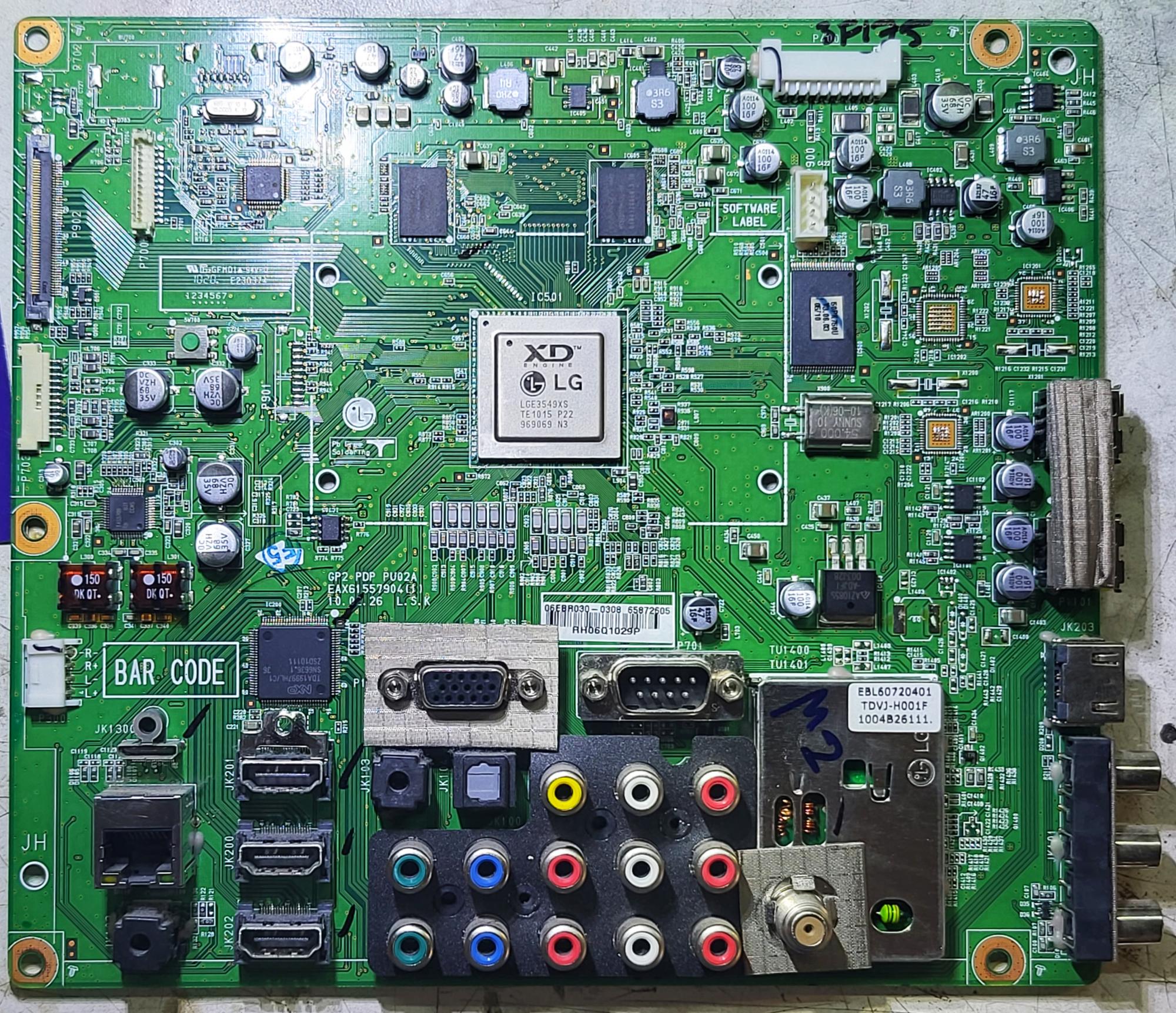

                          I hate to bring a thread back from the dead but there's some pretty good information in here and I'm experiencing the exact same issues with the TV I just picked up.
                          Rather than start a whole new thread I'd like to ask if anyone knows Which mainboards are interchangeable within the PK-series.
                          • KYBOSH
                            • Oct 2011
                            • 581
                            • Unknown
                            #33
                            Re: Lg 50pk750

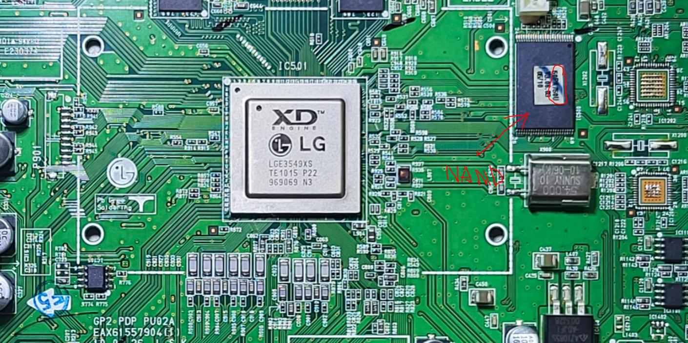

                            To give a little more context i did the test pattern test mentioned above and found that the mainboard is the most likely culprit.
                            I looked over the board, testing, probing, looking for shorts amd found nothing. Everythjng looked good. I thought it maybe an EMMC issue but read about the BGA being the moat likely problem. I put some heat to the processor for a little while and tried it in thr set but no joy. I noticed the PCB was a little bowed around the BGA but i dont know if that was a result of me heating the chip or if it was always there (a result of the thernal pad and heatsink pressi against the chip for the last 13 years).

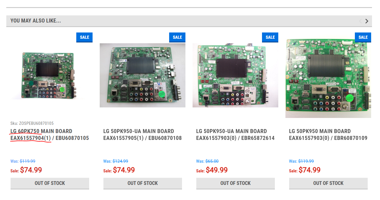

                            Anyway i wanted to see what the market for replacment boards while i continued troubleshooting. I came across this thread and saw that a nunber of board will work.
                            I also nocticed tbat the board that is in this TV, EAX61557904 (1)
                            , is not native to the 750 series but rather the 950. This is based on my googling.
                            This is why inwant to verify the compatibility of boards across the PK series. This board may actually be good but not compatible with thjs TV as i dont know what, if anything the previous owner has done with it.
                            Thanks in advance!

                              Re: Lg 50pk750
                              There is no eMMC here, NAND Flash here and the board matches the 750 model as well.

                                Re: Lg 50pk750
                                Thank you for your response @Lotas. Always a pleasure getting correction from you.
                                Yes you are right... My mistake I meant to say a BIOS issue rather than EMMC issue. I think I had another TV on my mind when I wrote that.
                                Also I checked shopjimmy.com, tvpartstoday.com as well as a few others and they all had EAX61557904 (1) as belonging to a PK950 with no mention of any other compatibility.
                                ShopJimmy is usually very good about listing other TVs their parts are compatible with so I often trust them without question but now I will have to do more in-depth research on compatibility.
                                The TVPartsGuy webpage you reference is the only place that lists this board as compatible with a PK750. I dont know if that is a mistake but it is certainly an outlier which I have yet to verify.
                                Not saying it isn't compatible... Im I just want to be absolutely sure before I proceed to the next step. Even ordering another board would depend on this step as you should try to order the same board (part number) that came with the TV whenever possible.
                                But that's kind of why Im asking here.
                                To see what the hive mind might know or at least where to look.
                                Im not aware of an official LG parts supplier webpage that has in-depth information on LG TVs, parts and accessories like samsungpartsusa.com.
