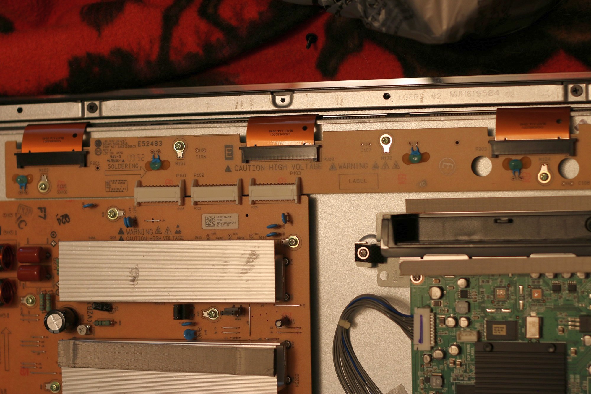

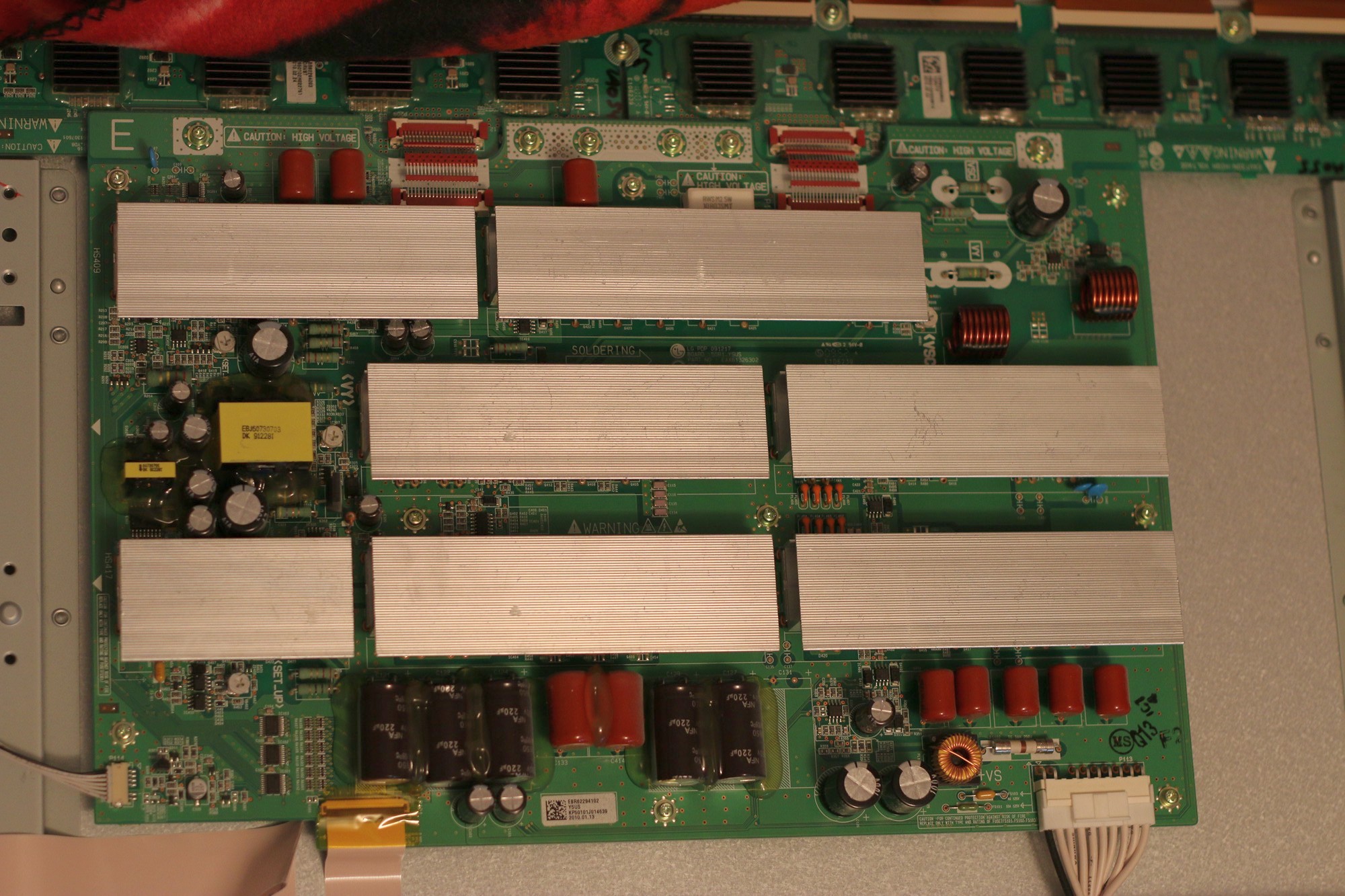

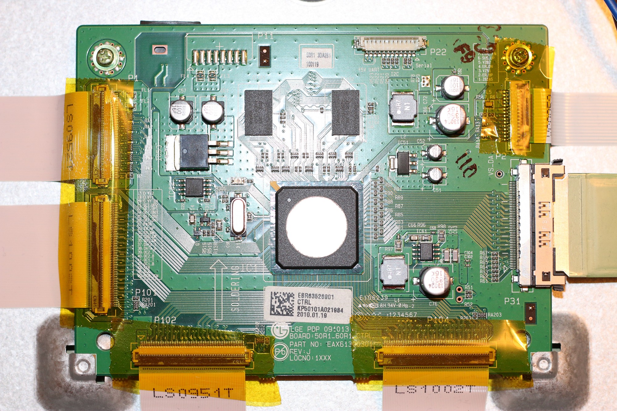

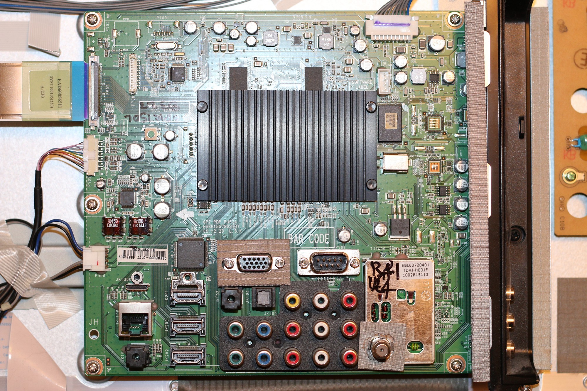

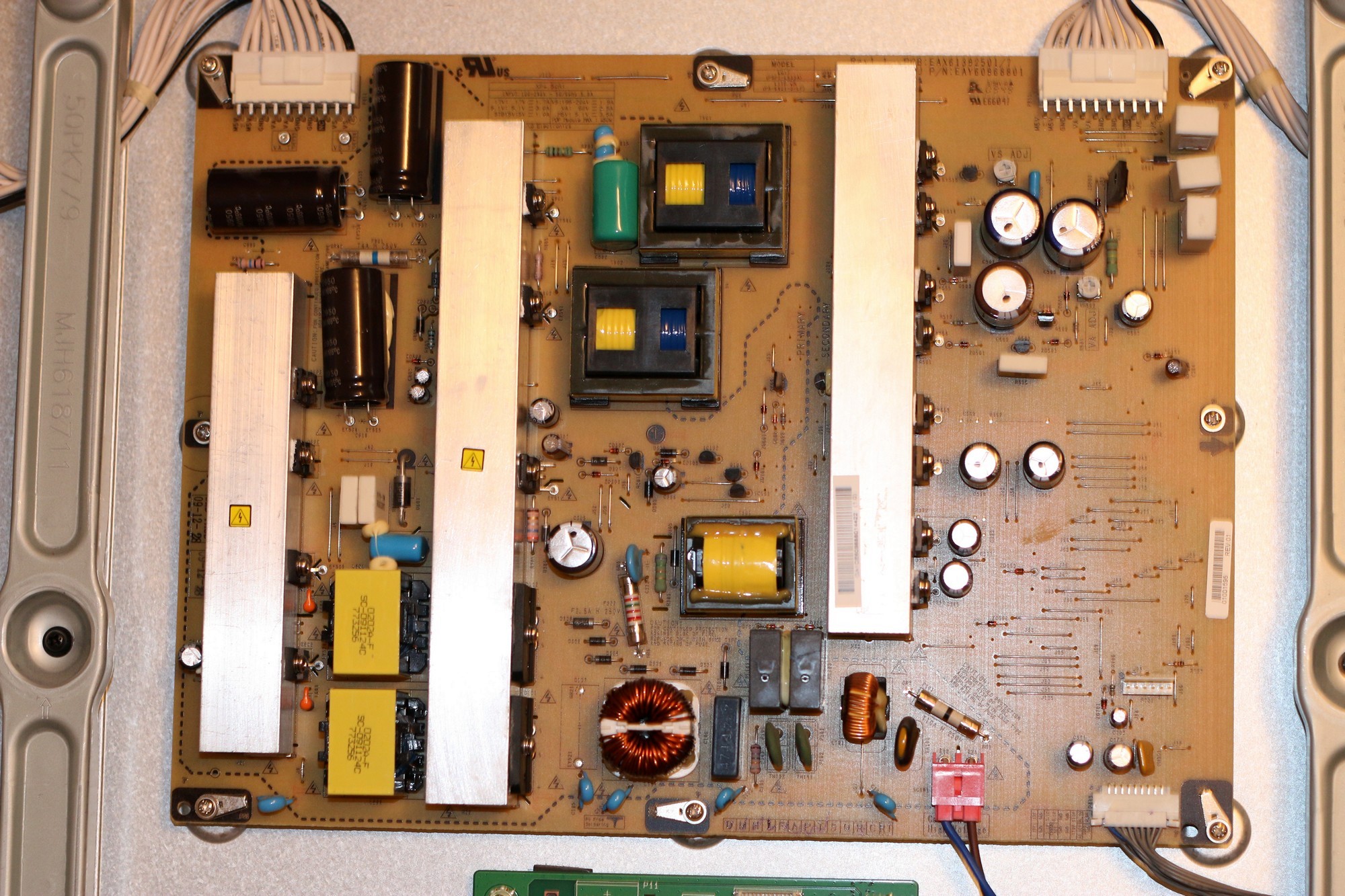

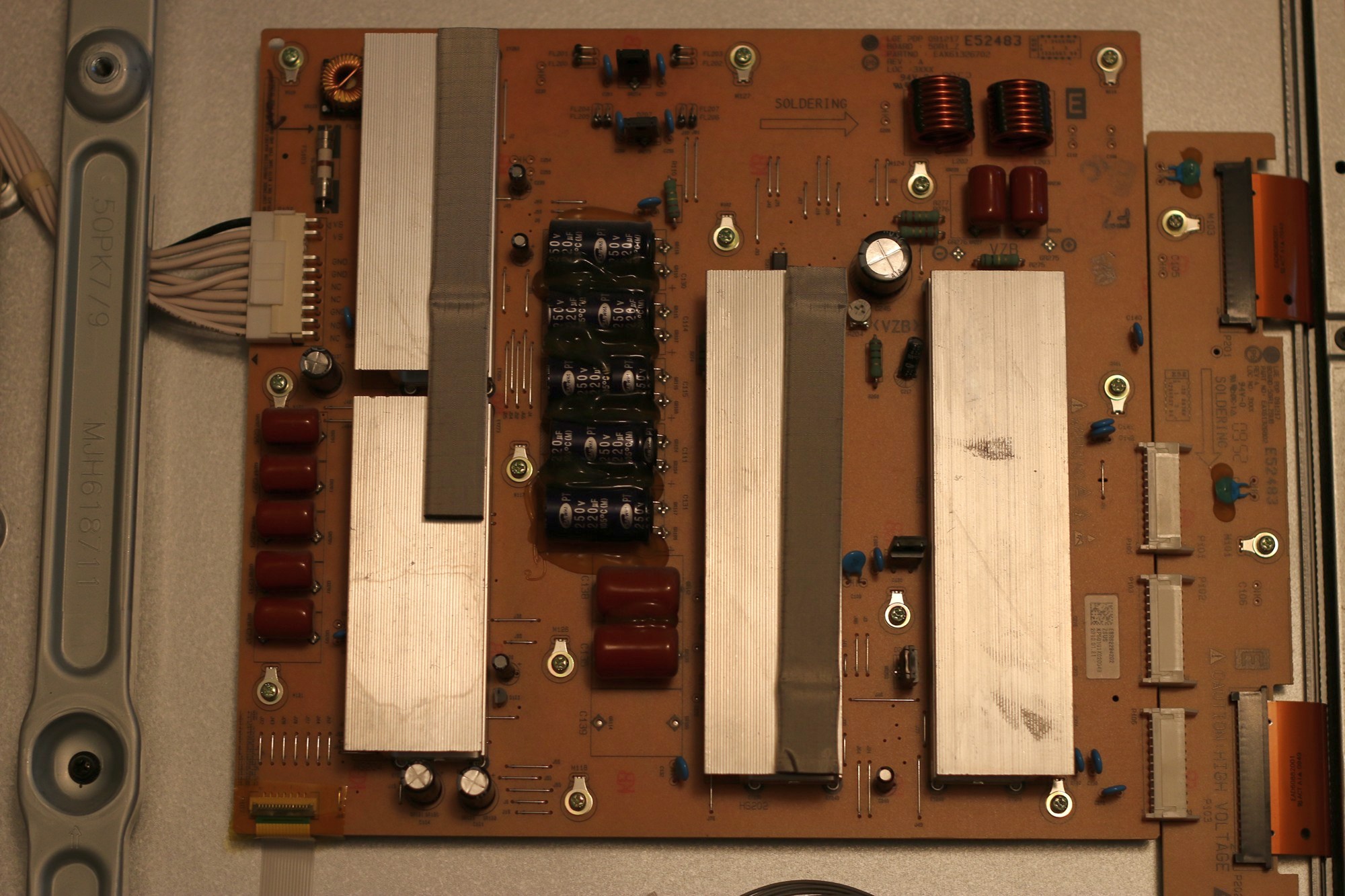

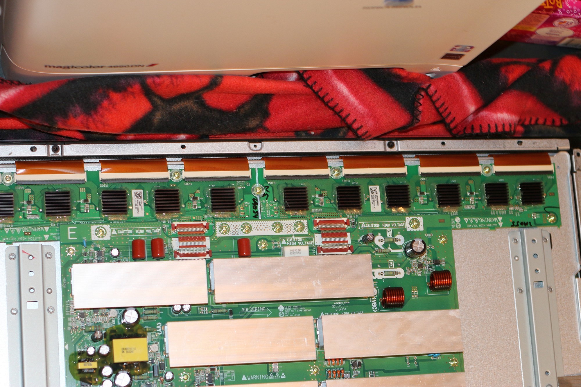

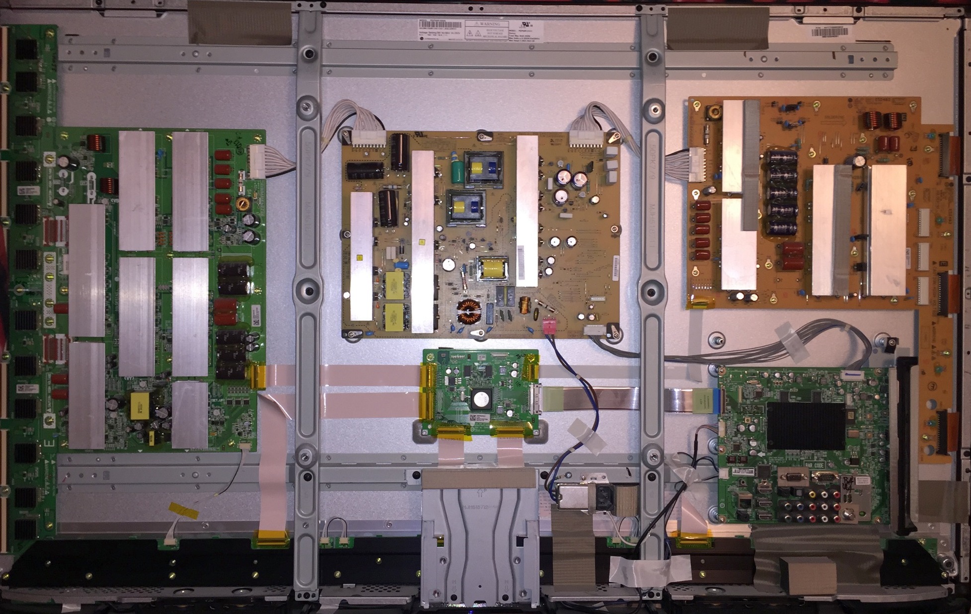

        Re: Lg 50pk750
        Okay. Here are some pictures of the TV's innards....
        Powering the tv back up this morning, I noticed that the display is not going completely blank. There is still some "backlight." I know a plasma doesn't have a backlight, but the screen is still glowing some. When I power down the tv, this goes away. I am still not able to see anything further displayed on the screen.
        I also measured Va and Vs...
        Va = 132Vac
        Vs = 437Vac
        I'm only measuring these with a multi-meter so I can't see if there is any funny business going on.

              Though I think your PSU Bd is not the problem and it is in-fact a MAIN Bd issue I'll share a method to 'self test' the PSU Bd.
              1. Build a TEST LOAD by connecting two (2) 220Vac light bulbs in series so you now have two (2) wires to connect to a circuit.
              2. Disconnect all jacks on the PSU Bd leaving the AC Input jack connected.
              3. On the Jack P813, connect a wire across pin 18 (AC Det) and pin 10 (GND).
              4. Connect another 100Ohm resistor across pin 15 (RL_ON) and pin 13 (STDBY 5V)
              5. Connect a100Ohm resistor across pin 17 (M5_ON) and pin 14 (STDBY 5V).
              6. Connect 'TEST LOAD' on Jack P812 across pin 1 or 2 and pin 4, 5 or 8.
              7. Plug PSU Bd in the AC.
              Test Load bulbs should light up and stay ON. If they do not stay on then PSU defective.
              If they stay ON, measure Vdc across chassis GND (BLACK probe on DMM) and RED probe on pin 1 or 2.
              Should get Vs=195-205Vdc

                Run test patterns by doing the following:
                Disconnect the LVDS cable that connects the main av board to the control board (P31)
                Connect the 2 holes beside the 2 resistors (r51 and r52) with the piece of wire, paper clip etc.
                Power on the TV, if you get test patterns you have a faulty main board.
                • humzilla
                  • Aug 2015
                  • 10
                  Re: Lg 50pk750
                  I haven't tried the additional testing on the PSU board yet, but I did try to the jumper on on the control board (it was easier.)
                  The tv began go through a bunch of test patters... flashing the screen in different colors followed by displaying various boxes...
                  I'm guessing this means the PSU board is fine and that my problem is the main board. Do you guys agree?

                      Doing some searching on the web it looks like it's going to be pretty difficult to source the main av board.
                      Are there any usual suspects that I might be able to repair on this board or do you guys think I'm likely out of luck? Is it time to start shopping for a new tv?

                          This board looks the similar but the part number on my board is P/N EAX61557902 (3). This board is P/N EAX61557905 (1). These sound like different revisions. Do you think the P/N EAX61557905 (1) would be a workable substitute?

                                My TV is a 50PK750-UA.AUSLLR. The boards I'm finding appear to be for 50PK750-UA.AUSLHR. I'm not sure what the difference is between these two models but am suspecting it has to do with the revisions made on this board.
                                I know I'm being a bit paranoid here, but you guys think that the different control boards are interchangeable?
                                I've already posted a picture of my board and the e-bay pictures are pretty blurry but everything is in the right place. The boards appear to be nearly identical except for the revision difference.
                                thanks for your help and your patience... :-)
                                • humzilla
                                  • Aug 2015
                                  • 10
                                  Re: Lg 50pk750
                                  I broke down and just went ahead and ordered the board. I finally received it today and (cue the church choir) the tv is now working...
