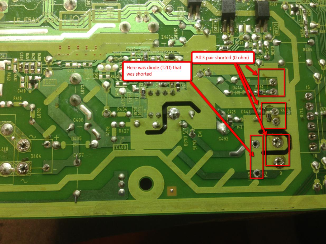

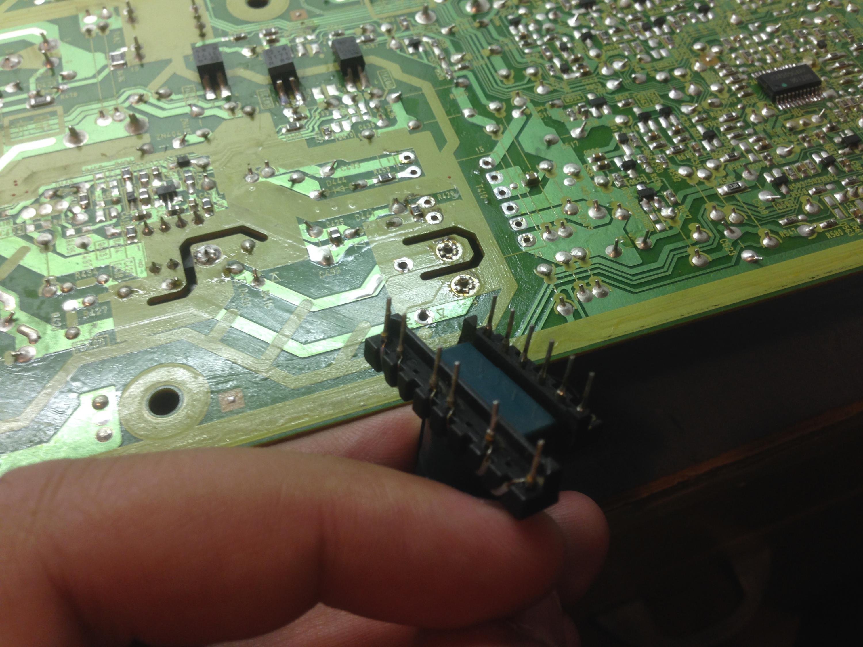

          hello, i found some burned diode on this board. So can you help me verify if this transformer is bad? All 3 mains are shorted and all 3 secondary are shorted (by shorted i mean that pinout in pair are shorted, all 3 pair does not have el. connection to other pair). I does not make any sense, if main need to be 0 Ohm then why put there a diode?

            i am sorry the main pair near burned diode is 7.4 ohm, all other pairs are 0 ohm
