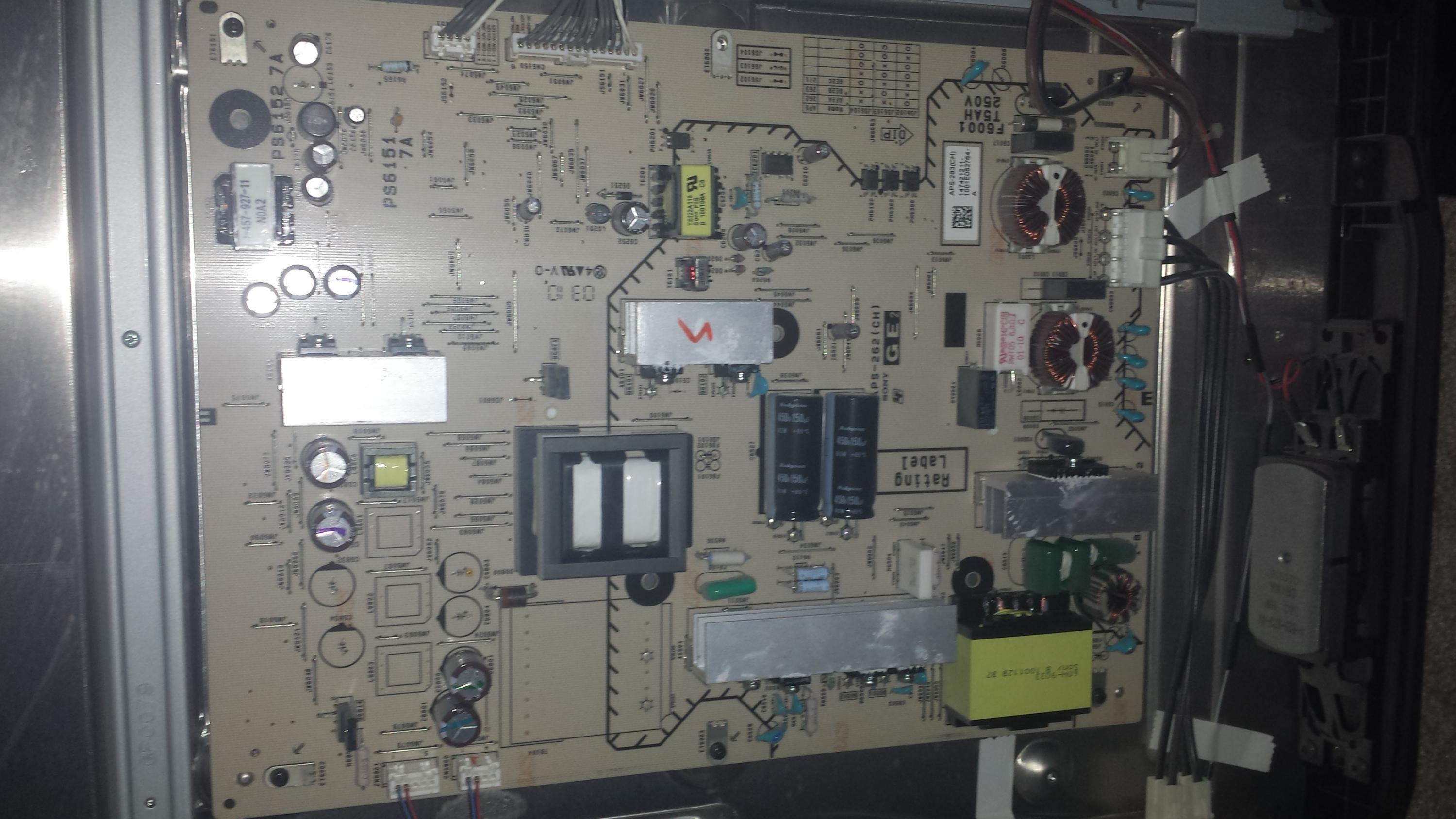

- I've opened the back of the TV to look for obvious shorts/disconnects but could spot none, nothing smells funny.

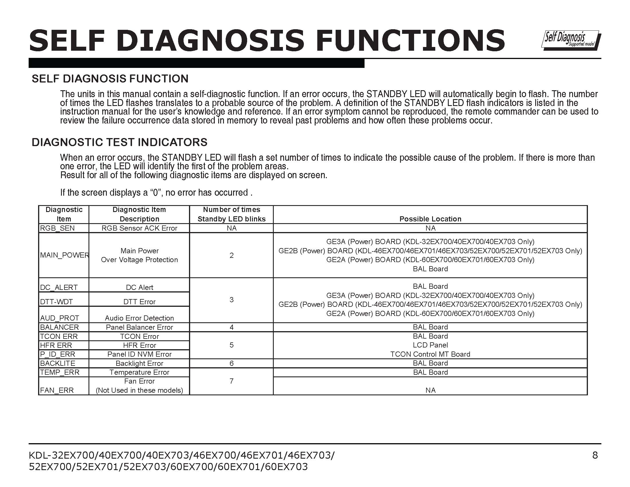

I found the following information on the blinking lights and what problems they indicate.
3 Red blinking lights is supposed to mean on a KDL Sony TV that there is a bad main logic, or power board to check for standby volts and if that is okay to replace the main logic board.
7 Red blinking lights is supposed to mean that the main board is overheating, which can be a short on the power board or main logic board.
While i suspect a bad main logic board based off the trouble codes I'm not really sure. Any ideas on where I can go from here to narrow down the problem? I've got a voltmeter if I need to take measurements and will gladly supply photos if needed.
