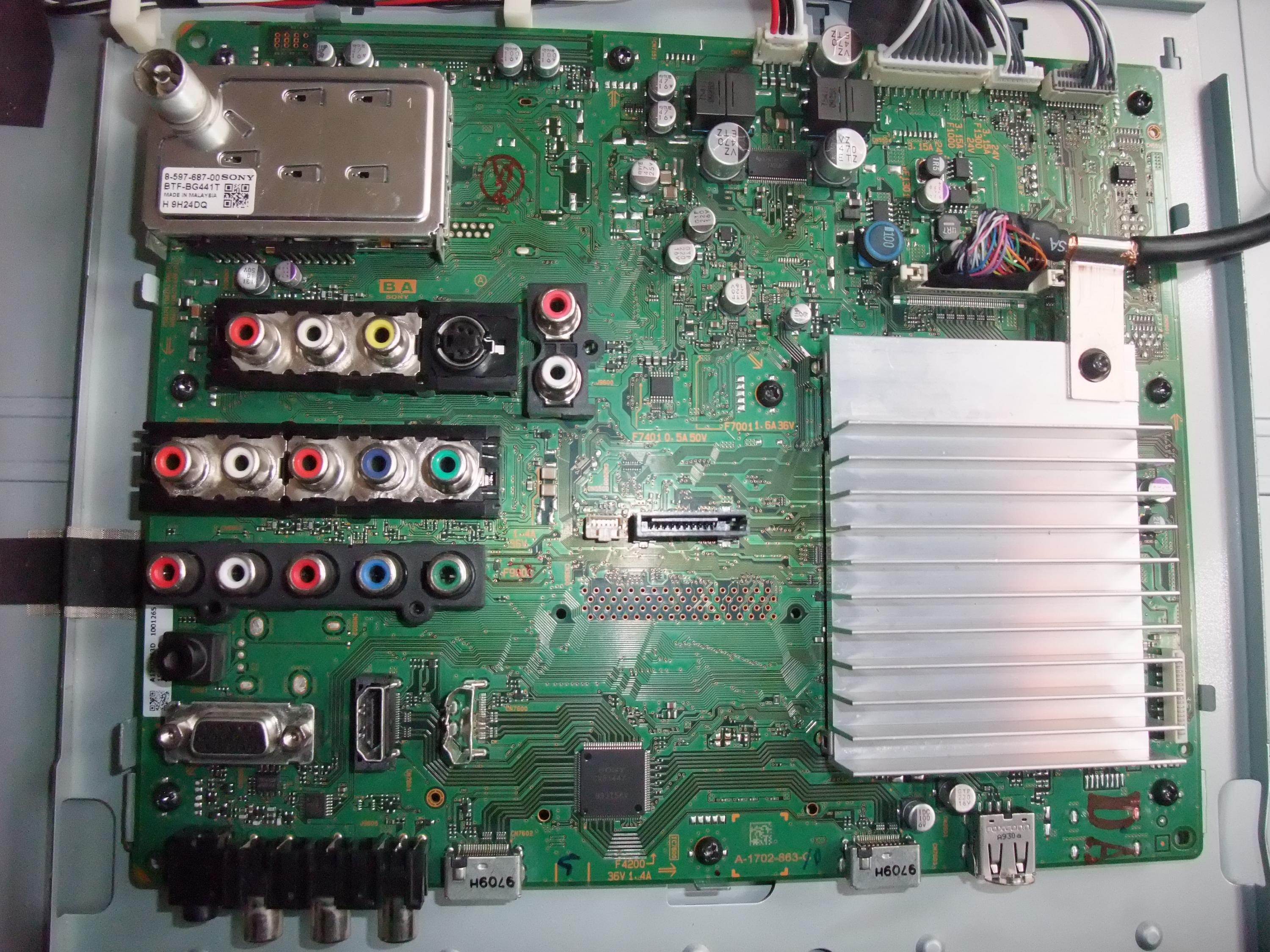

    Re: Sony Bravia KLV-32v550A Blinks 8 Times
    Picture of my BU board
    • pawangulati
      • Jul 2015
      • 34
      • India
      BA Board* not Bu Board
        DCV at the speaker output, there is protection circuit that monitor to see if there is DC present at the speaker connectors (the one with RED/BLACK/BLACK/WHITE) due to bad Class D power amp module.
        See if the IC gets hot or try cooling it, SONY should have installed heatsink for that IC.

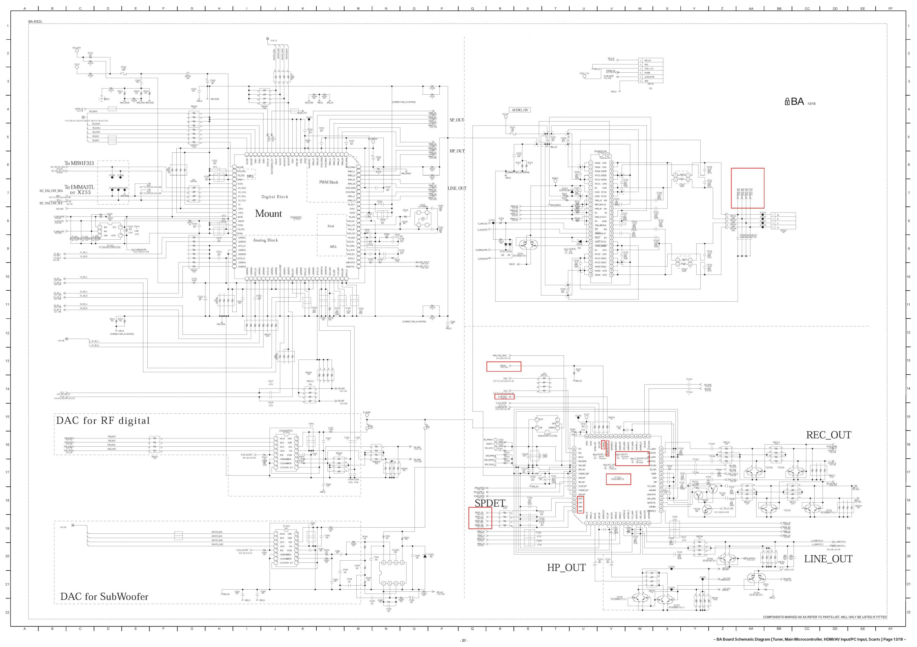

                                  I found service manual of same BA board
                                  Now can you please help me bypass the detection..
                                  • pawangulati
                                    • Jul 2015
                                    • 34
                                    • India

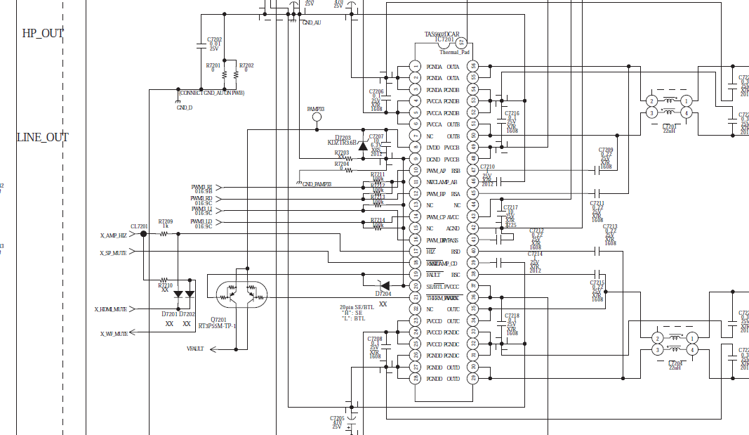

                                    I just noticed while removing IC TAS5602 i also by mistake removed and lost DIOD D7204
                                      Are you sure the board for the 5500 is the same as 550?
                                      See the attached pdf, as you can see, there are four speaker detection lines:
                                      SPDET_RP- SPEAKER DETECT RIGHT POSITIVE
                                      SPDET_RN- SPEAKER DETECT RIGHT NEGATIVE
                                      SPDET_LP- SPEAKER DETECT LEFT POSITIVE
                                      SPDET_LN- SPEAKER DETECT LEFT NEGATIVE
                                      All four of those signals are fed to pin 61~64 of the IC7301 (CXA3785R-T6 which looks to be the audio processor.
                                      There looks to be two error outputs:
                                      pin 43 is the X PROTECTION: LO = ERROR, HIGH = NORMAL, this is an OUTPUT pin.
                                      pin 44 is the VFAULT: LO = NORMAL, HIGH = ERROR, this is an INPUT pin. This signal is generated by the IC7201 (TAS5602) pin 19.
                                      So you need to see what you have at those two pins, for them to be normal they should match what are shown above.
                                      BTW, the diagram is not very easy to read.
                                        Yes i'm sure its same BA Board as of 550A
                                        as i have already removed IC7201 there is no signal at pin 44,
                                        do i need to solder Diod - D7204 which was removed by mistake and misplaced?
                                        so should i remove IC7301 (CXA3785R-T6 ic) also? will doing so bypass the protection??
