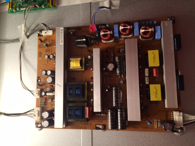

    I removed the back, all components look fine. No brown on any PCBs from past baking, everything looks new. Not even very dusty.
    All voltages tested OK. On Z-Sus the VS hits 263 when I attach meter but jumps right down to 201 where it is supposed to be. The 5V line is at 5.1. Even VZBias at 110 V where it should be.
    On the Y-Sus I saw 5.16 on the 5V line, 55.1 on VA (should be 55) and again 201.2 for VS. I disconnected LVDS and bridged points to make test patterns happen. Saw colors in the corners, nowhere else. It had appearance that matched several "Bad Z-Sus" board images on here. Specifically the mandelbrot shapes in corners.

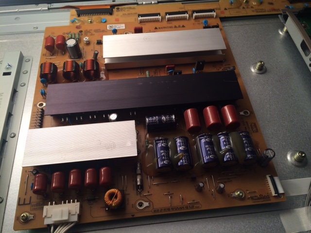

    I decided to just order a Z-Sus board since it seemed a likely culprit, based on symptoms. Then I discovered that nobody had them.
    Here is the shop jimmy page:
    http://www.shopjimmy.com/lg-ebr73561701-zsus-board.htm
    The only options I see are some repair kits on Ebay and 2 repair services where you send your board in. I noticed that the repair kits basically have all of the parts mentioned in the 1st thread I linked. But if I don't have anything (obviously) blown or shorted. If I turn it on, all I see is an occasional splash of white dots where the "no connection" notice is bouncing around. It will stay on like this for 10-15 minutes then eventually turn off.
    In short, I'm afraid that the standard repair kit may not be what is needed and if those people on Ebay doing repairs are just using same parts they buy in a kit.....
    Anyhow, I got excited reading that some boards can be interchanged. I had a look at the model right before mine:
    http://www.shopjimmy.com/lg-ebr63450501-zsus-board.htm
    It looked like the same basic board. And they are a dime-a-dozen. As little as $7 on Ebay. Looked like same plugs in same places. So I bought one.
    Got the board yesterday and realized first that screw holes in wrong places, only 3 match up. But I had to know. I had to cover parts of board where the studs came up and met components.
    And for the first time in almost 2 weeks, it fired up. But it isn't perfect. All of the plugs were the same, EXCEPT there was a 5V line coming into the proper part from the PSU , but the older Z-Sus didn't have that pin connected. It doesn't have a 5V line in from PSU.

      These z-sus boards are tough to find now.
      I have 2 of these 60PV450's love em for a cheap plasma that has a decent picture.
      I think that PK/PX series z-sus board is a 3D TV board so yeah they would not be compatible at all.
      https://www.badcaps.net/forum/showthread.php?t=42901

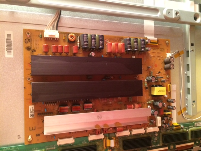

            Re: Another LG 60PV450 Z-Sustain issue, maybe?
            Mild Progress.
            I found that Vs was shorted to Grnd on the Ysus. Would explain the PSU giving two tries and giving up. Checked the FGPF4633 MosFets and found 3 of them that had all 3 pins shorted to each other, no matter how you connected probes. The other 3 were dependent on polarity and not shorted on all pins.
            So I got out some tiny clippers and a screwdriver. Yanked the legs off those 3 and now Vs doesn't short to ground.
            Put the Ysus back in and it no longer cuts off. It also doesn't have a picture and the Ysus generated voltages are all over the place, but with 1/2 of the FETS gone, hardly surprising.
            Those parts are only $1.76/each from Newegg. If nobody rep's some more sturdy ones that could replace them, will likely order a dozen or so, if I'm going to rush ship them may as well get more than a few.
            The back of the Ysus board is a tiny bit brown near one of the dead FETS. So maybe was Ysus the whole time? In any case, I found a source for brand new ZSus, so not sure if I should jump on it or if I will get away with just switching out these FETS on Ysus. And I imagine I should check Y-buffers while I'm doing all this, maybe one of them went bad and shorted all of this.
            Of course I finally made progress AFTER I ordered the new TV. Fingers crossed this does it.

                                  I clipped center leg of one FET at a time, on 3rd one the short was fixed. Much easier changing FET on the Zeus then on Y. Replaced FS103 and quick circuit test looks OK.
                                  I replaced all 3 of the bad FETS on the Y-Sus, was a bitch and if I was planning to keep using this y-Sus I would have to improve it. But in any case, put the repaired bad EBay board in with my repaired Y-Sus. Went back to the double click double click, shutoff. Disconnected the Z-Sus and it will remain on. Tried to check the voltages on Y-Sus, one of them was all over the meter, thought it looked like AC so switched to AC, found a nice steady 19.43V AC. That's not good. Getting in over my head...rectifier diode maybe? The voltages coming in from PSU board are fine, it's the voltages coming out of Y-Sus that are no good. Disconnecting power to Y-Sus and it still clicks off. Disconnecting power to repaired EBay Z-Sus stops the double click double click off issue. So, even with that FET replaced, Z-Sus still bad, though not shorting to ground anymore. Putting my original Z-Sus back in it didn't do the click thing, but no picture and bias voltage was like 43 Volts or something, totally wrong.
                                  Pulled top buffer board, seems OK. As I understand the test you find the pins that are all grouped together that connect to Y-Sus and look for shorts to the output pins that connect to the ribbon cables that go to panel. No shorts on top buffer. Seem to recall that you can't run with Y buffers disconnected but will read relevant threads again.
