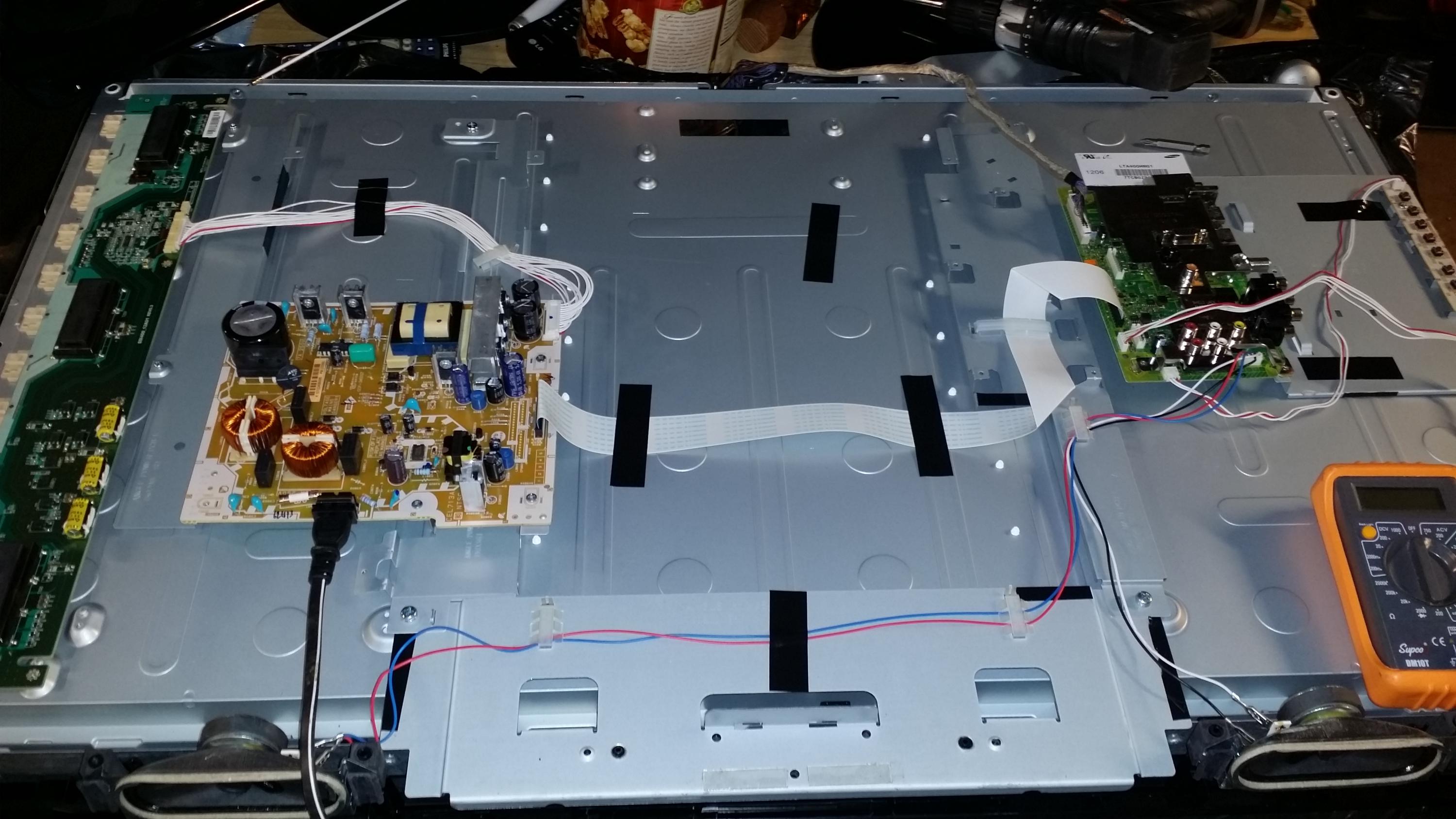

so I received this tv with no main in it, so I purchased a new main which they only have 1 for this model which I was lucky. and the backlights are not turning on. and it has a ribbon going from the power supply to the main so I don't know how to check the voltages but I checked it at the inverter and it is getting the 24 volts, so I thought maybe it was inverter. so I swapped it with another one I already had and it still didn't work, so is it possible the mains bad? I thought that as long as the 24 volts is going to the inverter that the backlights would be on?
hitachi L40A105E no backlights

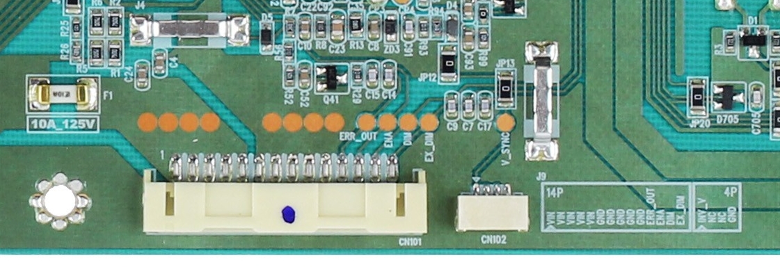

You have 24VDC for power but do you BL-ON & Dimm control signals from the main board to turn on the inverter circuit?
Is this your inverter board?
http://www.shopjimmy.com/samsung-lj9...-inverter.htm#Last edited by budm; 07-16-2015, 12:27 PM.Never stop learning

"I thought that if there was 24 volts to inverter that it automatically would turn on? so you saying that even if there is 24 volts going to inverter that the main could still be bad?" The inverter has to be able to go off when the TV is in standby mode (not powered off mode) when no Video signal is detected.
If you look at the big white connector, you will see the pinout chart of the connector, you need to check the DCV of the ENA pin, DIM pin, Ex_dim pin with ref to the chassis GND.Never stop learning

ENA = Backlights Enable = BL-ON, <1V = OFF, >2.5V = ON. so your main board is not sending out or may be the new main board pinout is not the same as the old board.Never stop learning

You need to trace that BL-ON pin on the main board to see where it goes to, probably a switched transistors that get the command signal from the processor, to test the IC or transistor you will need to know what they are by looking at the spec sheet.Never stop learning
Re: hitachi L40A105E no backlights
Right now what you can do is to disconnect the ENA pin from the connector, then a 500~1K between the ENA pin on the inverter board and the 5VSTBY pin to force on the backlights so you can see if you do get the pictures on the screen, if not then you have more than one problems on that main board.Never stop learning
