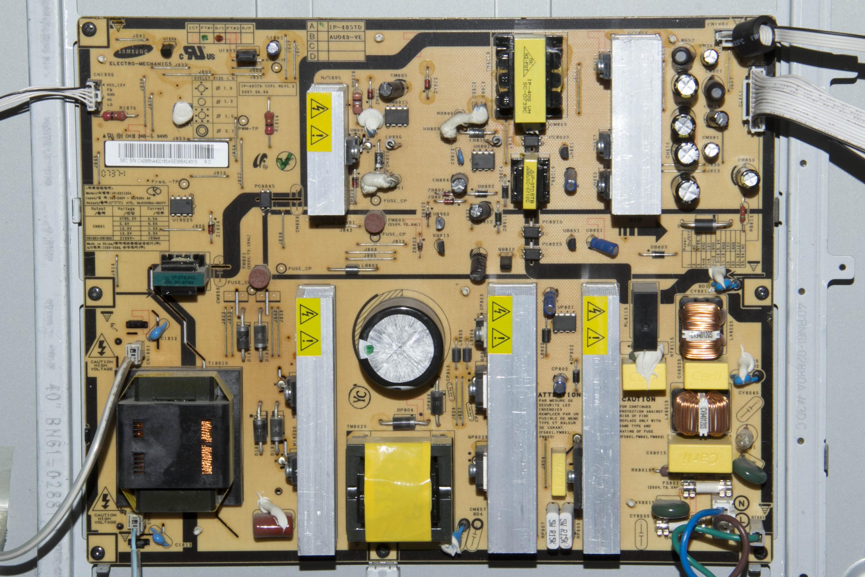

    I got Samsung LN-T4061F. Powers on with splash sound, panel has image (flashlight test) but the back-lighting is not on. The power supply is BN44-00165A (IP-231135A, IP-40STD) all good caps, as far as I can see. All voltages are reading fine as well (12V and 5.4V) at least on the cables leading to main board.

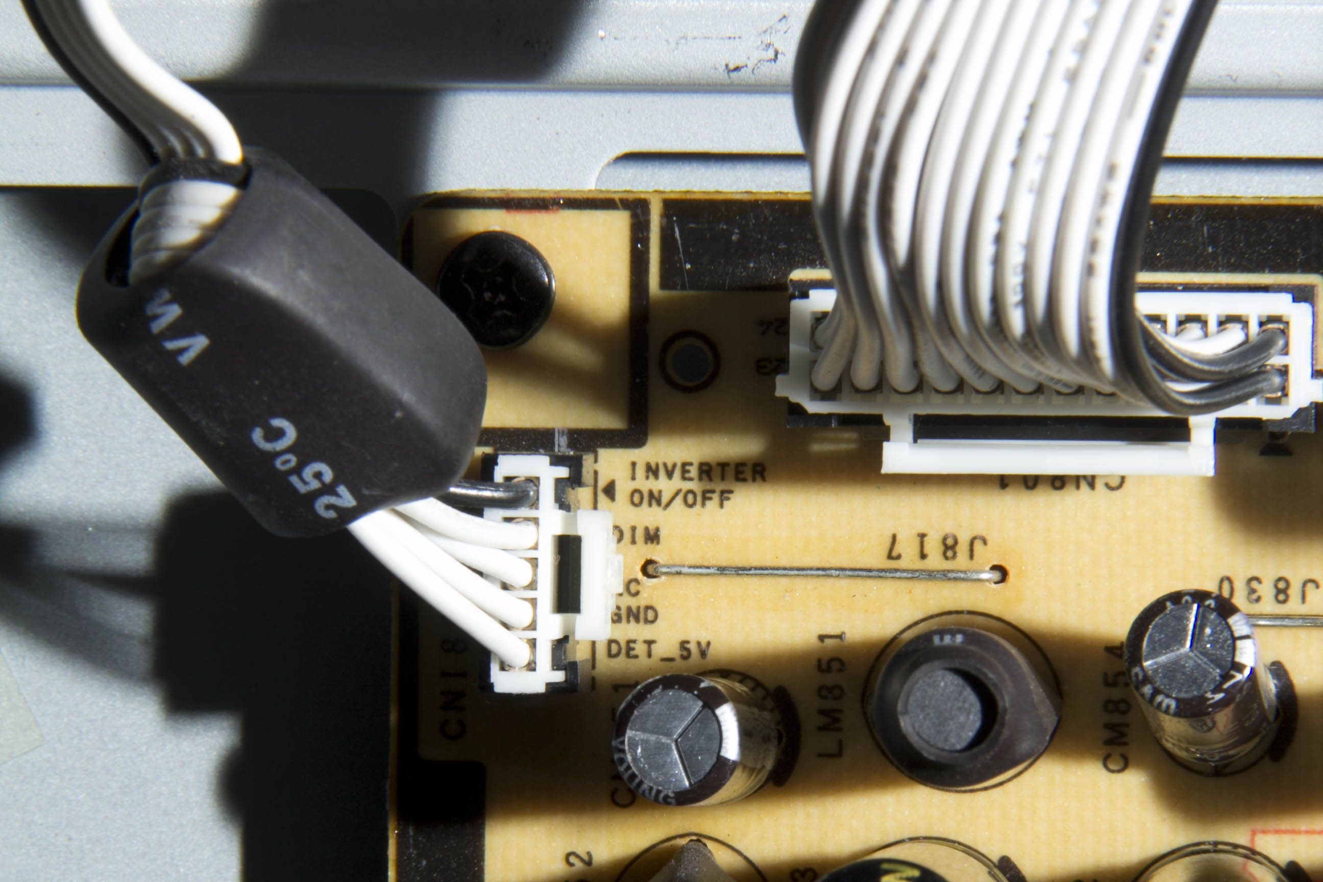

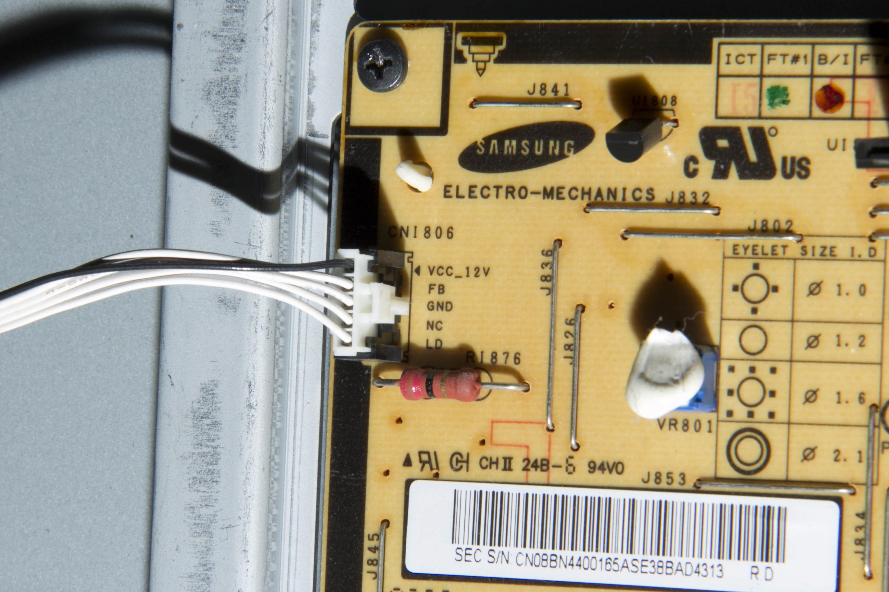

    There is a lead coming from the main board called inverter on/off and it reads 5.4V when on. On the other side of the power board there is lead going to inverter called VCC_12V, but it only reads 2.5V. I can't test the transformer voltage as it runs around 2100V and my multi-meter goes to 1000V only.

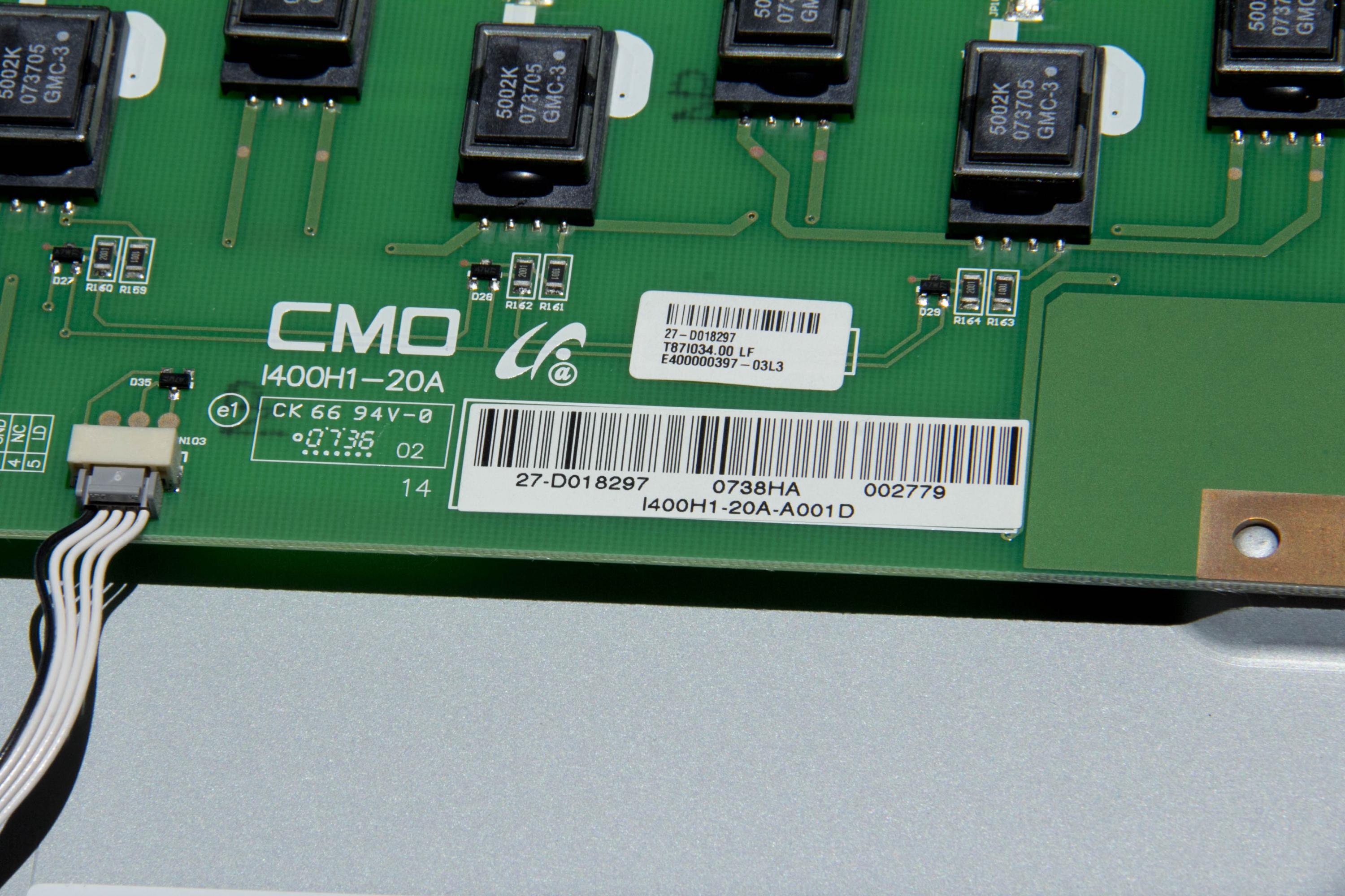

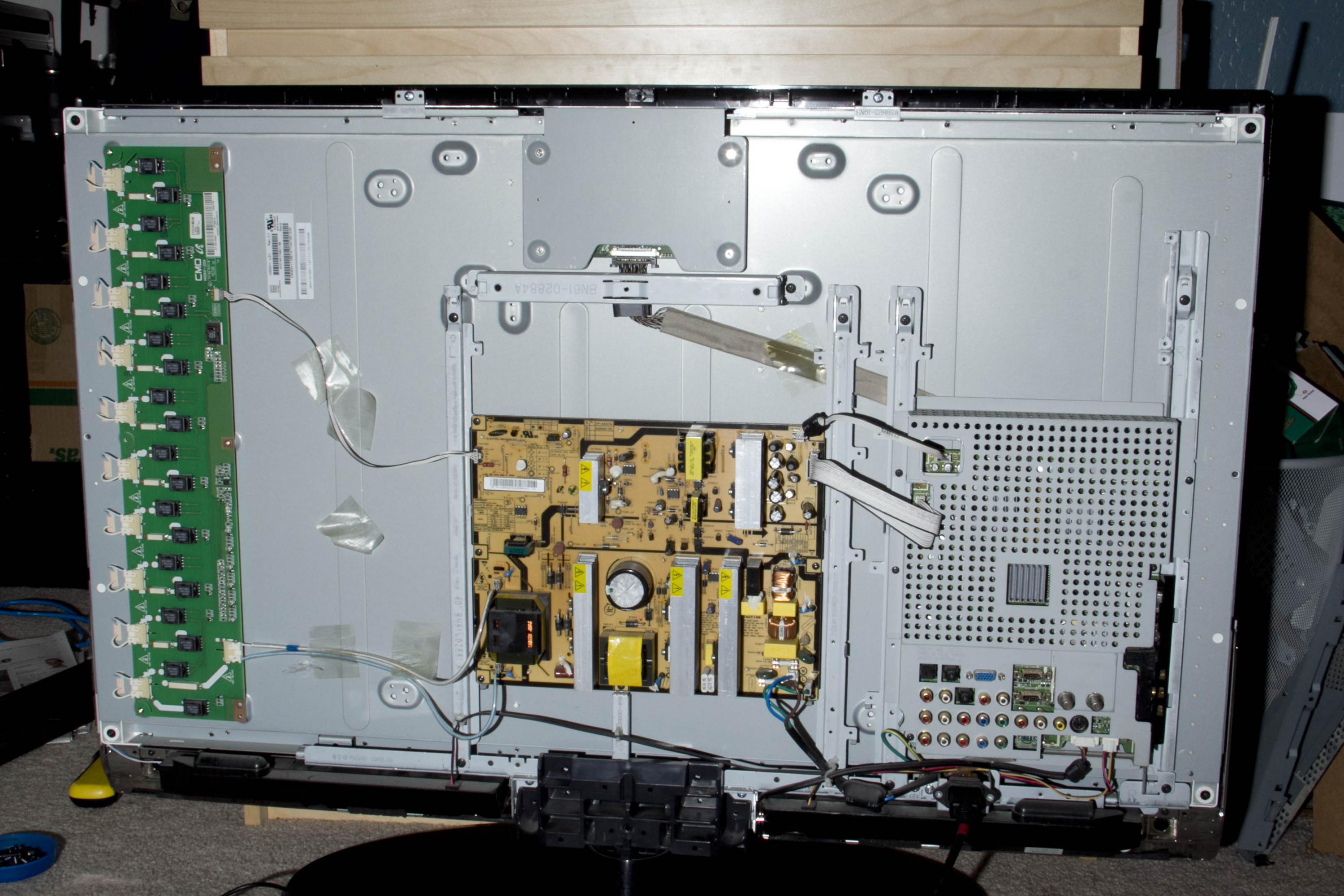

    Can we see the whole back side of the TV? You have power supply/inverter board combination, the High Voltage output is fed into the Balancer board, the VCC_12V is used for the comparator circuits on the Balancer board for the LD (Lamp detect, >10V = Good) error signal and the FB (Feedback for maintaining constant brightness, in mV AC range).

        Re: LN-T4061F has power, sound and picture, no backlights
        That is not inverter board, it is called Balancer board to balance all the lamps current draw.
        So which board did you replace, the Balancer board or the power supply/combo board?

            Do you have the 13VDC on connector CN801 pin 19/21/22?
            • Pioneerx01
              • Apr 2015
              • 241
              • US
              Yes, all the voltages on the CN801 are good. I am reading 13.57V on 19/21/22
                Then you need to check the UI809 12V regulator 78M12 input and output to see if 13V is present at the input pin, also check the resistance between the output pin and GND pin to see if it show low resistance, it is either that regulator is bad, the filter cap is bad, or the load (UI802S) is bad. See page 3 of the schematic for details.
