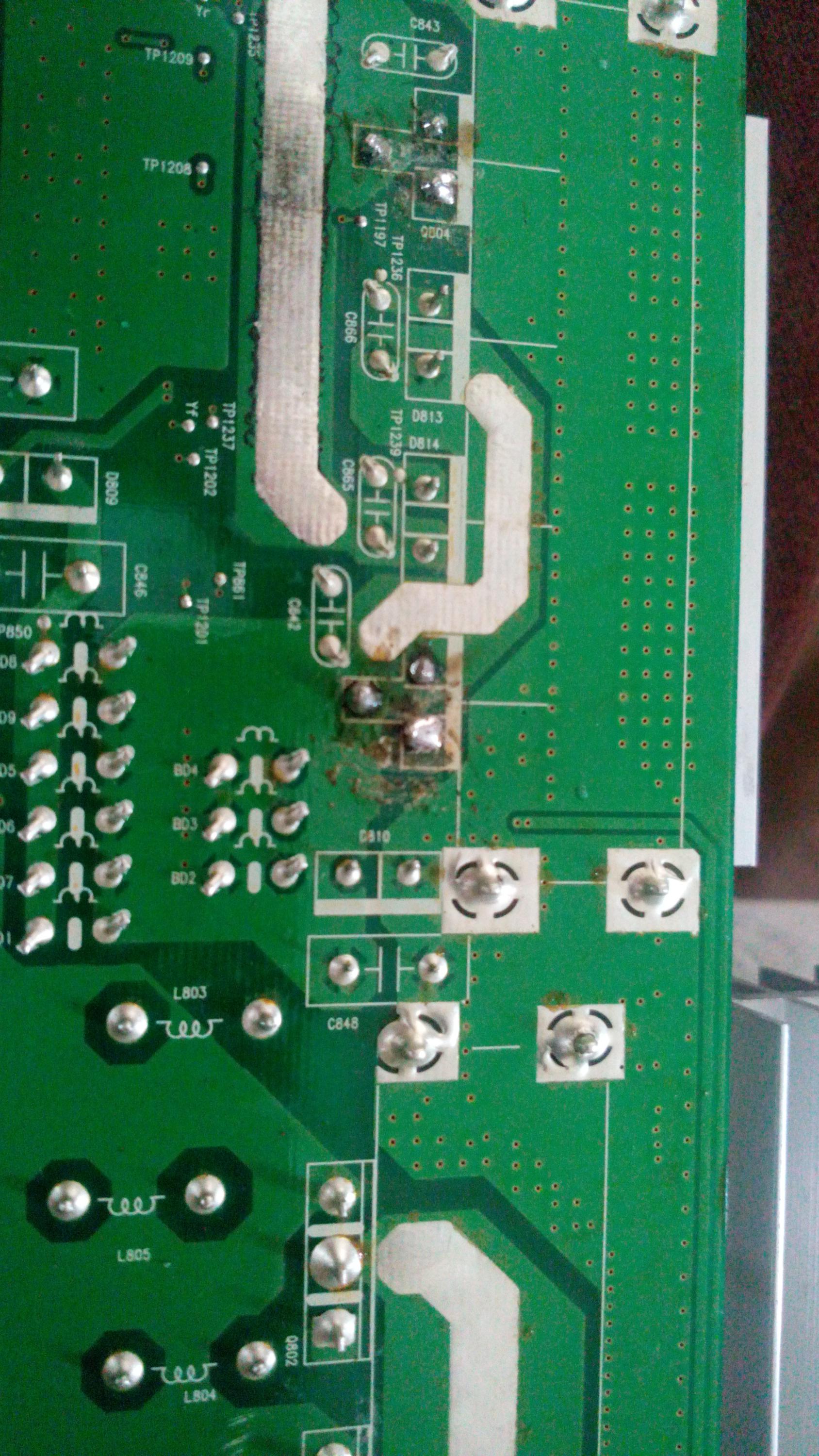

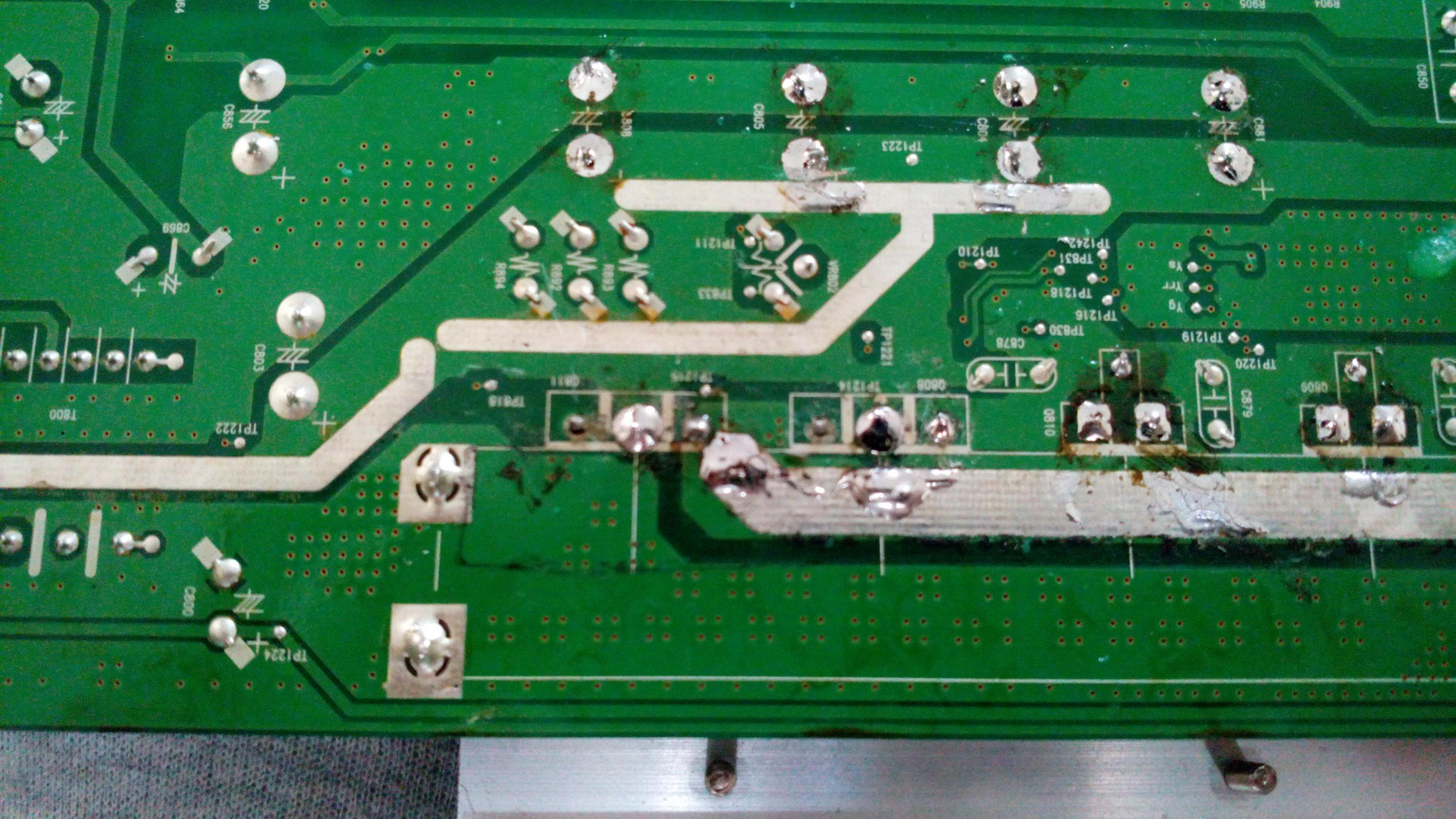

    Resistors are fine I am a little worried when I flipped board over I found this
    Seems its been soldered badly and few burns any chance its related?
    No shorts found

      Pin 1+2 are the Vs this is short (.16 ohm ?) But please check again, By the looks this board has been worked on before in the photo that's just were it has been soldered, the parts to check are Q804/5/8/9/ Q810/11 and there gate resistors and ICs U800/812 these are the parts that would be shorted or blown and I would recommend replacing . I have now looked and I have a board should you need it.

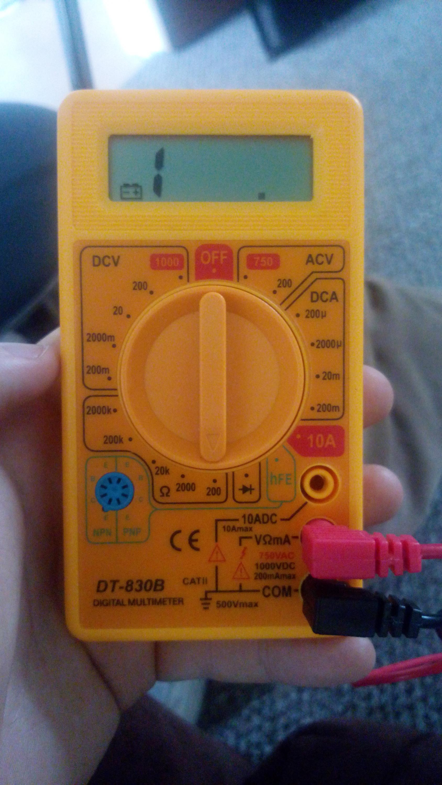

        II'll send picture of my dmm its a cheap one as haven't got round to buying decent one but show 1+2 open and low ohms yeah I'd say it has looks like one or two places board is actually missing solder point on q808 q811 so would I check these the same way as normal resistors? I'll upload picture of missing solder joints and how much would you want for the board?

          That would have to be one of the worst jobs I have seen and believe me I have seen some, well the problem you have is that these are some of the parts I have listed so it looks to have badly repaired in the past, my money would be on having to replace all on my list as you have a short on the Vs and bad soldering will not be the problem ,but would be the cause of the blown parts , can you give some background on the set did you buy it faulty or has it been running .

            Yeah I picked it up with a with the clicking fault but my first attempt at susing out the problem failed as I thought it was dead capacitors apparently not but looks like its a very bad repair so thinking I'll just get all parts and redo the whole thing , I saw it as a little project I have a few broken set I'm trying to fix

              This is DMM and setting I'm using to test for shorts and the resistors
