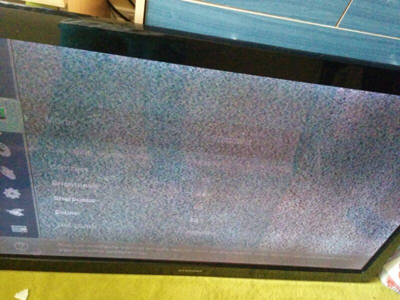

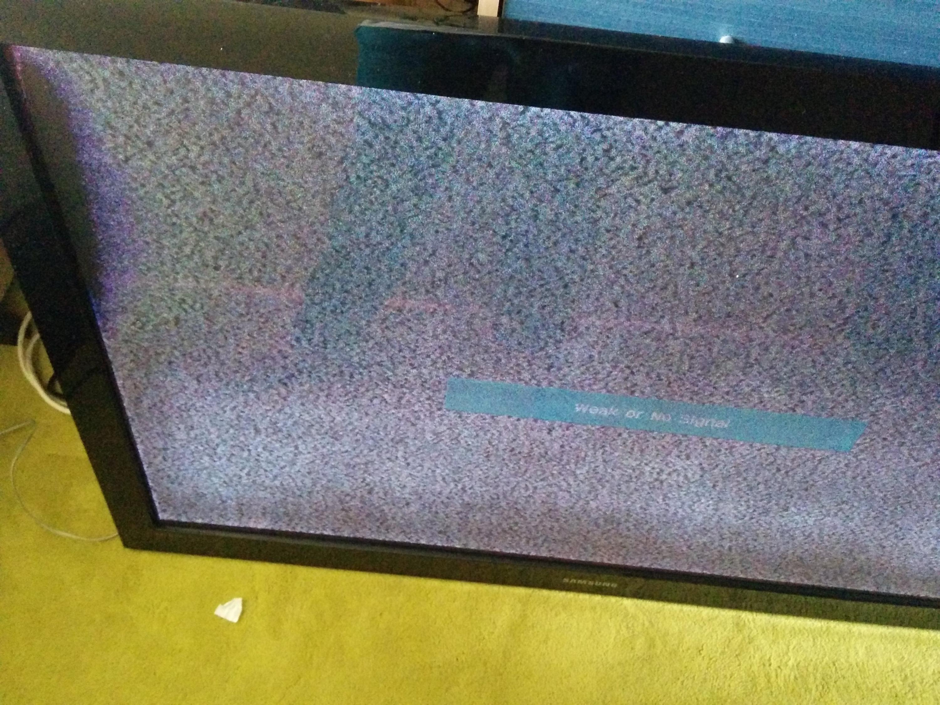

    Hi Flocko,
    Good news is TV works. But the Bad news is Picture is not good.
    please have a look on attached pics.
    Is that a bad plasma panel?

      Re: ps50b451b2wxxu clicking not turning on
      one more thing. Tcon board green LED is keep blinking.
        Have you reset all the voltages to the panel sticker ? Va/Vs ect
          How to do that flocko?
            Vscan is less than the sticker
            should be -190 but reads -187
            and Ve sudenly drops to 20-30 but stay 81-85. sticker value is 85
              Ooh flocko Great. again clicking Xsus is short now.
              All the RJH3044 are gone. Do you know which parts needs to replace?
              Do you think its worth to repair it? is that the prob for dark screen?
              pls help
