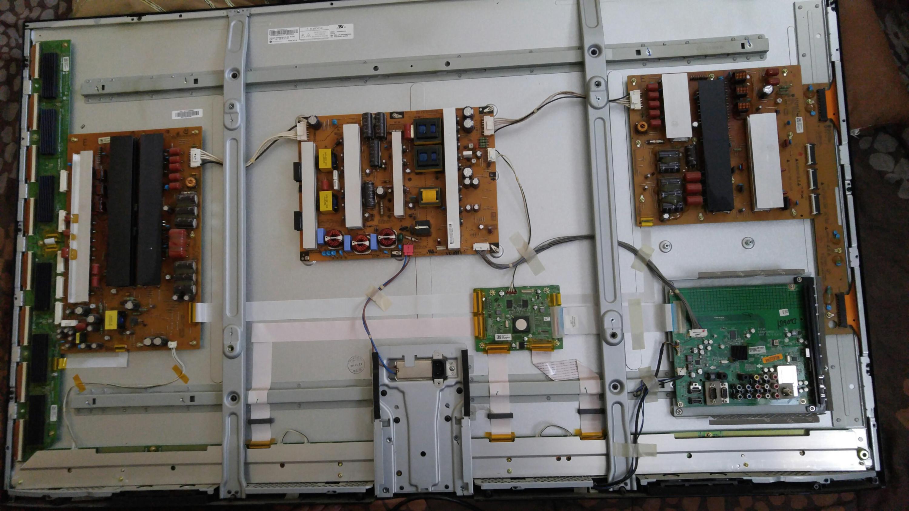

              Also we need pictures so we can see how the boards are linked together.

                      here is a picture of the all the boards

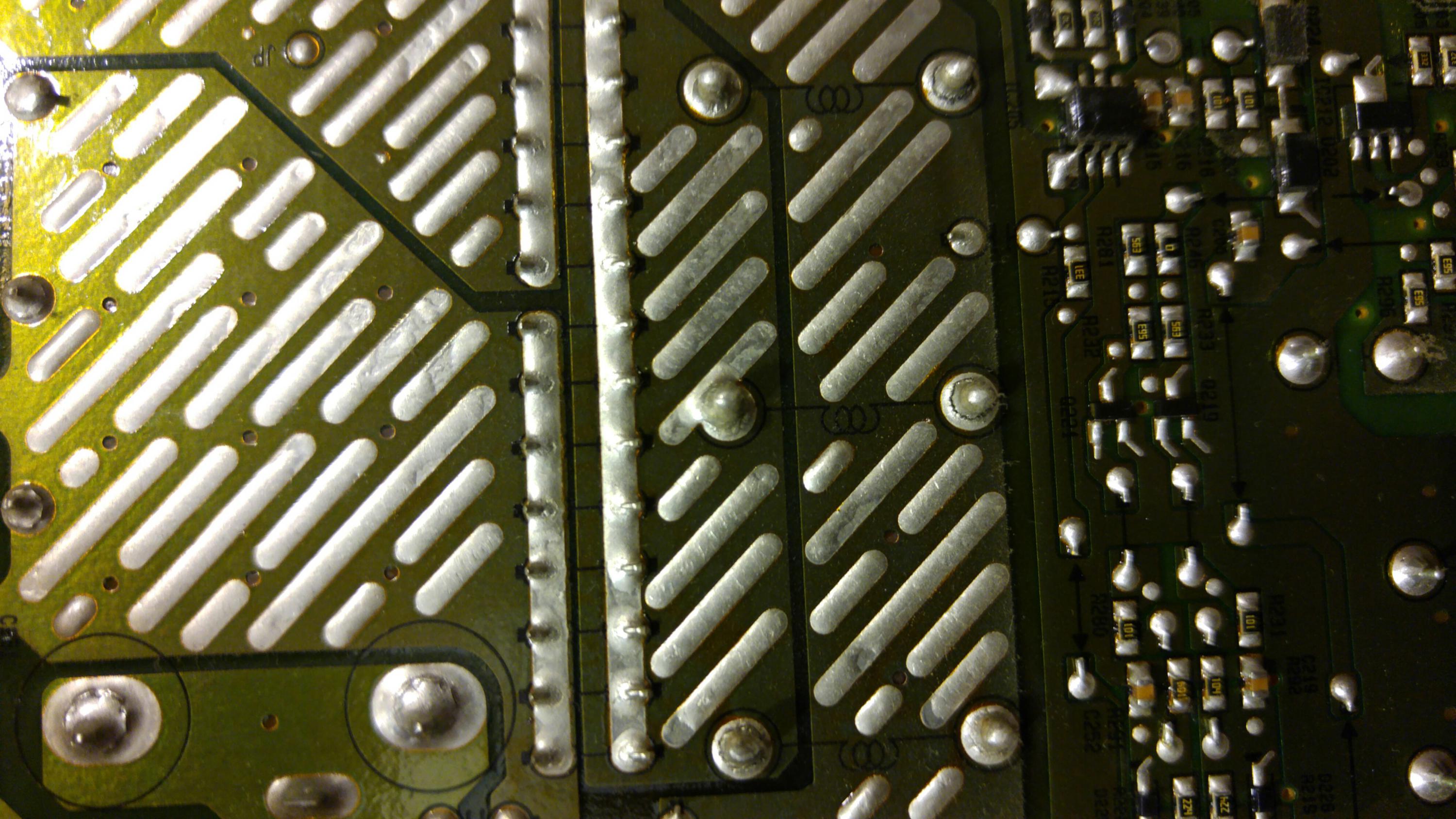

                        I examined the bottom side of the z sus board and noticed this solder joint looked like its shorted to another trace on the board, but wanted to post it to ask if thats what it looks like. Its the area where there are 3 larger solder joints in 2 rows, these 6 large joints below to the large inductor coils. It looks to me like one of the middle joints has shorted. Am i looking at this correctly?

                          All of those look cracked and loose, you can try soldiering them back to whole again but if they have gotten that bad I am sure they have cause damage to other components.
                          Mine was like yours and took out several SMD components so I just got a replacement board. There are 2 version of the y and z boards the version you have and the other listed on shopjimmy, they are interchangeable I using the newer versions with my panel and it's been working perfectly for almost 6 months.
