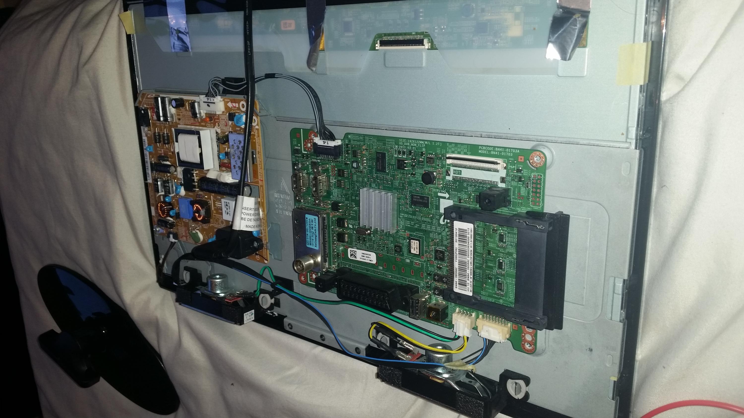

    Hi guys i have this tv when i unplug the av board the back light comes on and im getting 12.5v going to the av board but when i plug it in i get 13v and the screen goes black

    Re: Samsung ue19d4003 wont turn on
    As shown
      Where is the flat ribbon cable between the integrated T-CON on the LCD panel and the Main board?
        Taken it out as it makes no difference at the moment
          If that cable is removed then there will be no power and signals to run the T-CON board = no pictures on the screen. All you will see is the glowing screen.
          What do you get when that cable is connected? How about the SMD fuse on that T-CON board and the DCV at both ends of the fuse with ref to the chassis?

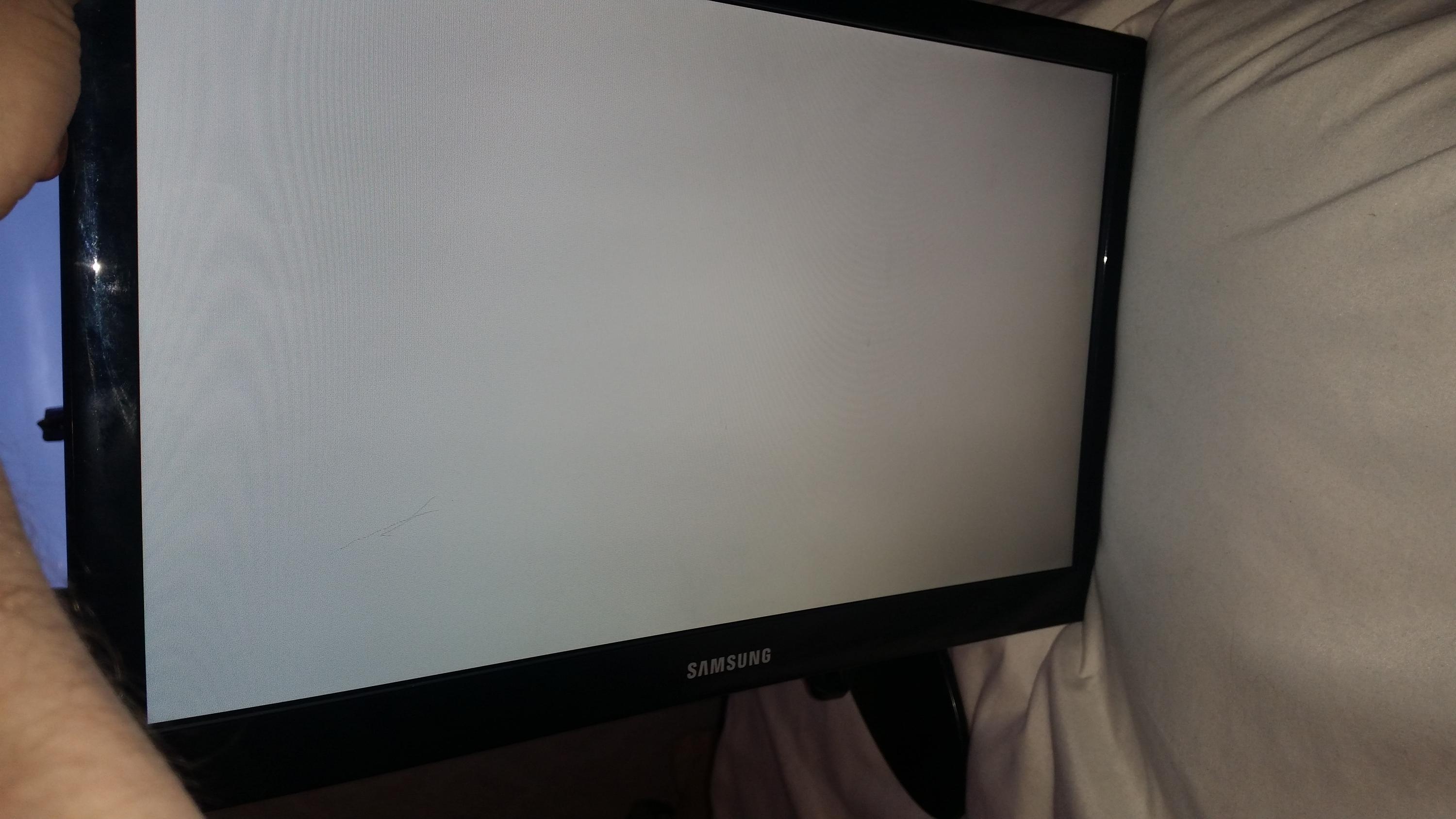

            I have tried it with the ribbon in still get the same results only put a white screen when av board is not plugged in from power board
              "I have tried it with the ribbon in still get the same results" what does that means? Backligts still on but black screen or backlights are on but gray glowing screen?
              Well, did you check the SMD fuse and the Voltage on the SMD fuse of the T-CON board? Do you also still get backlights when all the cables are back in place?
                The back light comes on only if the power board and just the power board is plugged in if the t con and av board are plygged in to its completely black with no back light the back light is plugged into the power board on these
                  So did you try only AV board connected?
                  Some LCDs go white with no power - others go black. Black is most common. ("Normally Off")
