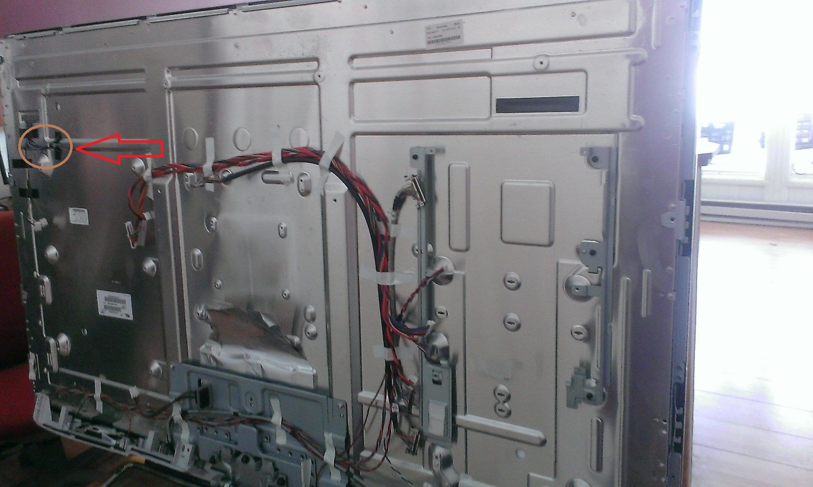

                I have added the LED output location.
                There is a connector, that has wires going into both LEDs. So the line can be broken from there, but I don't really understand how is connected, because it is inside the panel.
                I'm adding a picture, found on Ebay about this connector.
                Bellow it, there are the two LED connectors, going into the power supply board.

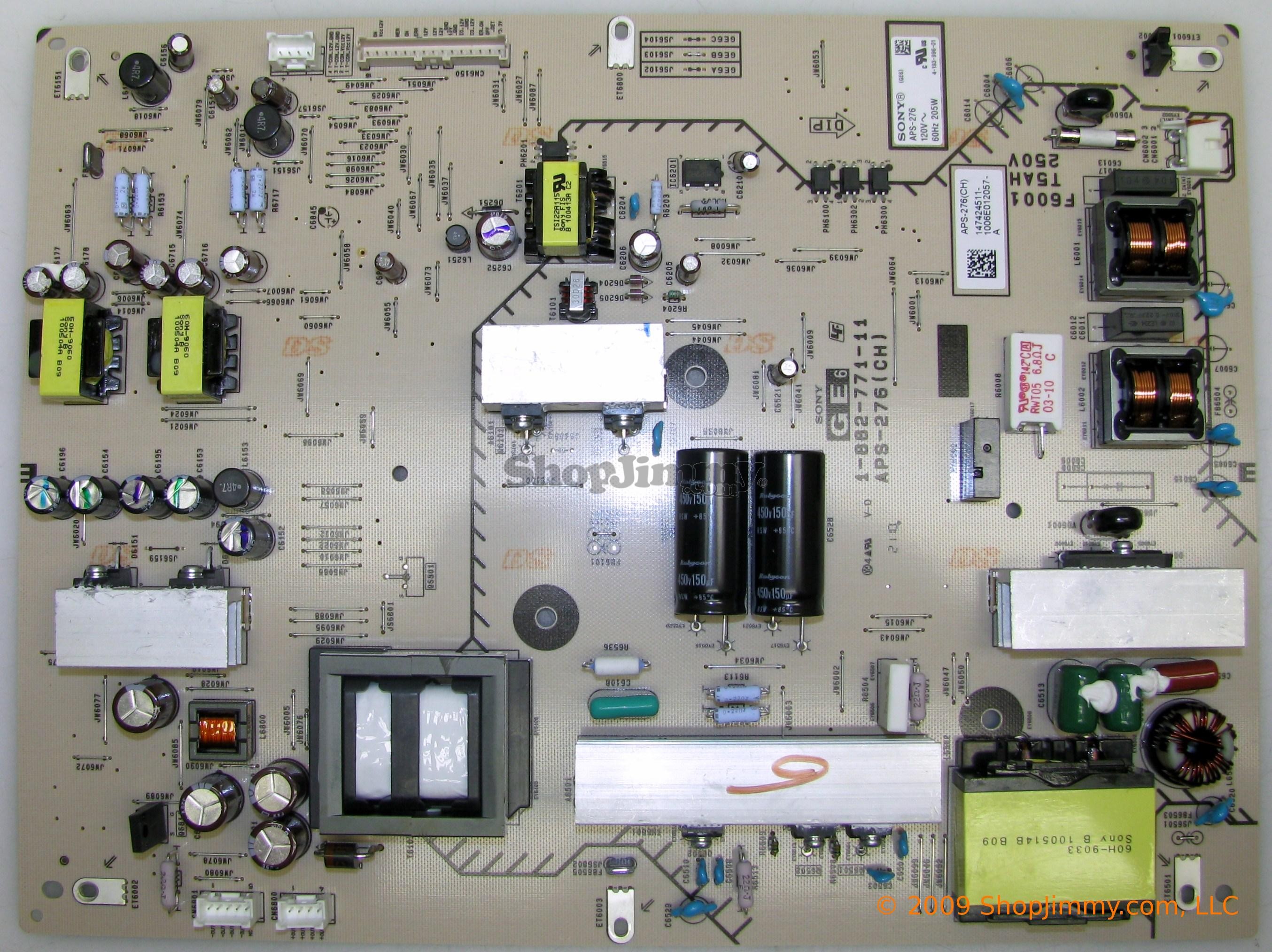

                                        Re: Sony NSX-46GT1(Google TV) 2 x error code
                                        Is this your power supply board?
                                        http://www.shopjimmy.com/sony-1-474-...-ge6-board.htm
                                        It looks like the panel uses one big long sting of LEDs (the two strings are connected in series at the power supply/LED driver board), I can see one current sensing resistor, one Power MOSFET (Q681?) for the LED PWM, one boost conveter inductor L6800.
                                        Picture provided by shopjimmy.
                                        Need good pictures of the bottom side of the board, especially around the LED driver section.
