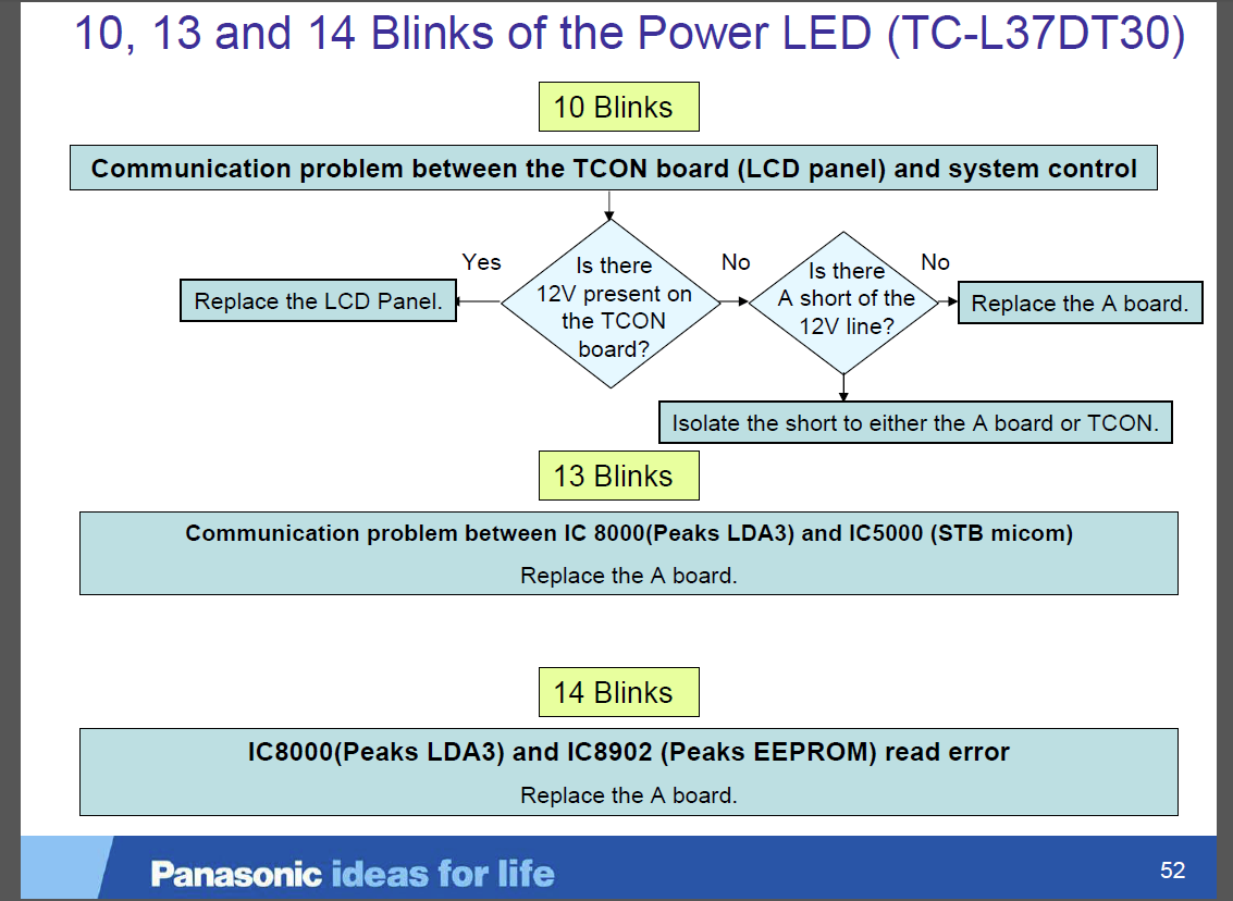

    blink codes

        Re: Panasonic TX-L42U3B dead screen and blinking standby lights
        Beware as we have found on the plasmas at least 14 blinks whilst coding for an A board fault can in some cases be caused by other boards.
        I would check the full power on process. Check for all power on signals, check for 24V, 12V, etc.

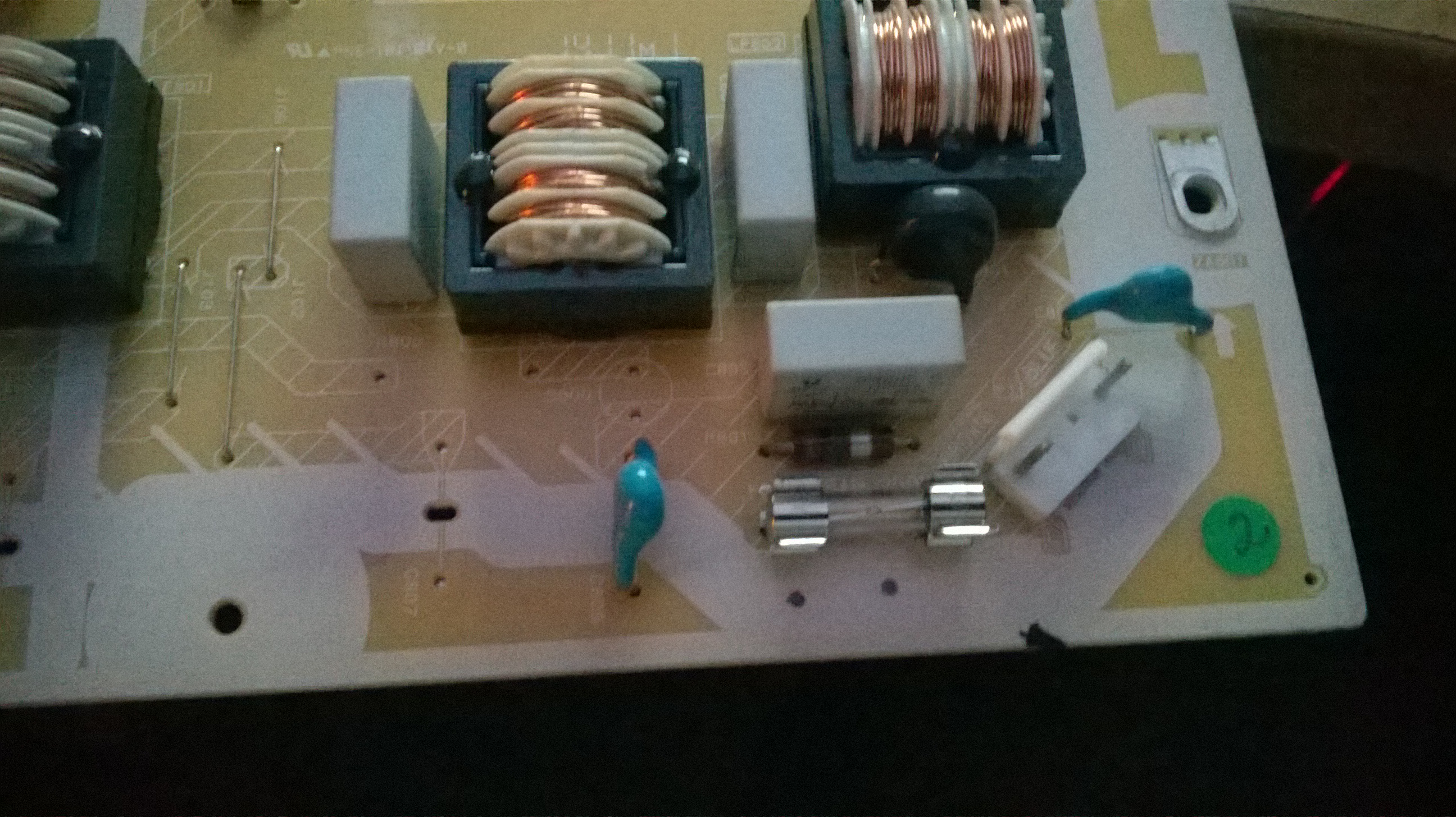

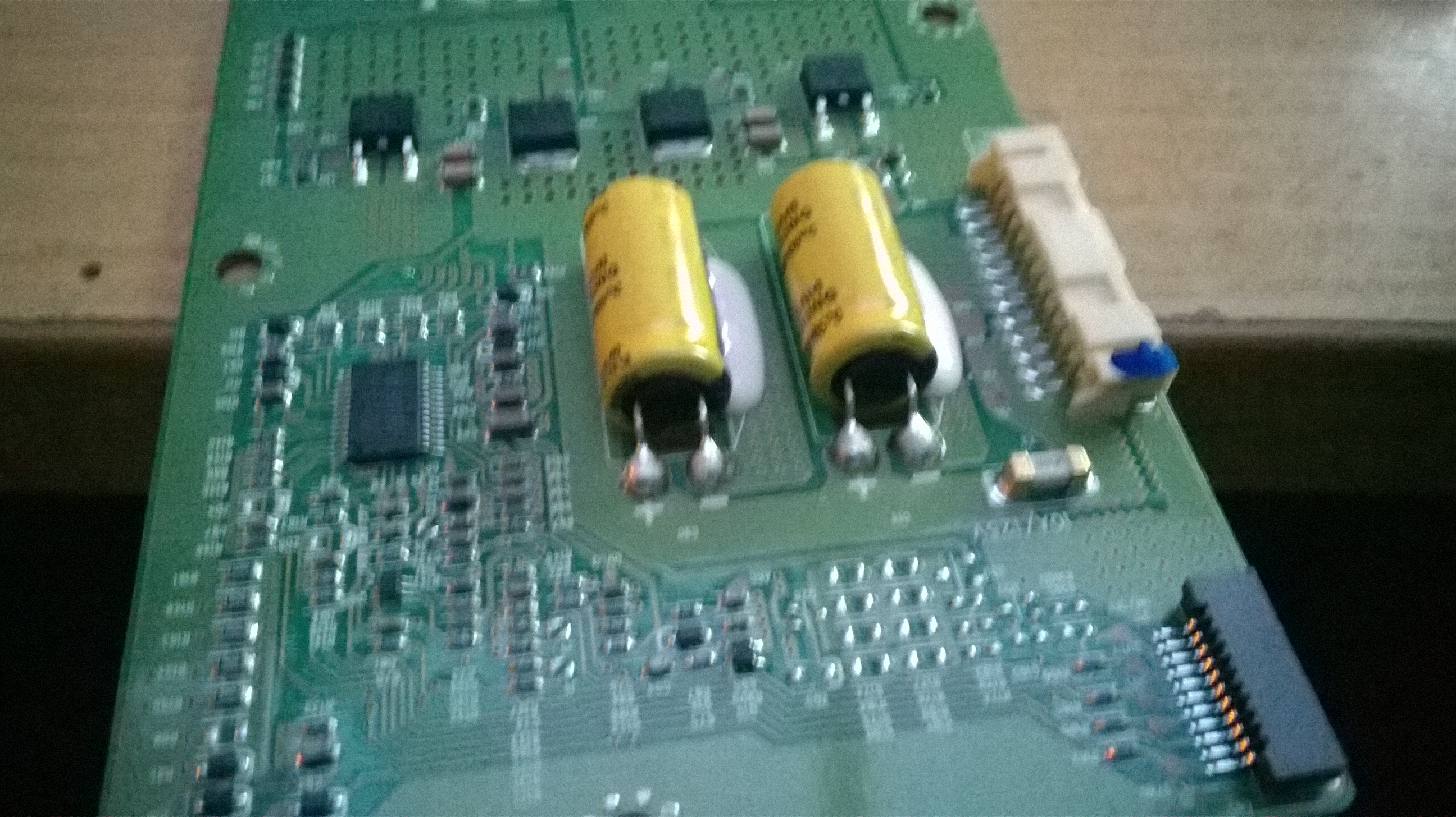

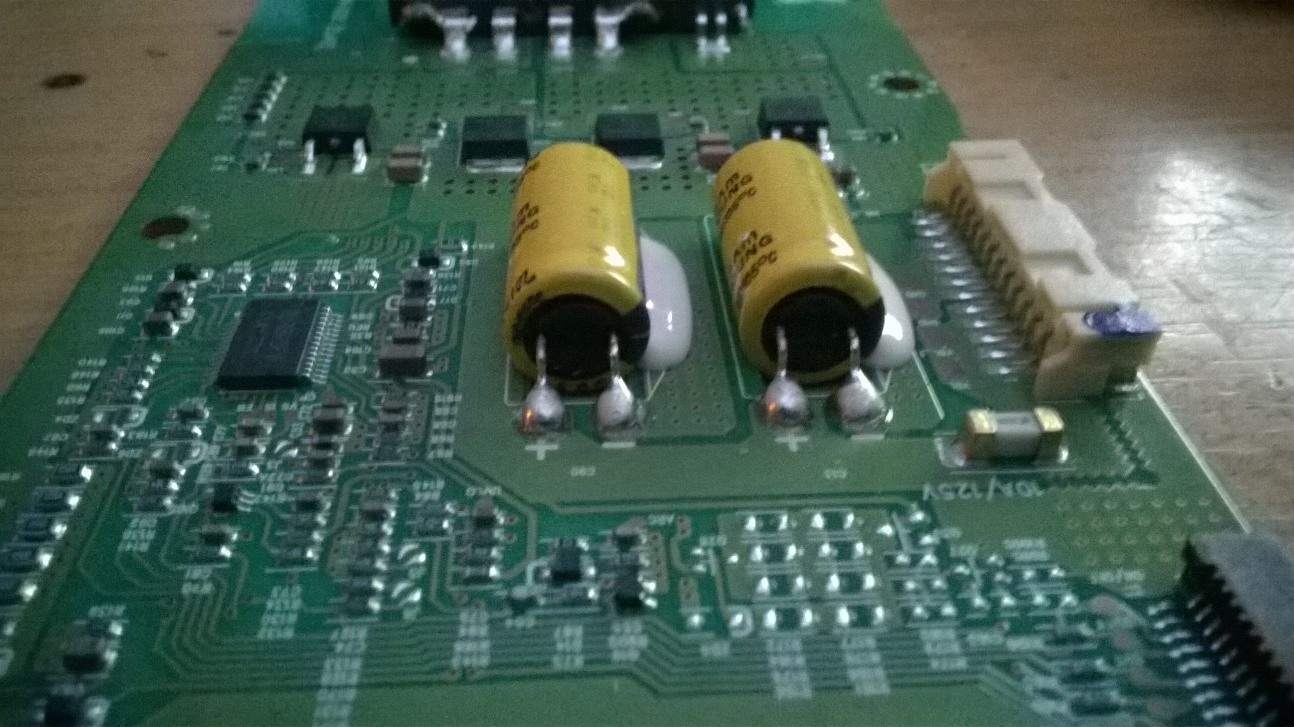

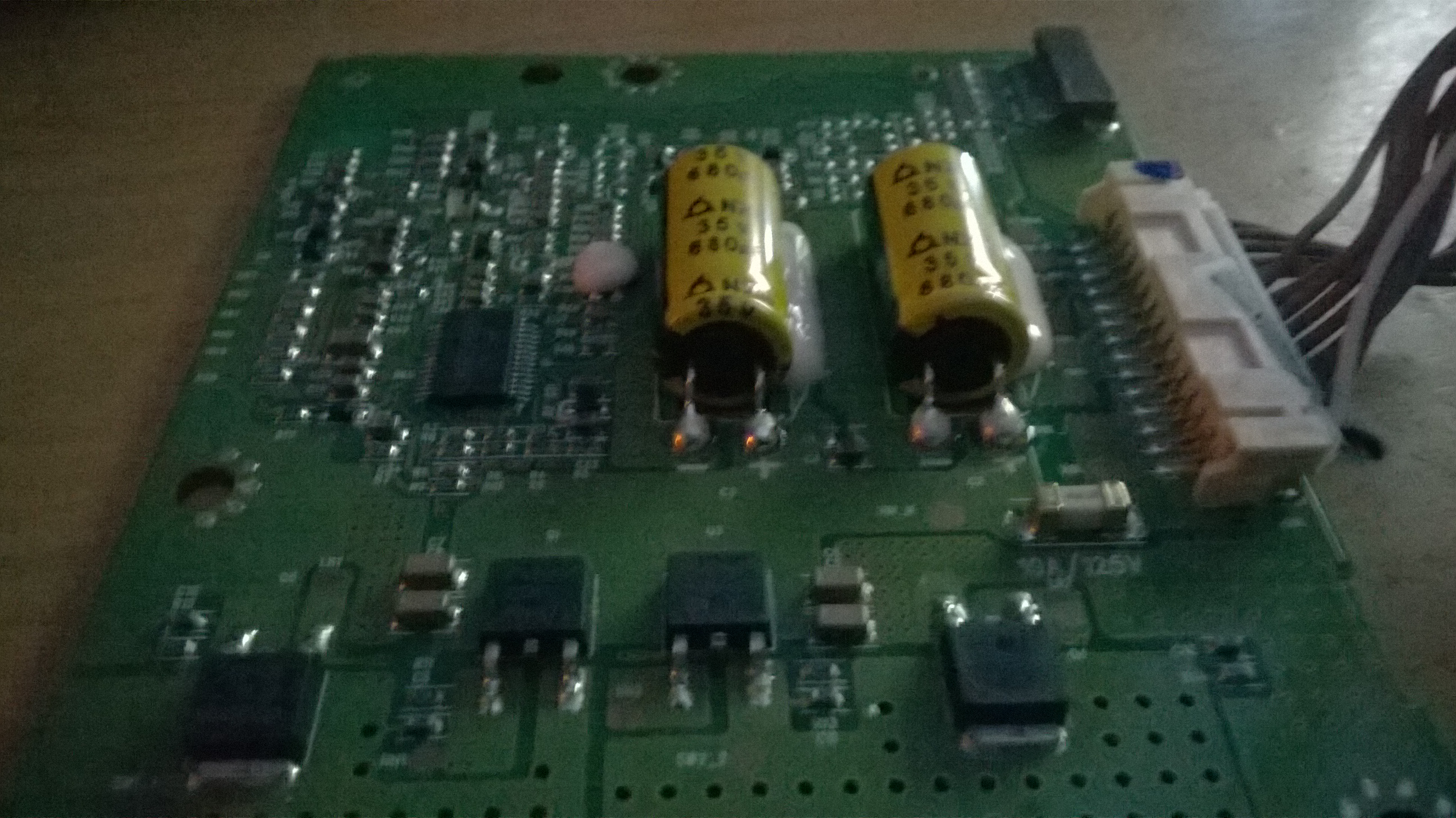

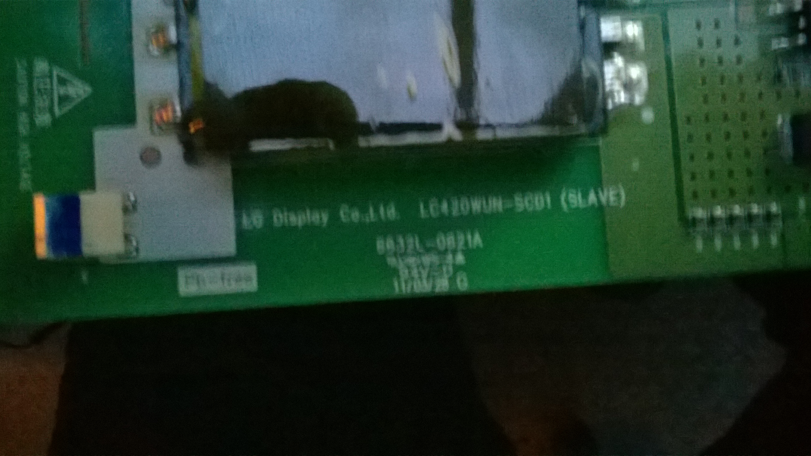

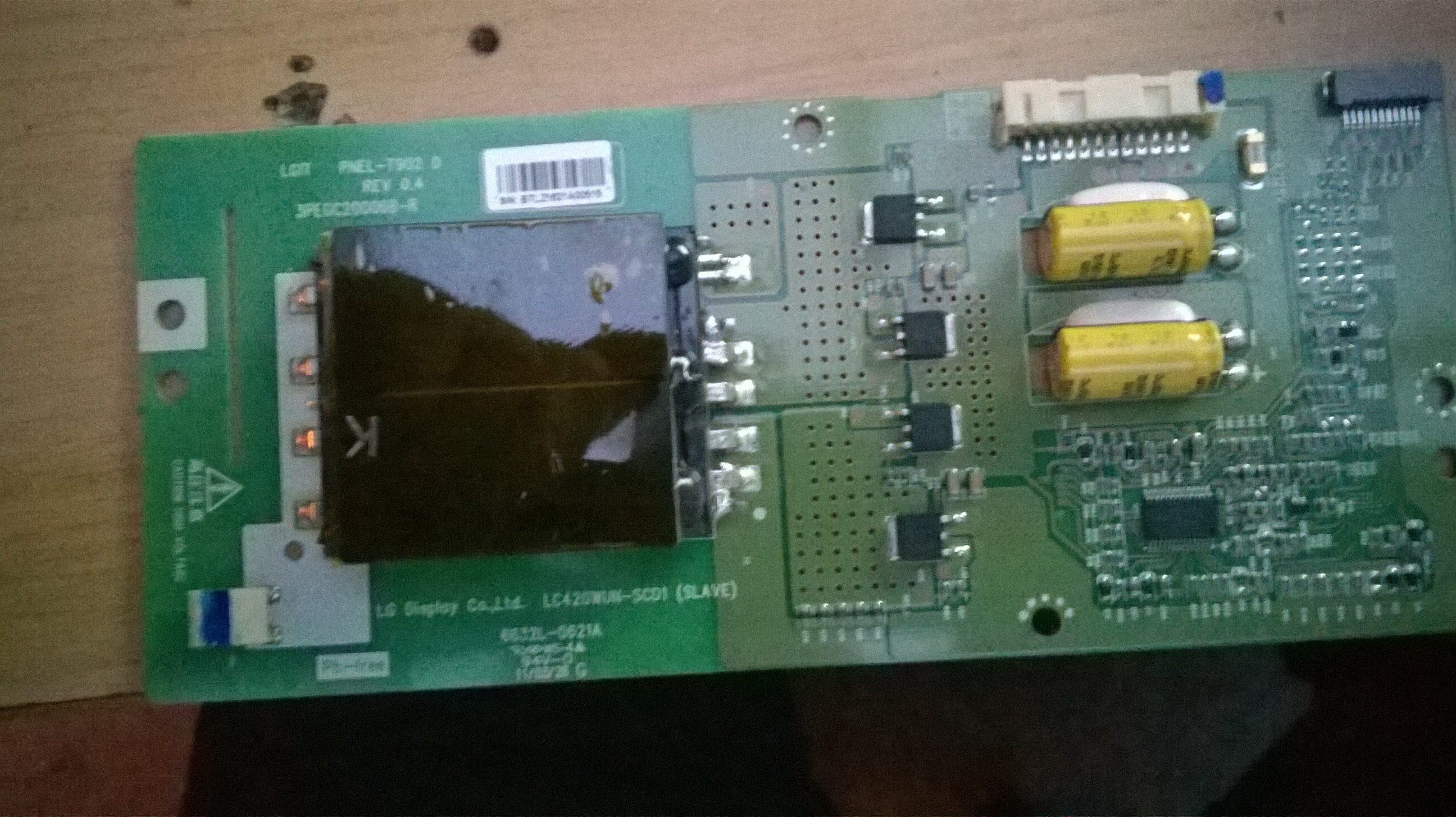

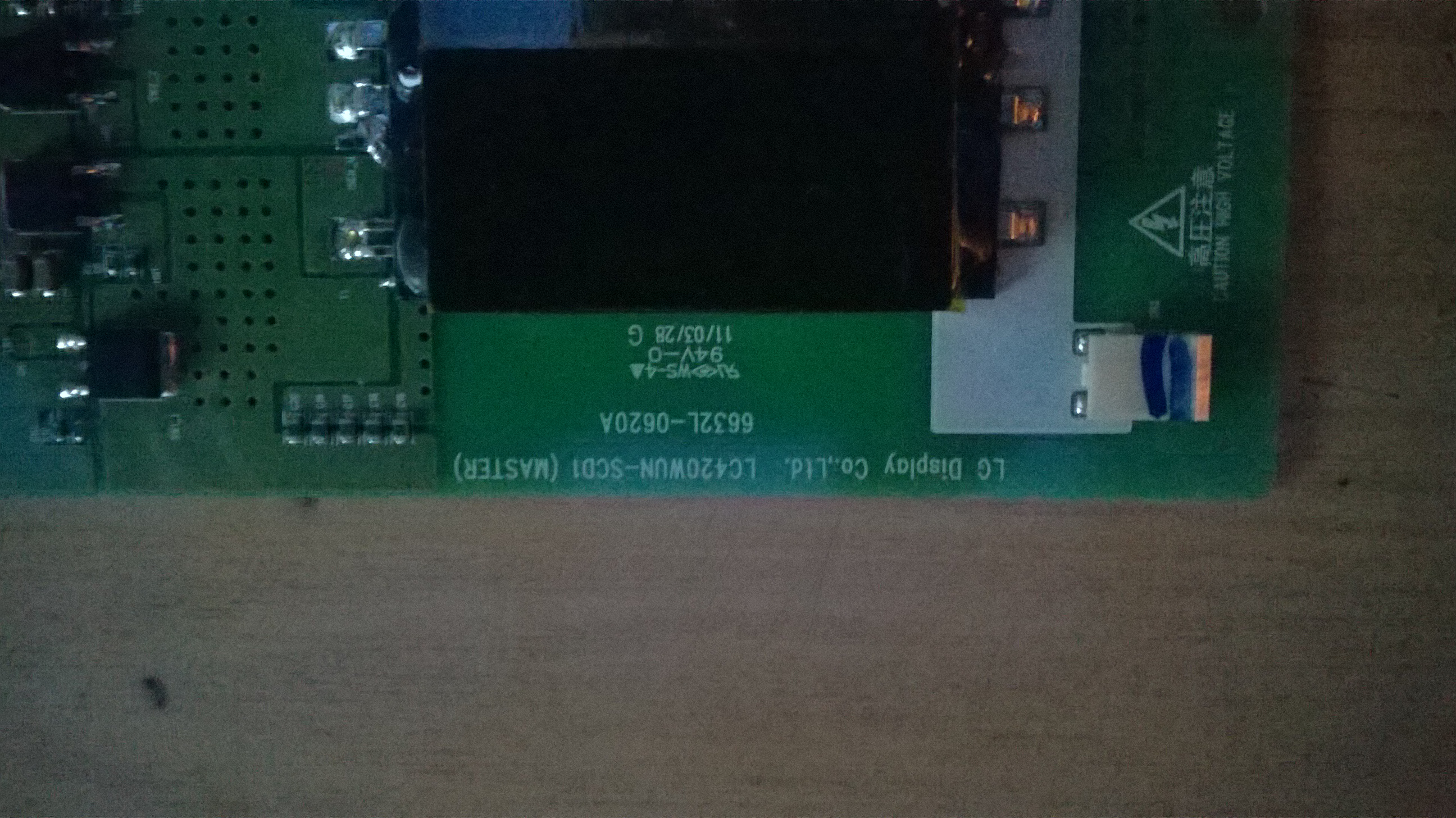

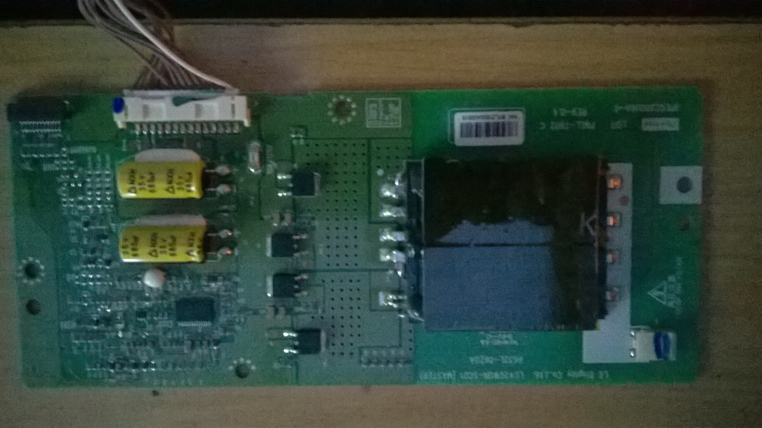

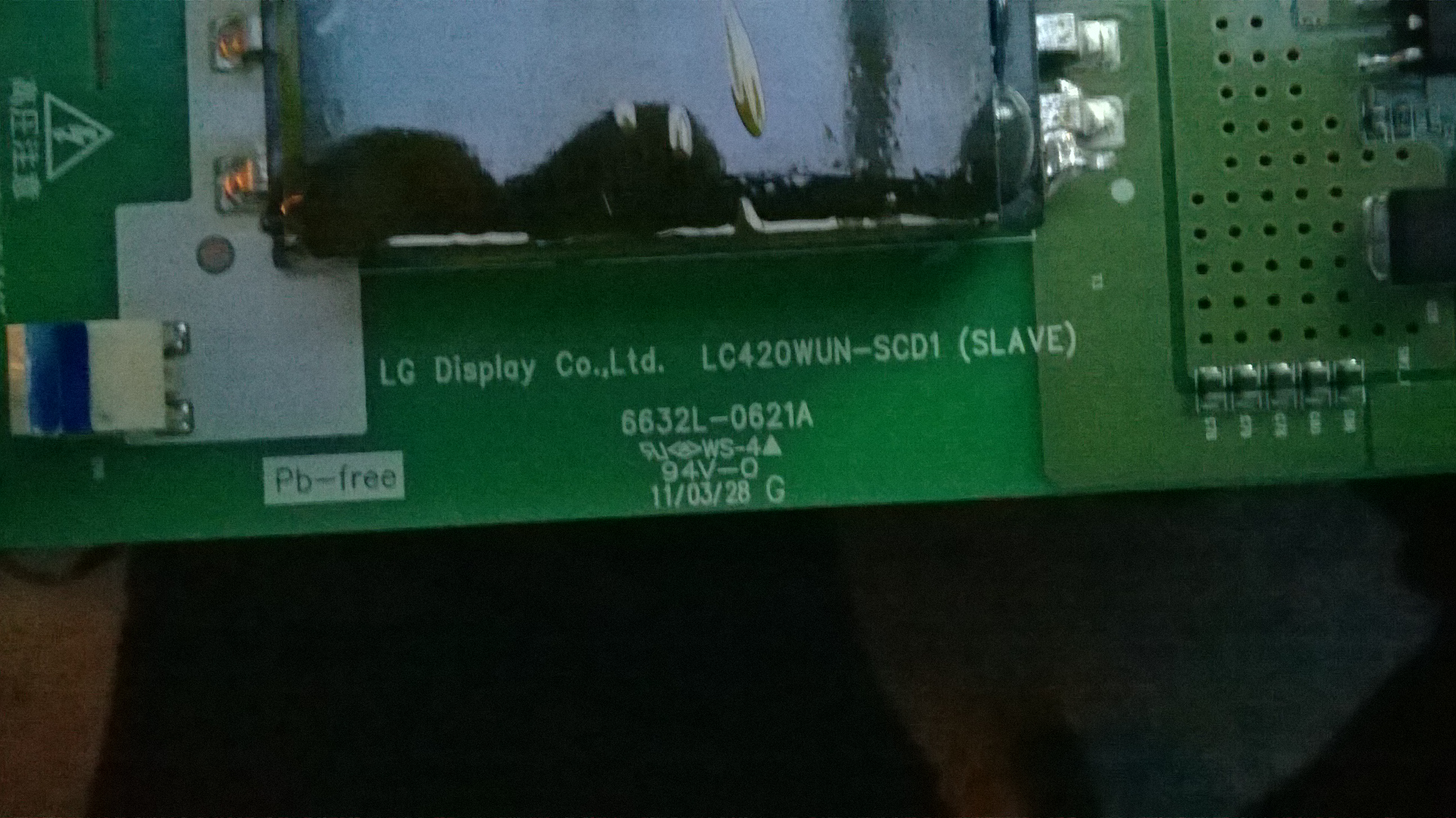

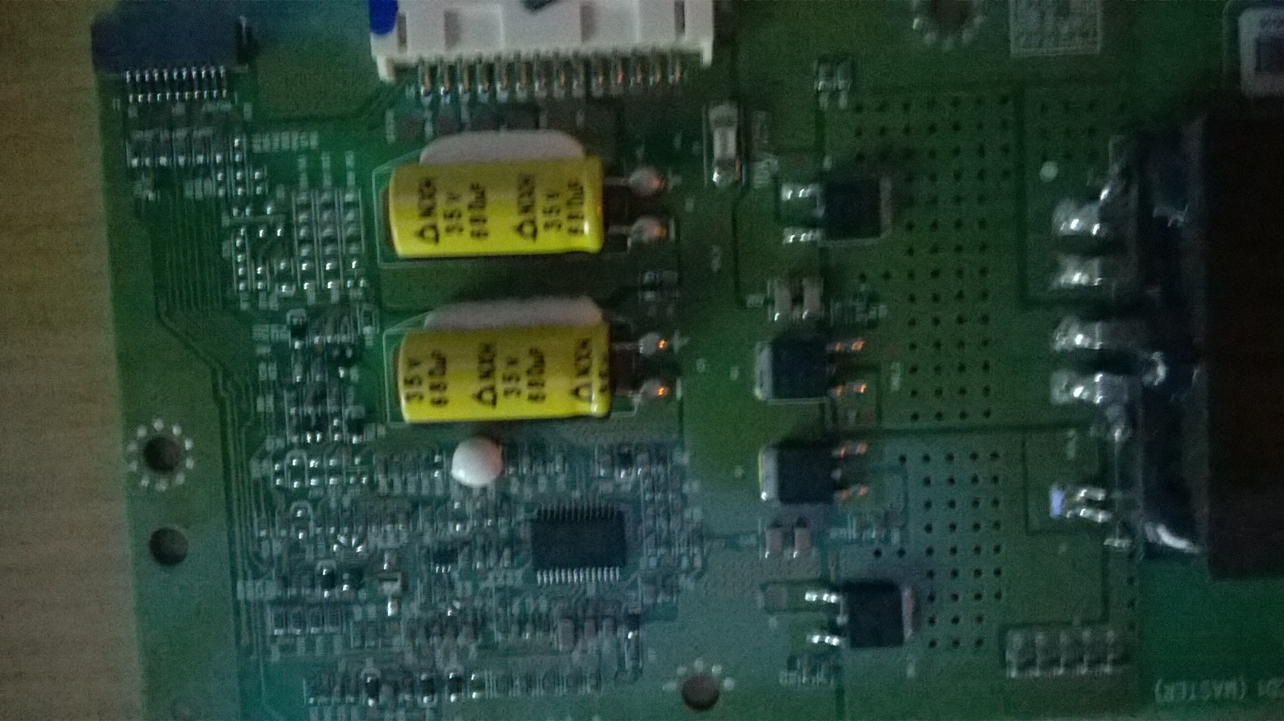

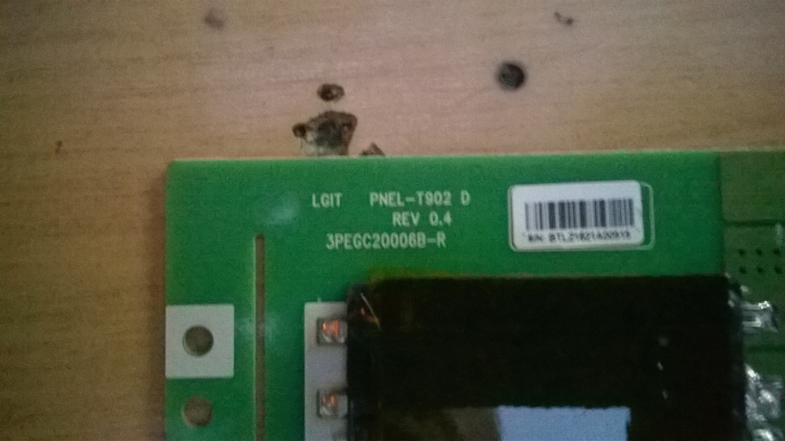

              Here are some more pictures of the inverter boards

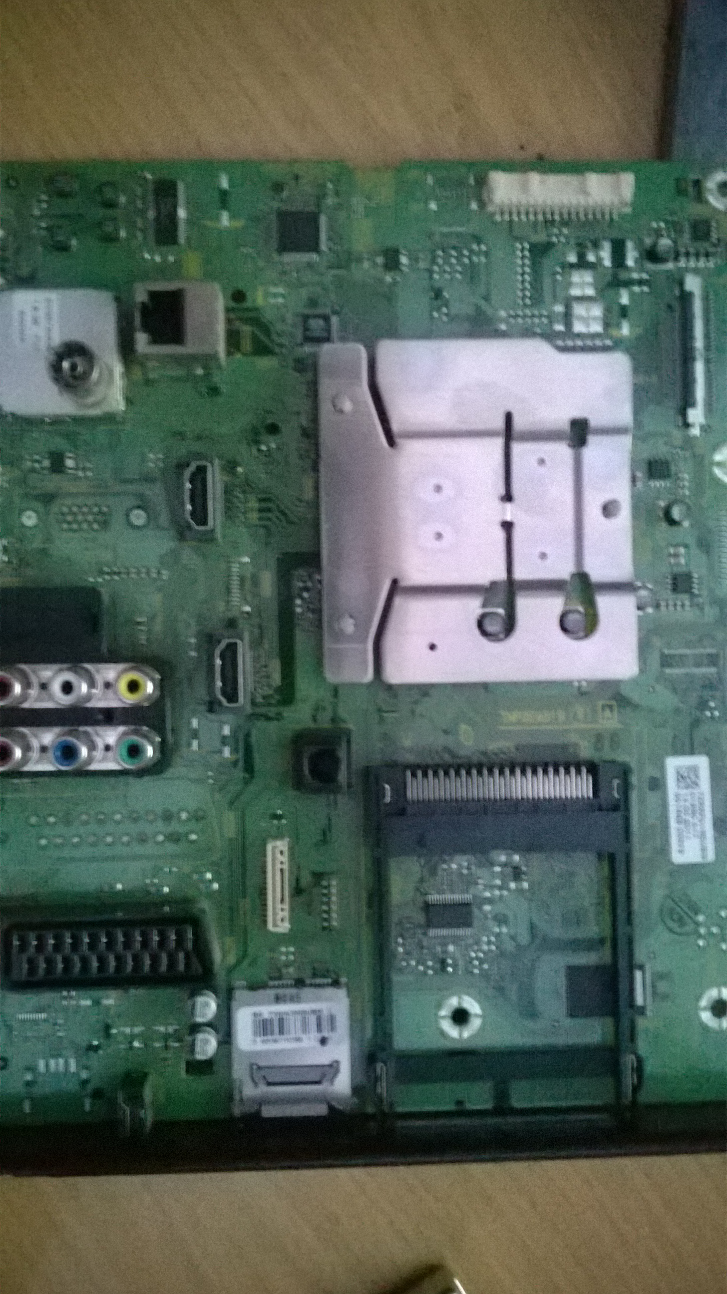

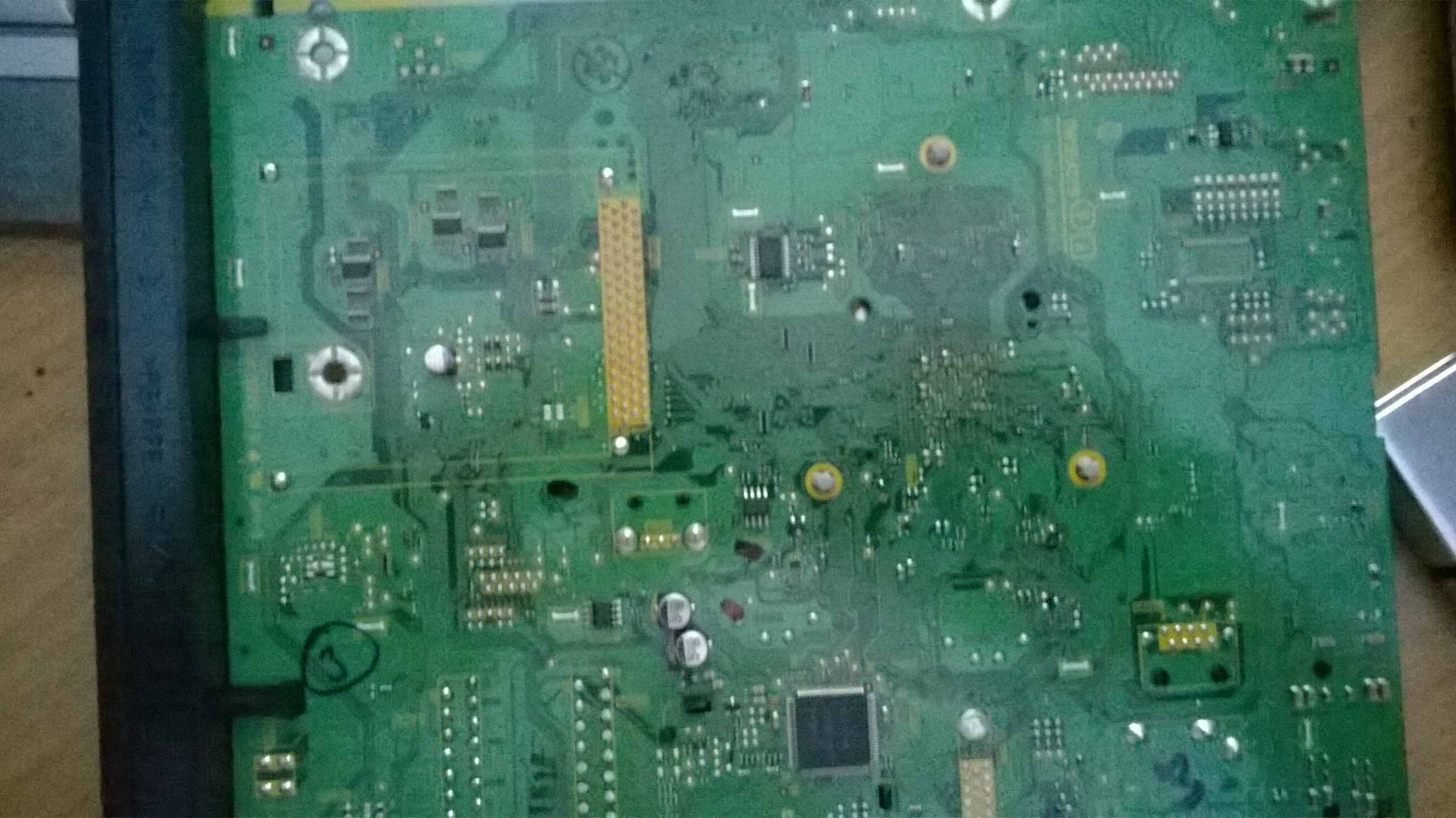

                Mainboard

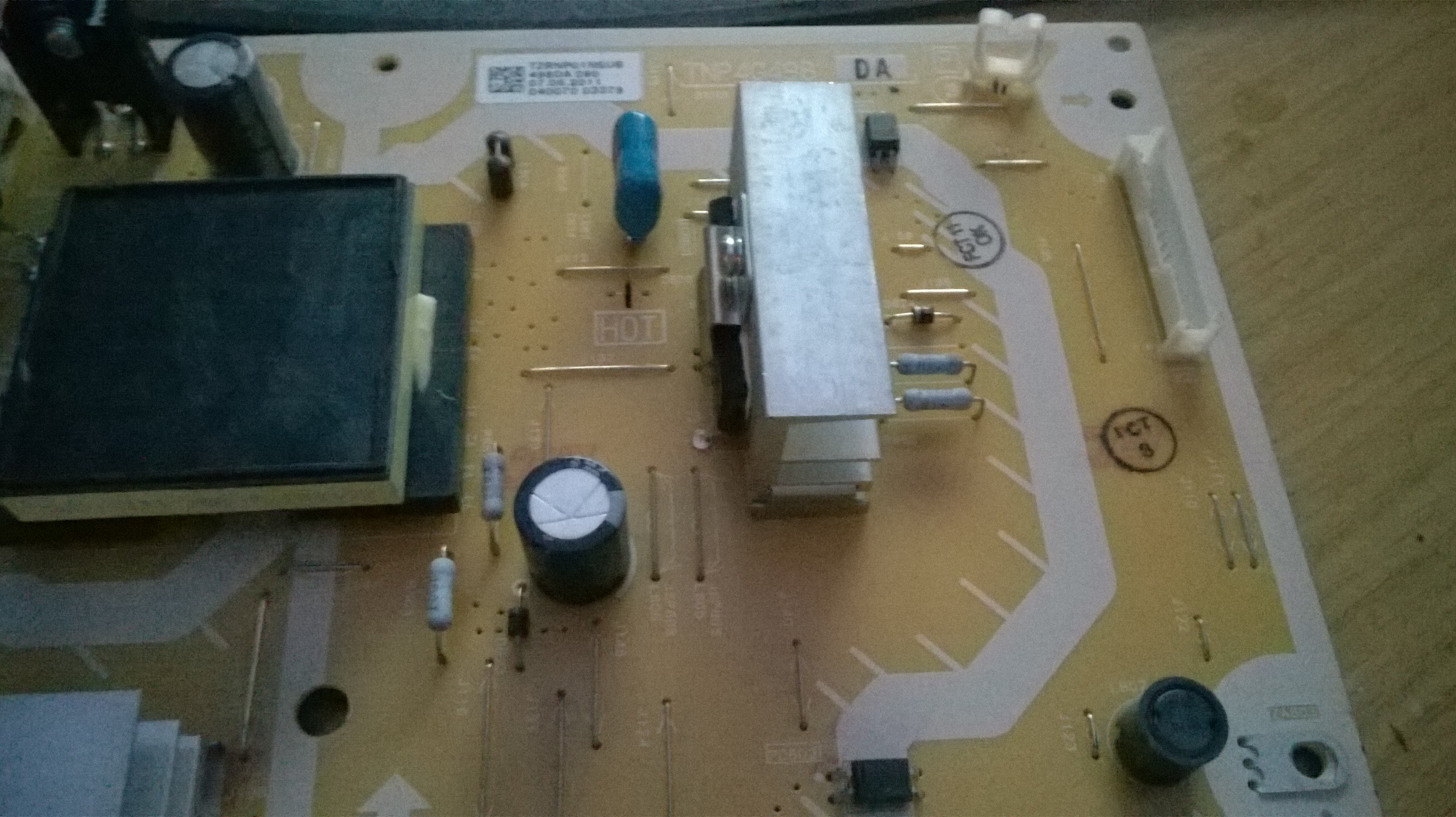

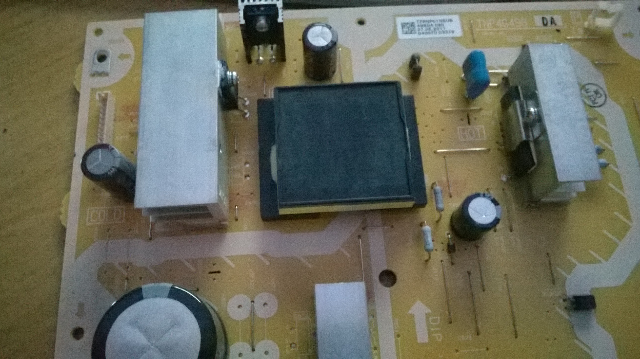

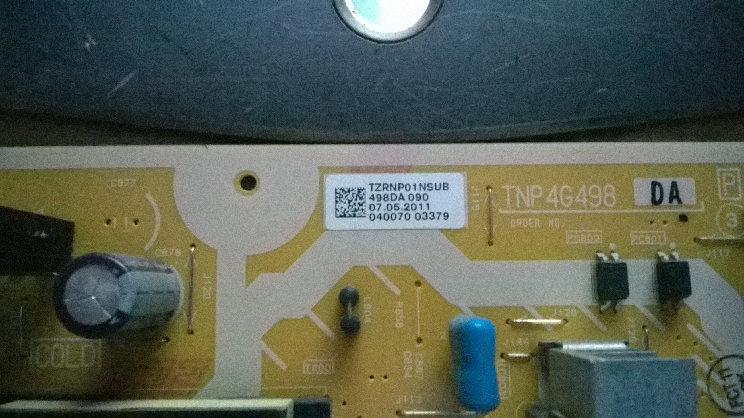

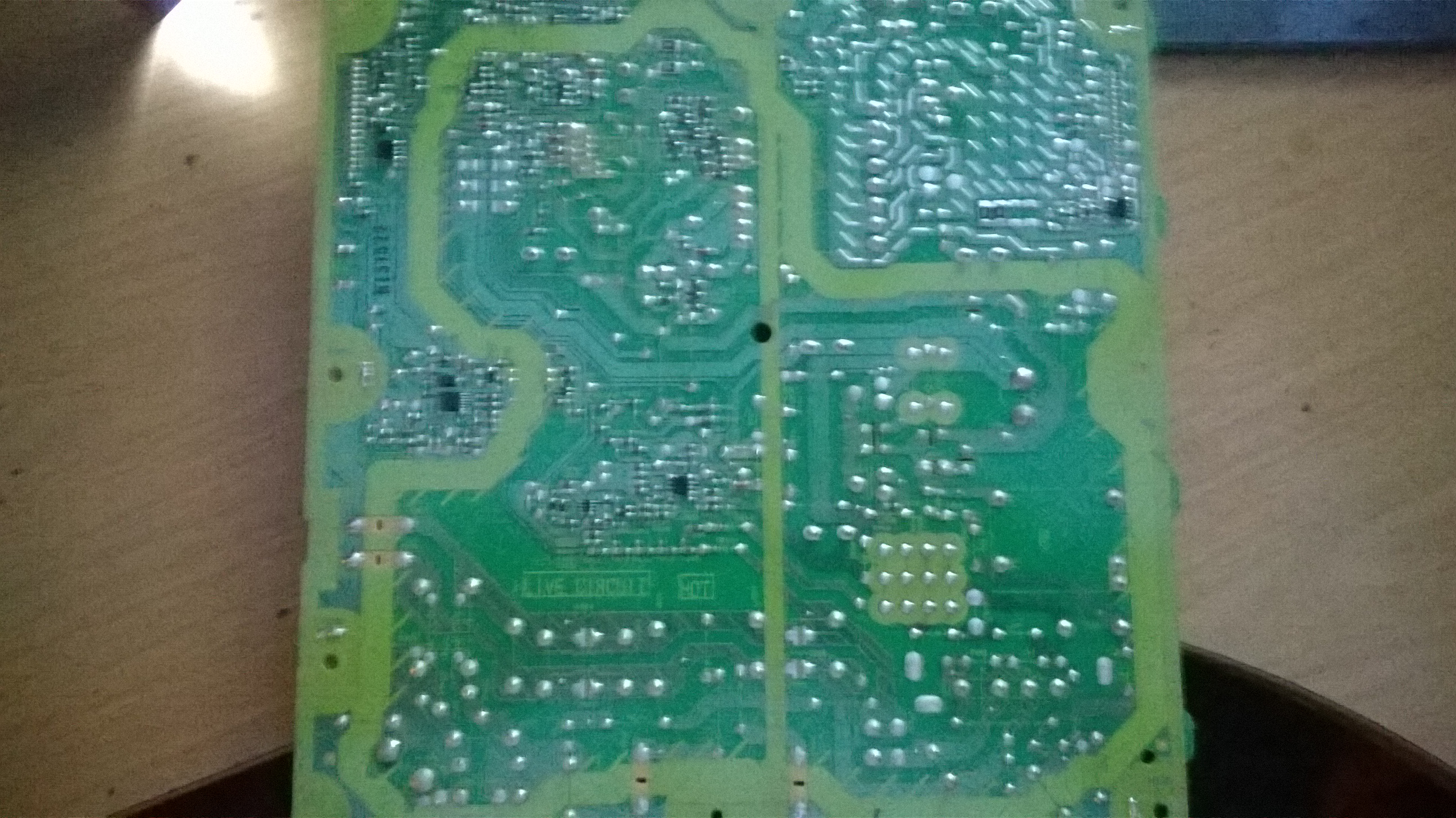

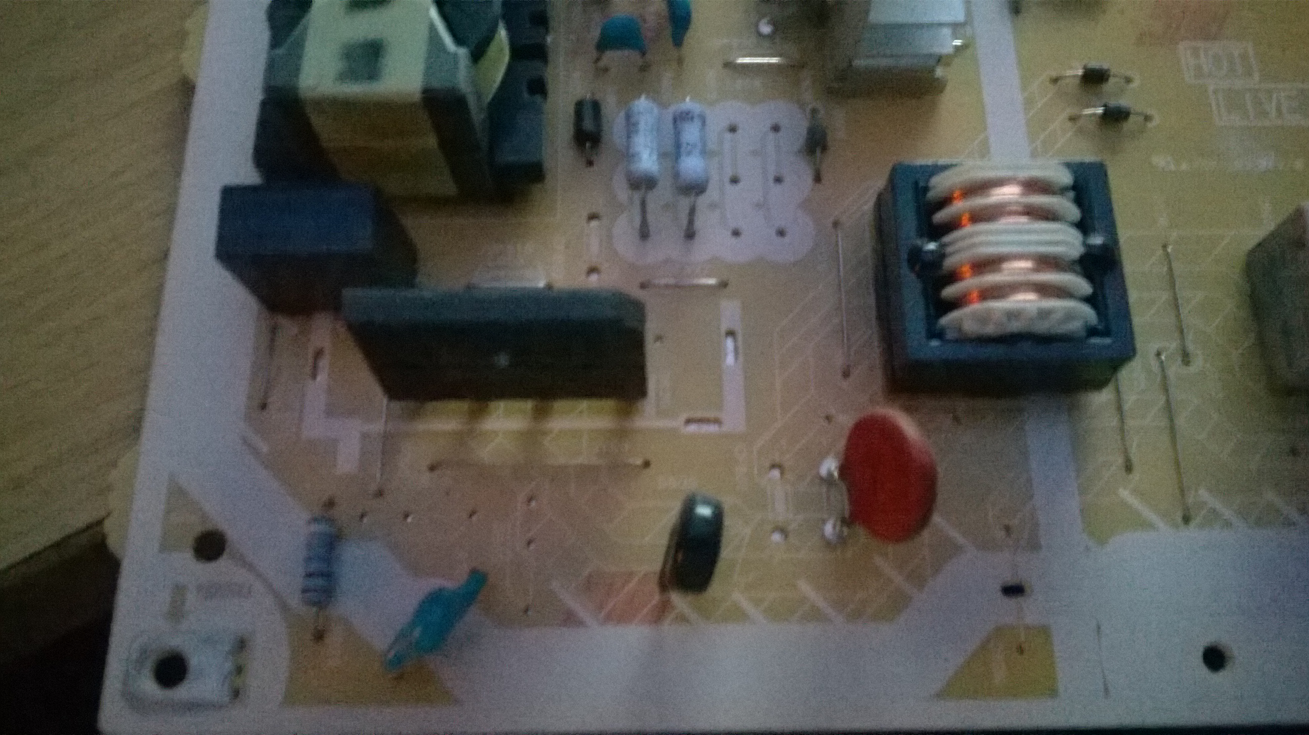

                  power supply board

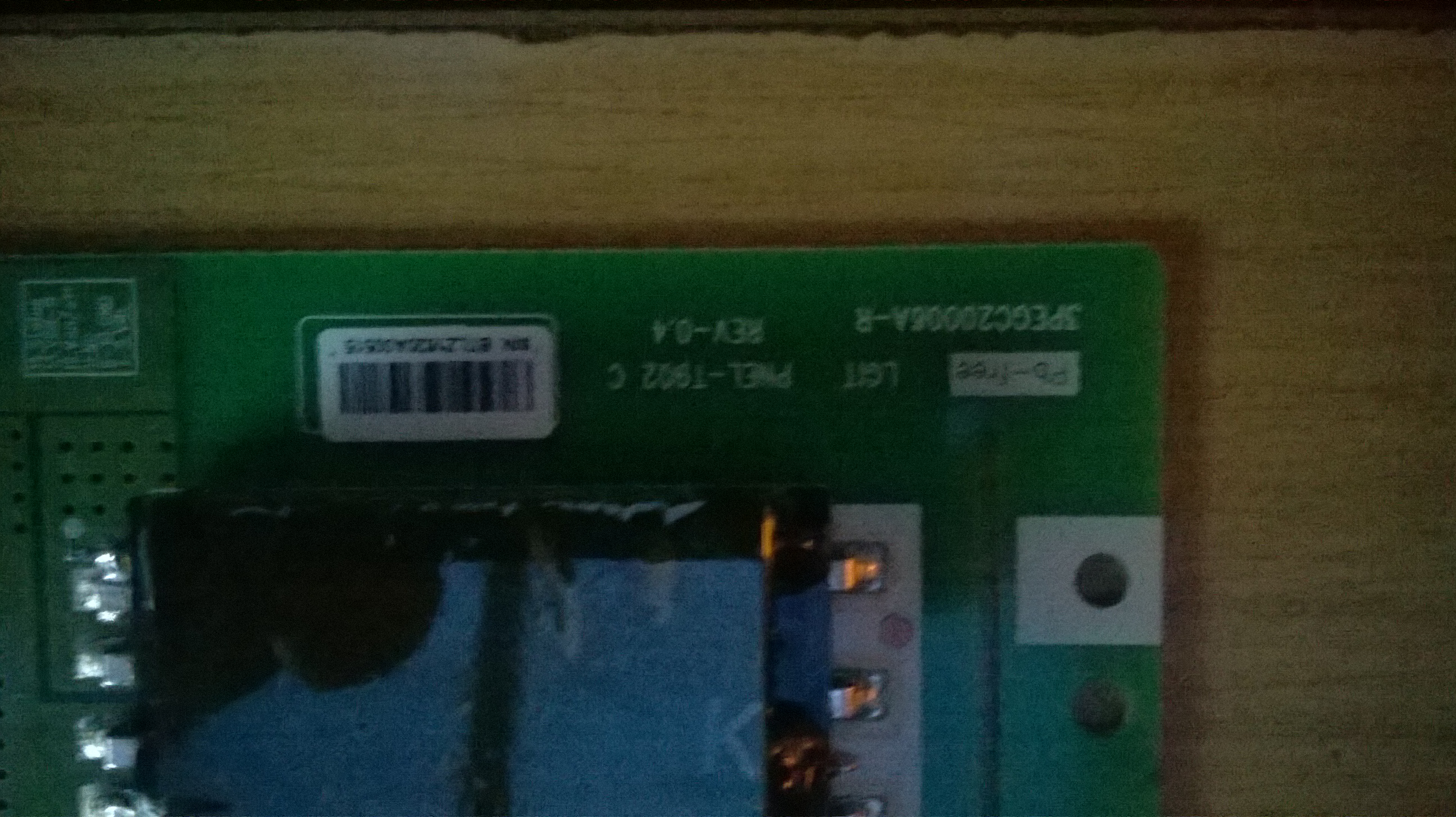

                    Master inverter board

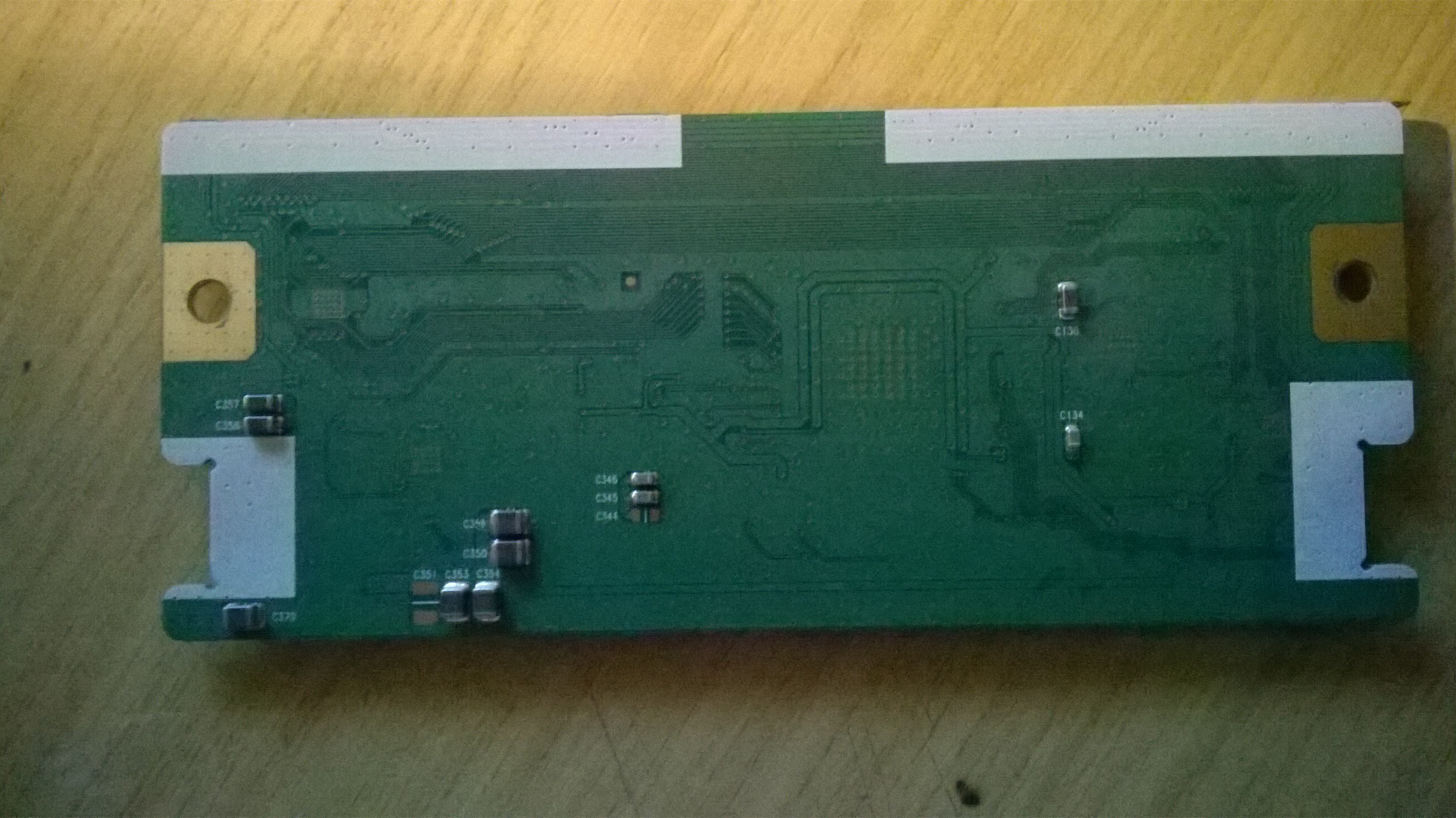

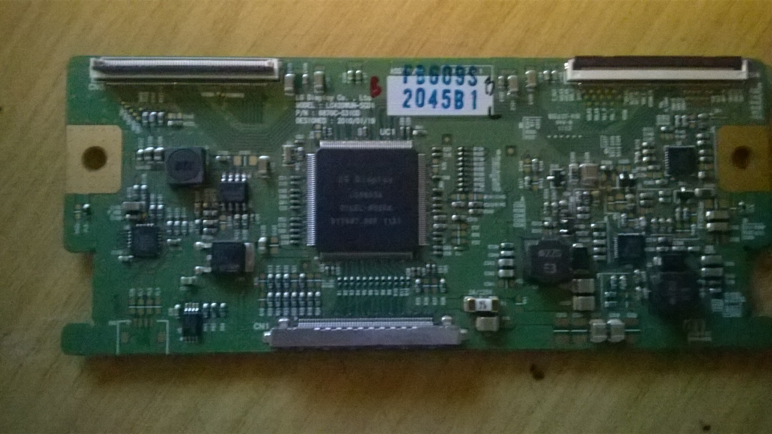

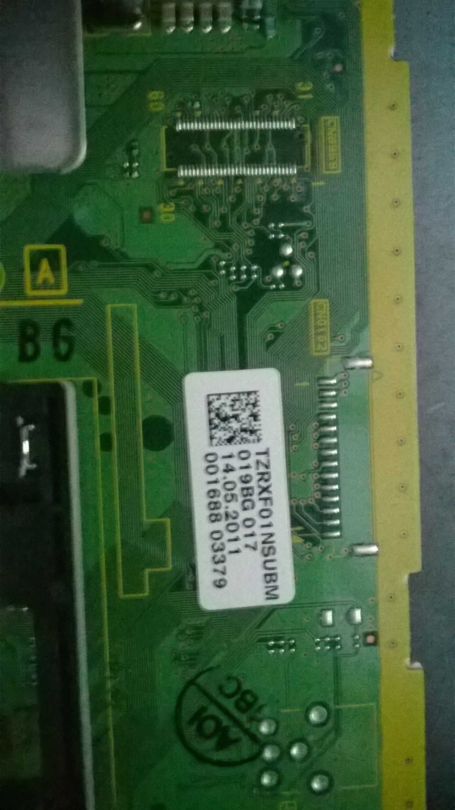

                      Tcon Board
                        Where am I checking for the voltages reece can you highlight using paint ?
