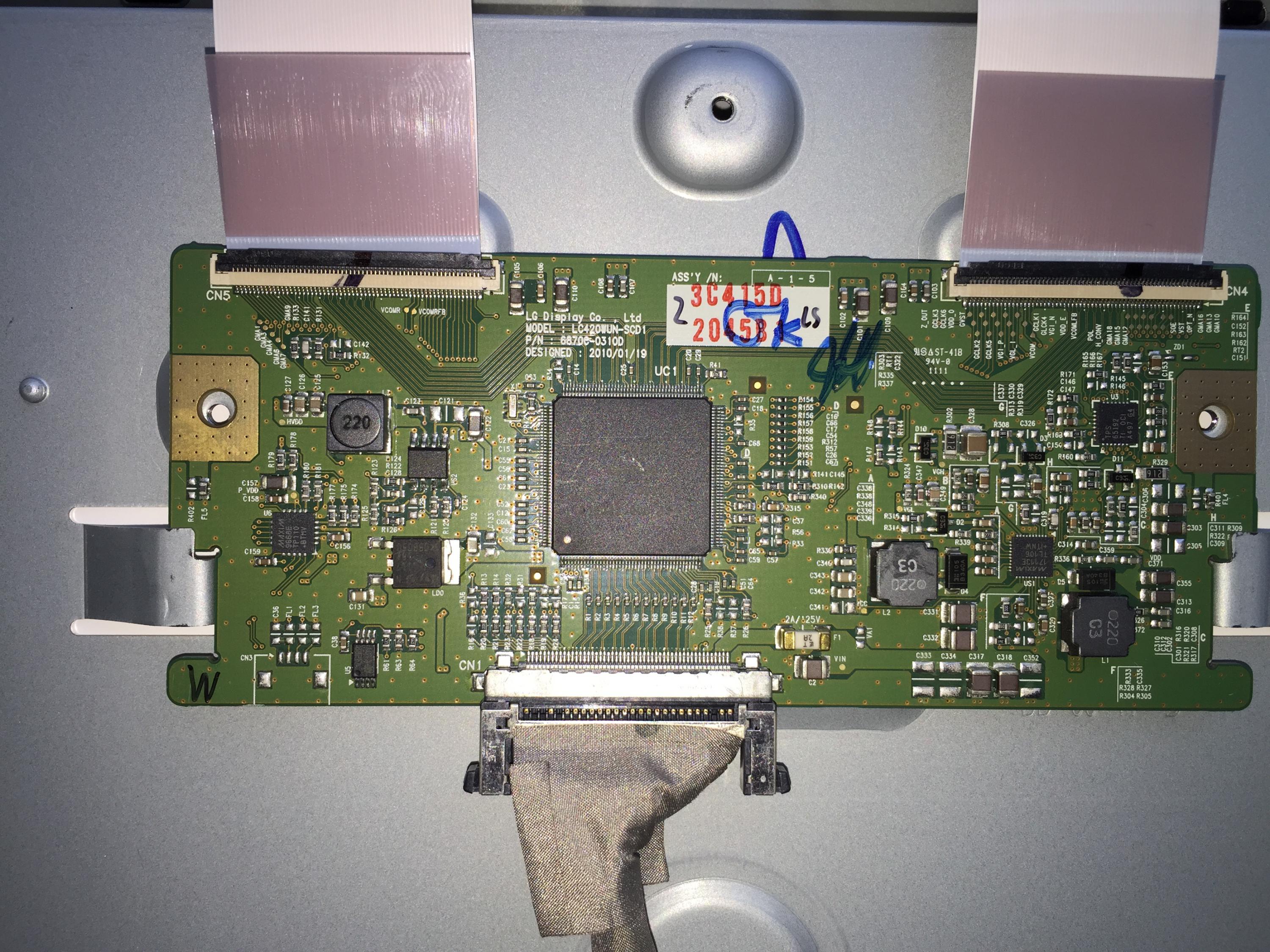

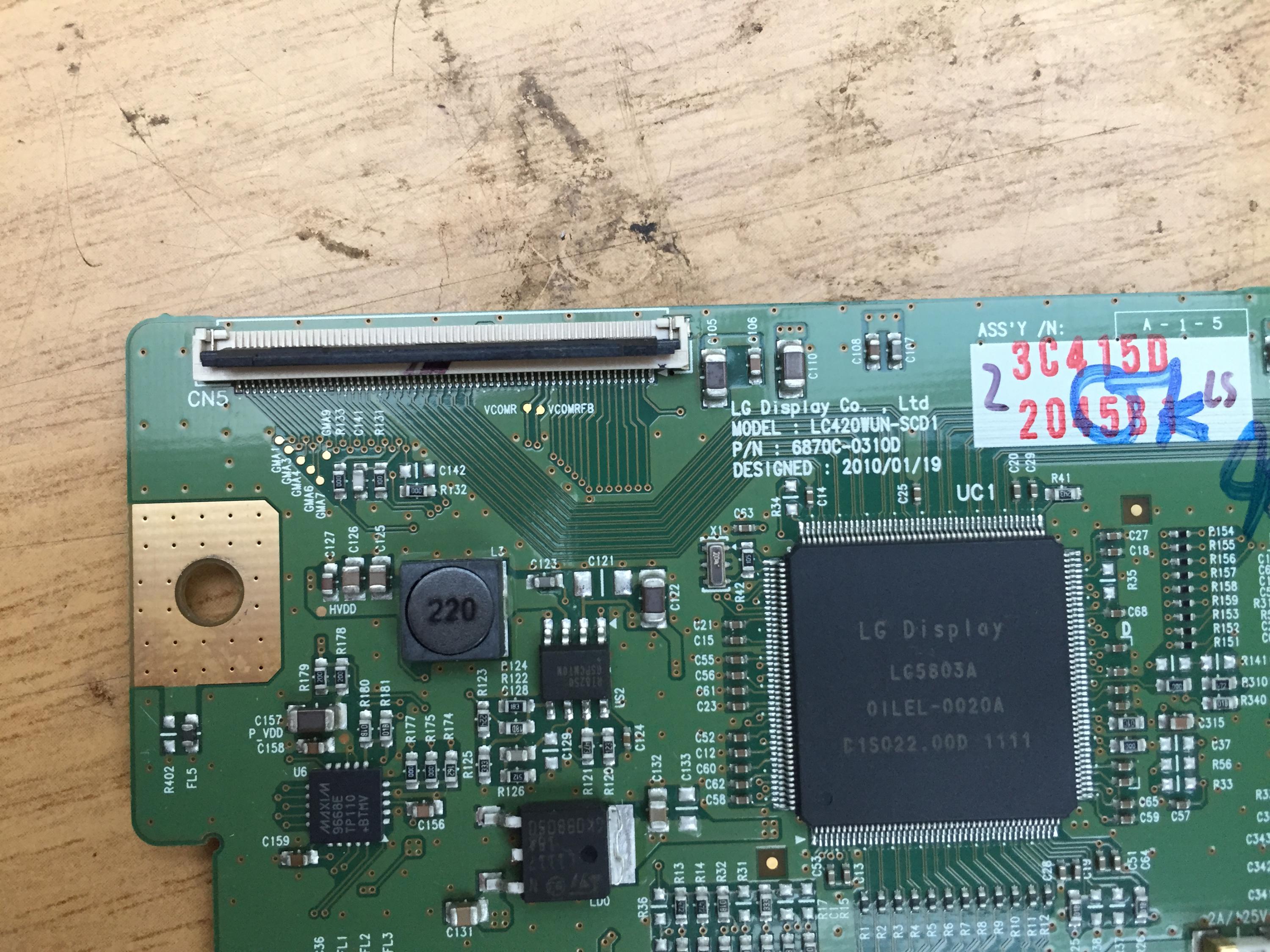

        the woman who is after getting rid of it says they had a new tcon board fitted and it still doesn't work. She also said they still have the original board that they replaced. So for £30 i'm just wondering if it's worth a punt as the parts for it seem quite cheap enough on flat tv parts website

                Re: Panasonic TX-L42U3B dead screen and blinking standby lights
                deffo not the TCON board and deffo 14 flashes on the standy led no activity on the lcd screen either !

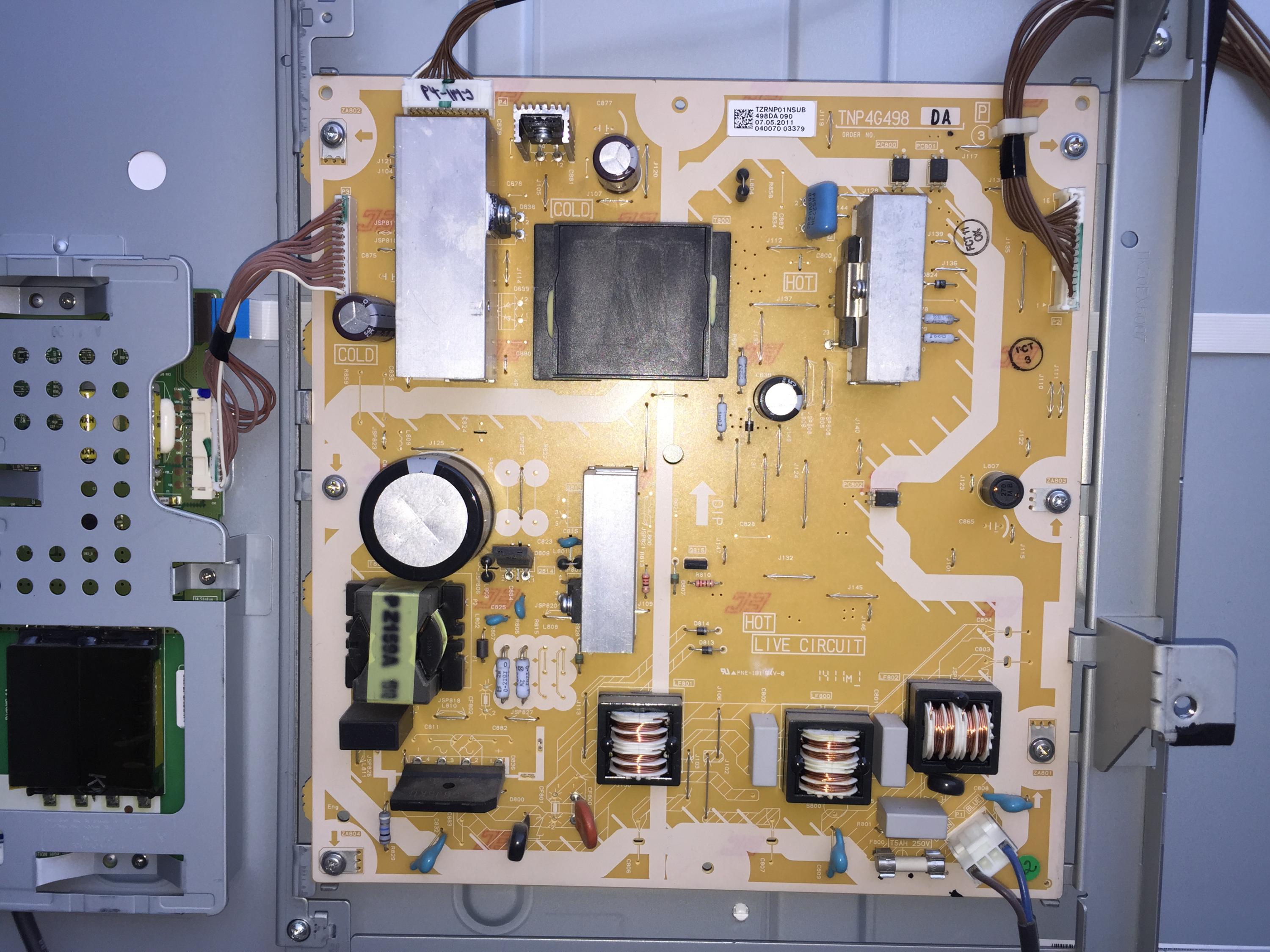

                    nope nothing at all i've tried changing the fuse on the power supply board too
                    and still nothing not even a flicker and still the 14 flashing lights on the front panel

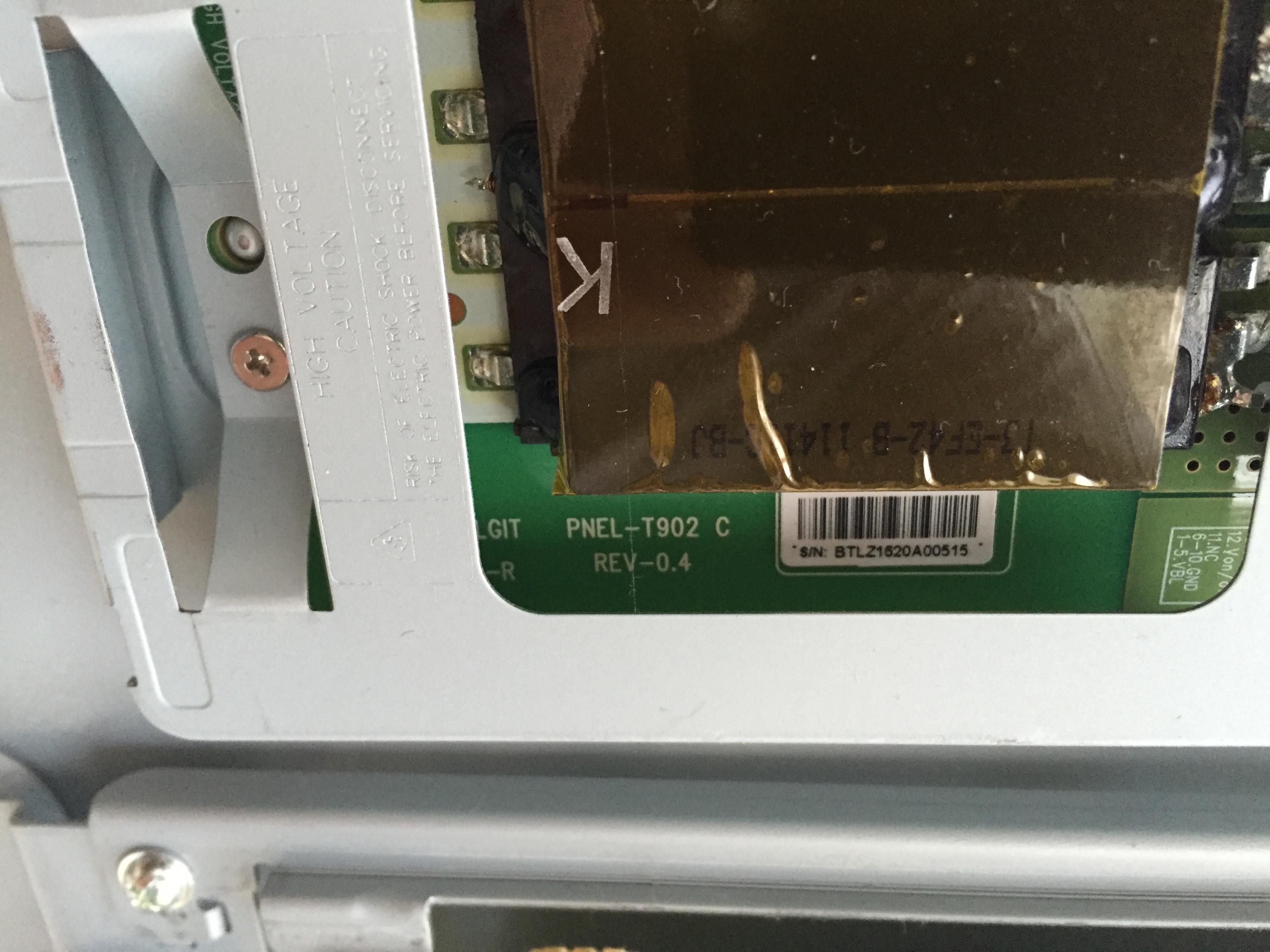

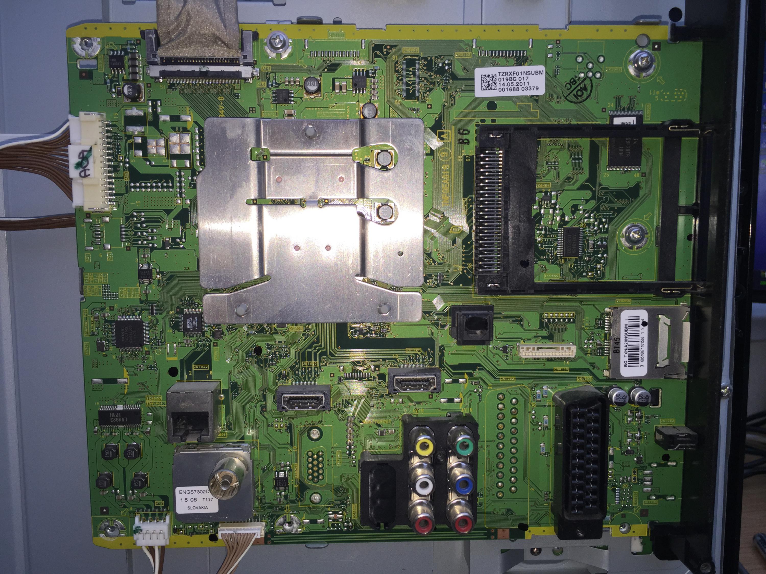

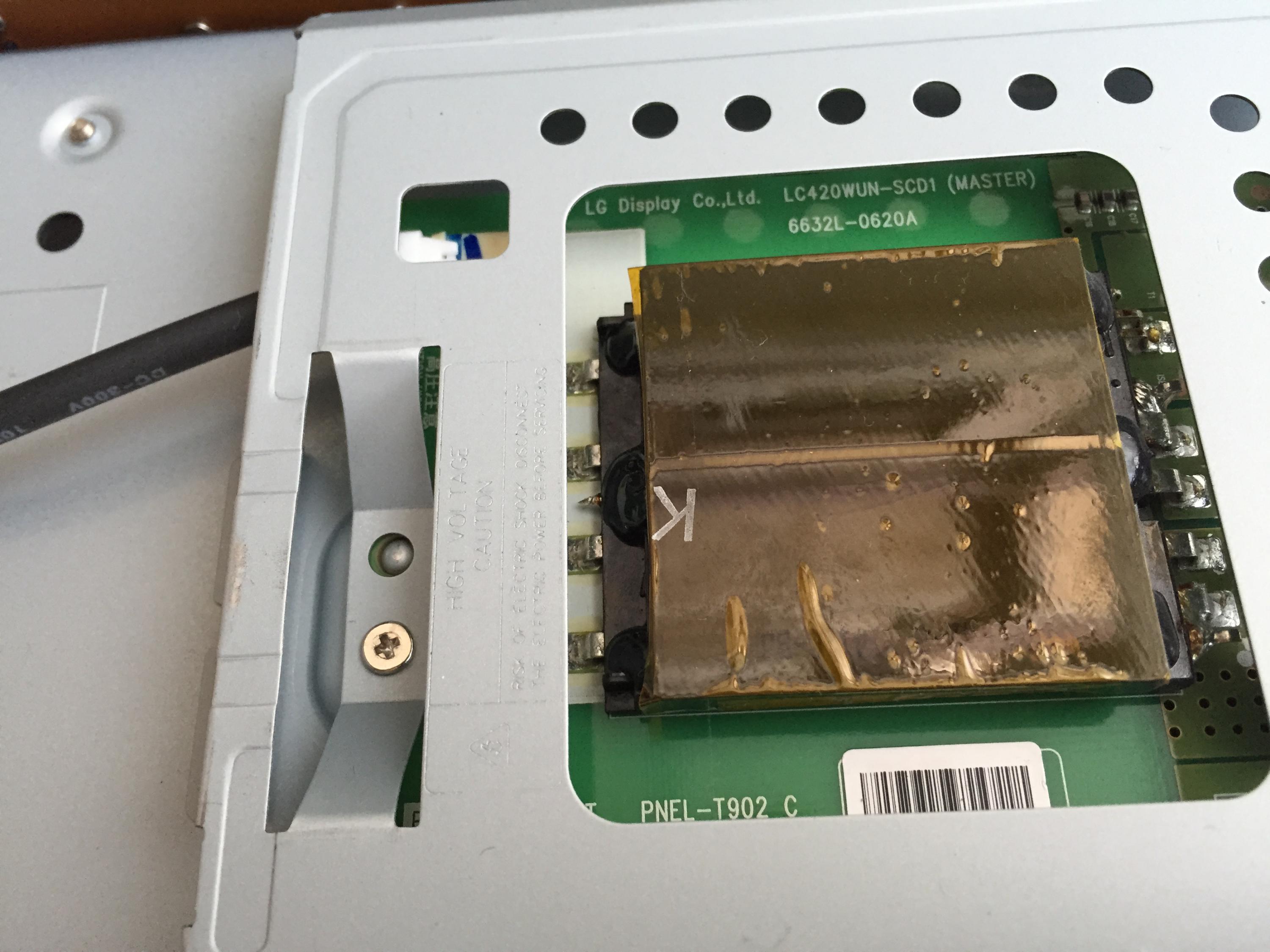

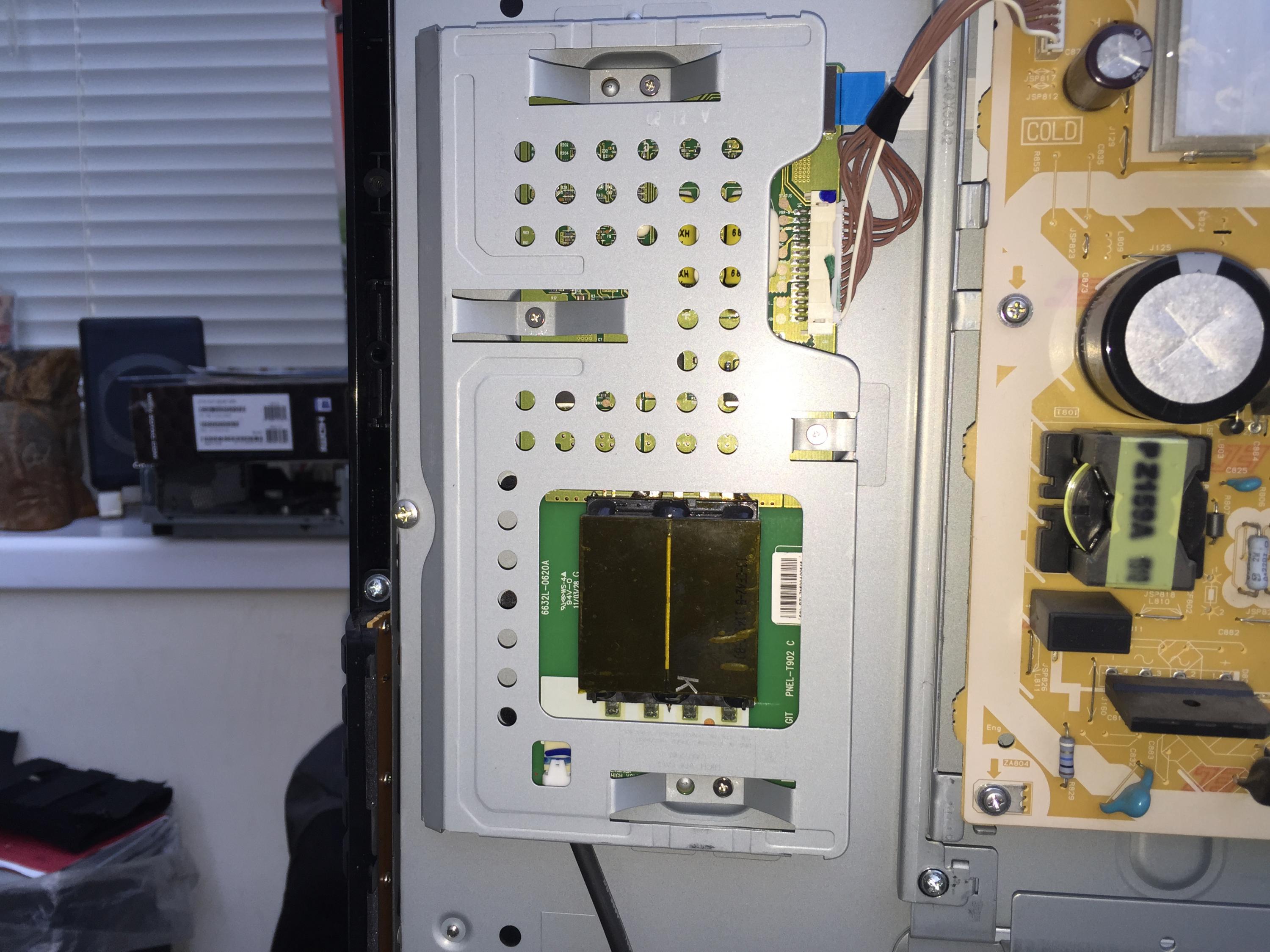

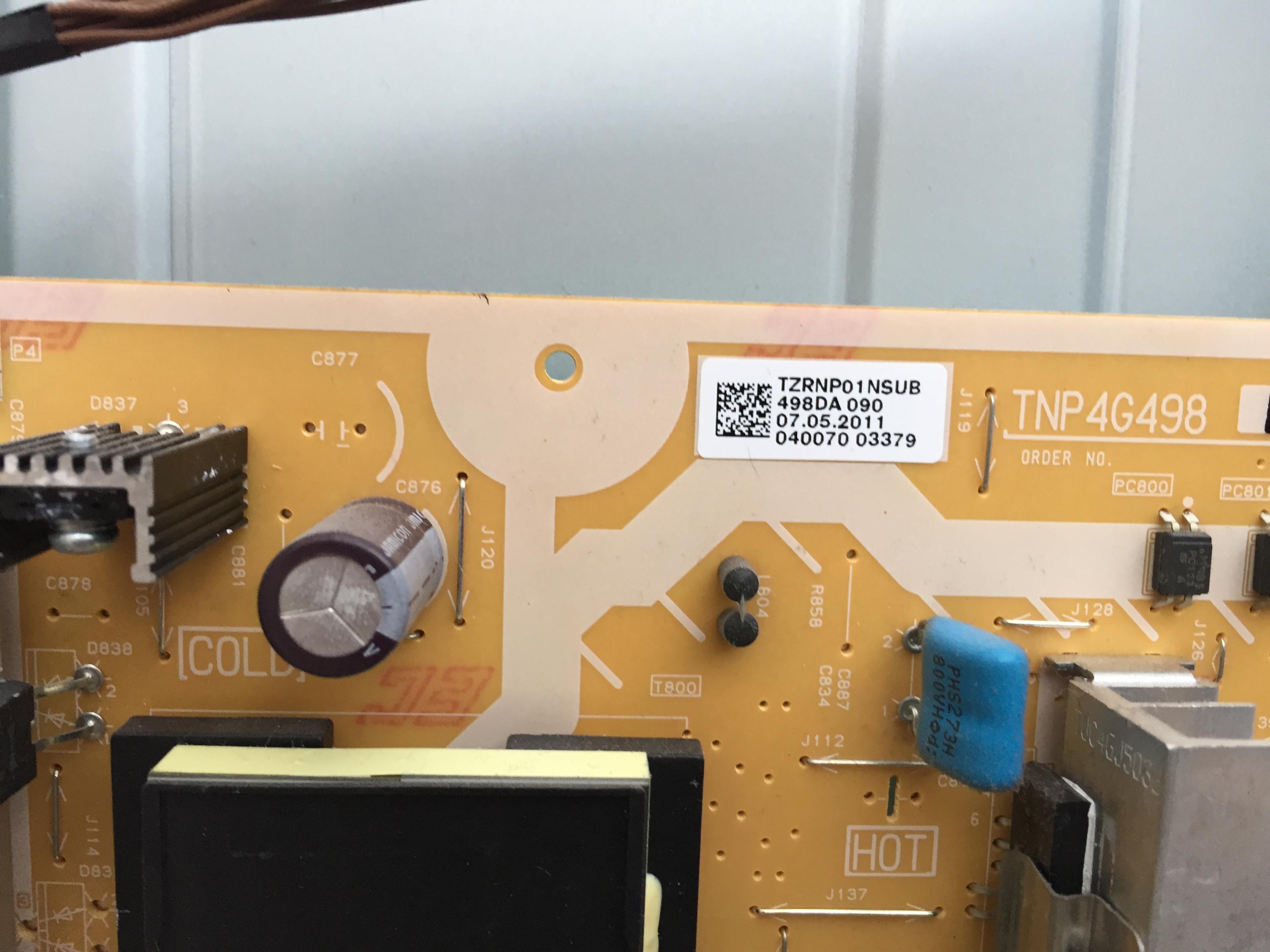

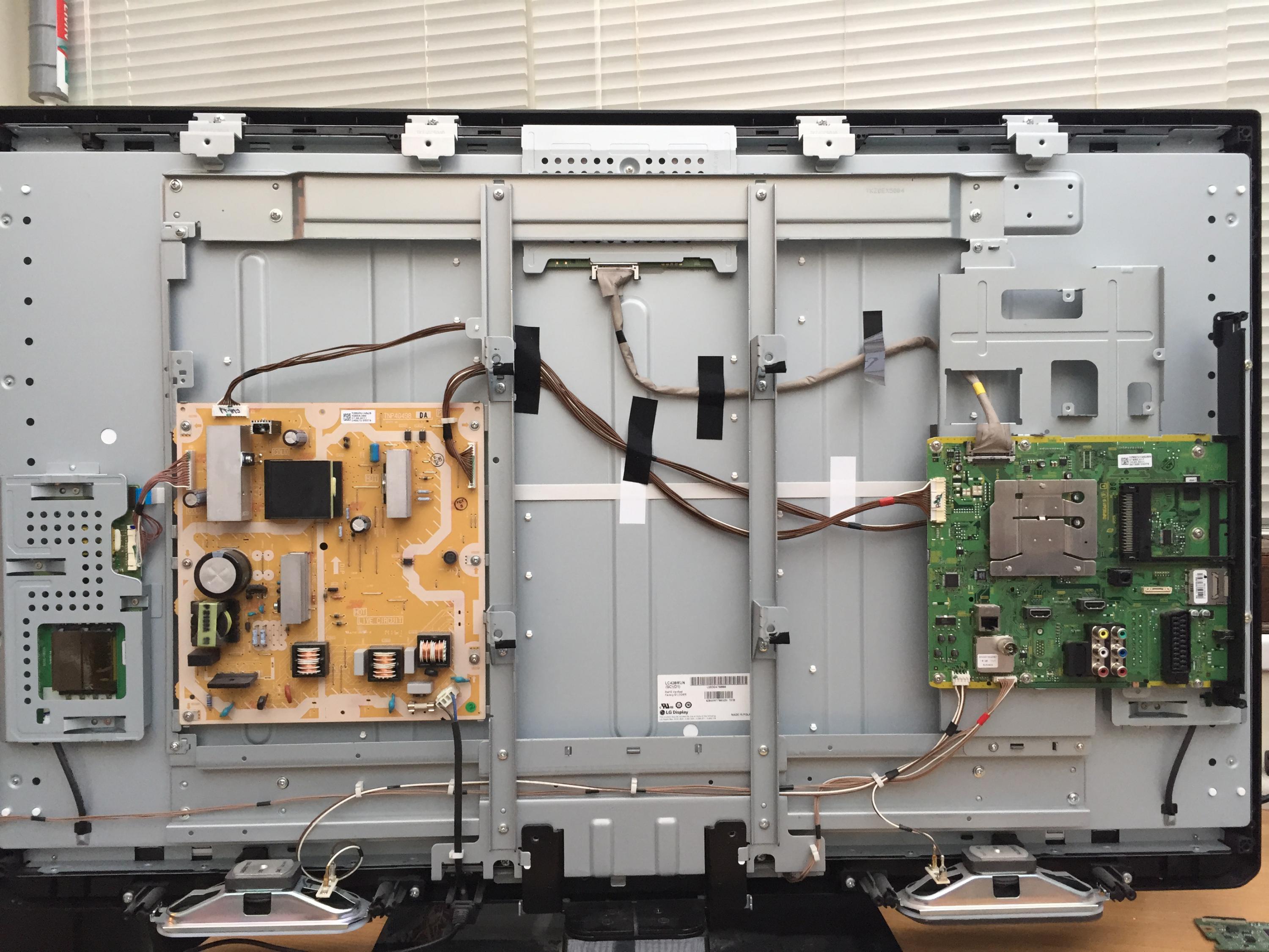

                    • smallprint
                      • Nov 2010
                      • 86
                      here's some pics of the back of the set
                      • smallprint
                        • Nov 2010
                        • 86
                        Again

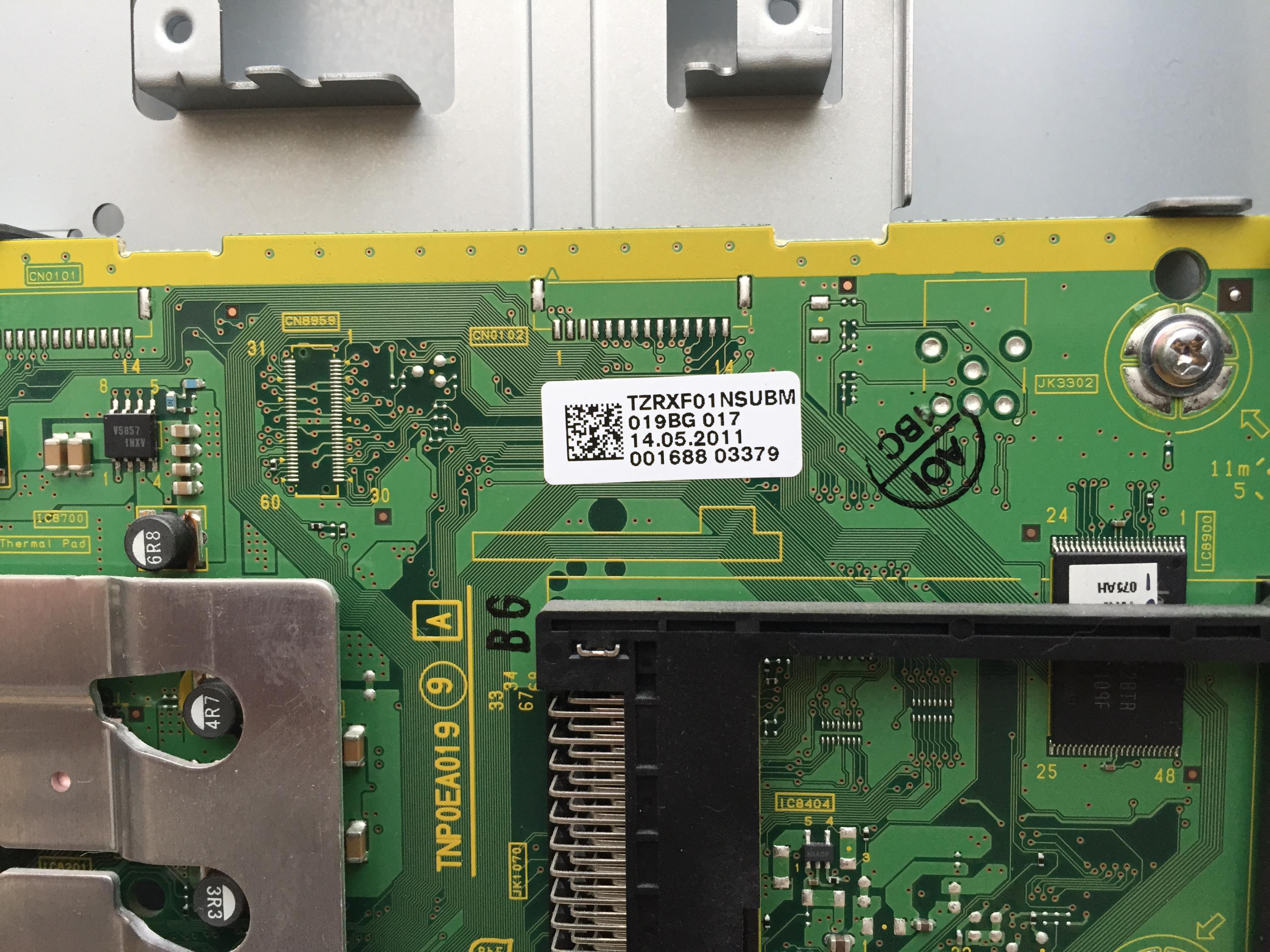

                            it won't let me post attachments at the moment. The guy i spoke to said he'd had it in at a tv repair shop nearby and he'd had a look at it (Alledgedly) he had it for 6 weks and he reckoned it was the tcon board. The guy went out and bought a tcon board from ebay and the repair guy reckoned he couldn't fit it and give him a warranty on on the repair if the part was second hand. Sounds to me he was just fobbing him off any how o've just tried the said part and there's no difference at all with either board. My guess is either the power supply or the inverter or maybe the mainboard. I can't see any burst caps on the power supply and none of them seem to be bulging or leaking.
                            • smallprint
                              • Nov 2010
                              • 86
                              here's the pics
                              • smallprint
                                • Nov 2010
                                • 86
                                and some more
                                • smallprint
                                  • Nov 2010
                                  • 86
                                  and the rest
                                    Can't find a service manual anywhere for this set even on elktrotanya
                                      This is the training guide for the US models in the 2011 "30" series, it should be roughly similar:
                                      Error codes on page 44/46.
                                      • smallprint
                                        • Nov 2010
                                        • 86
                                        According to that it says 14 blinks is the mainboard faulting IROM SOS
