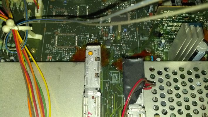

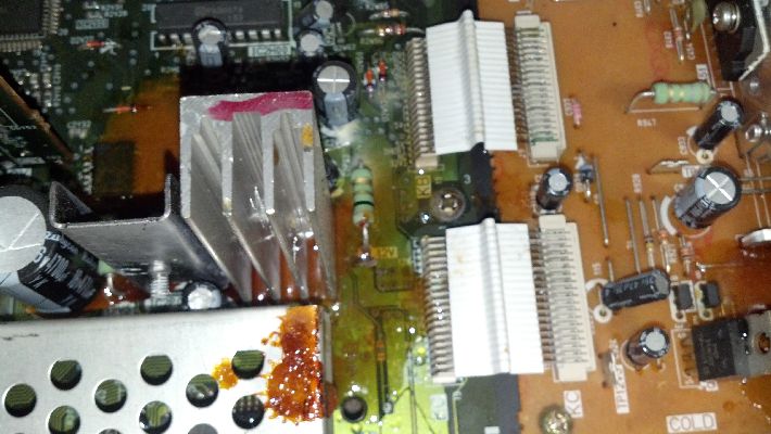

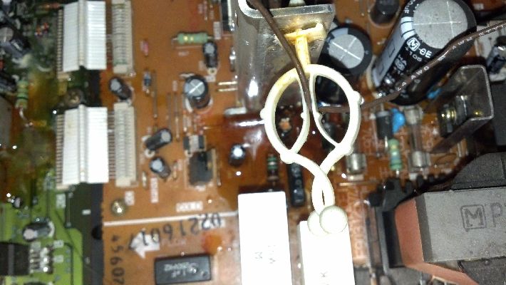

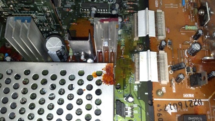

    I have this older rear projection and it has been in DRY storage for 2 1/2 years.
    I knew the local power company killed the power supply because I was watching it when it happened (surge from mains transformer blowing up)
    I decided I would fix it today but low and behold there are 3 puddles of brownish water on the boards. It dripped out of the cones above that the color projectors are encased in. What the heck??? It has been dry from the time i unplugged it.
    Mystery to me but i am not even sure I want to try and fix it now.
    Thanks in advance but has anyone seen this before?

    My guess is that's glycerin or Ethylene Glycol (they used both) from the projector lenses. Its reaching EOL very fast. Also, if they dump the rest, it won't come out of your carpet.

      Re: Water inside Panasonic projection tv mystery
      It's not water.
      http://opa-and-granna.blogspot.com/2...k-of-that.html
      Extreme temperature swings while in storage helped force it out, but they were always leakers to begin with.

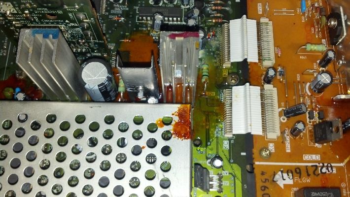

      In addition to a coolant change, those boards need to be completely cleaned of the stuff. Otherwise, the power supply and deflection/HV out will burn up.
      Beware that some CRT assemblies are held not with screws/springs, but torsion rods. If that's what you've got, you'll think you can open and clean the CRTs/chambers, but you'll never get them back together. The tension is too strong and jigs are required.

        Hey thanks to both you guys makes sense now. In my mind I would say it is nowhere near worth the trouble to repair... I will likely pull the boards for salvage, any other Ideas out there Id like to hear... the waste truck runs on thursday

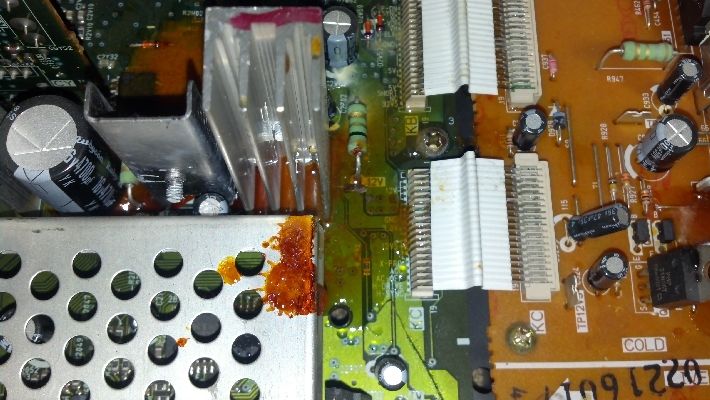

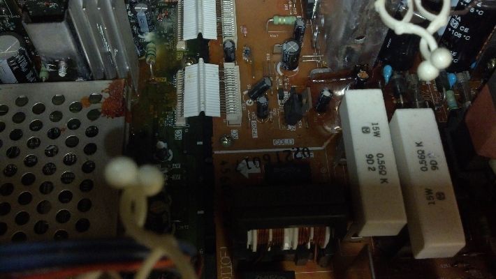

                  If the glycol solution sat on the boards for any length of time, as in the OP's case, I'd be concerned about the fine-pitch traces on that double-sided signal/syscon board.
                  The power/sweep board(s) weren't as prone to that, with their heavier traces, but they must be properly cleaned. Either in a dishwasher or a mild Simple Green solution and rinse.
                  Any residue is conductive, and that silicone around the CRTs' anode connections was a response to a problem. Slow weeping leaks used to make the HV short out, so the idea was to "seal" the HV away.
                  But the coolant still leaked on some of them. I recently gutted a Mitsubishi with better-than-average coolant retention; even so, there was evidence of very slight seepage.
                  I think the drip shields became mandatory by UL spec, after a number of RPTVs had (power/sweep) board fires back in the 80's.

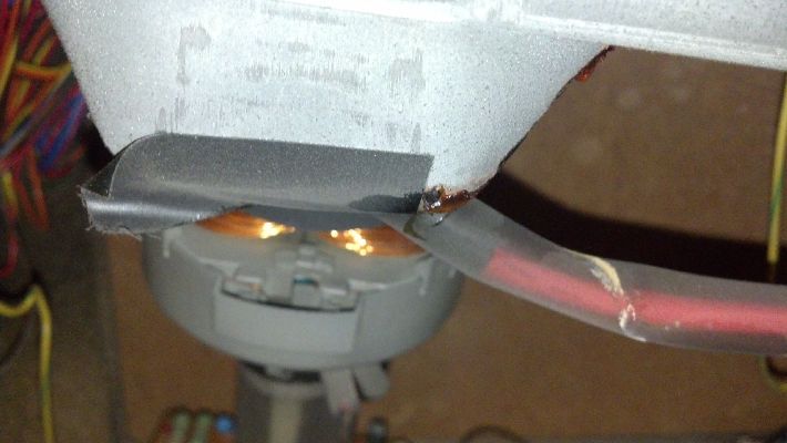

                          • 31293

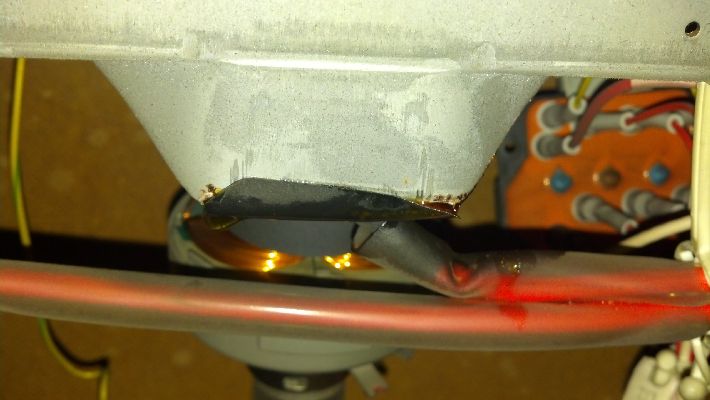

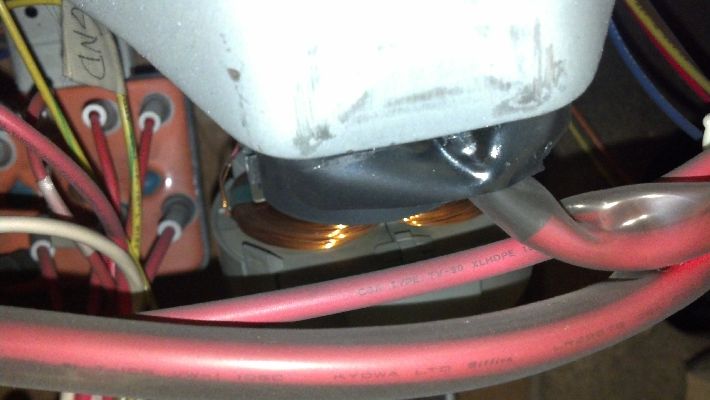

                          can you post a foto of the front of the tube and lense.
                          there is usually something sticking out of it like a small bottle to handle expansion when it all heats up.
                          btw, the coolant is to stop the phosphorous on the tube burning because the brightness is so high.
                              I will try I have to get some actual work done but ASAP
                              It's been sitting there 2.5 years... no hurries, I just hope I can learn a bit.
                              Never worked on one of these before.
                              Seems like a lot of trouble. I will try and get some good photos now that I know better where to look.
