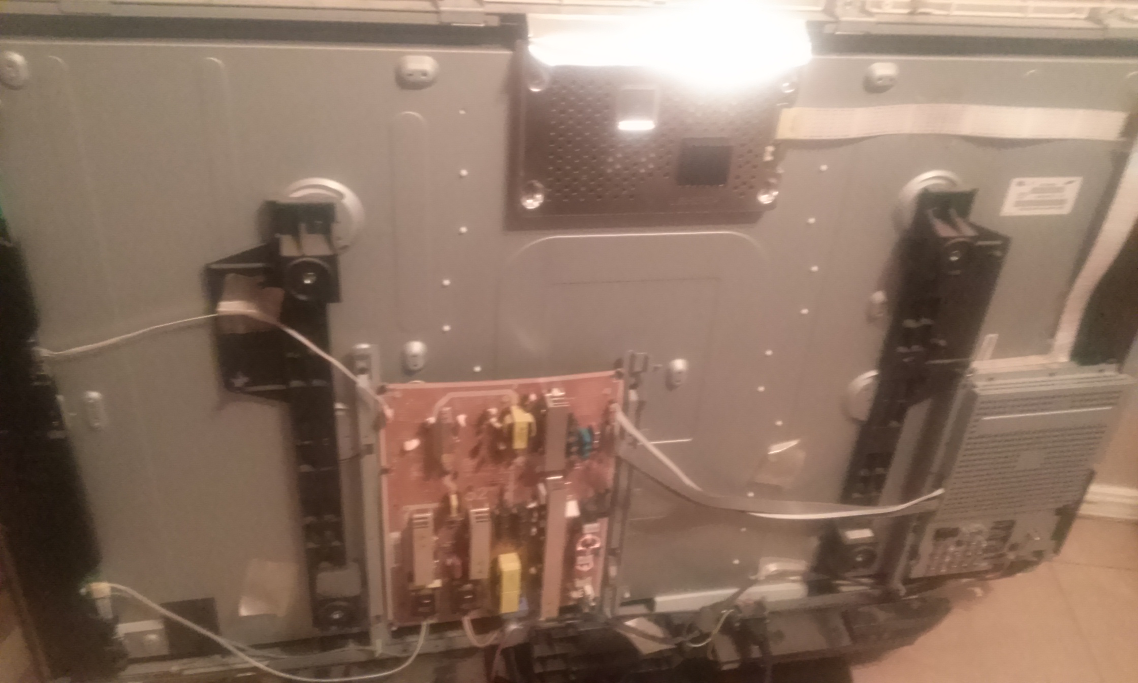

    I have a Samsung tv that powers up just fine. It only goes through the power cycle when something is playing like my xbox, the cable, etc. I've been dealing with this issue for awhile and need some help. Also, before it powers off, it has a buzzing noise coming out of the speakers.

    have you checked the PSU output voltages before and after plugging a component in? Does it work fine if nothing is ever hooked to it?
      Re: Samsung ln52a650 power cycle
      https://www.badcaps.net/forum/showth...650#post560429
      Pictures of the boards and the whole back side of the TV?

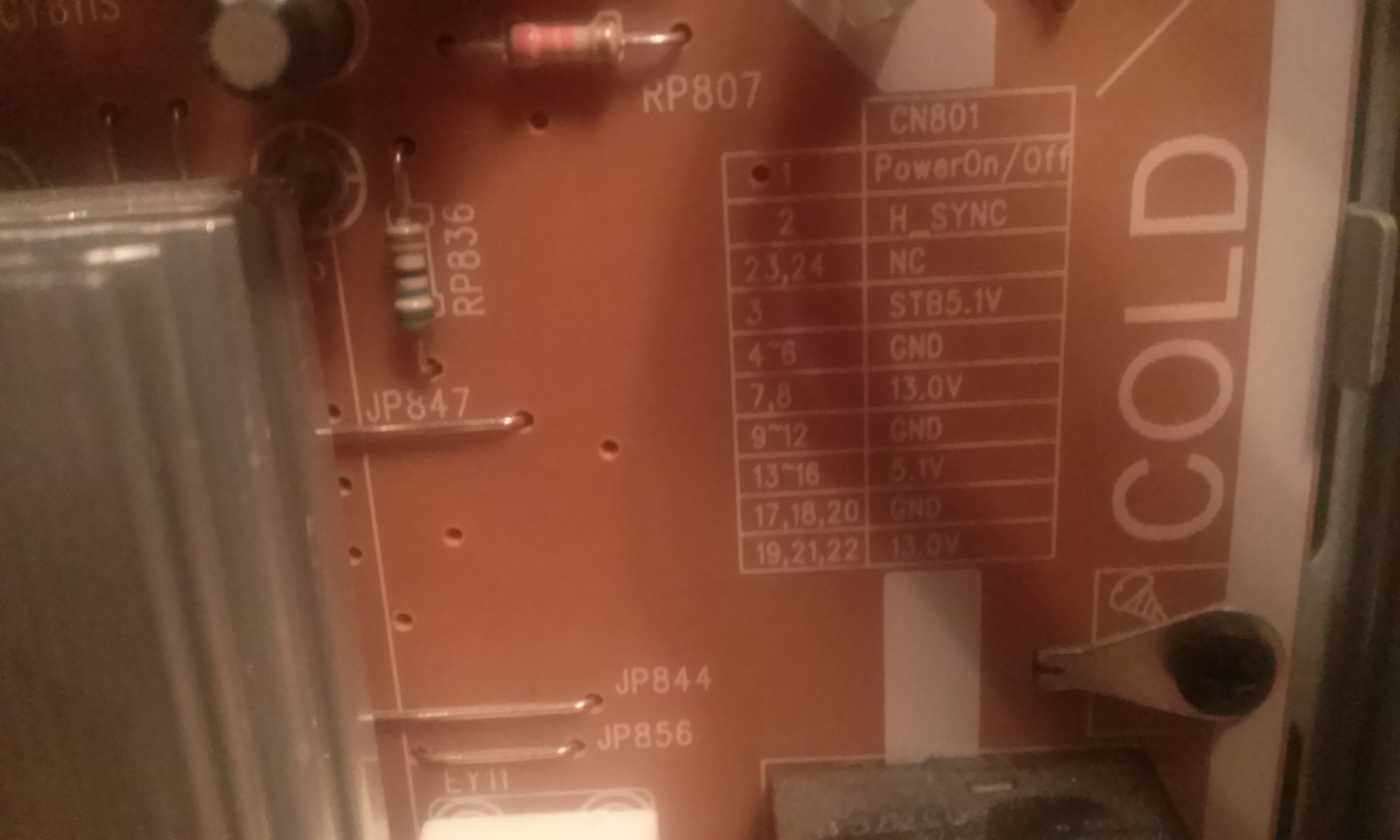

          The second picture is the plug running to the left side of the panel. It supposed to have a output of 12v but it read 10v.

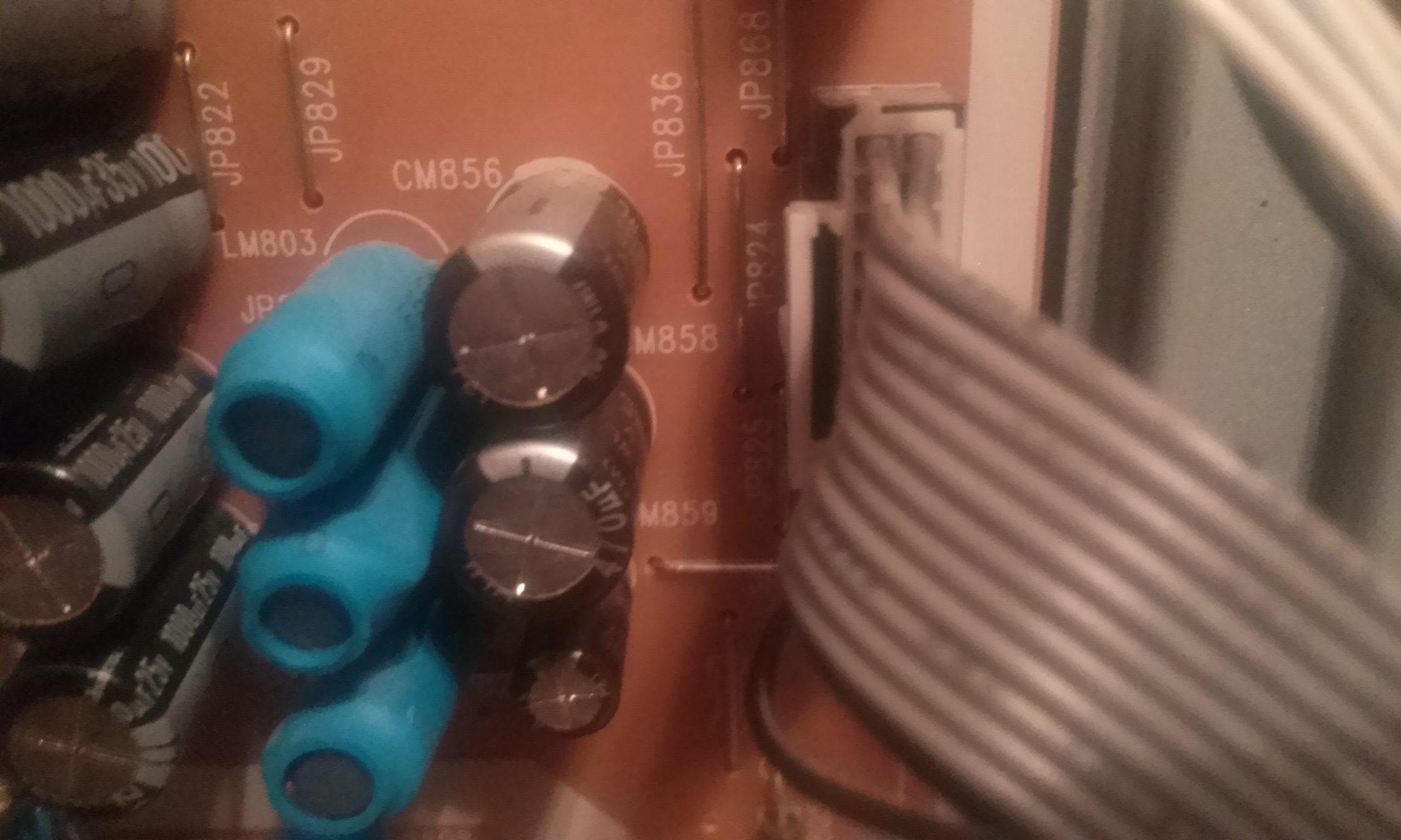

          The third picture is the upper wire plug that runs to the main board. It supposed to have a output of 5v but read 4v.

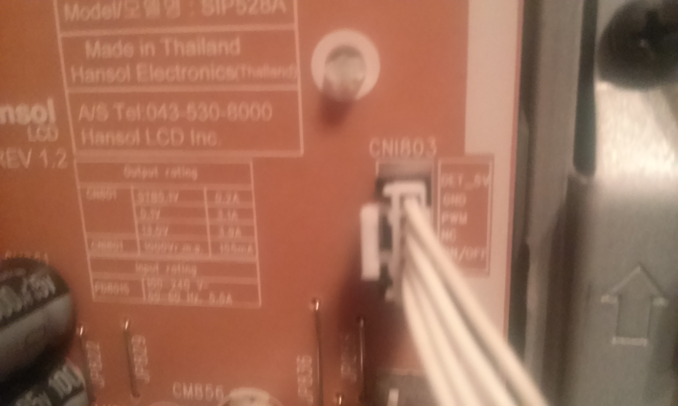

          The fourth picture with the caps is the lower wire plug that runs to the main board. Its supposed to have a output of 13v. It has 12v.
          This is with something running and with the tv just on with nothing running.
          If i was to watch a movie or cable, after 15 to 20 minutes the controls will lock up and a buzz will come from the speakers. Then the tv will turn off. It will continue this until i stop playing a movie or take the cable cord out of the TV.

              "If i was to watch a movie or cable, after 15 to 20 minutes the controls will lock up and a buzz will come from the speakers. Then the tv will turn off. It will continue this until i stop playing a movie or take the cable cord out of the TV." To me, this is problem on the main board.
