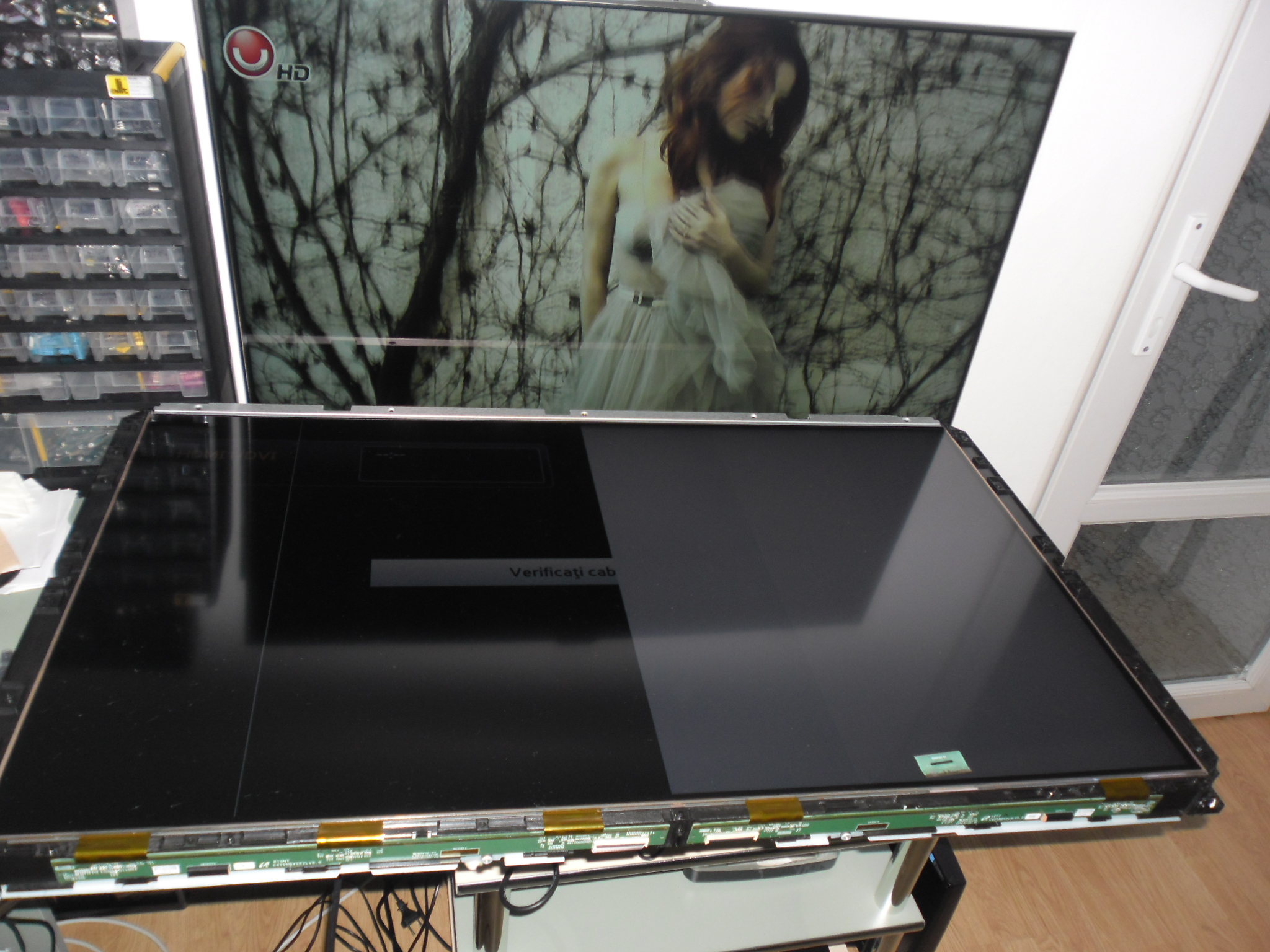

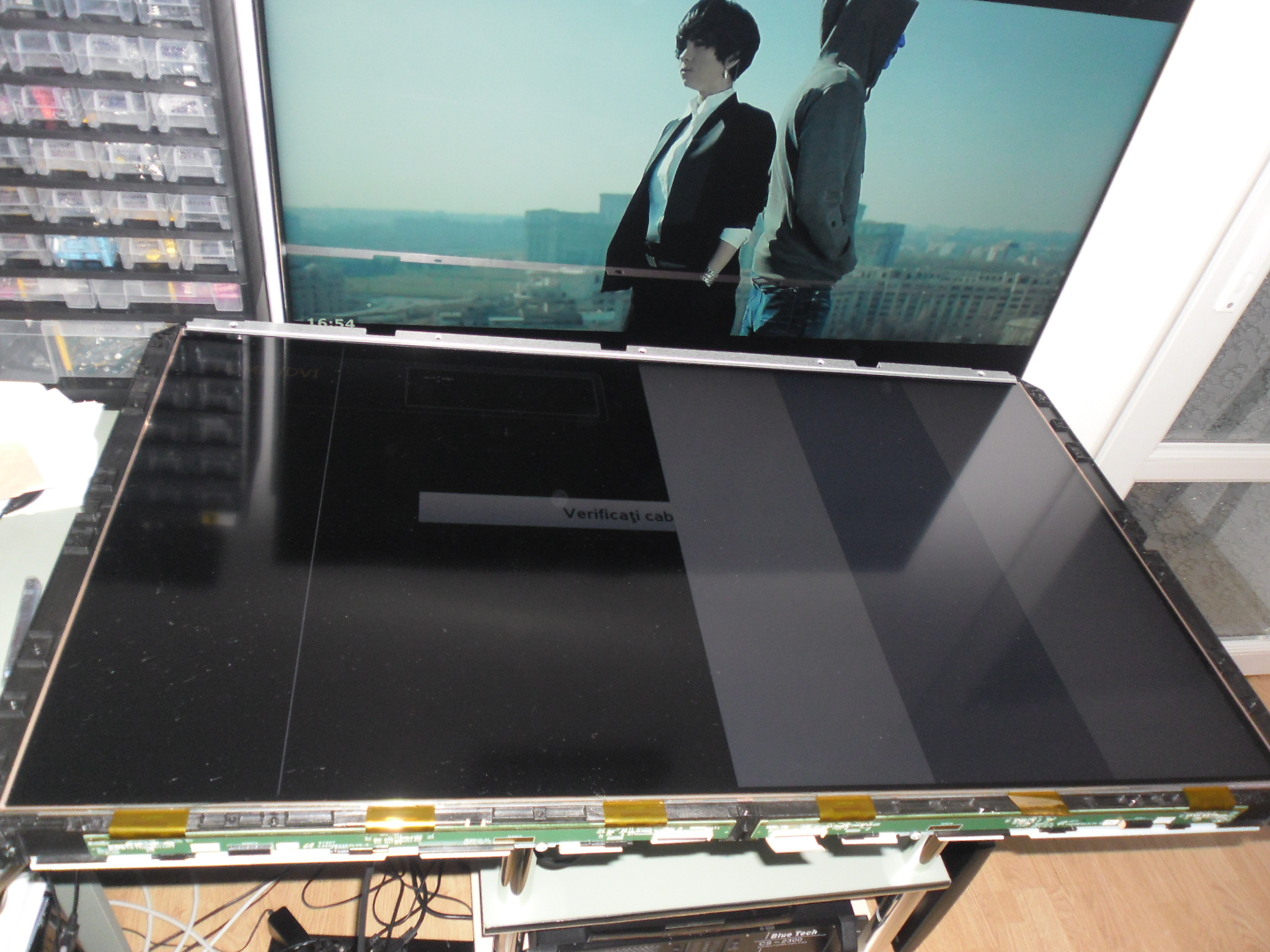

    looking at this picture would you say Tcon or panel is goosed ?
  • victor_cj
    • May 2015
    • 90
    • Romania
    Re: Samsung LE40B541p7w (Tcon OR Panel ?)
    Corroded PCB at LCD screen, COF broken/faulty or bonding problem. LCD panel need to be repaired or replaced.
