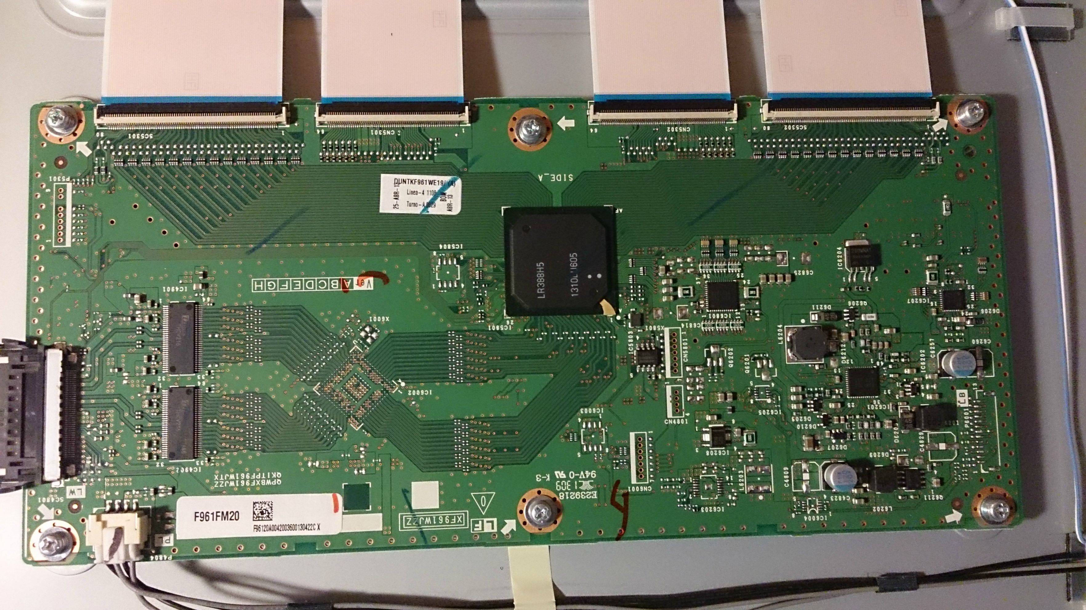

Sharp LC-70LE750U horizontal lines then no picture (Error code: 2-5 blinks)
  • CLquasi
    • Jun 2015
    • 9
    As an owner of 70LE750U, I feel like a trainer of rarest pokemon, I could barely find any information on this model...
    Anyway, I have this TV for about 18 months. The issue first appeared to be some distorted picture:
    VIDEO: https://youtu.be/EC6z9kbRSBI
    In the beginning of experiencing this issue, the picture would be fine for minutes after the TV is just switched on, then it gets worst and good picture would then only last for seconds. Now the TV goes blank when switched on, and the LED indicator gives the error of 2 long then 5 short blinks. According to the service manual from a similar model from another thread (LC60_70LE745U_C7450U_SM.pdf), it's the "Panel power supply error" error:
    PANEL_POW
    Panel 12V failure
    Flashes fast 5 times
    DET_PNL12V (34pin) failure (L). Panel power is not
    applied.
    Detection is started after turning on the panel power and
    receiving command; the power is turned off by polling.
    Based on the symptoms, I was assuming the issue is power supply related and hoping to resolve the issue by replacing the "Sharp RUNTKB118WJQZ (DPS-254BP-1) Power Supply / LED Board".. well, until I saw the Sharp TECHNICAL TIP 1541 from another thread:
    Model :
    Almost all Aquos TV’s
    Sympton:
    TV does not Power ON, exhibiting blink code of 2 Long & 5 Short
    Cause:
    Defective/Broken Panel, or Tcon defect
    I am now unsure how to toggle the issue, it seems it could be the T-con board, power supply, or the worst case... the panel... Any idea what to do next? Any help would be appreciated.

    Re: Sharp LC-70LE750U horizontal lines then no picture (Error code: 2-5 blinks)
    Posting pictures of the back of your tv showing the boards with clear pictures may help you more with fixing your problem

      Start by measuring the voltages coming from the power supply. 12V , 5V etc do you have those?

        Thanks for your response. I just opened the back, there are 3 major boards I see:
                    Given you're getting a 2-5 error code, which is panel-related, and a picture fault, I would say it is quite likely the LCD panel has failed - this would generally not be repairable (sorry)
                      Thank you for the reply... Yah, based on the error code, it does seem hopeless... I guess I was just waiting someone to hit me with the truth... 18 months... This is the shortest lived TV I have ever owned.... (What a shame... Even my 1997 Sony CRT still works like champ!)
