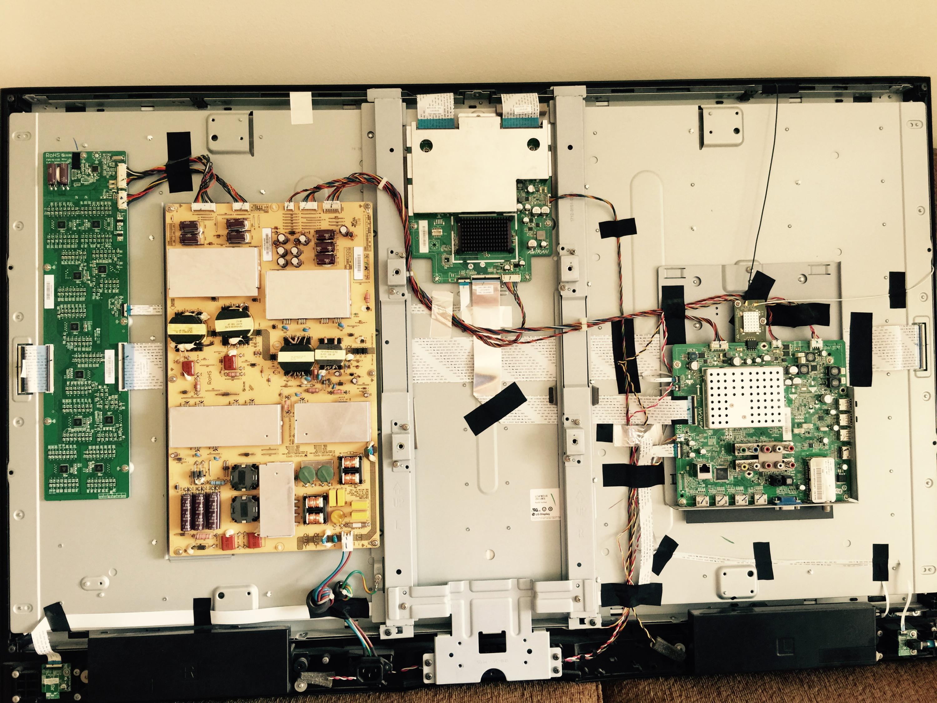

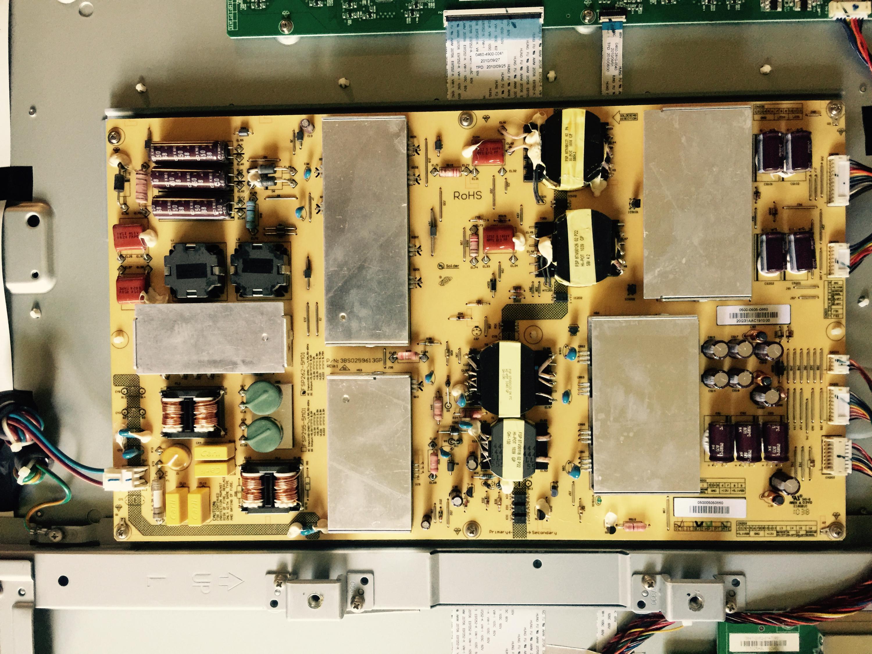

    About 3 weeks back my Vizio started acting up and would have to be reset and this solved all problems. A few days ago hit the remote and nothing happened, went through the reset procedures and nothing happened to include the orange Vizio logo doesn't even light up. I contacted Vizio and they referred me to a company for repair, but they are not in my area and there is actually nobody locally I can find for repair.
    So I began my troubleshooting and reading and have found several articles about bad capacitors and resistors with Vizio. I did check that 120 volts is going into the power board, but from there really have no idea. All the boards look ok and really don't see anything suspicious. Really at a lost and would appreciate anyone with any advice on what and how to troubleshoot.
    My thought is the main power board (part # 050005050860) has gone south.

      Re: Vizio XVT3D474SV Completely Dead
      • dadunn1960
        • Jun 2015
        • 20
        • US

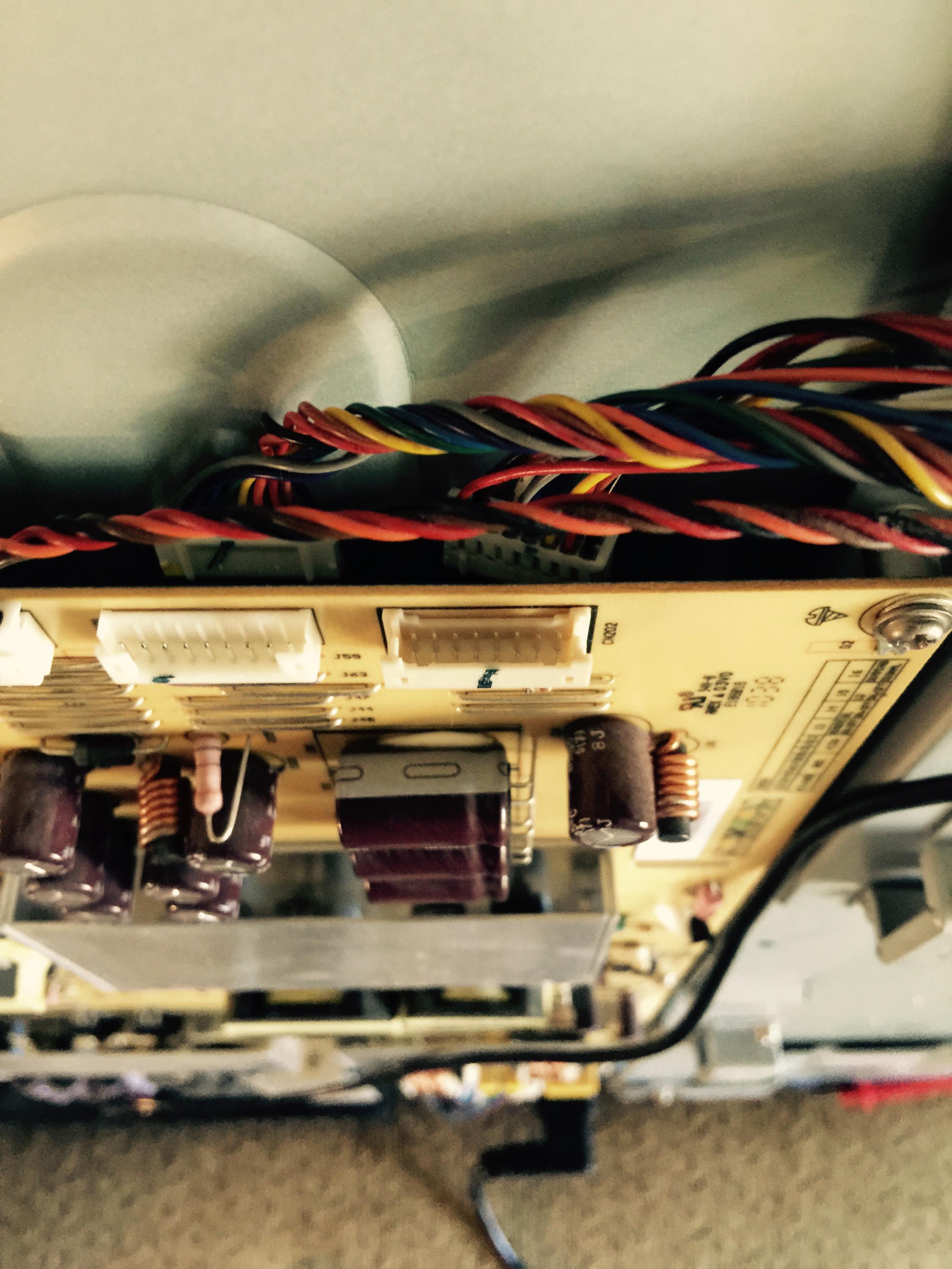

        Hope the Pics help!

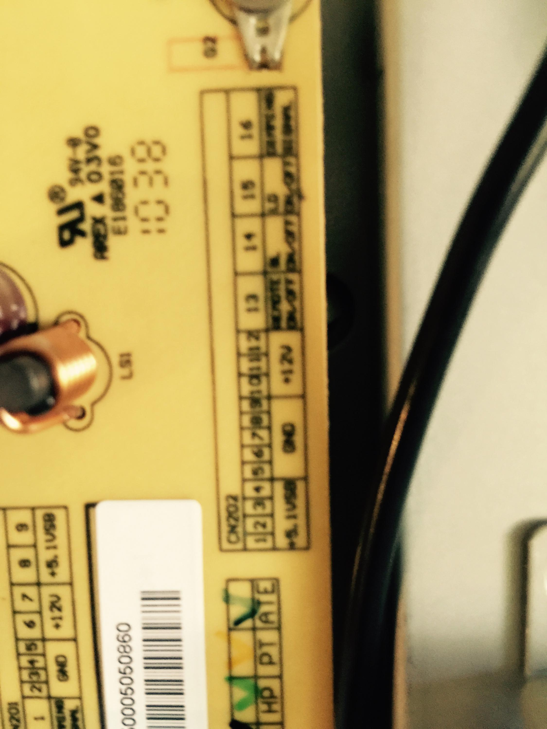

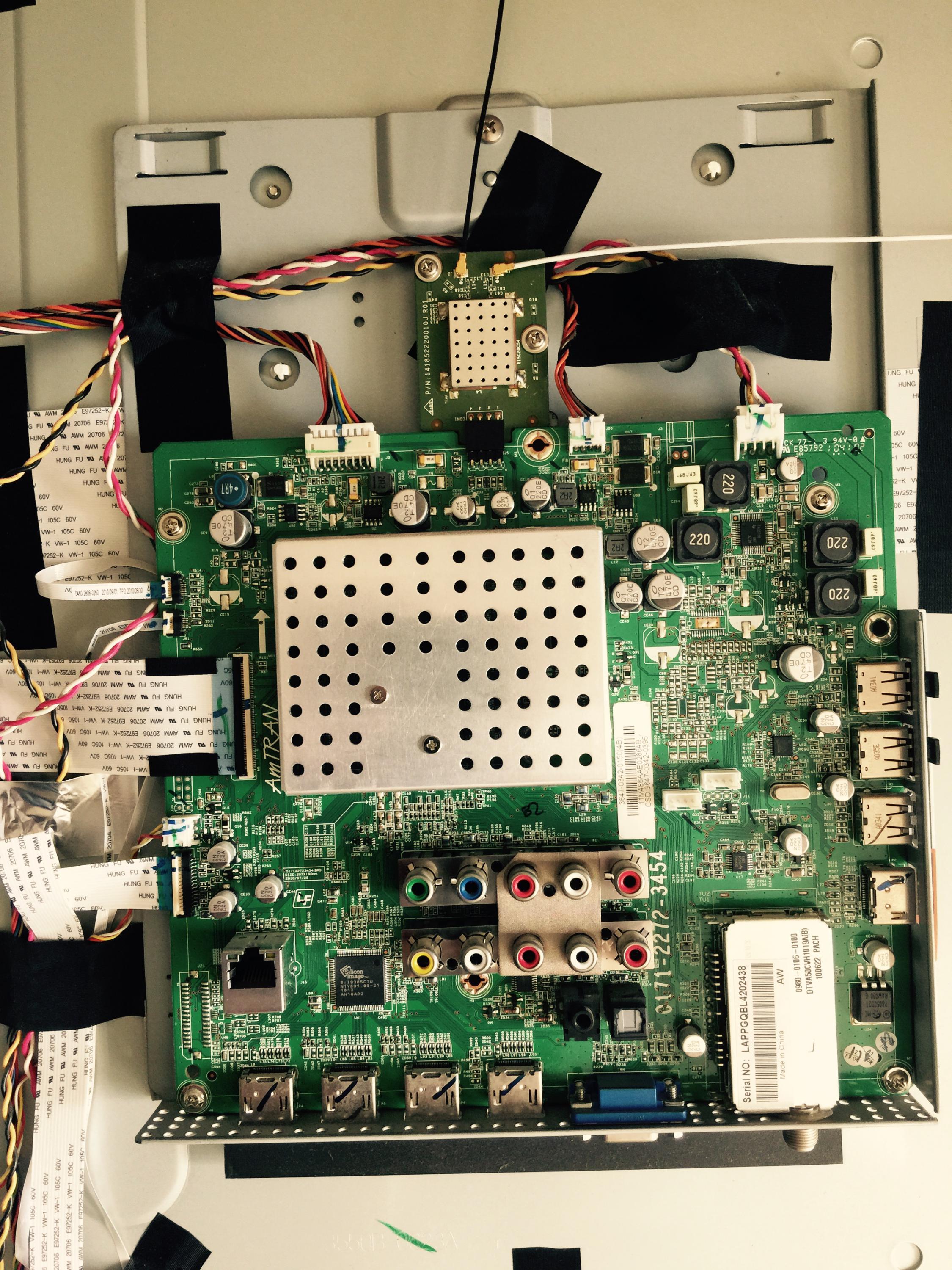

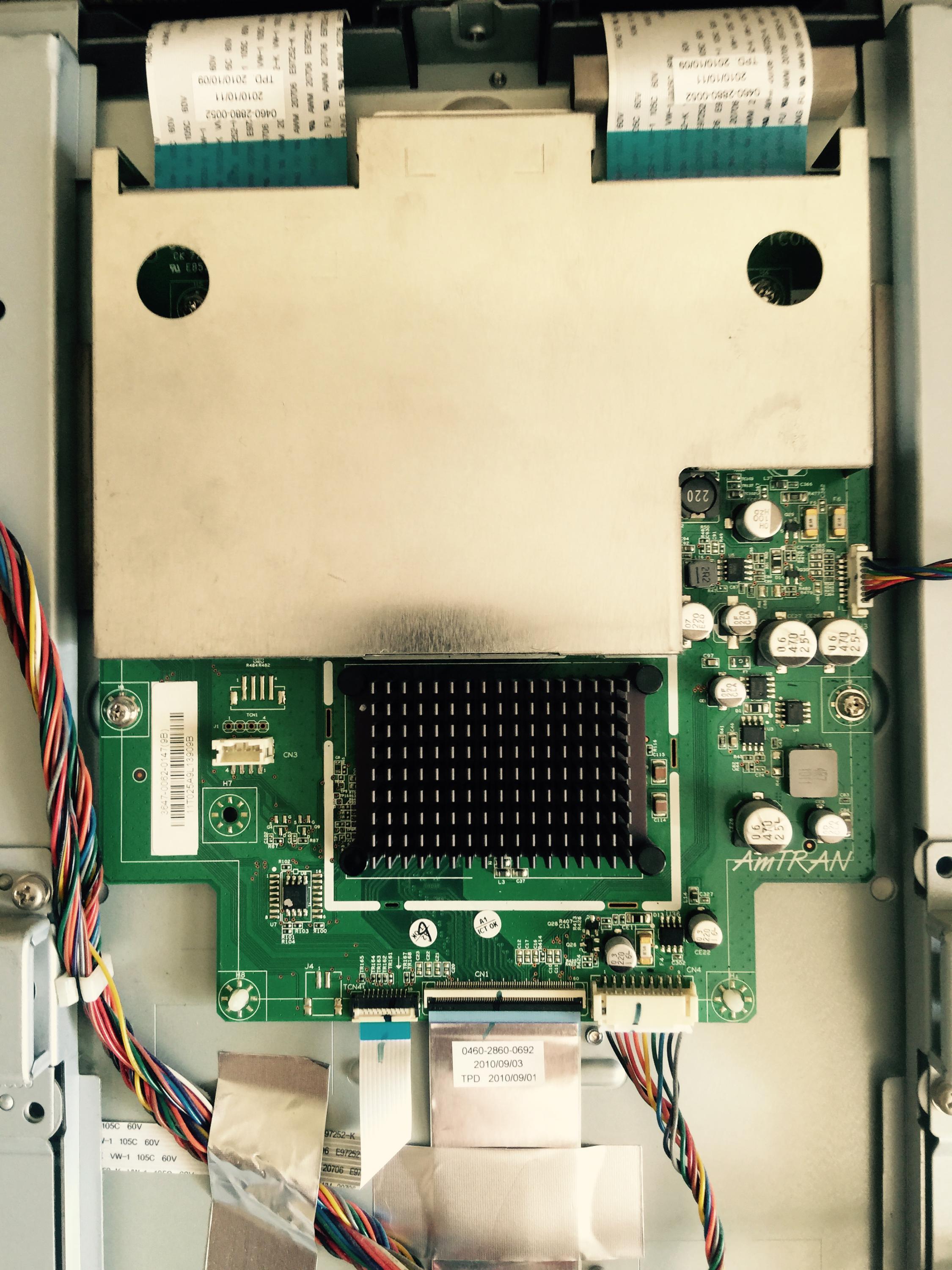

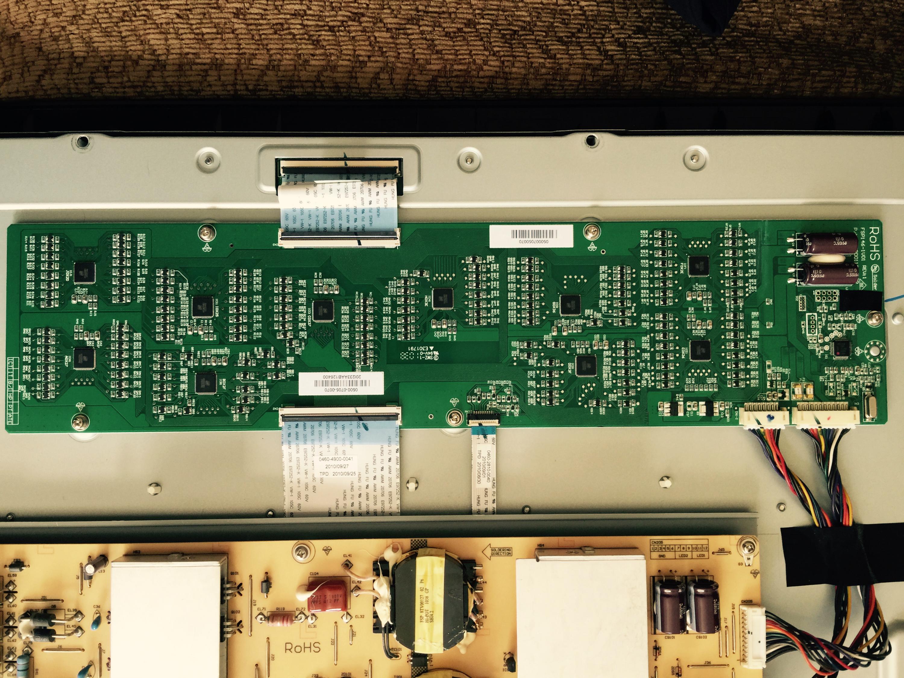

          The connectors on the power supply board have labels for each pin to tell us what they are for, so please take the DCV reading when the TV is plugged in but the power switch is NOT activated, then take the readings again after the power switch is activated so we can see what are missing. Make sure to put the pin names for each pin next to the Voltage readings, they are must have info.
          We also need the pictures of the whole back side of the TV so we can see how all the boards are connected together.
            I did record all the pins positions for 5 connections, however when push the off/on switch nothing happens and there is no change.
            CN201 Pin 6 and 7 +12V:nothing Pin 8 and 9 +5.1VSB: 5.1 and no change with on/off
            CN202 Pin 1,2,3,4+5.1VSB and only reading 5.1 on pins 1 and 2 and nothing on 3,4. PIN 5-9 are GND: nothing on all except 8, 9 which both have 5.1
            Pin 10, 11, 12 +12V:Nothing
            Note that CN202 is a double row of pins and the diagram just list 1-16 straight across, not sure if my evaluation is correct?

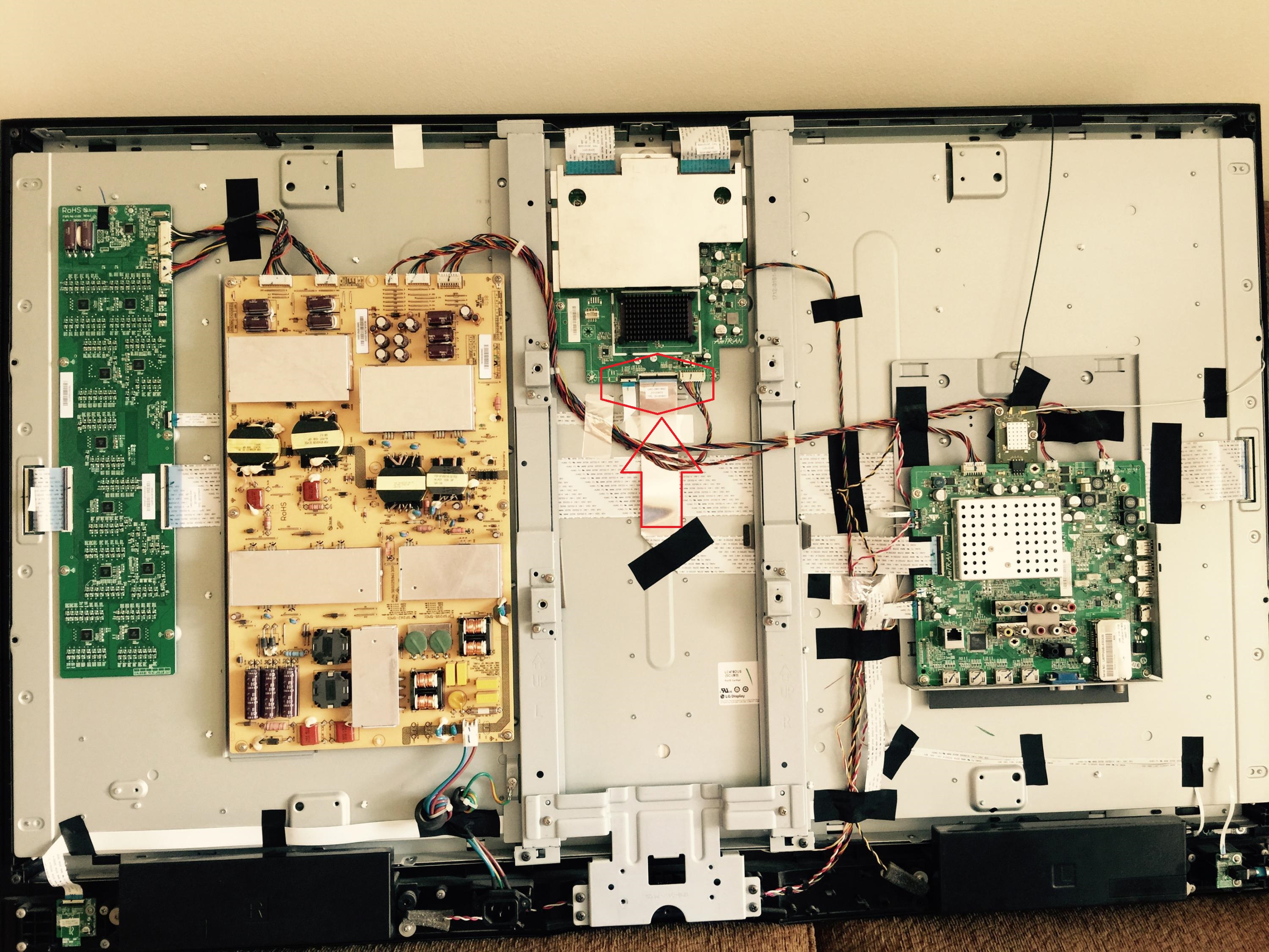

                You have no orange light on the TV power indicator, maybe the main board bad.
                check the main board processor heat sink shield with the TV power plug in. Touch with your hand to see if it is getting too hot or remaining cold.
                also disconnect the two ribbons cable and the power cable going to the pc board. this is a 240hz TV and this board is known to fail, see picture
                something is keeping the processor from powering on.
                  The Vizio logo does turn orange when plugged into AC power. Did check the processor and no change at all. What do I need to check when disconnecting the two ribbon cables.
                  Also nothing happens when I press the on/off switch.
                  Thanks for the Help!
                    you said the Vizio logo doesn't even light up a little, confuse. I think the main board is bad, mainly the flash memory chips the store the firmware is corrupt. replace your main board

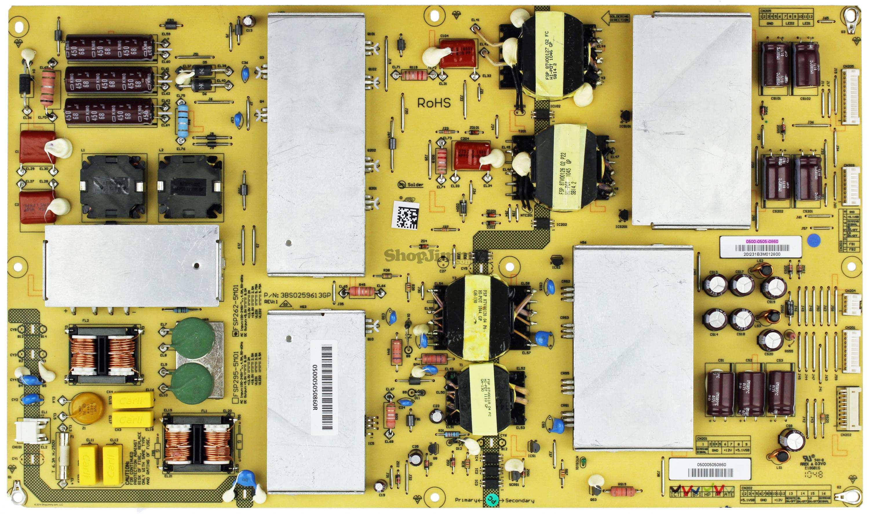

                        http://www.shopjimmy.com/catalogsear...zio+XVT3D474SV
                            Because the Main board has to send the PS-ON (pin 13 REMOTE ON/OFF) signal to turn on the rest of the power supplies, do you have >2VDC in that pin when power switch is activated?
                            Good pictures provided by Shopjimmy.
                            Pin 14 is for BL ON/OFF, it should be >2VDC when power switch is activated.
                              Pin 13 has nothing and pin 14 has .006 VDC. No changes when I press the off/on switch.
                              Would the next step be to replace the main board or more troubleshooting? Is the main board the same one that ecking767 recommended in post 10?
                                      Contacted Shopjimmy, but they do not have the part available, found the part at TV Central Parts.
                                      After I install the new part, is there any software that has to be loaded or any special procedures required?
                                        Thanks to ALL those that helped me with the troubleshooting and providing technical guidance, part came in today and that fixed the Vizio. Only issue is the remote control isn't working, not sure why. If anyone has any ideas I will certainly be willing to try.
